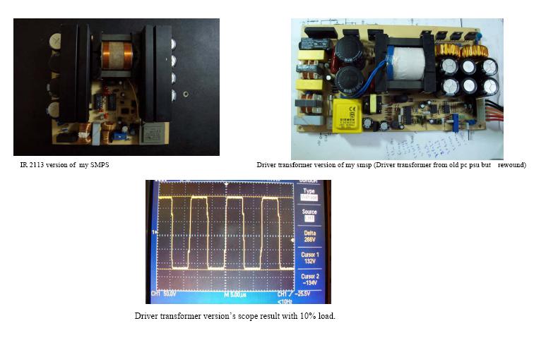

Hi to everybody,
I have builded so kind of a SMPS with ETD49 with IR2113 and another circuit I used driver transformer. My ETD49 magnetics P material and it wound on only 24sp primary and 2*8sp sec for +-37V 8A output. I am working on the new updated version of the SPS's pcb. But ý would like to say the circuit uses driver transformer is more efficient then the gate driver version. I am enclosing the picture of circuits and scope results of my circuit.
Best regards

I don't see output inductors on the picture, and on the schematic. Why did you omit them?

what my picture? I didnt post any picture
Sorry, I was thinking of Worthless....
Worthless: Why there aren't output inductors on the schematic, and the PCB?

Hi DANKO and the others,
1.Because "driver tranformer version" has a different shematic.
2.555 and 393 : 393 for erors against to over temperature and over current and it drives 555. 555 tirgered by 393 and stanbys the 3525 chip for 3-5 second for erors.
3. I will redraw the driver transformer version's shematic and post it as soon as possible.( it is hand drawn by me so may cause to be misunderstanding)
4. output inductors from an old pc PSU and rewound. I am not shure but they must be micrometals T-106-26 core. The circuit my old desing and I can not remember the munber of turns for the output inductors but I will look my circuit and measure the inductor value and post all of them as soon as possible.
Please let me a bit time to post.
By the time I can answer your questions.
