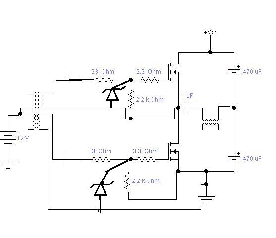

Here is the schematic.
Passive resistive gate turn-off is not suitable for SMPS at all. Use a PNP buffer instead, with a diode to bypass it during turn-on.
The two latter schematics from that picture should be a good hint for turn-off improvement (for your case, replace the first NPN transistor by a diode as the one you are already employing to isolate negative pulses).
Be careful with pulse transformer ringing as it may cause parasitistic turn-on of the wrong set of MOSFETs, shall it happen RC damping networks would have to be added to the windings.

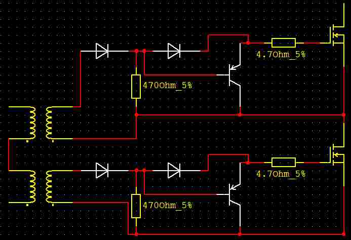

Hi, Eve
I tried the schematic you posted.It was a bit better but still not good enough.
I was thinking of using hi and lo side mosfet driver (IR2110).What do you think about this kind of driving.
Thx,
nejc
Thx,
nejc

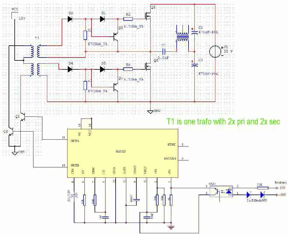

Could you post an schematic of what you actually tried? If you still experiment high switching losses when employing active gate turn-off as I suggested, the problem may be actually coming from other part of the circuit.
The gate drive approach as you show it should work fine. However, in the schematic both secondaries are driving the MOSFETs with the same polarity, but I suppose that this is just a typo as such a connection willl autodestruct itself. Also, two transformers with their primaries connected in series are shown, is that also a typo? A single transformer is preferable, since two transformers will require their primaries to be wired in paralell and some speacial means of flux balancing.
Have you placed a 1uF non-polar cpacitor between one of the primary leads of the transformer and the SG3525? This is essential to avoid transformer saturation. A couple of 2.2 ohm series resistors may also help in order to keep the SG3525A happier (they will help to prevent overshoot and will isolate it from transformer capacitances). Note that in case you are using two independent transformers, each one will require its own balancing capacitor and resistors.
By the way, how is your SG3525A wired to the transformer and to the rest of the circuit? Could you post an schematic? The problem may be here.
You are driving the transformer in the wrong way because the primary must be effectively shorted during the time MOSFETs are off, but your circuit just leaves it in a high impedance state and thus free to ring and turn on both MOSFETs ramdomly.
Also, base resistors for Q1 and Q2 are missing, is this a schematic typo?
If you want it to work properly, you have to drive the transformer directly from the OUTA and OUTB outputs of the SG3525A (or any other totem-pole low impedance source) with a 1uF series capacitor (and optional series resistors) as I previously mentioned. If the transformer has a 1+1:1+1 ratio, you should connect both primaries in paralell if you can, otherwise you should drive only one of the primaries, or drive both in series by employing a higher power supply voltage for the SG3525A (it's rated up to 35V). Either way, the supply voltage should be chosen to get 15V at the gates in order to achieve optimum conduction losses.
EDIT: Remember to ground both the Sync and Shutdown inputs, as they may pick up noise and cause the SG3525A to terminate the pulses or the clock cycles prematurely (big trouble). Also, you should place a capacitor of at least 10uF between Vc and Gnd pins, as the totem-pole output stage of that IC suffers from brief cross-conduction pulses in each transient.
