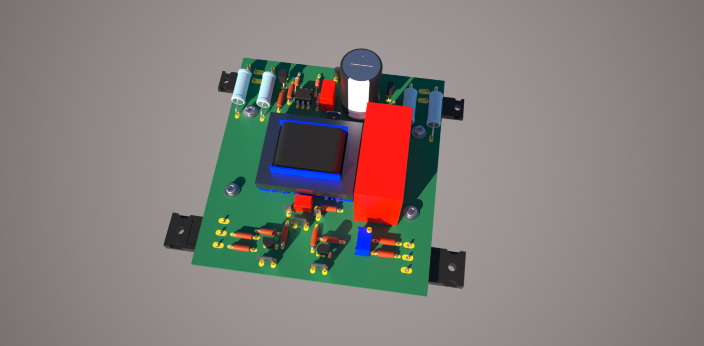

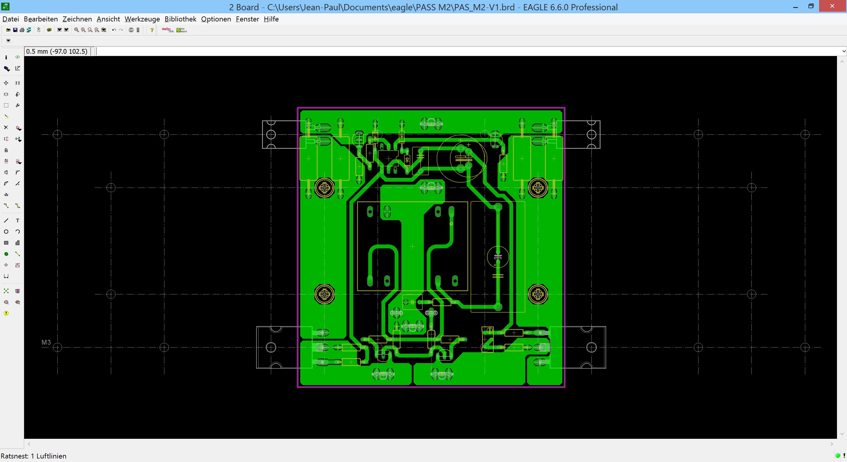

... my try this sunday...

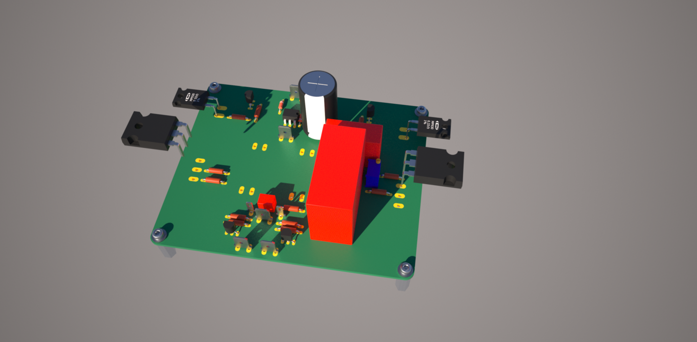

I will go with vertically mounted PCB (FET´s directly screwed onto heatsink): needs new symbols for this kind of mounting.
What do you use for the PASS typically 3W resistors? Should place two parallel, parallel to MP´s on PCB.

Jean-Paul,
This is the resistor used in several First Watt amplifiers that had inside pictures published.
ERX-3SJR47 Panasonic Electronic Components | P0.47W-3BK-ND | DigiKey

To get more people interested in your boards you might want do make them compliant with the "Universal PCB & Semiconductor Mounting Specification (UMS)" published on the DIYAudioStore site. To see the diagram go to http://www.diyaudio.com/store/ select Chassis and you will find the link in the Technical Information section.
