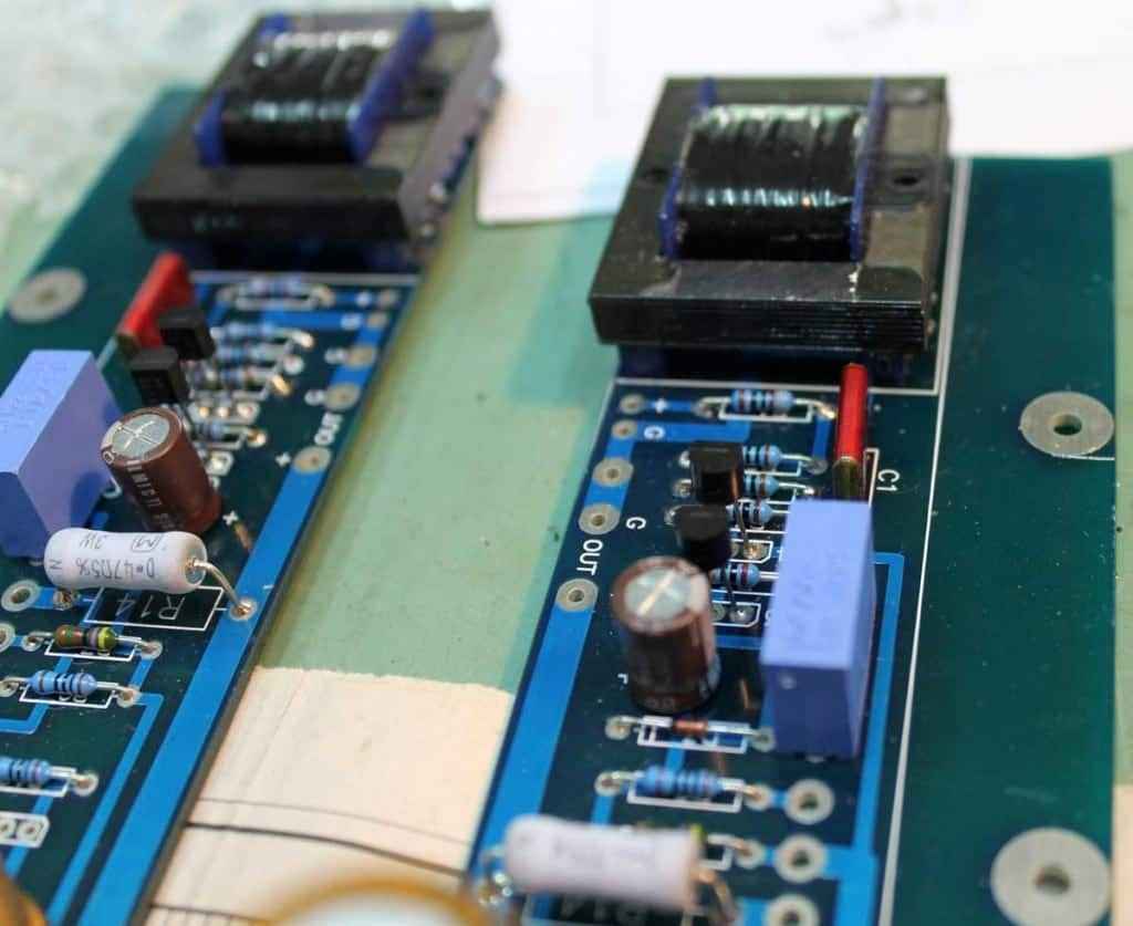

I have tried to find the Edcor PC600/15K transformer with no luck. I can only guess it was made specifically for Firstwatt. What transformer did you use Zen Mod?
Just use a Jensen with the right turn ratio.I have tried to find the Edcor PC600/15K transformer with no luck. I can only guess it was made specifically for Firstwatt. What transformer did you use Zen Mod?
I think voltage gain of amp is around 6
After much head scratching on my part this is the transformer I came up with. You will have to change the type in the box to 600 ohm to 15 K ohm.

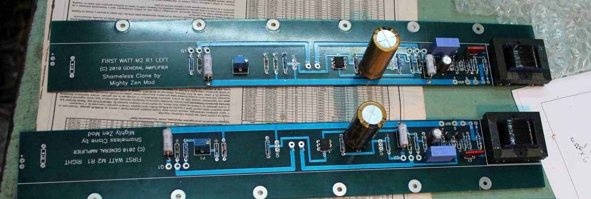

If I become even more lazy than I already am now, I would definitely be interested in some of your pcbs
Iq is aroundish 1A5
tweakable varying LED series resistor or including some resistance in series to bjt part

One thing that is a very nice feature but not often included, is an extra place to for an additional source resistor for paralleling to tweak value of source resistors.
The only other thing would be to ensure big Elna Silmic caps will fit on the PCB.
