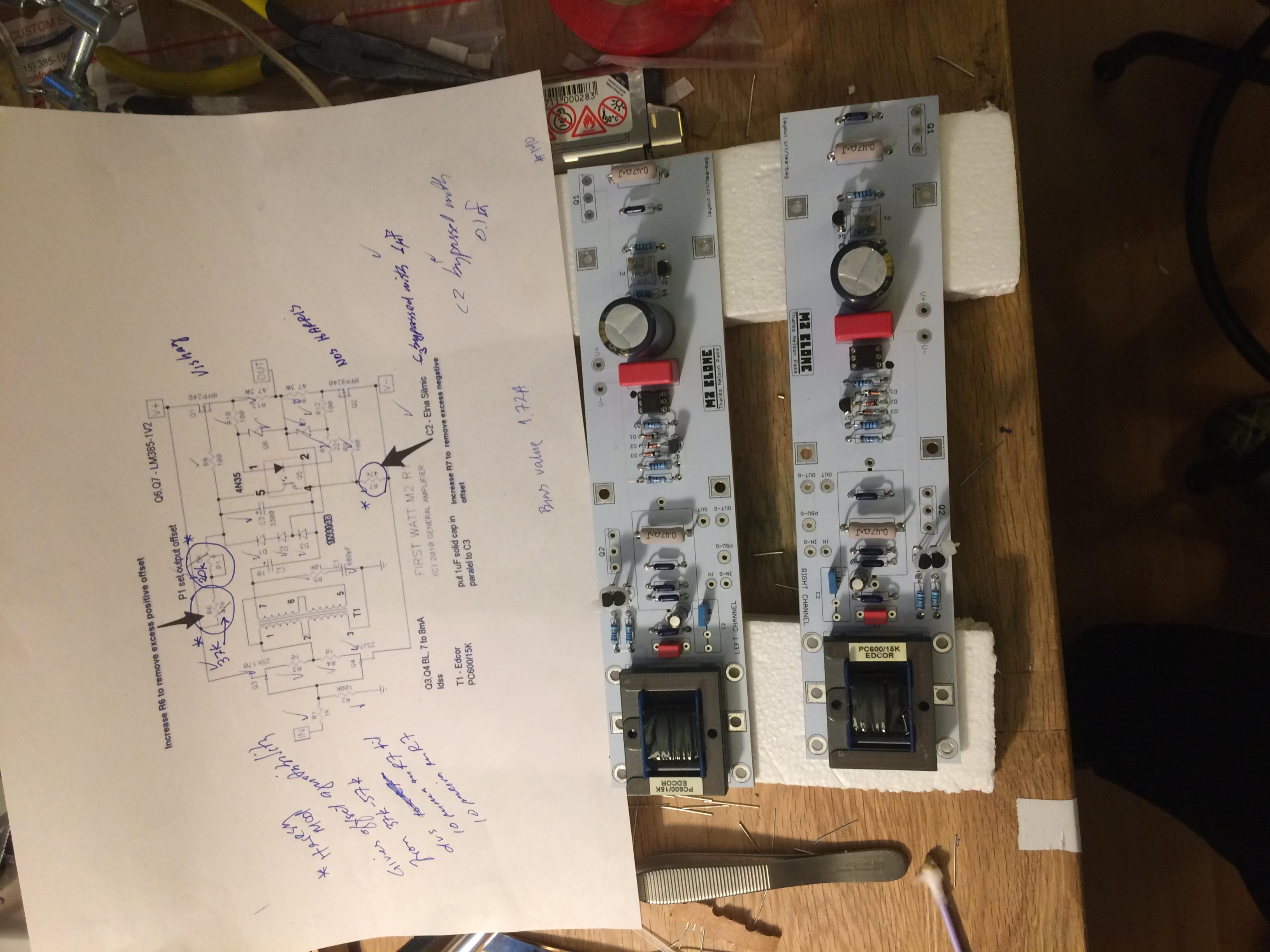

M2 Clone - Tea-bag pcbs.

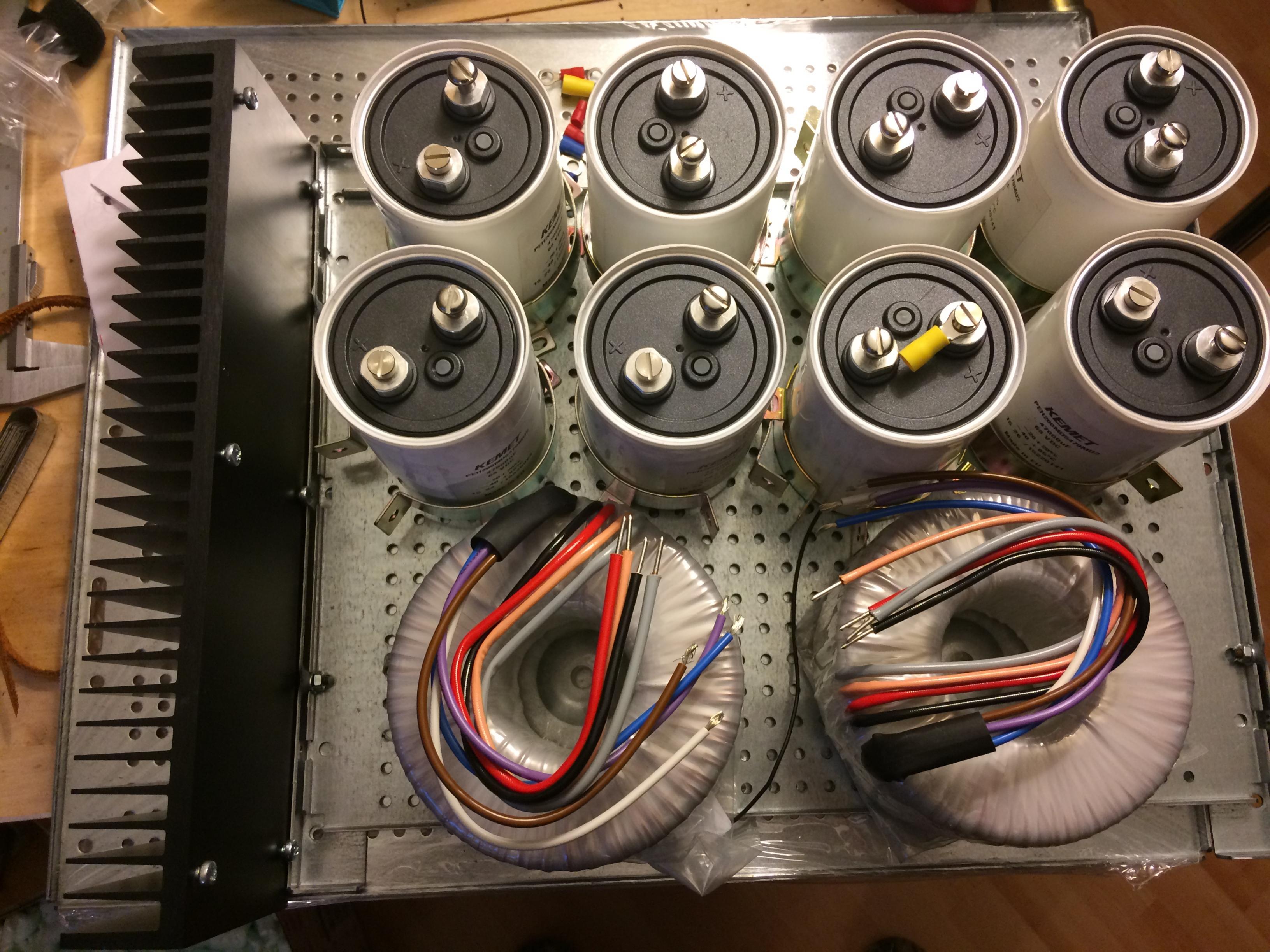

Getting there 🙂
4Ux300 case will be cramped but probably doable (bottom plate and sink on picture from 2U case to test fit). It would be nice to have predrilled 400 deep 3U or 4U heatsinks. The 5Ux400 is to big for my taste - until the 100W class -A fever hits me

kbergsson, that looks exactly like what im planning for my M2. I also just got hold of some 47mF/63V PEH caps so will go for dual mono. I am a bit worried about noise radiated from the transformers being picked up by the Edcors though, as i seem to have a bit of that in my F6 in the 4U chassis (not dual mono but 400VA transformer).

Silasmellor I have the Diyaudio powersupply solution (8x 18000uf) in my F6 and unshielded 400VA trafo. Had some supply noise at first then remembered to do grounding excactly as 6L6s F6 build guide. My F6s are now totally silent on my 100+db Altecs.
Did you get your Kemets from surplus in Holland? I got mine there (tunasto) for a good price. Jonny Canuck, correkt 47000uf long life PEH200. Mouser has them as well but they are expensive. Mine are as said from surplus but according to datecodes all between 2 and 3 years old, seem to be unused.
I have some screens for the edcors on the way, if necessary, but they will be placed furthest from the trafos.

I also use the grounding scheme from the guide. From psu board, via cl60 To chassis. Each amp board connected to +/-/gnd.. The noise is very faint with me ear next to the woofer, but I can see higher order harmonics in the fft which bother me (though i am not sure they are audible). I’m not sure if it is radiated noise from the transformer getting into the Jensen’s, but that’s currently my hypothesis.

It will be similar to your plans i.e. I have some 0R1 10w wirewounds as R in CRC, so 47000uf-0R1-47000uf and maybe 10uf large Wima as bypass per rail. The trafos I got are 2x 300VA dual 18V seconaries. I dont have any simulation sw. So If I like the sound is will be ok, If not Ill have to try something else 🙂
In the F6 I use shielded input cable with shield connected to gnd cable at input connector. I have used Tubes for a long time so if I dont hear noise I dont care 🙂

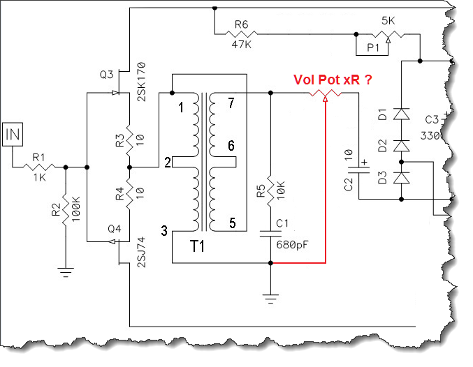

To get the most out of M2 and F6 I would like to place the volume attenautor also behind jensen / edcor transformers. For M2 this would be possible I guess. Could you help please if this would be feasible and what pot/relay volume attenuator impendance would fit best to match output impedance of transformer and the power transistors.
Any chance to put a dual volume control behind the jensen transformer in a F6? I do not know where to place.

The traditional position for a volume control would be "R2". Use a 100K pot to ground, input comes from R1, wiper goes to Q3 and Q4. Since it's DC coupled, if the input signal happens to have any DC offset, changing the volume control can produce a scratchy sound.
You probably don't want to drive the output stage from an impedance that varies with volume control setting. So you probably don't want to install the pot between the secondary and the output stage.
