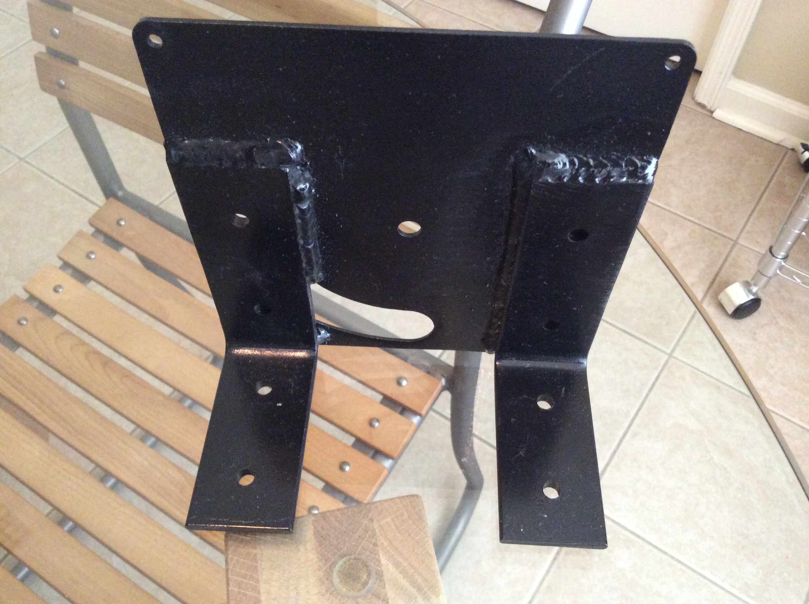

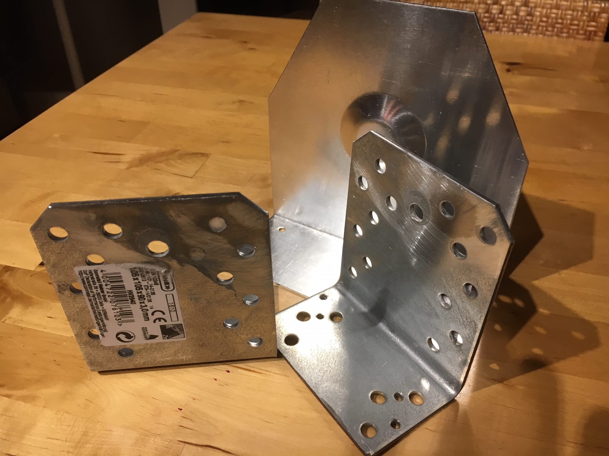

I have attached a pic of the brackets. These are standard brackets from hardware store and measure 105x105x90x3mm. One end needs to be cutted with an angle grinder and I had to drill some additional holes for mouning on the baseplate. I have ordered also L-Brackets from Audiophonics : Achats de Produits Hi-Fi Audio Electroniques et DIY - Audiophonics. But these are made of only 1.4mm thin aluminium and have a bulge which is not necessary for potted transformers. You can see one in the background of attached pic.Wow thats impressive! Some nice details there, I also like the rectifiers mounted on the faceplate. What l bracket did you use for the transformer?

Ah I see. This is what I had to with the mounting plate.
Good tip on the transformer brackets. I also bought the audiophonics one but it is not very stable (and didn’t improve noise with my F6) so I got rid of it. Those hardware store ones look more solid though, I will look into that.
Your version is perfect. Well done. Originally I thought about getting a bracket bended according to drawing. But to use the original plate for welding would be even better and cheaper. Or for free if you have a friend who can do the welding.
The welding was free and the brackets were $14

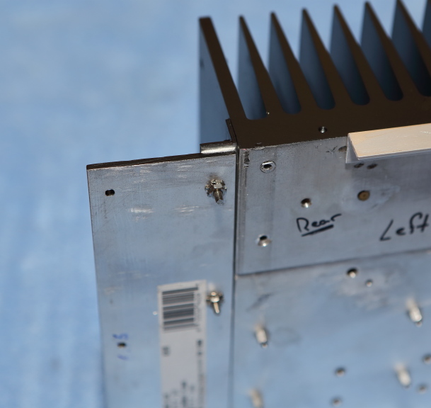

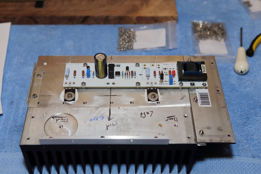

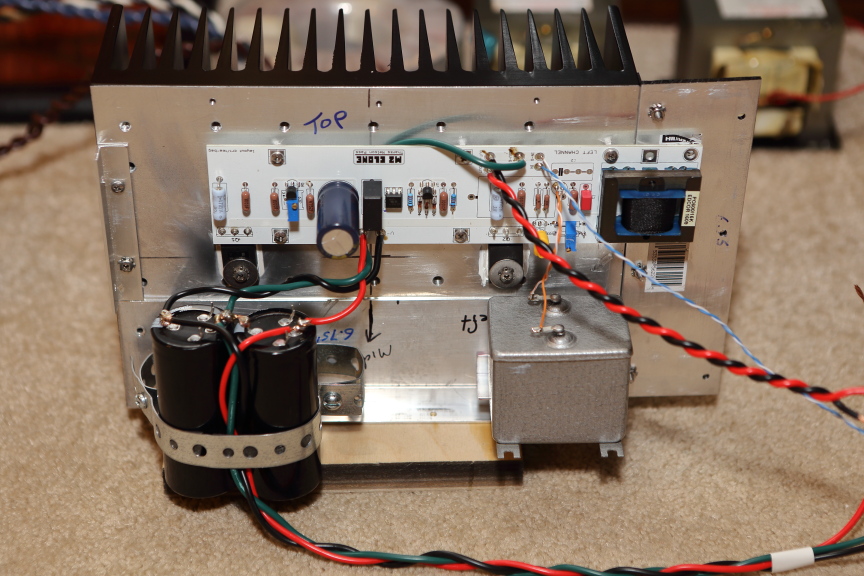

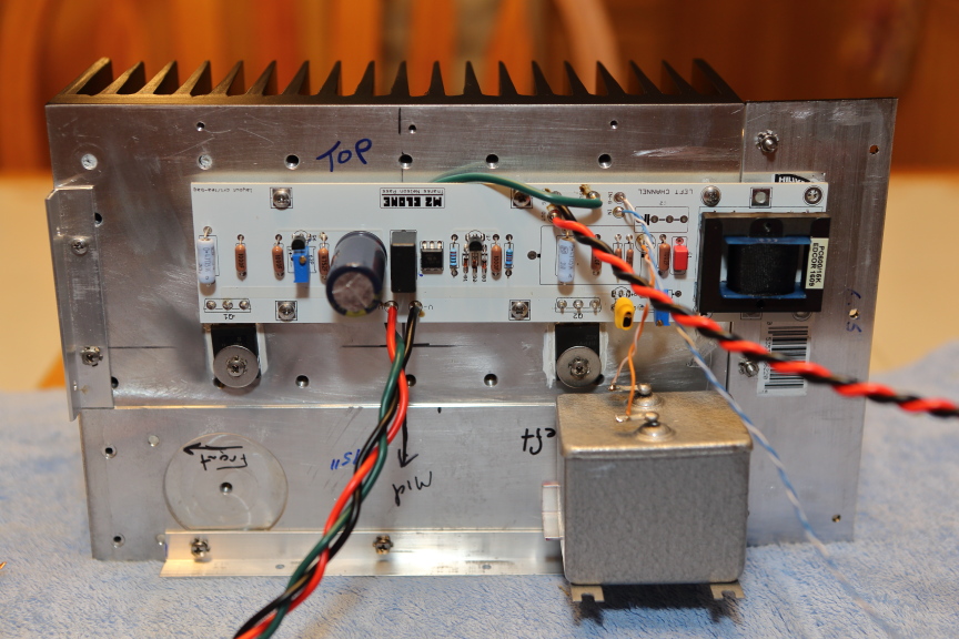

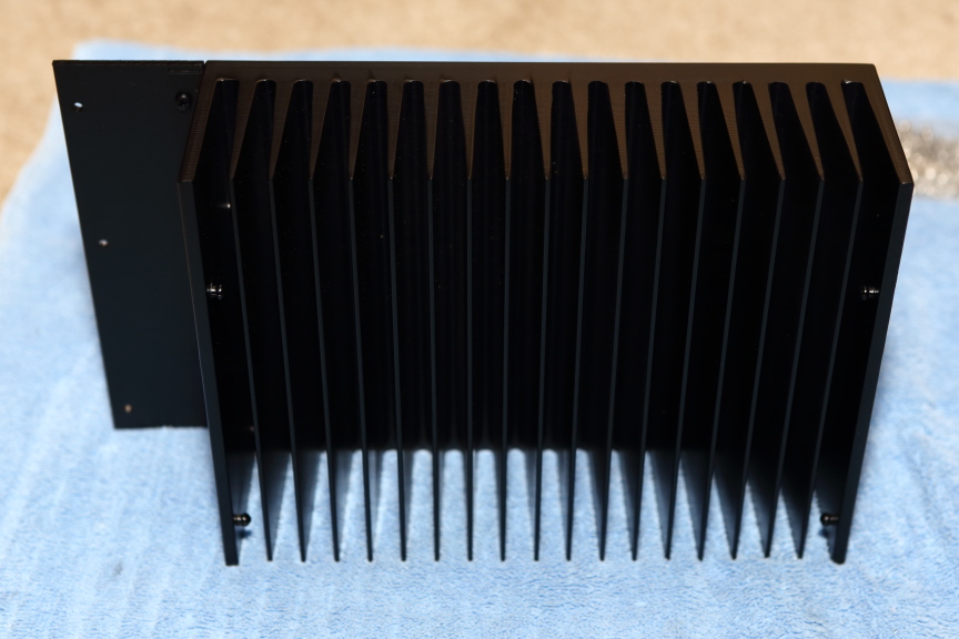

I've been working on my M2 for a little while now and still have a little bit to go. I've designed it in a "modular" fashion, with an outboard power supply that can also be used with my F4 and (not yet built) Aleph-J. I started with a 9x13" heatsink that I found at the flea market for $6. I had someone at the university product development lab cut it in half for me and I gave it light coat of black paint.

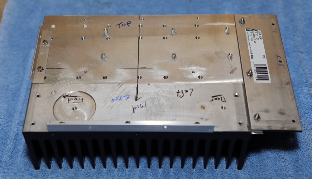

Because the sink wasn't wide enough to accommodate the circuit board with the mosfets placed in ideal locations for heat dissipation, I attached a 1/2" aluminum L-bracket and a 1/8" x 2" strip of aluminum bar to one side.

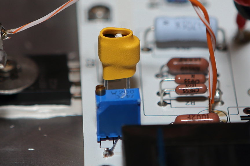

I used Tea-Bag's boards along with the Harris 9240, so I had to make R6 47k5 and R7 53k in order to achieve 0mV across speaker terminals. PSU rails are plus/minus 22.6v and I measure 0.594v across R13 and R14. With stock configuration, this works out to 1.26A bias or 58w per channel. The sinks provide a 20c rise over ambient temperature. I used some mica and goop to mount the mosfets, they get about 10c hotter than the sink itself.
I used a 20R multiturn pot in place of R3/R4. I used my most mis-matched jFets (10.66mA 2SK170 and 6.90mA 2SJ74) and the 20R allows me to balance the output of the buffer with precision. I slathered the jFets with some heatsink grease and wrapped them with heat shrink tube. For C2, I used a NOS Russian PIO 10uF MBGCh cap - thought it would "fit" better with the "tube" sort of flavor of this amp.

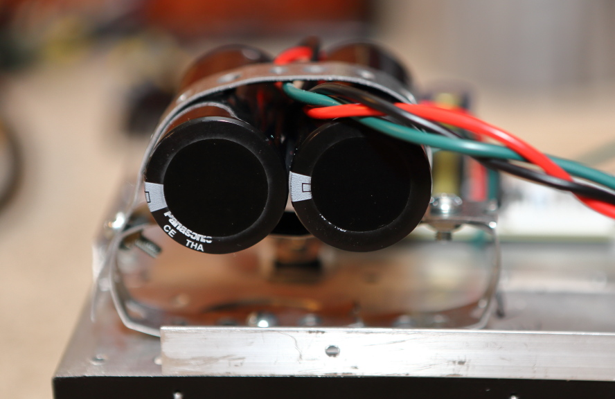

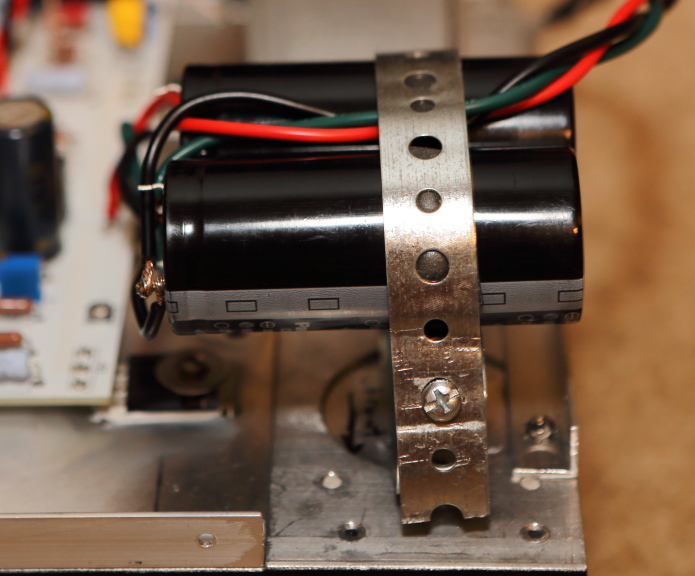

I used some steel banding with a bit of rubber padding to make a clamp to hold the local power supply caps (39,000uF each) to the sinks. This arrangement holds them tightly, but isolates them a bit from the heat of the sink. The outboard PSU will have another bank of caps and about 0R1 resistors, followed by the power umbilical, thus forming a CRC filter.
I'll use some figured maple for the front and top of the chassis. Just a bit more structural work to go then I'll move it into my main system for some listening.
