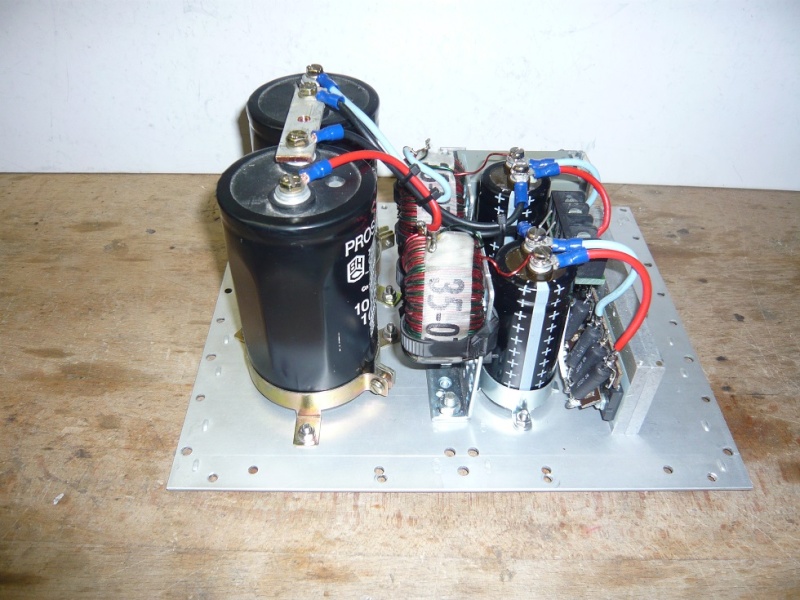

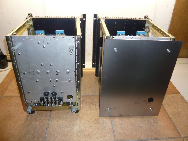

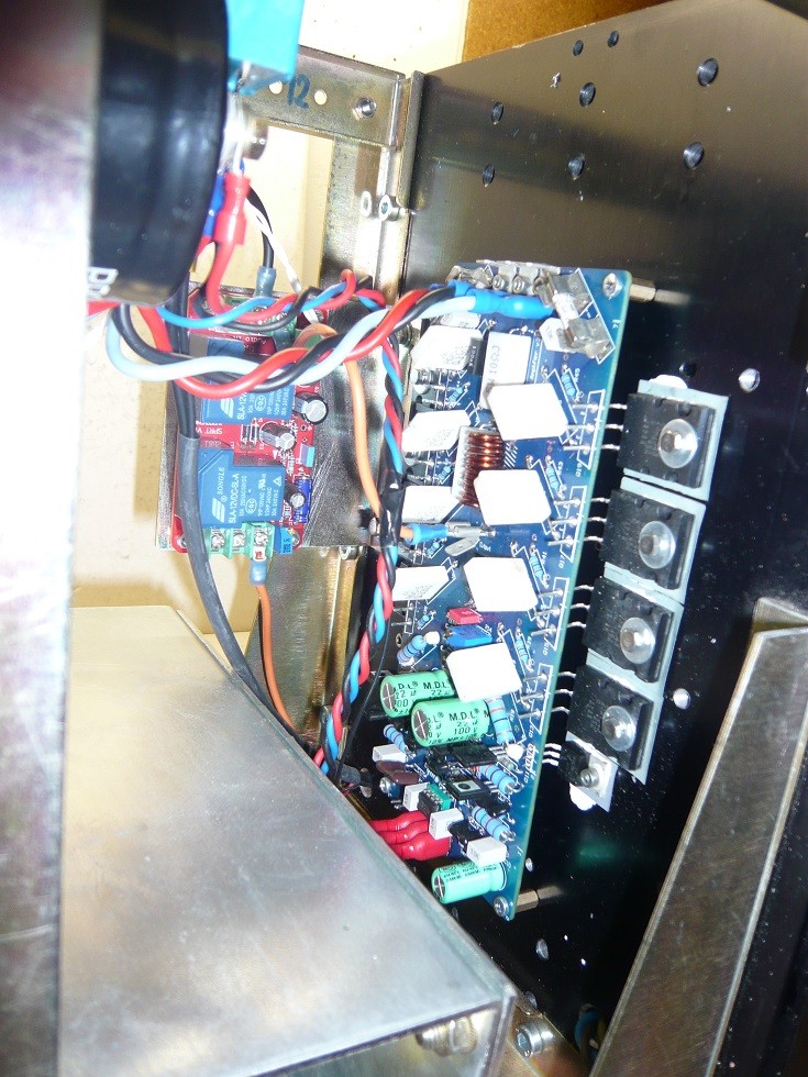

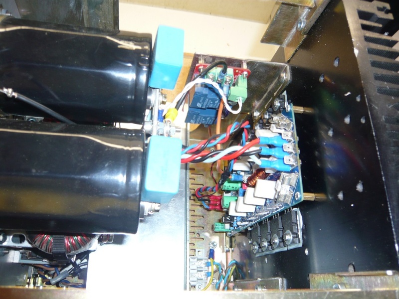

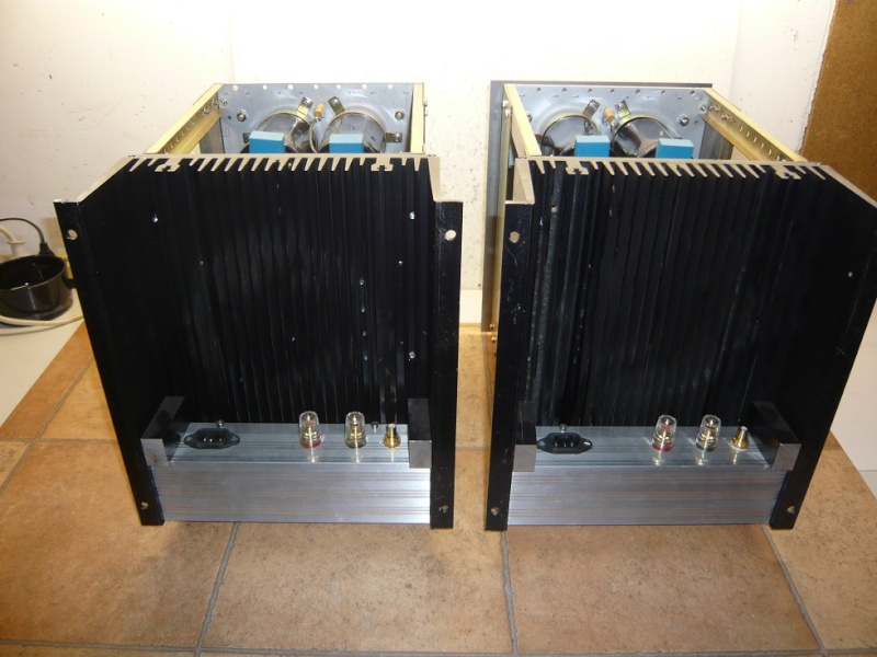

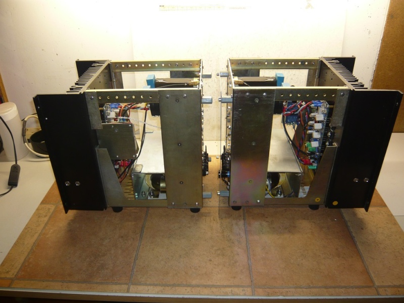

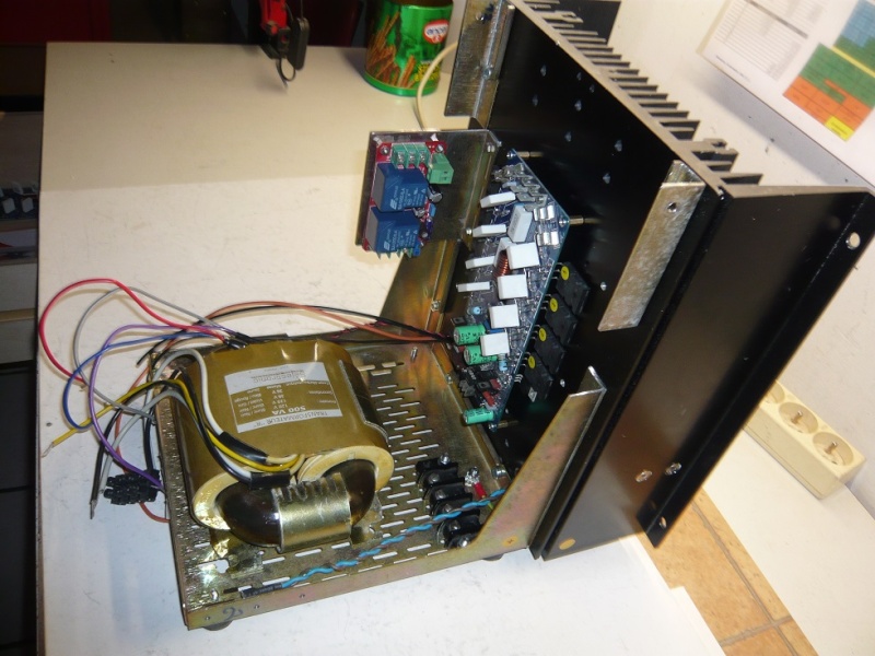

After six years on the shelf, I finally found some time to do some more work on this project.
I started out with preparing the heatsinks. I drilled all of the holes on the milling machine for accuracy and followed each hole with a thread forming tap. Rather than cutting the threads, I favour thread forming for small diameter holes in aluminium. These are all M3 holes some of which will need some decent torque on them, so they are at least 20mm deep.
The next thing to do was to develop a jig for bending the leads on the output transistors accurately and consistently.
Using a scrap piece of 25.4mm square aluminium I cut a pocket out to accommodate the body of the transistor with a step at the end at the correct length for the bend. The height of the step also needs to be sufficient to support the leads at the base of the package as they are bent over.

Hello folks ,
here is my contribution , ( at least ! )
I built 2 MONOblocks oh this amp , as you can see on the following pictures:
[/url]
[/url]
[/url]
[/url]
[/url]
[/url]
[/url]
Sounds very nice !
@ + Philippe .
Sounds very nice !
@ + Philippe .
