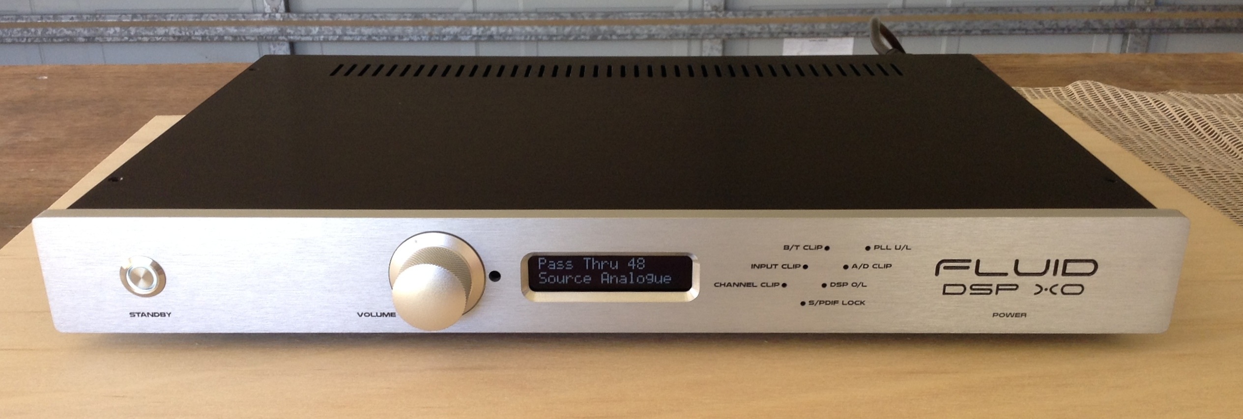

This is my version of it in a custom made chassis.

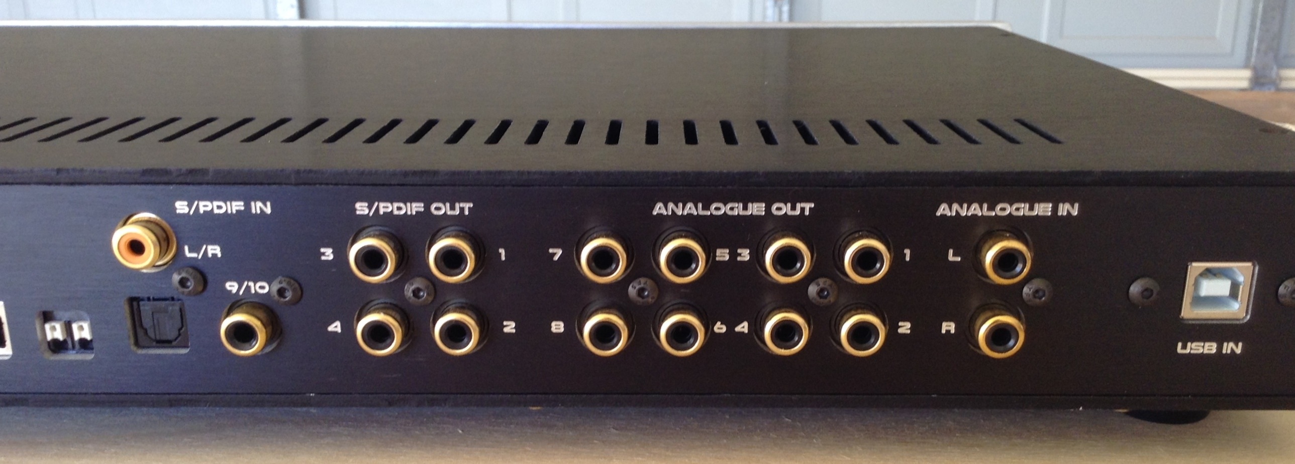

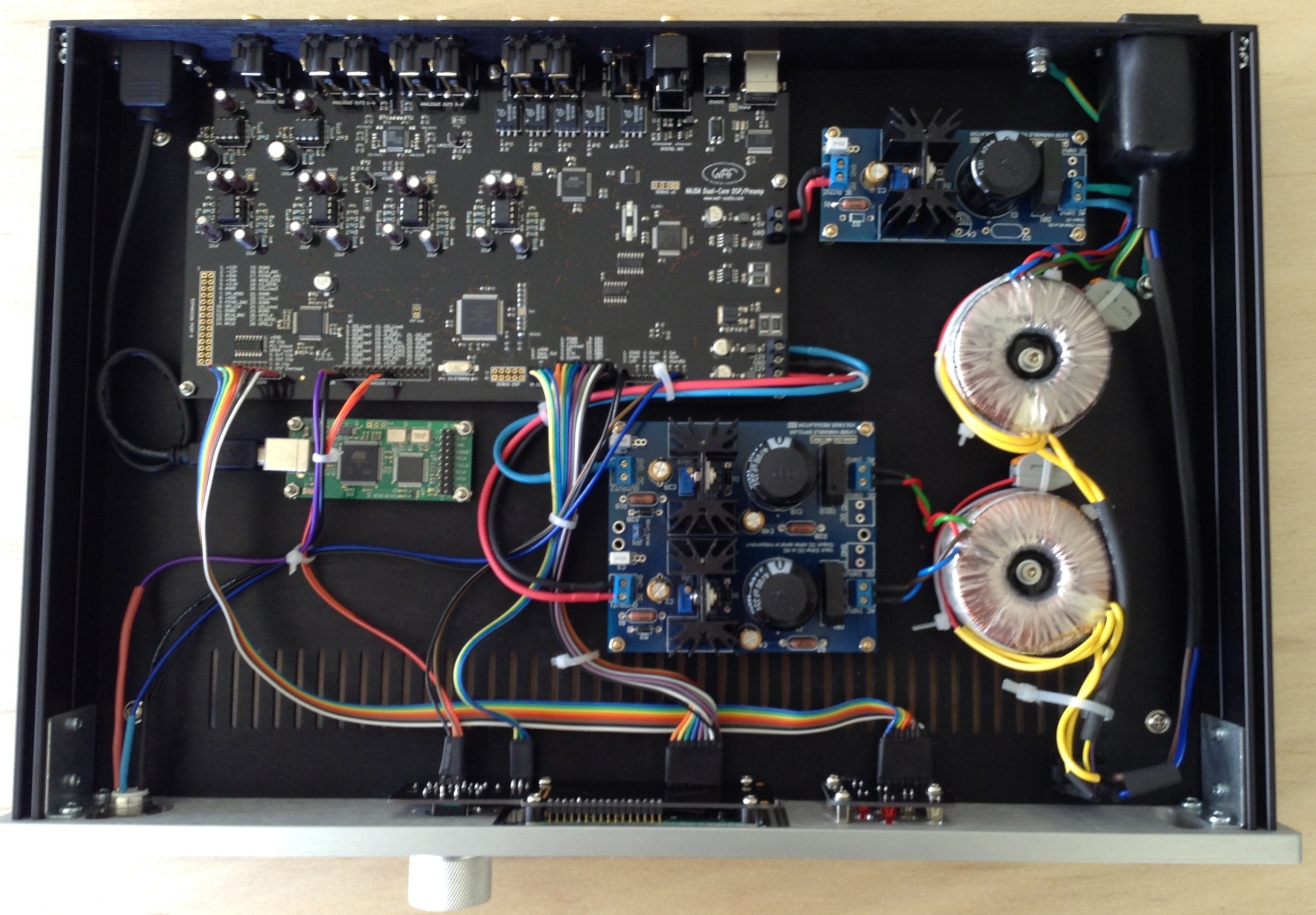

Hi Fluid
Your cabinet work is beautiful! On quick inspection, it appears that the analogue outputs are RCA only and I would prefer balanced, to accommodate the Yamaha P2200 driving the Plannar tweeters, and Crest CA-18, driving 18 inch RCF bass cabinets. The Saffire seems more of a recording studio tool at first glance but I will investigate further, thanks.

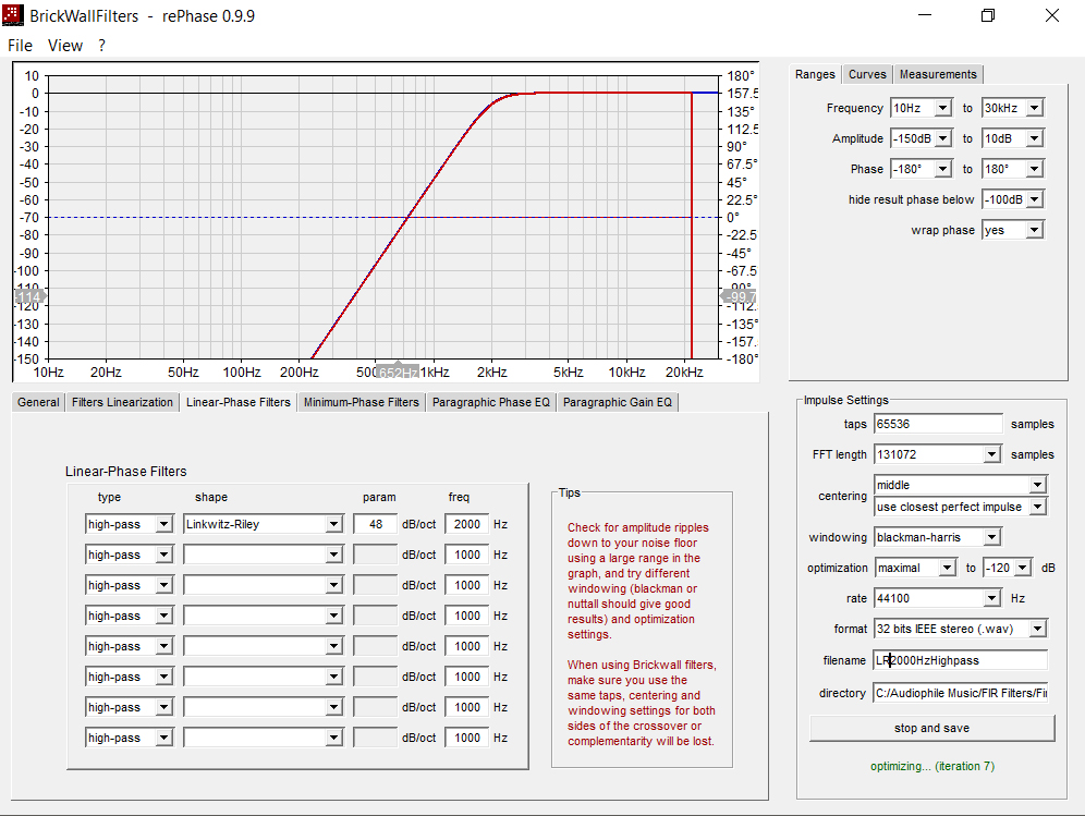

tip of the iceberg with FIR processing...
Peter,
I know You are starting to dig into the digital realm. I do not know how deep You have dug into the possibilities of IIR and FIR processing. What I can mention, is with FIR processing, You can create 48dB/octave cross-over filters that are phase linear. You can also create brickwall cross-overs. To give You an idea of what these look like, I have included two screen shots from rePhase.
The solid red line shows the curves of the cross-over filters, and the dotted line shows the phase.
Whether or not You will prefer the sound of linear phase filters will depend your own listening preference. But, as You can see, You can create cross-overs that have no overlap at all with Brickwall filters. Just some food for thought, as You research different devices. 😀
There is a lot You can do, I myself have just scratched the surface. 😉

Thanks, it came out very nice. Yes the Najda has single ended output. I use it with balanced Hypex amps and use single ended to balanced cables (very easy to make). This works really well and still achieves 40dB of common mode noise rejection. The balanced input is the most important part and you already have that. The main benefits of a balanced output and input are the higher signal voltage level and increased noise immunity. Neither of these are necessary in a home setup. The Najda can put out 6V over the RCA due to it's analogue volume chip that has 15dB of boost, although I would be surprised if you ever need more than 1 to 1.5V. With mine set at 1.5V even with 15dB of cut due to the EQ I am using I cannot tolerate the volume at 0dB for more than a few seconds.

Please be aware that FIR processing is not without it's tradeoffs too. Lots of people post as if it is magical and can do anything without penalty. The downsides to FIR processing are latency as wesayso mentioned but also pre-ringing. When you look at an impulse response that has FIR processing you will often see activity before the main impulse peak. If the measurement was taken properly then this is the pre-ringing from the FIR filter. There is much debate on how much pre-ringing is audible but if you get enough of it then the sound can be unnatural and 'weird'. In nature you can't hear something before it starts if that makes sense.
The latency comes from the number of taps that the filter uses, more taps = more latency. In order to process low frequencies you need more taps, so an FIR filter used at low frequencies will need a lot of taps for correct response and will have a lot of latency. Most computers using Brute FIR or Jriver will be able to process a very large number of taps, the minidsp or other hardware based systems will often have a limited number of taps available so you may not be able to realise everything you want with them.
Digital IIR EQ is not linear phase so when you use it you will have a corresponding change in phase, this can be helpful as when you flatten your frequency response you also tend to flatten your phase response.
You can avoid pre-ringing in an FIR filter if you use it only to change phase and not amplitude. So by using IIR EQ to change your frequency response and then use FIR to undo the phase turn from your crossover or other EQ you can get the frequency response and the phase response you want without pre-ringing.
I really don't understand the use of linear phase crossovers. You can get a better result from a standard crossover and then use rephase to fix the phase to whatever you want.
Also you do not need FIR processing to get steep crossover slopes. The steepness of the slope is limited by the software that you use but it is easy to cascade filters to achieve a steeper slope, i.e. use 2 x 24dB/oct filters at the same frequency and you get a 48dB/oct slope.

I agree but in the context of speaker crossovers and the kinds of processors being discussed FIR filters are generally being used with linear phase. For a simple crossover slope or parametric EQ seems like a lot of effort to make an FIR filter that includes phase shift.FIR filters can be built with zero pre-ringing, this is not an inherent 'feature' of FIR. Rather its an inherent feature of linear-phase filters. If the pre-ringing is at an ultrasonic frequency then its unlikely to be audible.
If you are trying to make a very specific filter that is difficult to achieve with IIR then this makes sense.Perhaps this is one way to avoid pre-ringing, but this isn't the only way. Just don't ask your FIR filters to be linear phase and the pre-ringing goes away.
IIR is not lessor than FIR it is just different. IIR EQ requires much less processing power so it is more efficient to use if it does what you need. Analogue and digital EQ is not really any different either, one is a digital representation of the other. FIR offers the ability to create filters that are either impossible or very difficult to achieve in the analogue domain.PPS: The issue of FIR filtering or IIR, again something beyond me, at this point, I have to ask; even with the apparently lesser form (IIR) how bad is it compared to phase shifts or ringing issues caused by conventional graphic equalizers?
Most speakers have significant phase shift due to the crossovers used and sound just fine.
The reason I have tried my best to explain it is that in order to improve the time response / transient response FIR filters are being used to correct the impulse response. This is really the last stage in perfecting any speaker design, some really believe in the importance of a time coherent speaker, others couldn't care less. With the availability of DSP and programs like rephase it is now much easier to achieve so why not?

As far as digital inputs (attached image) there are three types. Am I correct to assume that I could connect multiple inputs and switch between them?
