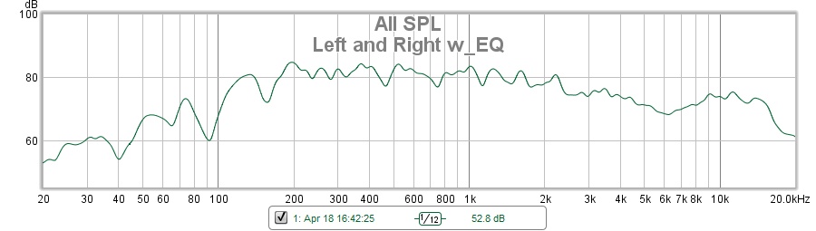

I very much agree with Wesayso...start with just examining SPL.
Try to get a sense of overall tonal balance, and big valleys and hill tops in response.
Move the mic around, and see if the frequency of sharp dips changes...this will help you determine where reflections are coming from. Either fix those dips with speaker placement, or room treatments etc, or ignore them.
Big valleys and hill tops that show up everywhere you measure... go ahead and try to EQ with PEQs. Stay broad.
Same with tonal balance...go ahead, perhaps using high and low shelving
I wouldn't even look at other measurements, unless they help you understand the SPL curve, until you have the SPL curve looking good enough to say, hmmm, what next? Good luck !

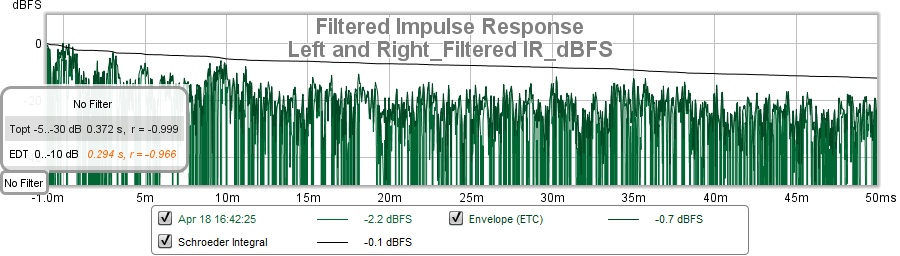

Start by saving these graphs a bit bigger, plot the SPL graps with 5 dB division on the scale to the left of the graph, leave phase out for now and smooth them to, let's say 1/12. Make the top 100 dB (limits button), bottom 45 dB, left is 20 Hz, right is 20000 Hz. Save them to about 900 pixels image width to have a readable graph.

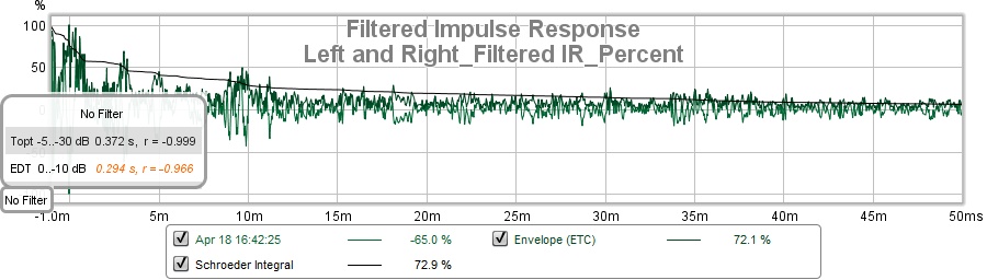

Here is the SPL graph as well as the IR Filtered in dbFS and %. This is from a new measurement after moving them with left and right together...

Not quite what I was hoping to see. First a question, why do we get such a strange ratio oh graph height to width? This way we still make huge jumps between the values at the left that represents the dB scale.
I'd expect to see a screen filling graph in REW. With about a 5 dB division between the numbers. Any reason for it being this wide compared to its height? Its kinda likecwatching this stuff on an ultra wide screen right now :).
It seems we do see a very strong reflection. Usually we see a peak at zero.
After that peak there should be a drop, followed by the slope of arrivals. The bigger that drop, the less reflections we have (good!). Here we have reflections as high as the first peak. It doesn't help that the top end is down in SPL level, but your earlier graphs did show that peak, a healthy drop and that slope I mentioned.
(be sure to set the left boundary to - 0.001 s so we see that peak more clearly)
Edit: looking more closely (I'm on a phone) I do see it is at -0.001. However the main peak doesn't look centered at the 0 (zero) mark.
Now that makes me curious about what happens on the left. Setting it to -0.010 might show us that.
I'm sorry, I moved but the speakers and the microphone. The microphone was at the couch which is further back from the original measurements.

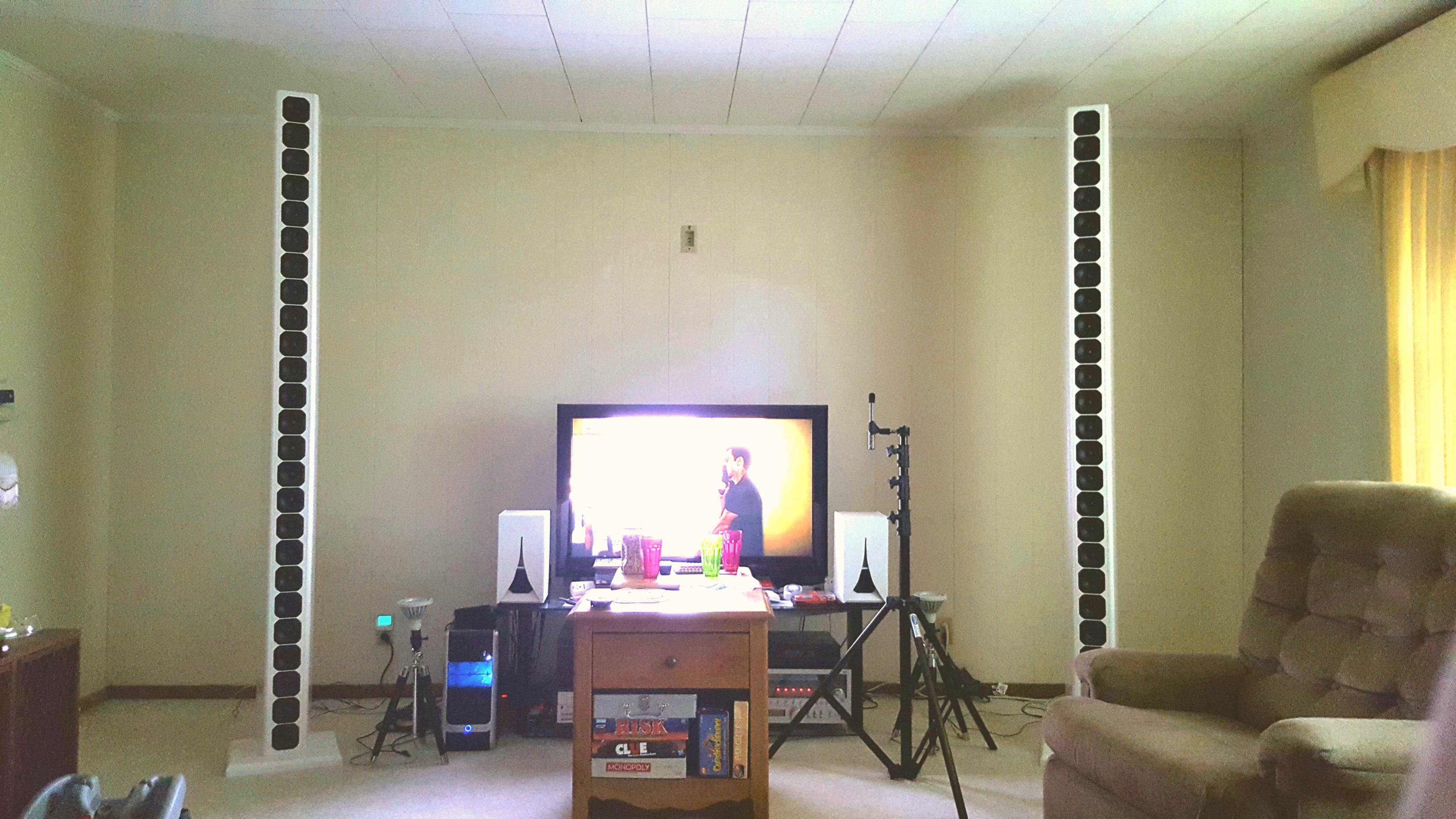

My end goal is to be able to listen from my couch 3/4th into the room (current measurements). My original measurements are from a listening chair 1/3rd into the room.
It looks like the room is the problem, which I can't address right away. Should I eq for the 1/3 seating position or the 3/4th position?
A few posts ago I was struggling with getting a center image from the arrays. I've had great experience with point source speaker after placement, toe-in, and light rake. I had tried tow-in with the arrays and still didn't have center imaging. Don't get me wrong, they sounded amazing.
I figured it out. I had to toe them in further to around 45 degrees (which I find extreme) and I finally have it!

This is the current placement of the speakers and what the latest measurements. I'll try to get new measurements tonight from the closer listening position. It should clear up the impulse plot.
Don't go for the closer listening position. A little distance can be a good thing with these arrays. If you can't eliminate the reflections, we can use some tools/options to go around that. I bet you're going to be thrilled once we add a little adjustment.
Unless your closer listening position is your favorite.
Can we tell from the impulse plot which of the two is the worst offender: first reflection or rear wall behind couch? There is half wall behind the couch forming a hallway to the front door.
