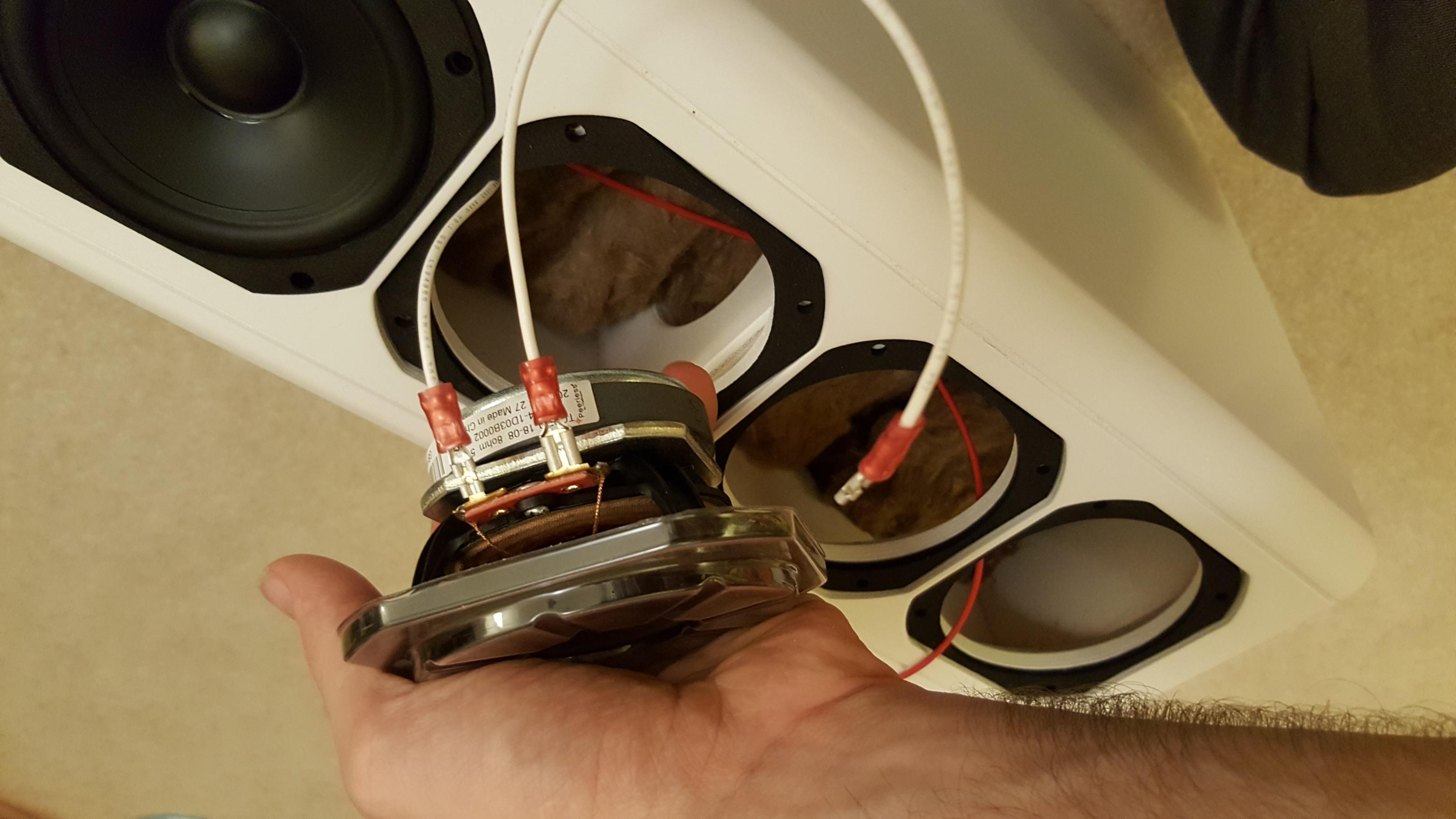

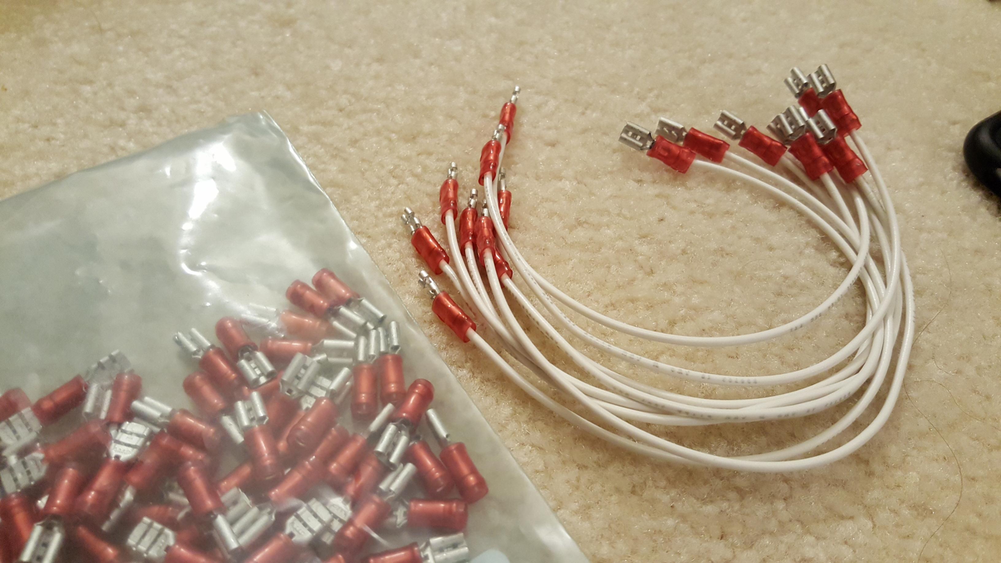

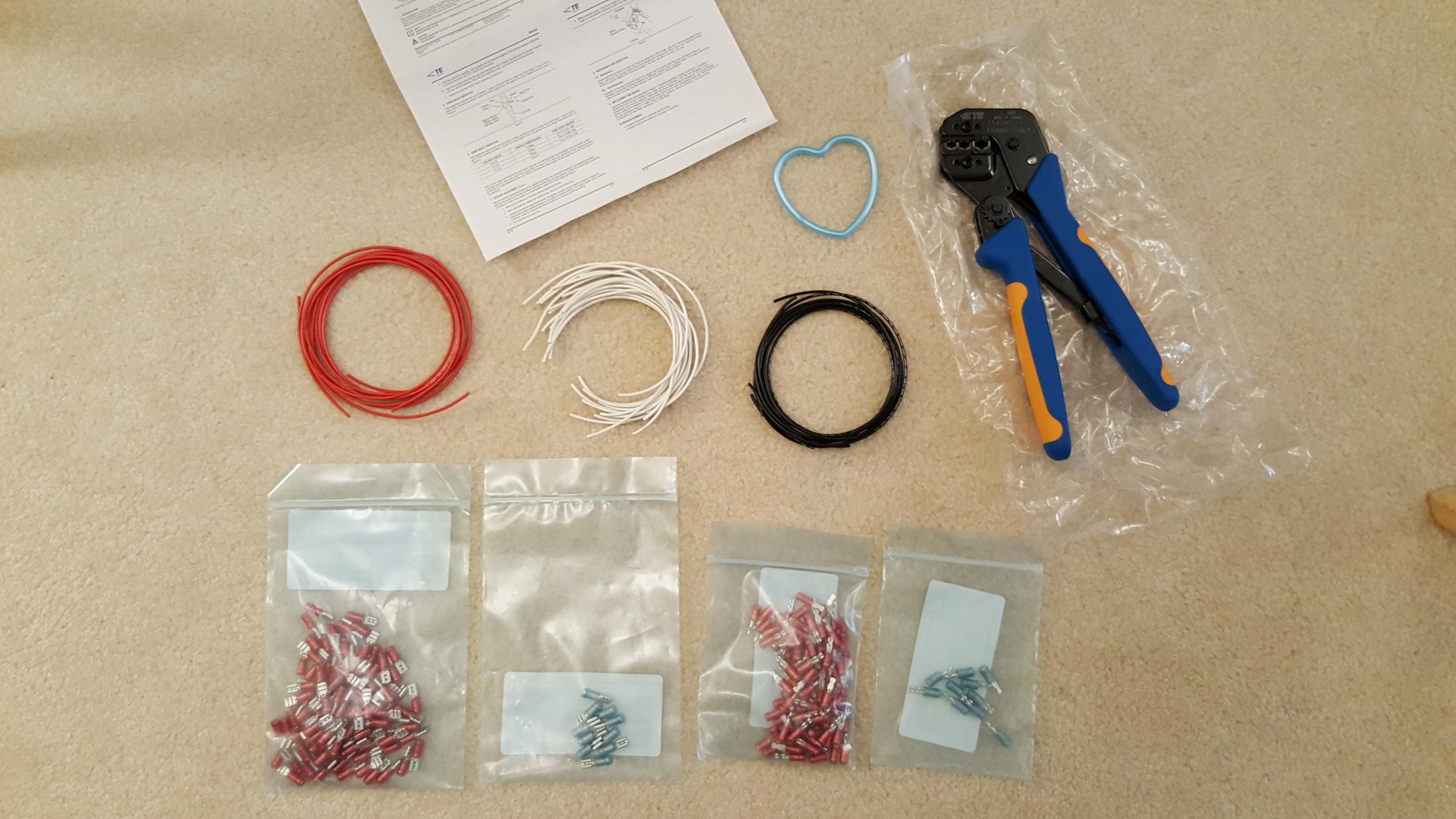

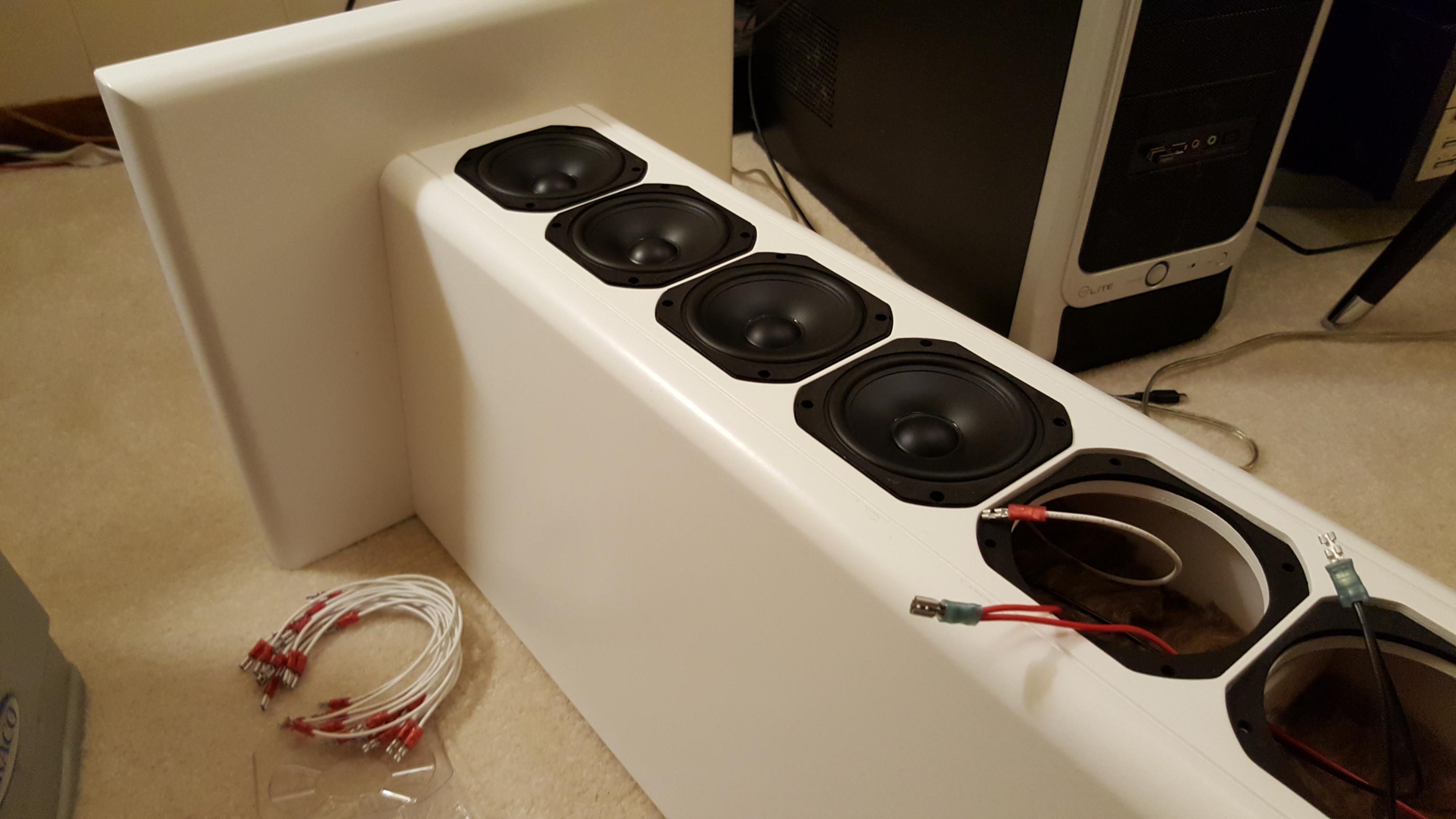

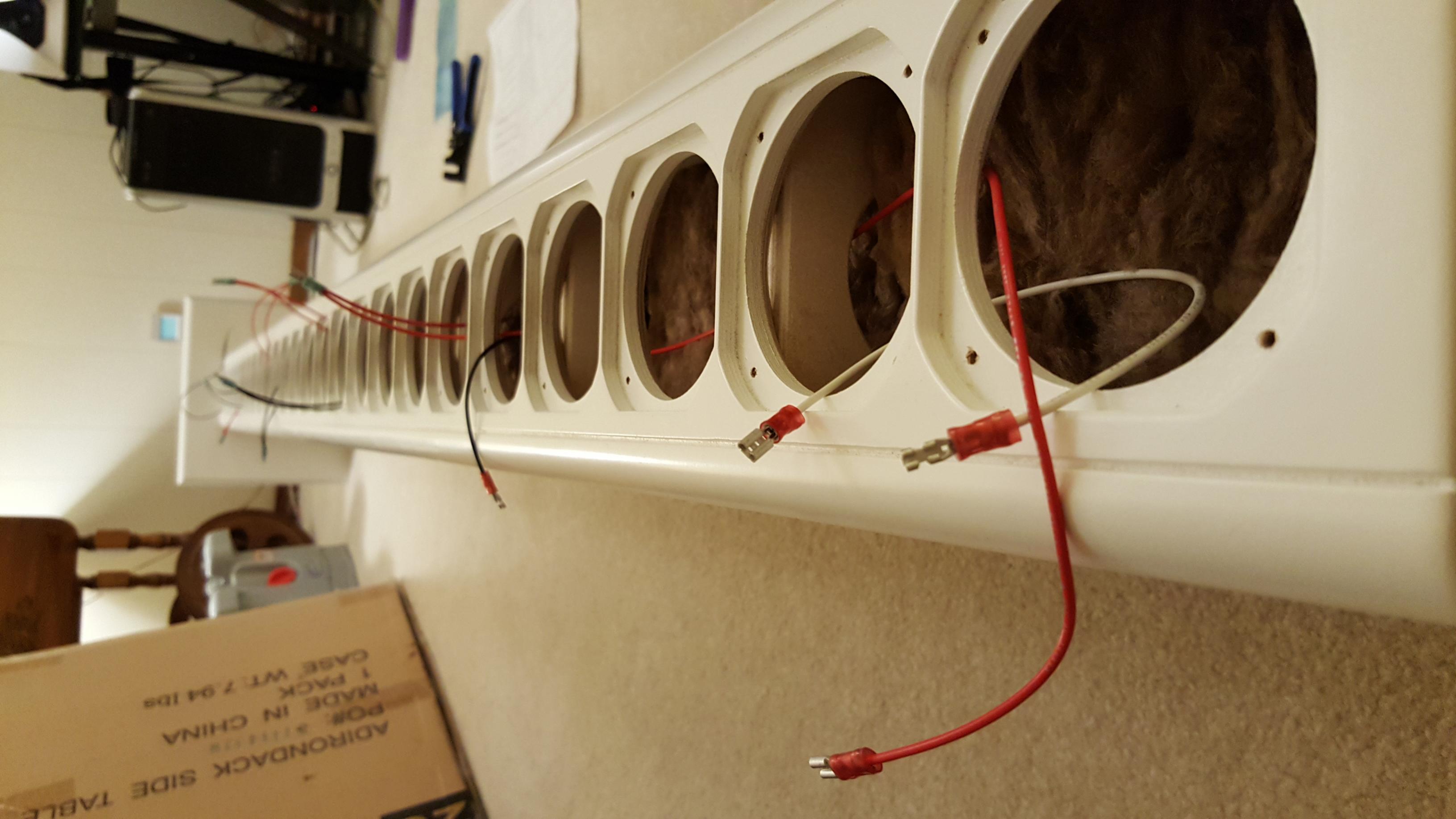

I chose not to solder the wiring as I'm too new to it. Instead I chose to use a quality crimping tool with quick disconnects that match the die set in the crimper. The crimper from TE Connectivity was $120 but completely worth it.

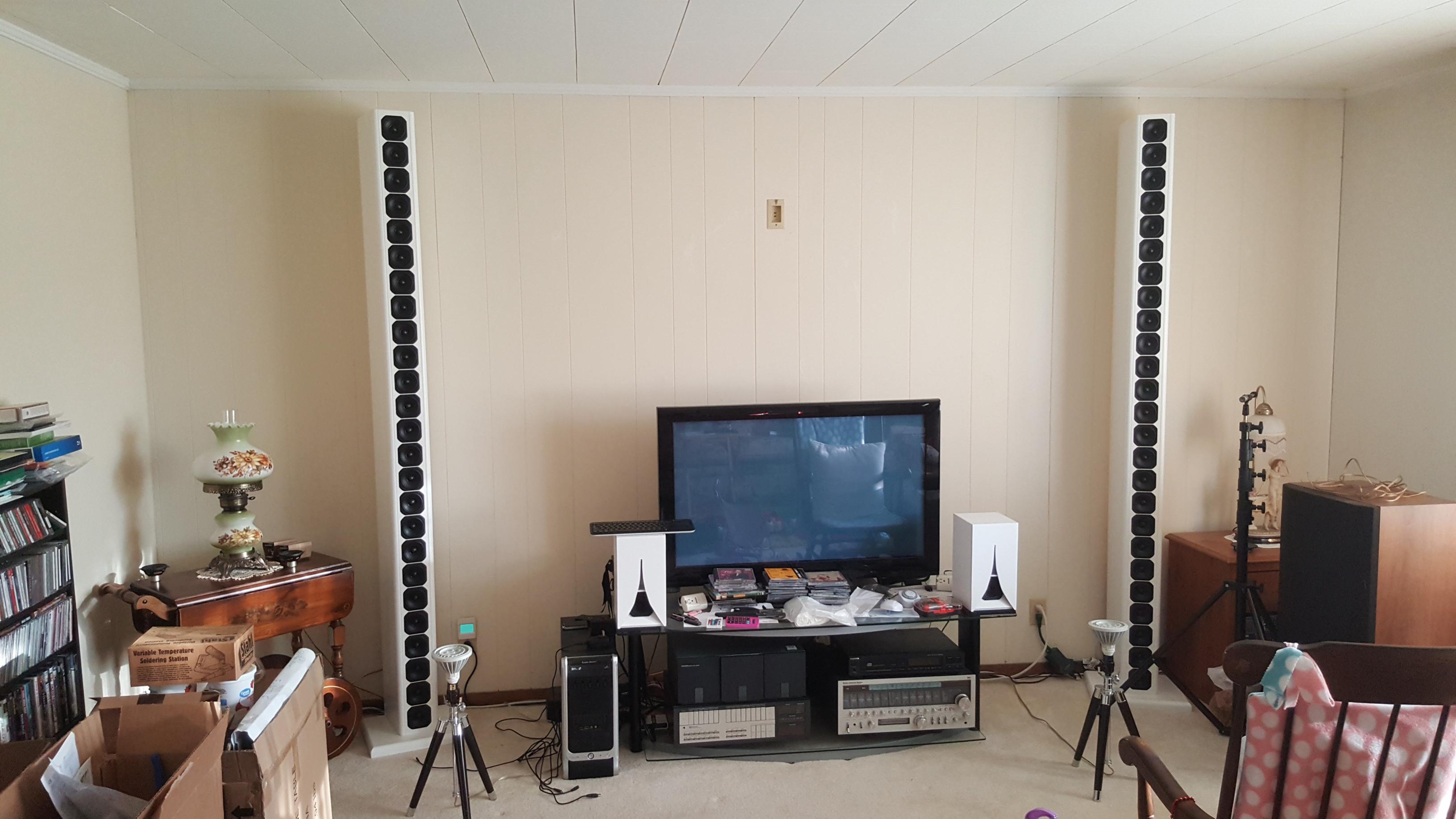

Phantom Center Image
A few posts ago I was struggling with getting a center image from the arrays. I've had great experience with point source speaker after placement, toe-in, and light rake. I had tried tow-in with the arrays and still didn't have center imaging. Don't get me wrong, they sounded amazing.
I figured it out. I had to toe them in further to around 45 degrees (which I find extreme) and I finally have it!

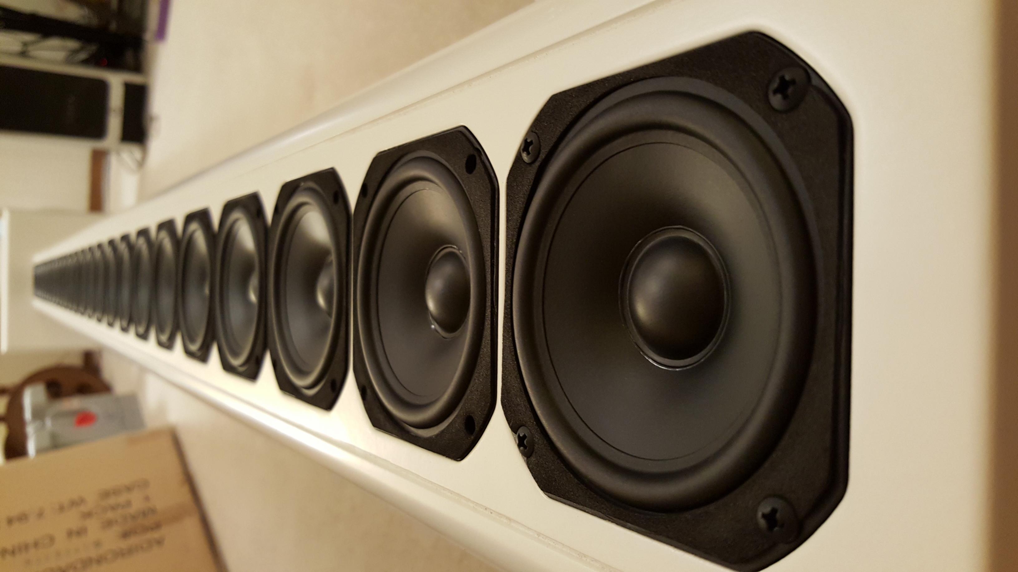

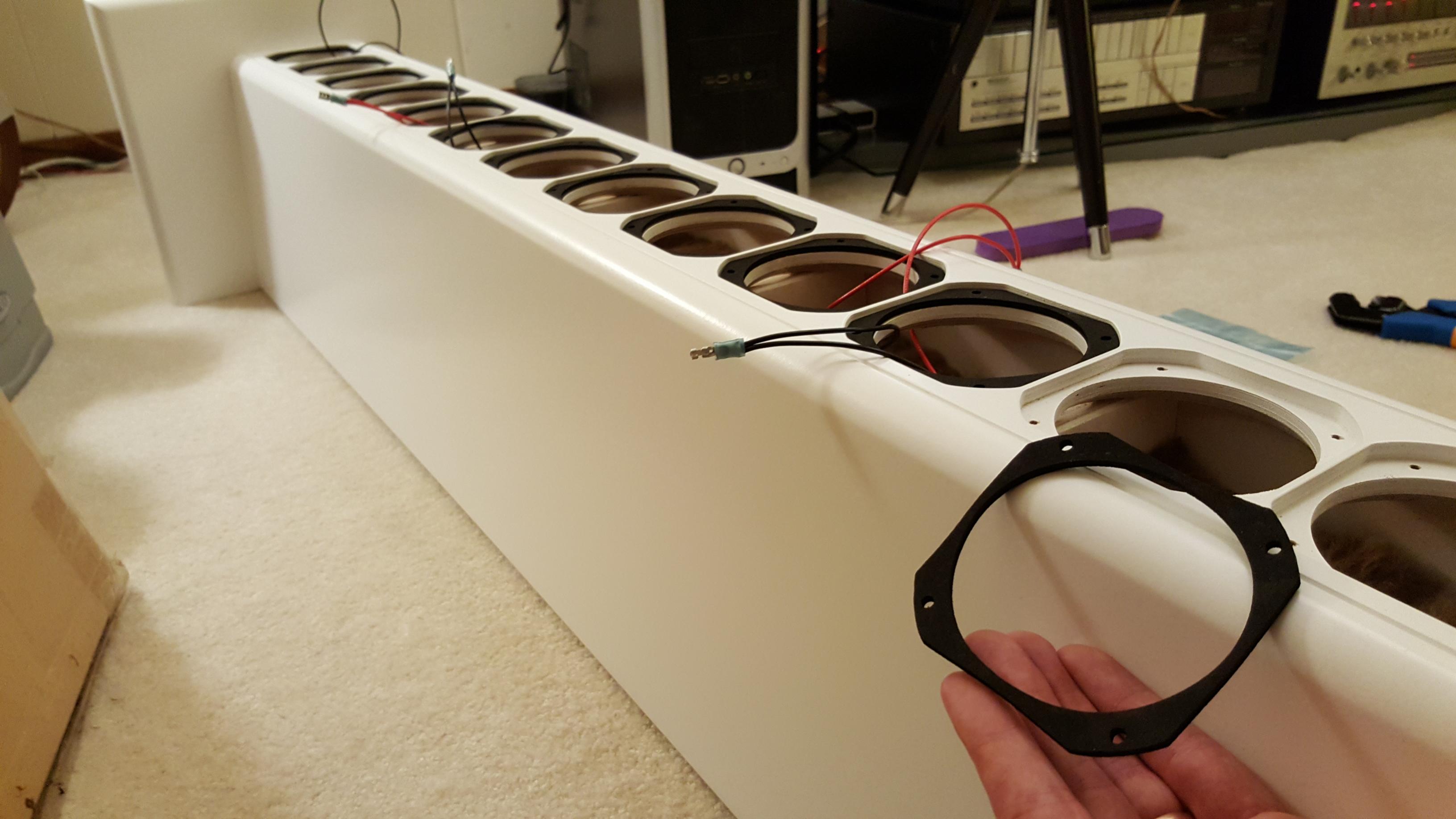

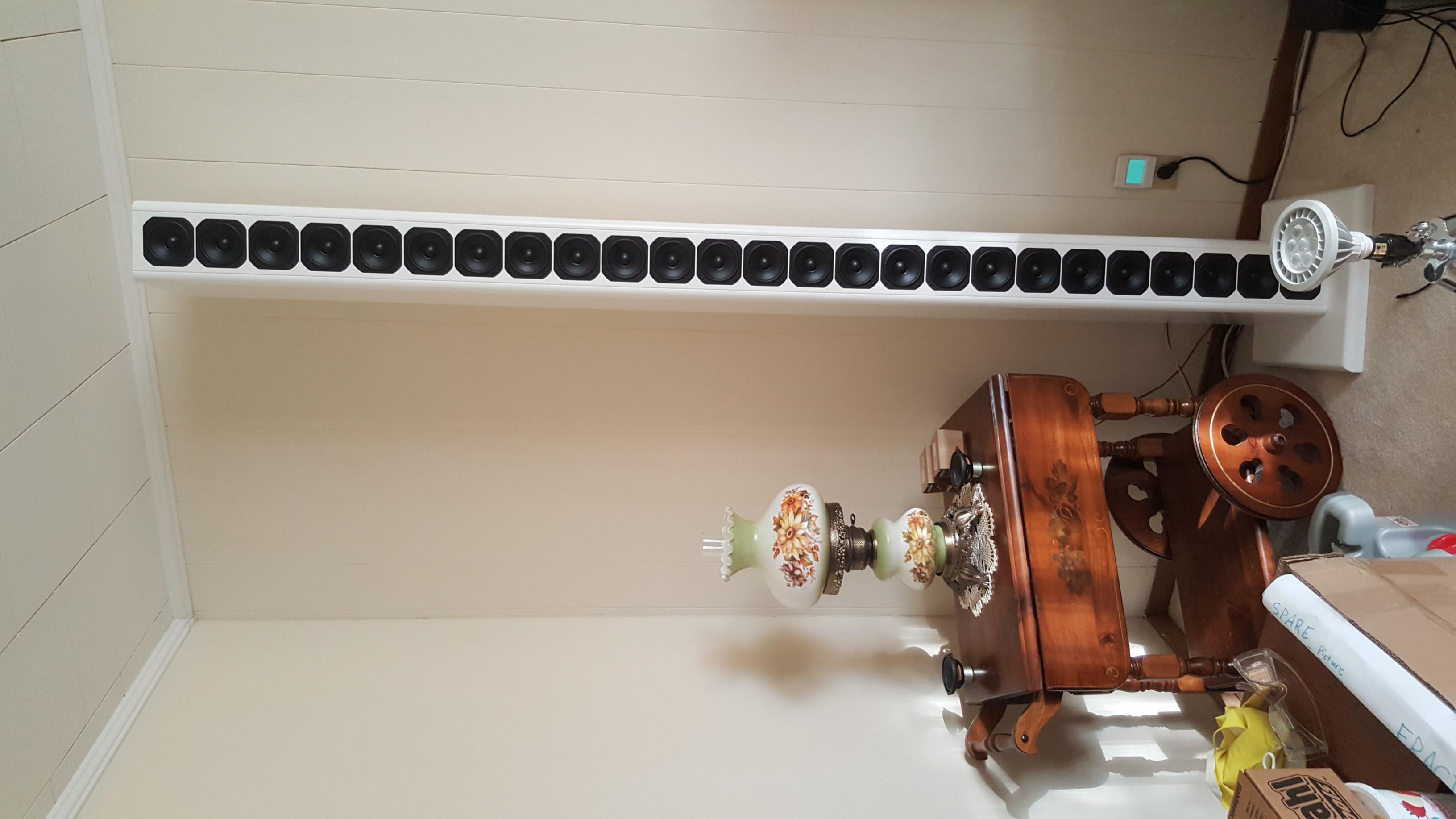

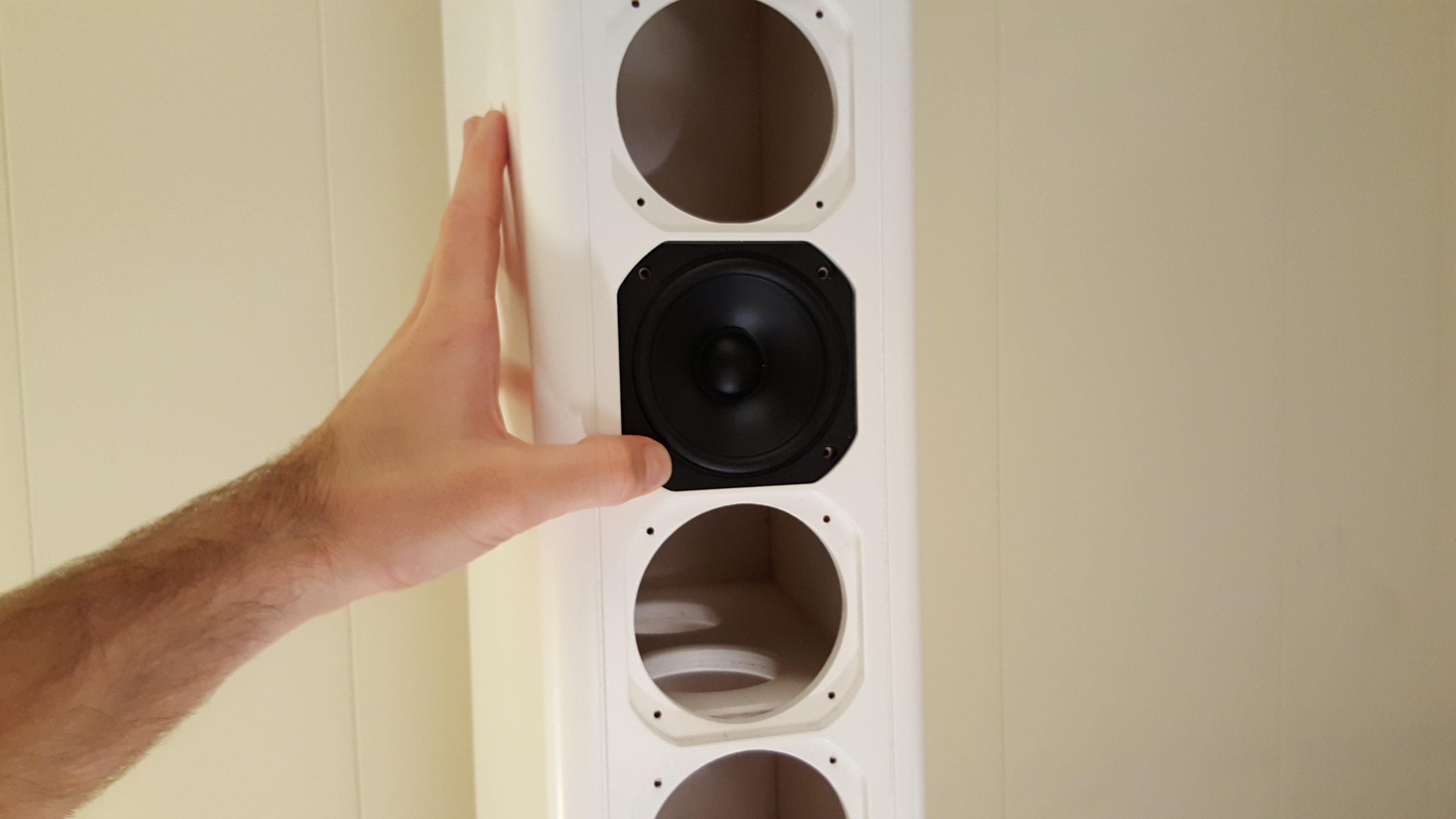

With mine, there is a slight gap between each driver that is fragile because of the flush mounting. When prototyping it, I could break it off with my fingers. Doing it by hand, that part might break off.
Flush mounting, for me, was well worth it for aesthetics and hopefully helps with difraction. You all would have to tell me if that actually works at reducing diffraction though.

I must say you did a fine job with these. Very neat, clear and the white color does seem to hide them a bit better than my "flashy" setup.
I see you have a couple of questions. First one was about imaging... you did find a solution with toe-in. The more interesting thing would be to see how this setup with that ~45 degree toe-in measures at the listening position compared to the previous position. Then we start to learn something from it 🙂.
I can guess, but that's no good. Seeing the differences brings us more usable data. Basic imaging is getting the left and right clean in the first few milliseconds and have the same balance left and right. The longer your reflection free zone becomes, the stronger and more clear/precise the imaging becomes. But you've got to know what you want. When I took all the early reflections out, some of the excitement the arrays used to have disappeared too.
