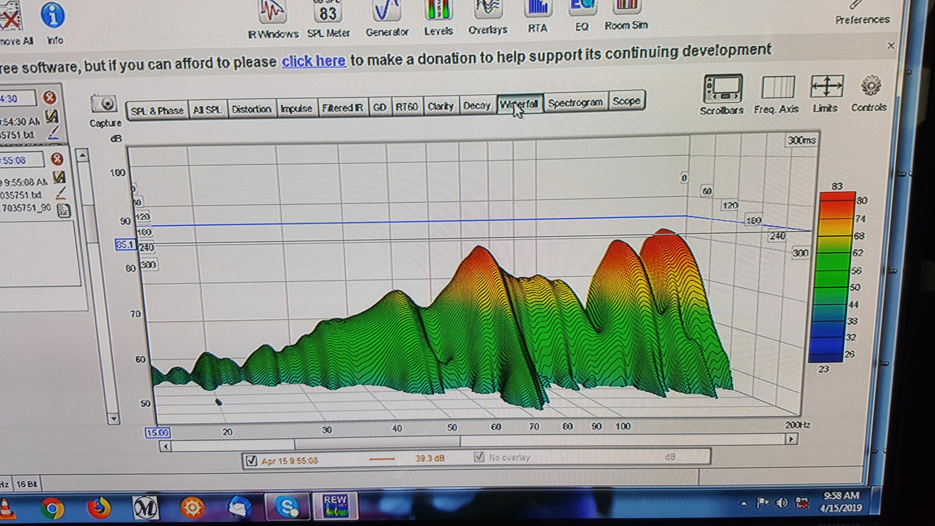

Attached is a previous attempt at equalizing in REW. I am struggling to get the low end up. Sorry for the poor photo quality.

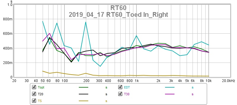

I'll be posting the measurements. Attached is my microphone setup.

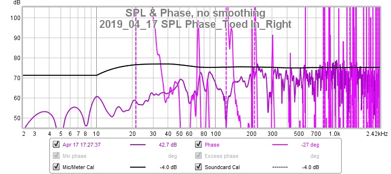

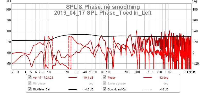

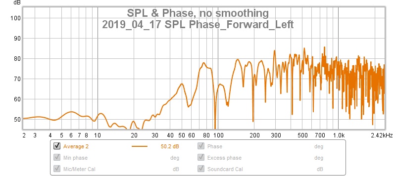

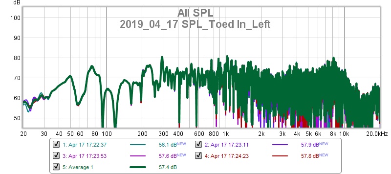

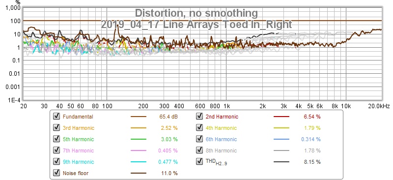

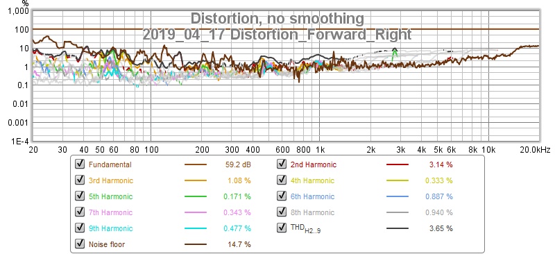

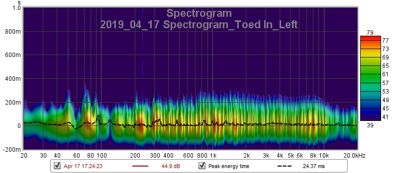

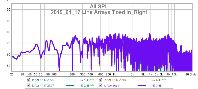

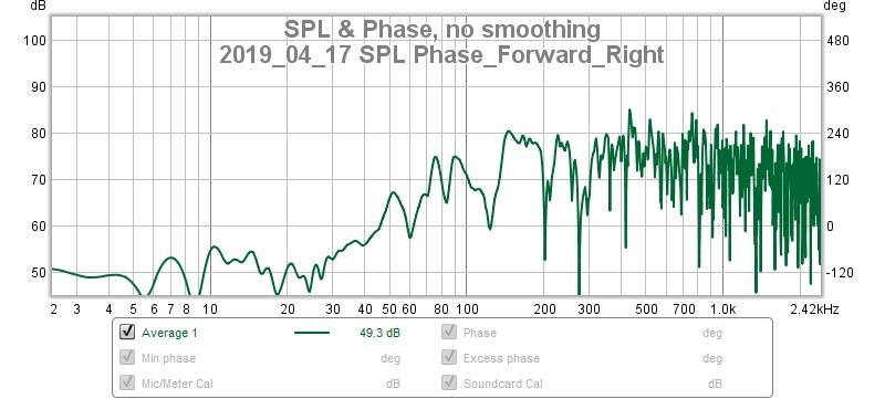

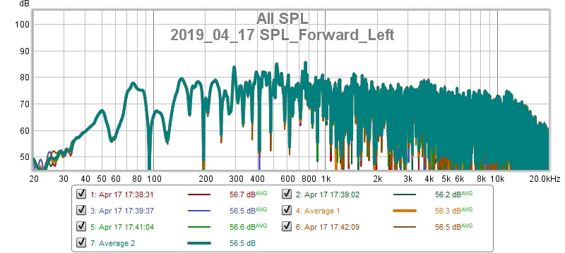

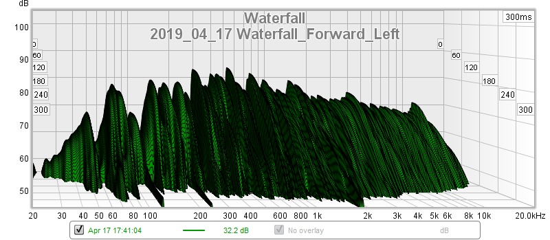

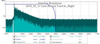

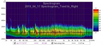

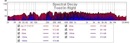

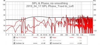

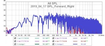

REW Measurements

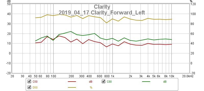

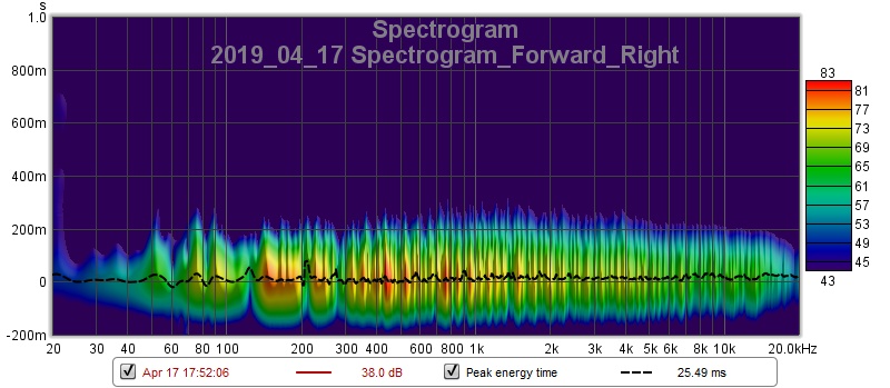

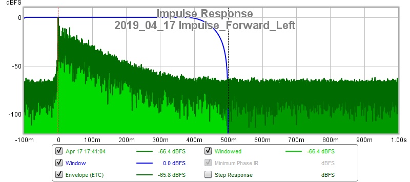

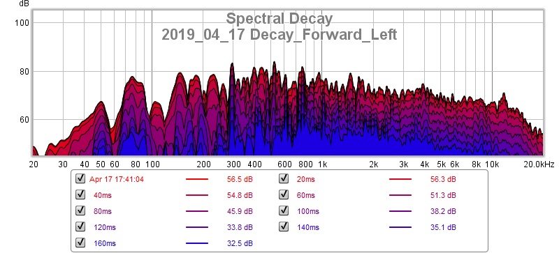

These are measurements of both the left and right speaker both toed in and faced forwards.
SPL & Phase:

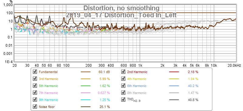

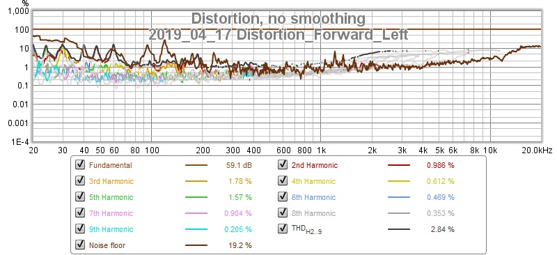

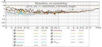

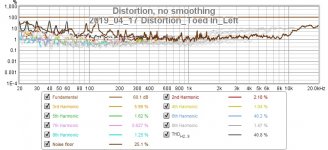

REW Measurements
Distortion

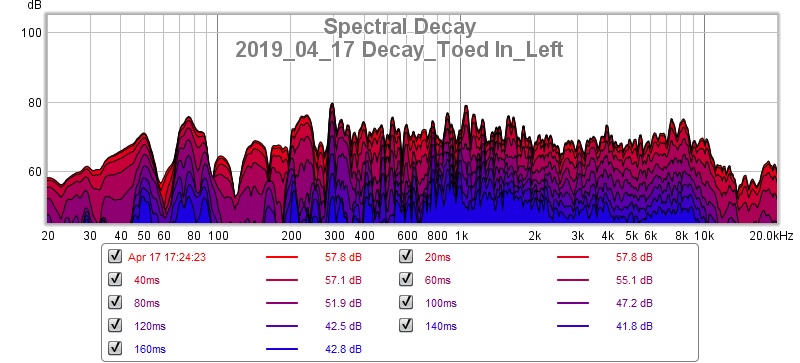

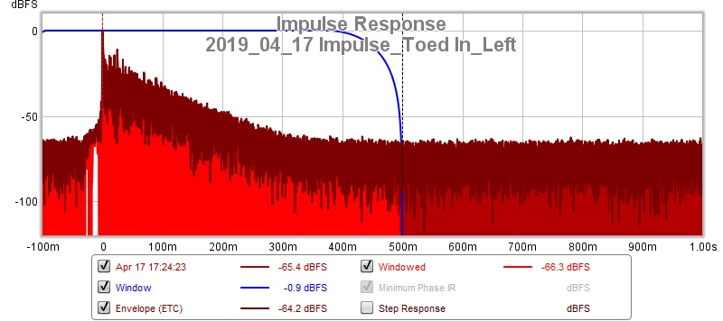

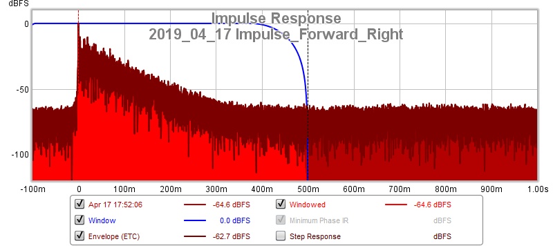

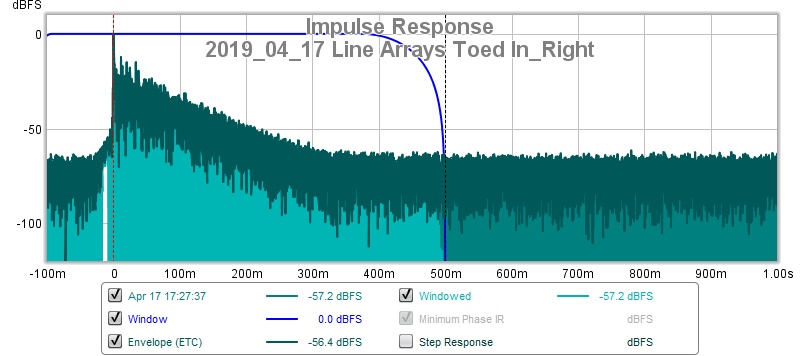

REW Measurements
Impulse

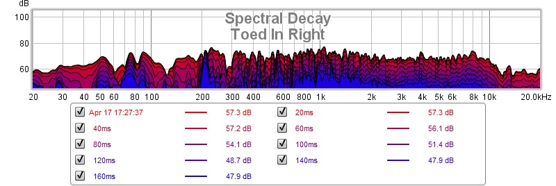

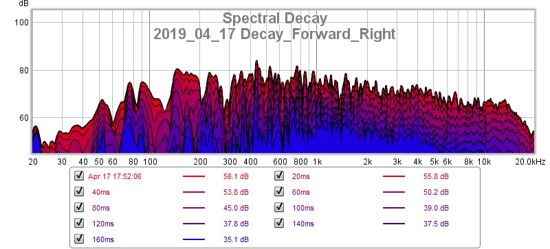

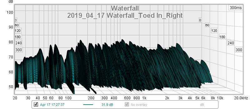

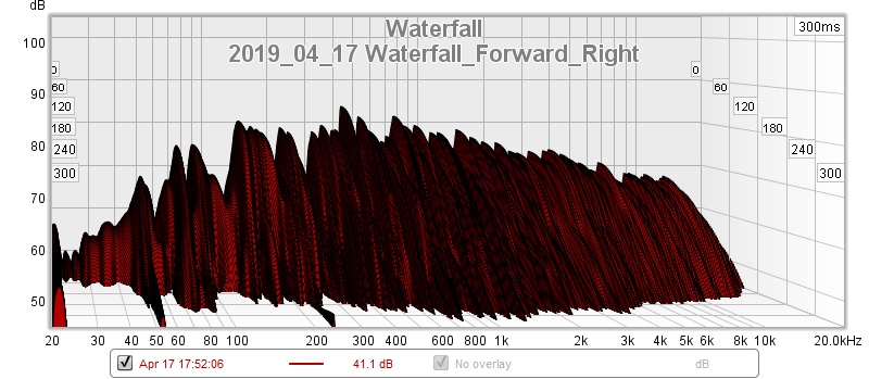

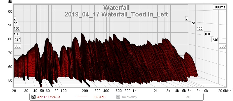

REW Measurements
Waterfall

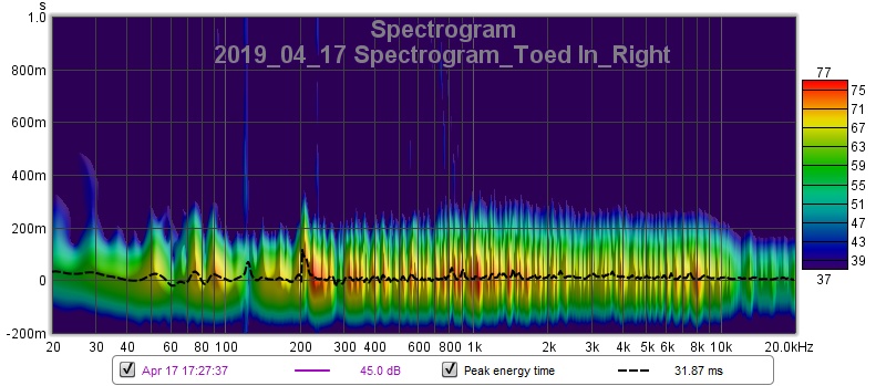

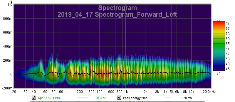

REW Measurements
Spectrogram

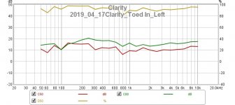

REW Measurements

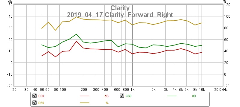

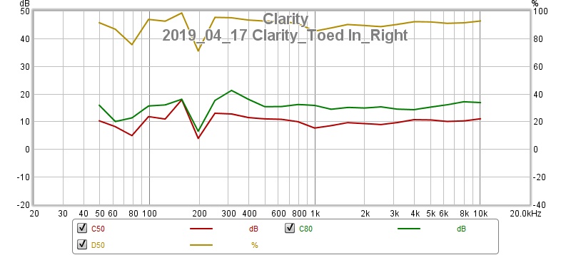

Clarity

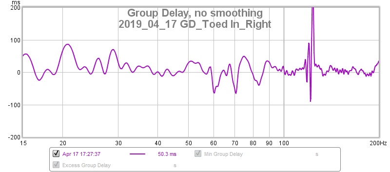

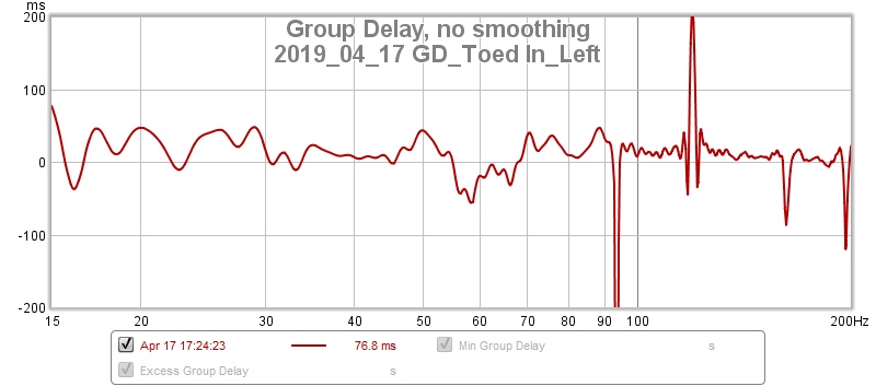

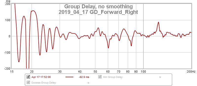

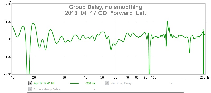

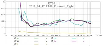

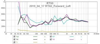

That's a lot of data right there 🙂.
Even if we do see some differences, it is kind of hard to make something out of it right?
We need to "zoom in" in order for these plots to tell us something.
Are these measurements raw without EQ? The reason I ask is because of the general trends of the array being visible and the distortion graphs look funny to me.
I bet things will start to improve with some help. I see a rising distortion, even on the top end and do not see that trend in my setup, not even from my raw measurements. But my "raw" measurements almost always include some basic EQ to get a reasonably straight FR curve. I haven't done a real raw measurement in ages. It is some pré EQ I use to get it ready for further processing.
I think if we EQ the lines, the distortion graph will look a lot better.
First we might want to look more closely at these graphs. Use the limit button (upper right corner) to get the graphs more in proportion/scale and zoom in a little here and there.
I haven't got the time to go trough them one by one right now.
Start by saving these graphs a bit bigger, plot the SPL graps with 5 dB division on the scale to the left of the graph, leave phase out for now and smooth them to, let's say 1/12. Make the top 100 dB (limits button), bottom 45 dB, left is 20 Hz, right is 20000 Hz. Save them to about 900 pixels image width to have a readable graph.
At least we get to see a general FR trend that way. One thing is clear, the toe-in has a rather different balance than the face front setup. It also interacts differently with the room. That much we can see right now.
After that plot let's look at the IR's, your plots are in dBFS, nothing wrong with that to see the strength of reflections but we need a closer look.
Push the limit button, set it to dBFS Top: 10, dBFS bottom -50, Left s -0.001 and Right s to 0,050. Let's see the graphs from both setup's that way.
Next on the left side inside the graph, you can set it to % instead of dBFS.
On that graph change the Right s to 0,020 and plot all graphs like that.
Those will do for now, lets first see the balance, we might want to change that.
So no new measurements at this point, just a different view on what you've got here.
Got to run now, hope to get back to you later tonight. I'm sure there are others that can help, feel free to jump in. 🙂

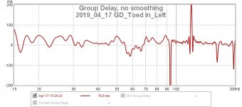

You're right about the distortion, it seems too high. The frequency response also has a strange dip around 120hz.
I've felt that the speakers have sounded fatiguing but I just attributed this the them being line arrays. It may be due to the distortion and frequency dip (and maybe first reflections?).
