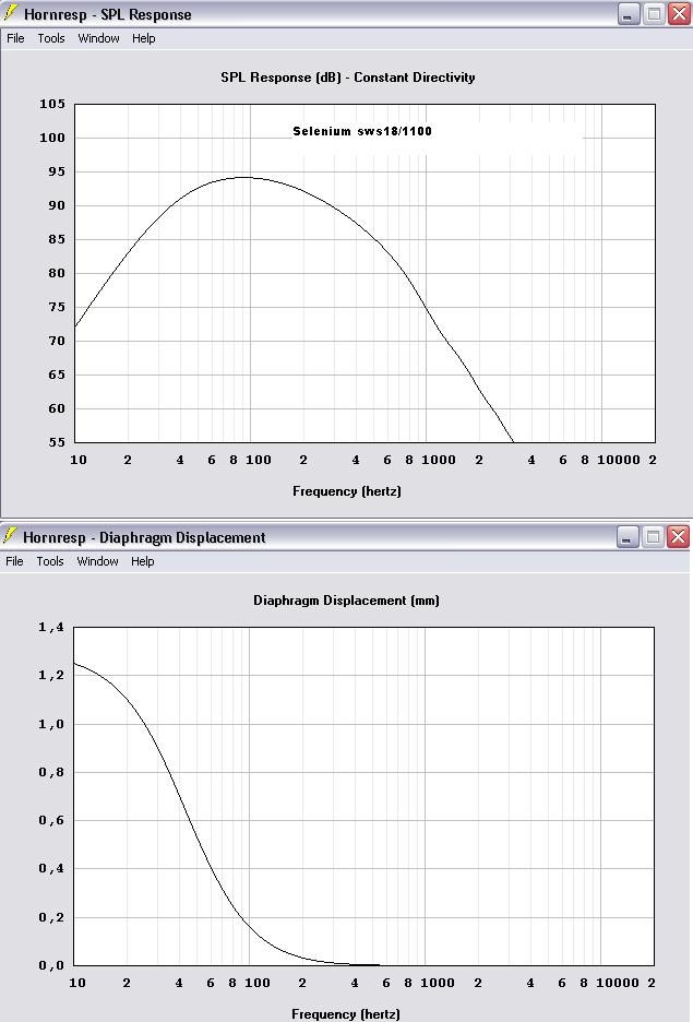

What about 21" and a xmax of 15mm. 1734*1,5= 2601cm^3.
http://www.speakerstore.nl/luidsprekers/Beyma/pdf/21SW1600Nd.pdf
I have eight of those, and they can really flap your pants down to 20 Hz even in open baffle.

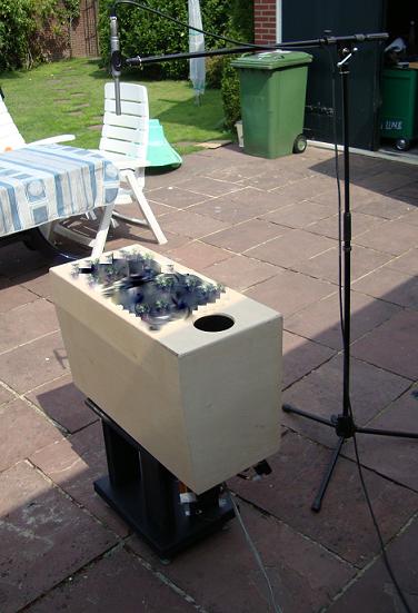

Most long sequence. A measurement technique to measure loudspeakers without reflectoin playing a rol in the measurement.
http://www.audiomatica.com/download/cliomls.pdf
Here I do a MLS measurement outside on myb latest project, because I want to use a long gate(170msec) to see the sub-bass.
Blueline is the phase response.
The grafic shows the basreflex tuning at 30Hz and the decrement of the radiated power of the woofer.
1/170msec= 5,8Hz
1/170msec= 5,8Hz
1/170msec= 5,8Hz

that red line looks like somethink I'dlike the achieve, I dont have a clue about the blue line, looks very messy, but my guess is its not, still working that one out.
The blue line is very ok. But due the long gate 170msec It measures some reflections of the sound on the baflle.
So it shout be a tight line sawtooht shape. Every fast change of the phase has distrosion as cause. Like lineair distrosion due reflections.
