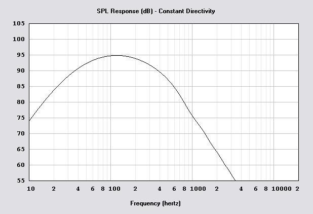

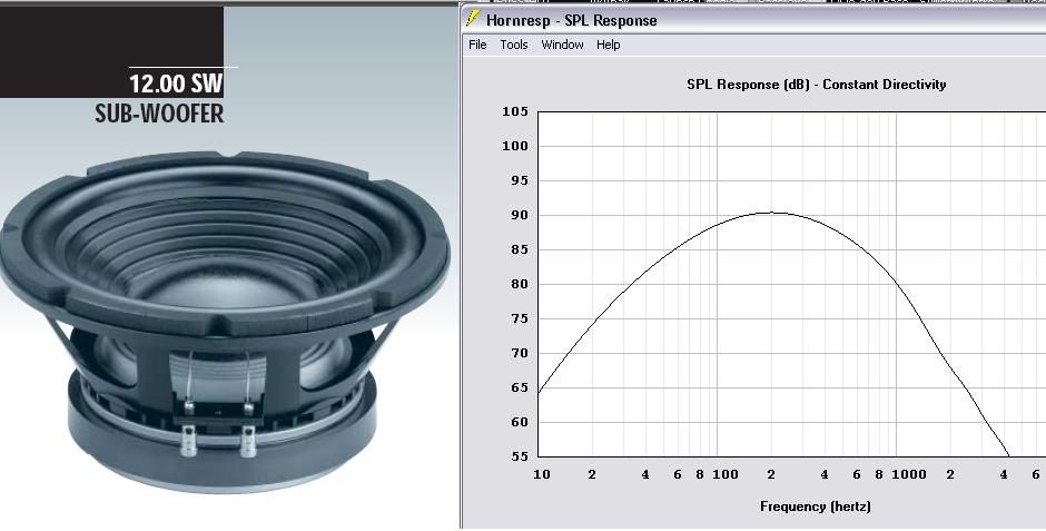

Found a hefty pro 12" xmax 11,5mm 490*1,15 = 563cm^3.
http://www.speakerstore.nl/luidsprekers/Ciare/pdf/12.00SW.pdf

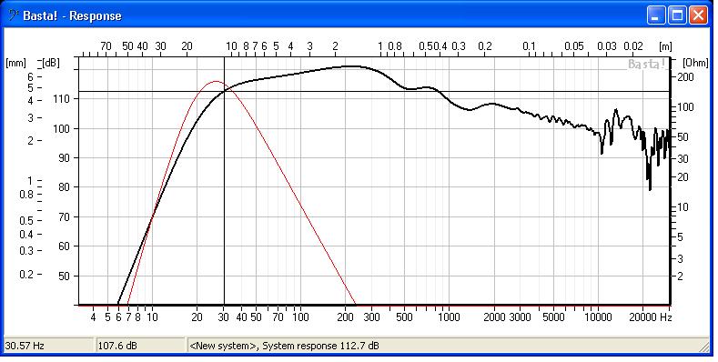

What about 21" and a xmax of 15mm. 1734*1,5= 2601cm^3.😀
http://www.speakerstore.nl/luidsprekers/Beyma/pdf/21SW1600Nd.pdf
