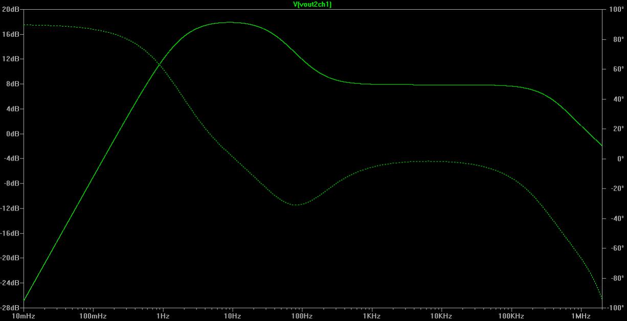

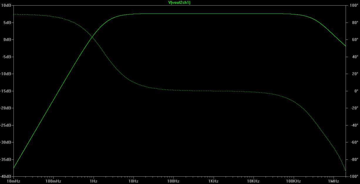

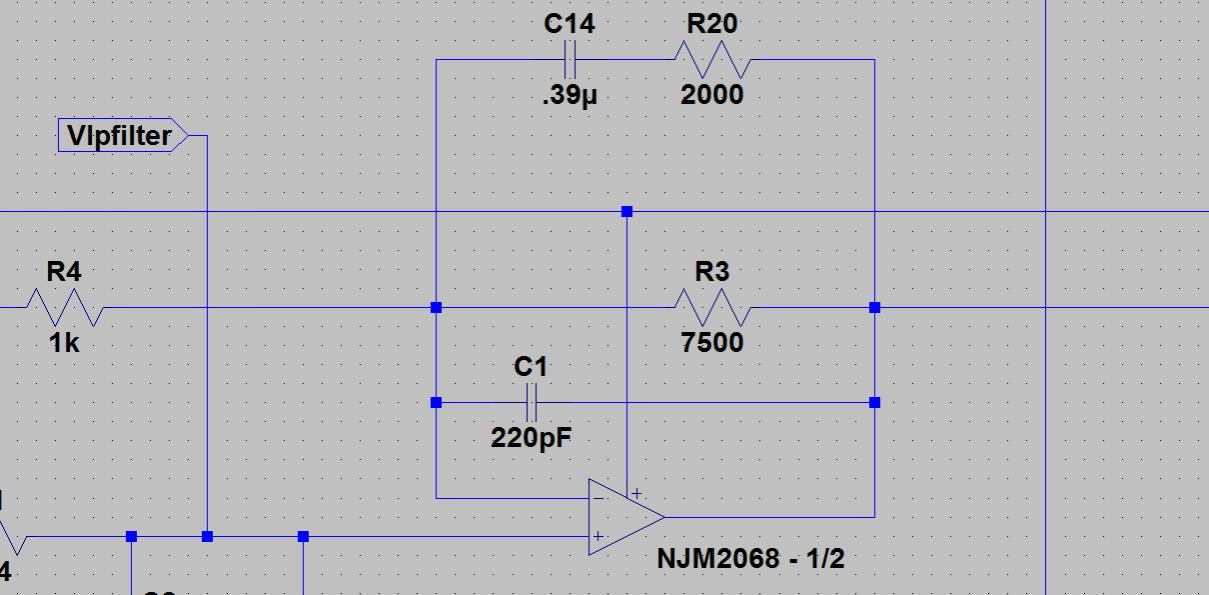

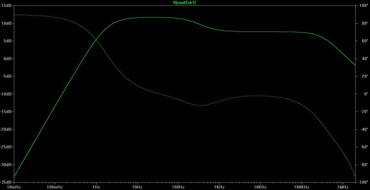

agdr, I'm looking at your Bass-boost mod.
I'm curious as to how one would bring the frequency + bandwidth down, I'm hoping to achieve +10dB at 30hz and about +5dB at 60Hz and maybe about +1dB(or less) at 100hz
I'm really in to my Subbass and considering my Headphones naturally drop to -10dB at 20hz.
I was originally looking at doing this Passive RC low-shelf pass but your method looks more interesting.
The first order filter in the boost circuit can't roll off quite that fast, but can get in the ballpark. Looks like the closest it can get is with the values below, 0.39uF and 2K for the boost part and 7.5K for the regular feedback resistor. The circuit winds up looking a lot like the rightmost diagram in your link for the shelving filters, except their configuration is for an inverting op amp and here it is non-inverting.
In the plots below the first is an O2 with no bass boost. The second is the regular boost parts, and the 3rd is with these values. The net result is:
10Hz 18dB (+10.3dB)
30Hz 16.7dB (+9dB)
60Hz 14.3dB (+6.6dB)
100Hz 11.5dB (+3.8dB)
273Hz 8.7dB (+1dB)
from 1Khz on 7.7dB.
If you need less than 7.7dB of gain (2.5x) after 1kHz use the attenuation mod earlier in this thread to knock the incoming signal down as needed. That modification just substitutes a larger value for the incoming 274R resistor to form a voltage divider with the 10k resistor to ground on the input of the O2. For example, if the 274R is replaced with a 10K that would form a 50/50 voltage divider. The input signal would get cut in half, then 2.5x from 1Khz on, yielding about 1.25x. The boost amount would get cut in half though, too, with the attenuation mod. In that case the amount of boost would need to be doubled to compensate.

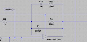

Thanks! I have LTSpice open with the Passive RC design in it and it looks like it suffers from the same bandwidth issues, my current one is peaking around 4hz , and hitting (-9.5dB) at 100hz.
The only way I can see getting it to work my way is to peak it near 1hz at +20dB, so the slope lands at +10dB at 20Hz, and 1dB at 100hz. I would never consider this except the other shelf filter has a -8dB from peak at 1hz which might offset this excessive gain.
Yes, that might do the job! Certainly worth trying. I messed around with that a bit, trying for just the last half or so of the roll-off curve, but it never seemed like the roll-off was steep enough to hit the 30Hz, 60Hz, and 100Hz specs. My guess is at least a second order filter would be needed in the feedback loop to get a steeper slope. I don't see a way to do that offhand with the shelving effect. A 2nd order MFB or salen key wouldn't level off, they would just keep going. Maybe someone out there has worked this out before and will post. 🙂 Seems like the kind of thing that would come up a lot with subwoofers.

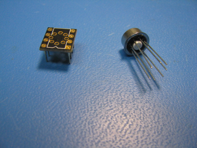

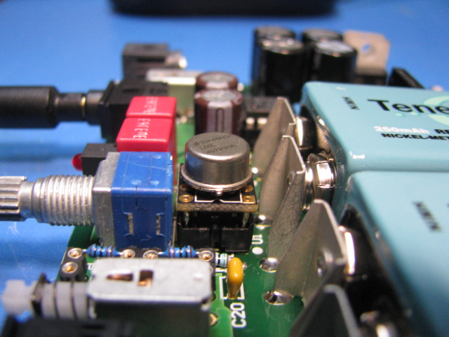

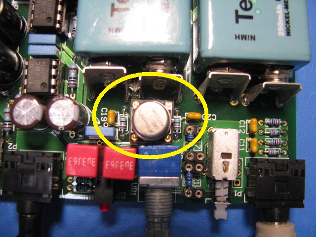

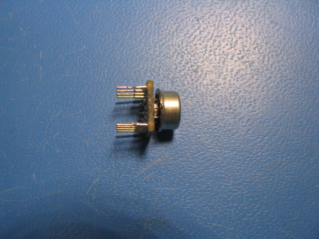

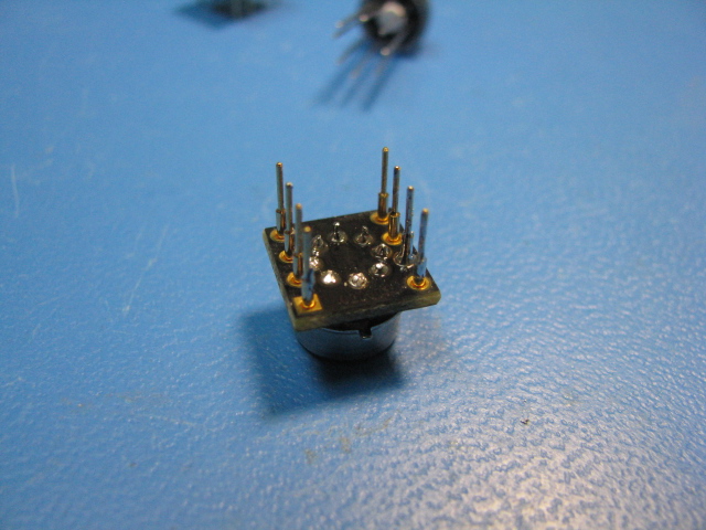

A LME49720HA on an adapter fits in for the NJM2068 gain chip
I just discovered that a metal can LME49720HA chip on a Brown Dog #02601B TO99 - to - DIP8 adaptor fits in just fine for the NJM2068 gain chip in the O2 headamp. Sounds pretty good too! No oscillations at all out to the 55MHz GBP of the chip and the 200MHz bandwidth of the scope.
The adaptor is this one. The leads on the chip have to be trimmed before inserting it in the adaptor. Then it takes some fairly precision soldering with a fine tip and small gauge solder to go around the circle - not recommended for first time solderers.

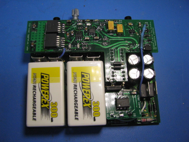

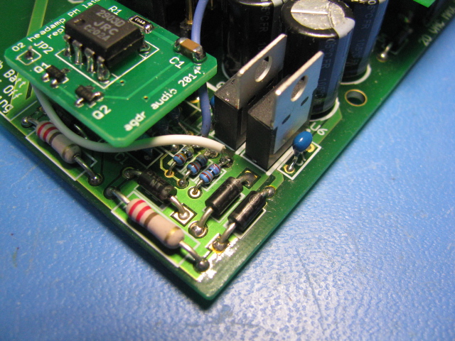

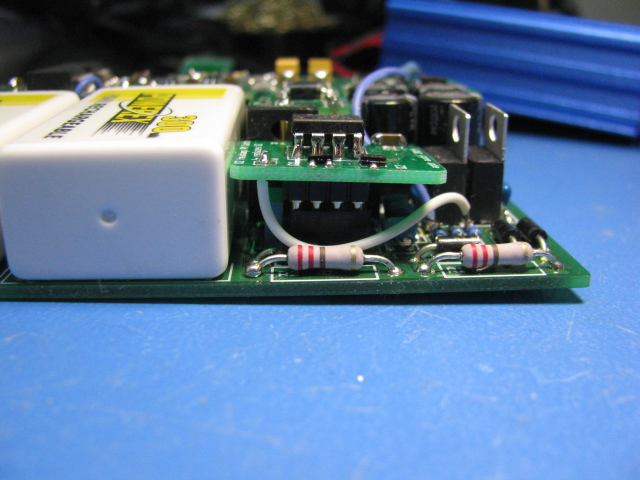

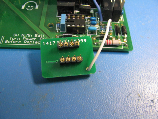

O2 non-motorboat PM latch board and post 108 update
I have an update to post #108 above from way back when that has my latch circuit for NwAvGuy's power management circuit in his O2 headphone amplifier.
The sense wire that goes to the O2's mosfets needs to go to the other end of the O2's R24. In post 108 I show that connection going to the side of the O2's R24 that is the Q1 mosfet gate, but it should go to the other comparator side of R24. On the O2 PC board that is the end of R24 closest to the O2's voltage regulators. I have photos posted below of the V1.0 board which shows how it wires into the O2.
Another update is the 4.7 meg resistor in post #108 should be around 499K instead. With 499K the O2 only has to be turned off (with the O2 power switch) for 10 seconds to reset the latch circuit. With the previous 4.7 meg it was more like 40 seconds, which was annoying.
Details, for those interested:
That circuit in post #108 solves the problem of the O2 headphone amp producing a "motorboating" sound at 2Hz or so when the batteries run down and the O2's power management circuit tries to shut them off. All batteries rise up in voltage a bit when the load is cut off. If that rise is too much with the O2's 9V NiMH batteries the PM circuit is fooled into thinking the batteries are charged again and turns the amp back on. With the load restored the voltage drops and the PM circuit shuts it all off again. It just sits there and does that over and over at 2 times per second or so, producing that motorboat sound in the headphones.
The circuit has worked fine since I posted it two years ago except for one thing. If the O2 is running on batteries plugging the AC power adaptor in would trigger the latch circuit. The O2 power switch would have to be turned off each time for the 10 seconds to reset the latch circuit. Moving the sense wire to the other side of the O2's R24 solves the problem. The latch won't trigger now if the AC power is plugged in.
The "why" the problem occured is pretty tricky. 🙂 NwAvGuy has 0.022uf capacitors on the gate of each O2 mosfet to act as a turn-on delay in an effort to prevent turn-on thumps. Those 0.022uF caps charge up to the full rail-to-rail voltage when the O2's mosfets are on. In the case of batteries that would be a minimum of 14Vdc or a maximum of around 20Vdc.
When the O2's power supply rails suddently shoot up to 24Vdc with the AC adaptor plugged in those fully-charged 0.022uF caps act like small batteries for a few milliseconds, such that the gate voltage goes from being zero with respext to the negative rail to 24V - the capacitor voltage. If the batteries were at 20V rail to rail that would be 24Vdc - 20Vdc = 4Vdc, which is more than enough to turn on the top mosfet in the latch circuit's two mosfet stack and trigger the latch. If the batteries are at the discharge end of 14Vdc rail to rail that voltage is even worse at 14Vdc.
But the other end of the O2's R24 is connected to the comparator's open collector transistor output, which is on and clamped to negative rail. So regardess of the 0.022uF cap acting like a mini battery the other end of R24 will stay firmly at 0 volts with respect to the negative rail and won't falsely trigger the latch circuit.
Lol - only took me 2.5 years to figure that out! 😛
With that problem resolved I've just reworked the board to be smaller, using a SOIC-8 version of the O2's NJM2903d (or LM2903) and 0805 sized resistor and capacitor. The V 1.0 board is large enough that I've been using a drop of hot glue on the side of the O2's U2 IC socket and the pluggable header to make sure the board stayed in the socket. The V2.0 board shouldn't need that.
The schematic, layout, BOM, build instructions, etc. are here on Google Drive:
https://drive.google.com/folderview...NvRjBCNU9BTmpMazcwLWY2VnNkdVdjdzg&usp=sharing
The V 2.0 folder is the one that just went out for fab. If it tests OK when back I'll post the Gerber files. I'm not going to bother posting the same stuff for the V 1.0 board that has been around for a year since its being replaced, other than the V1.0 folder has the photos below showing where that sense wire solders to on the O2 PC board.

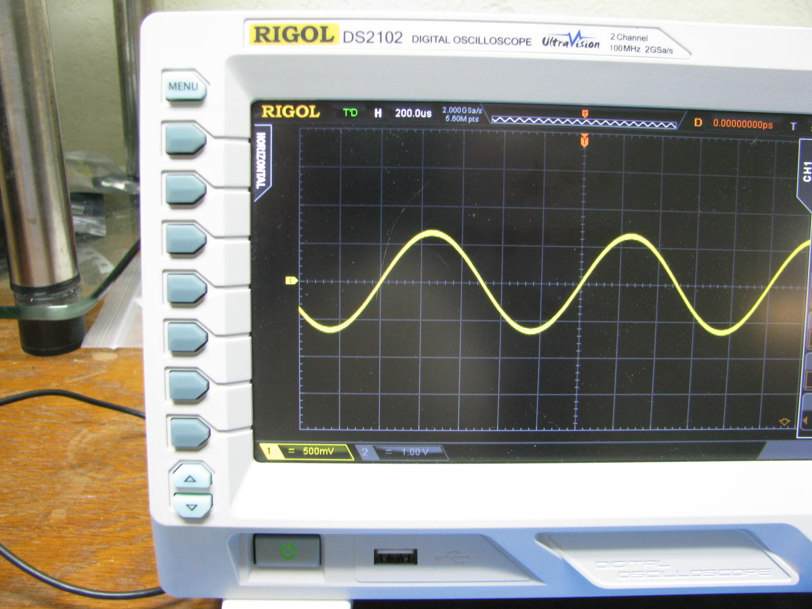

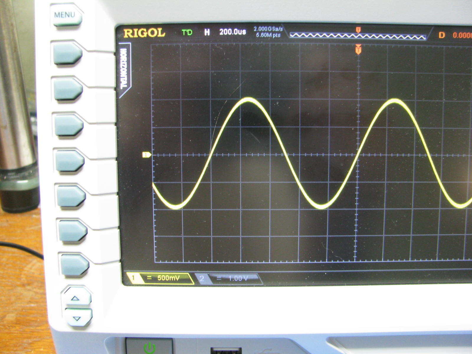

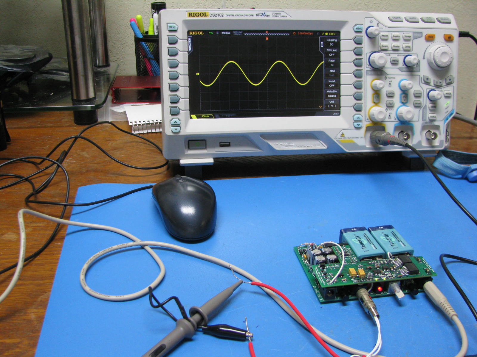

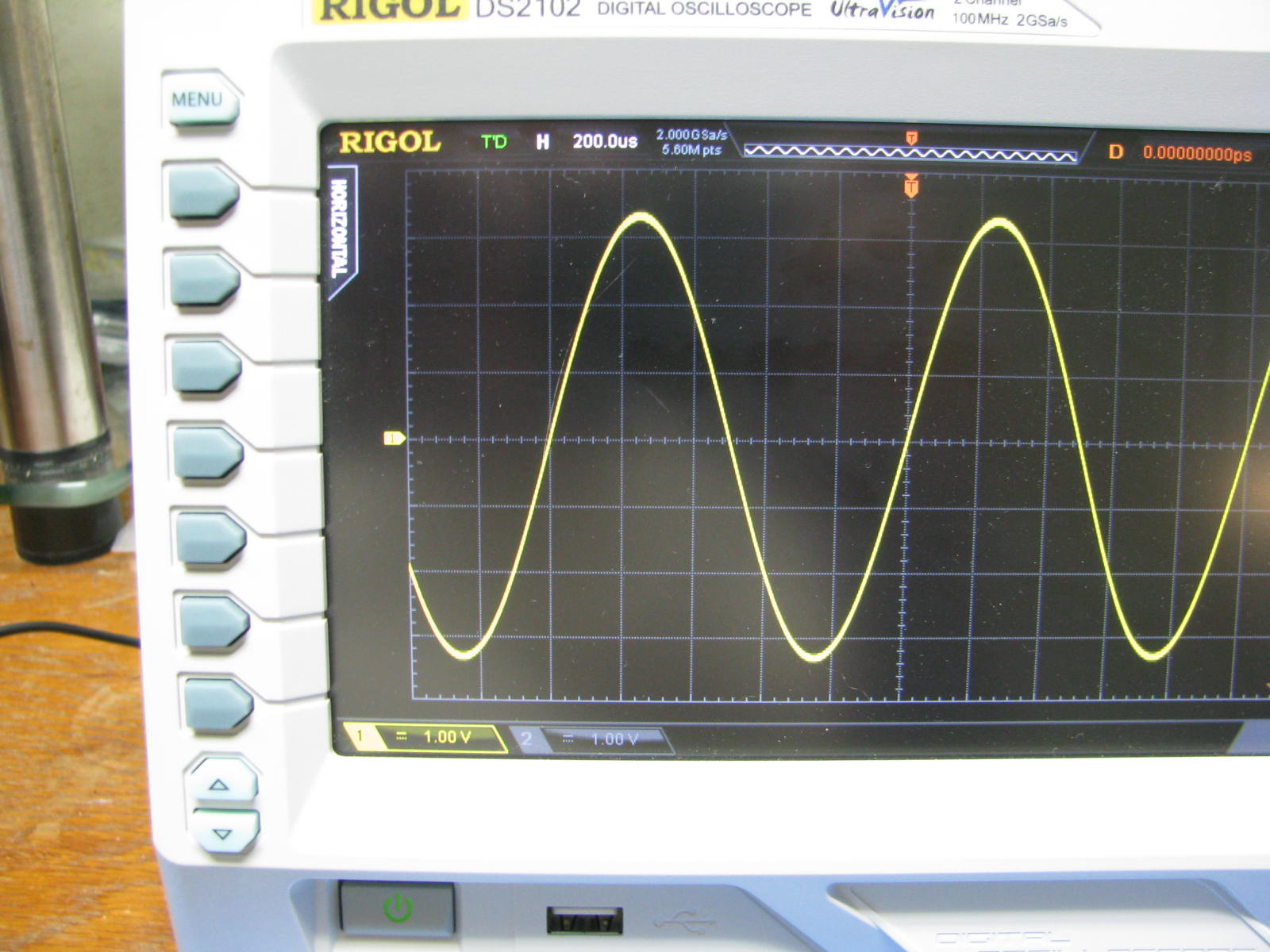

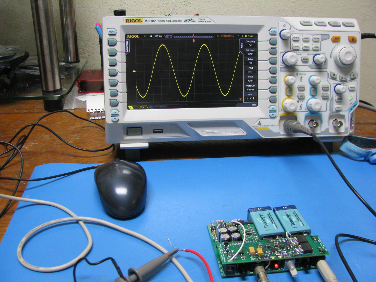

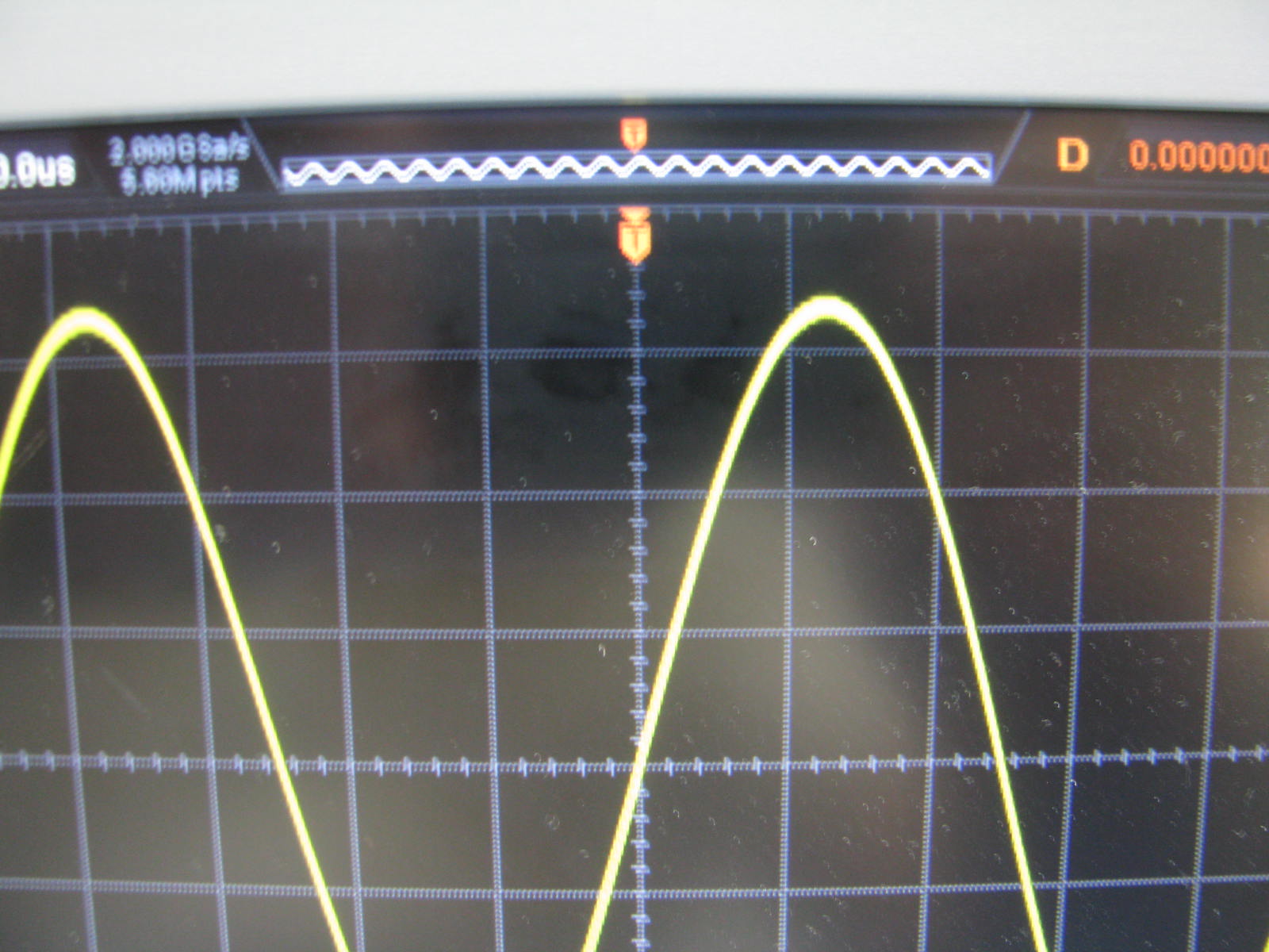

Scope photos for the 1/3 input attenuation modification + RF cap change
I just installed the 1/3 input attenuation modification in post #12 in an O2 and had an opportunity to take some scope shots of the results. 😀
Post #12 has the details, but in a nutshell the O2's 274 ohm input resistors, which are part of the RF filter with a 220pF capacitor, is replaced with a 4.99K resistor to form a 1/3 - 2/3 voltage divider with the O2's 10K pot. The net result is a 1/3 attenuation of the input signal (2/3 signal pass-through) to help deal with "hot" (high level) input sources.
All the O2's gain settings then get multiplied by the new 2/3 pass-through. If you had the standard 1x / 2.5x gain settings before, you wind up with 0.67x / 1.7x. If you wish to maintain 2.5x for the higher gain setting just bump the gain up in that setting so the product with 0.67 equals 2.5, a 549 ohm "gain" resistor in this case, Mouser #270-549-RC or #71-CMF50549R00FHEB.
The RF filter capacitor is correspondingly reduced to maintain the corner frequency from the previous filter. However here is one change over what I wrote in post #12. NwAvGuy had the corner frequency set at 2.6mHz. In post #12 I saw fit to reduce that to 470kHz. If you want to stay closer to NwAvGuy's original corner the cap to use would be a 12pF, a Mouser #80-C315C120K5G (Kemet #C315C120K5G5TA, 50V COG MLCC 2.54mm lead spacing).
The O2 being used here has gain set at 1x and 5.1x before the attenuation. After the attenuation these should be [(1 * 0.67) = 0.67x] and [(5.1 * 0.67) = 3.4x]. The O2 has an O2 Booster Board installed, but the Booster Board has 1x voltage gain, just a current buffer. Lets see if the measurements match up...
Photos with the modification in place:
* The first two show the test setup and input signal, 1V peak (2Vp-p) at 1kHz. The scope is on 500mV/division, which shows up in the lower left corner of the screen.
* In the next 2 photos show the O2 on the low gain setting (gain button out), 1Vpeak input, volume control all the way up. The scope is still on 500mVdiv so the small ticks in-between divisions are 100mV. As the close-up in 4453 shows, 0.67V peak! Right on the money.
* The next 3 show the O2 on high gain, gain button pushed in. The scope is now on 1V/div with the minor ticks now at 200mV. The close-up in 4460 shows 3 major divisions and 2 minor, which would be 3.4Vpeak, as expected. 🙂
