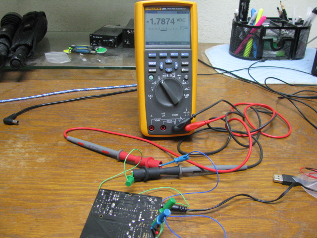

Details:
In RocketScientist's existing O2 power management circuit, when the MOSFETs are "off", U2 pin 7 is near the negative supply rail. That puts the 1.5M hysteresis resistor R25 essentially in parallel with the 33K R9, to give a parallel resistor value of around 32,290 ohms. This voltage goes to one input of the U2 comparator, pin 2, to be compared to the LED voltage on U2 pin 3.
The photo below shows the measured voltage across the O2's LED at about 1.78Vdc. The photo is taken with the O2 on AC power, but I also tested it on batteries and the LED voltage is nearly the same, as it should be. RocketScientist is using the LED essentially as a voltage reference.
So with the power management circuit just barely "off", the voltage at U2 pin 2 from the R5/(R9 || R25) voltage divider must be right at 1.78Vdc to match that reference voltage from the LED on pin 3. That gives a current through the R9 || R25 (parallel combo) and into R5 of 1.78Vdc / 32290 ohms = 55uA. Multiplying that current by the value of R5 gives a voltage drop across R5 of (55uA)(270K) = 14.88Vdc.
Now adding that voltage back to the 1.78 volts across R9 gives the rail-to-rail voltage at the point where the power management circuit activates and turns "on": 14.88Vdc + 1.78Vdc = 16.66Vdc. Assuming the two batteries are approximately equal, dividing this by two will give the voltage of either battery at the point where the PM circuit turns on as the batteries "recharge" once their load is removed (PM circuit had turned off): 16.66Vdc / 2 = 8.33Vdc.
That voltage matches up with the 8.30 volts measured in the linked post above in the main thread. The batteries in that case were charging back up to 8.30Vdc, just a hair below the 8.33Vdc level need to turn the PM circuit on again, and have it oscillate on and off to signal the batteries are in need of charging.
To find the other trip point to turn the PM circuit "off", with the power management circuit already "on", just work through all the math above but this time with the hysteresis resistor R25 in parallel with R5, the 270K resistor, instead of R9 since the comparator output U2 pin 7 will be near the positive rail when the PM circuit is on. 1.78Vdc across the 33K R9 gives 54uA through R9 and into the 228.8K parallel combo of R5 and R25, producing a (228.8K)(54uA) = 12.34Vdc. Adding 1.78Vdc and dividing by 2, for the two batteries, gives the "turn off" voltage trip point of around 7.07Vdc per battery.
Going through similar math with RocketScientist’s original values of R9 = 40.2K and R25 = 2.74M result in a power management turn “on” voltage of around 6.95Vdc per battery and a turn “off” voltage of around 6.33Vdc each.

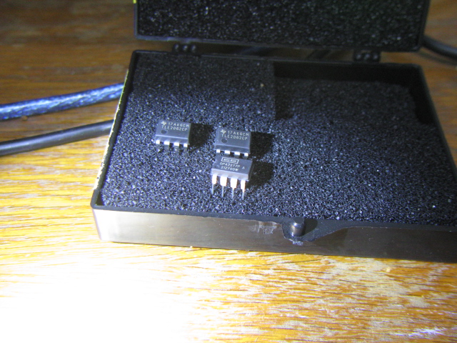

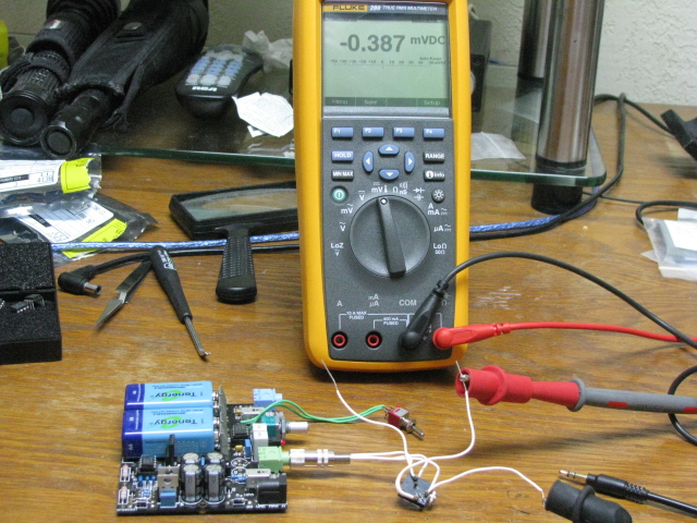

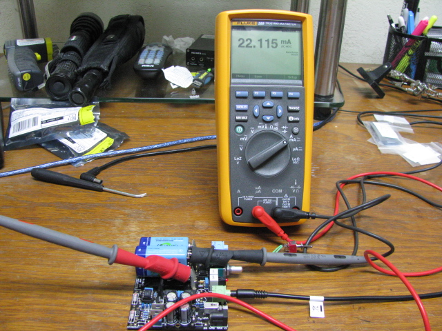

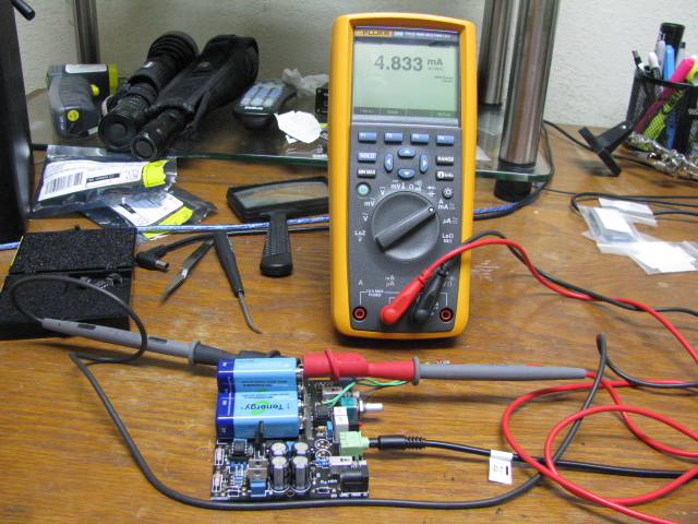

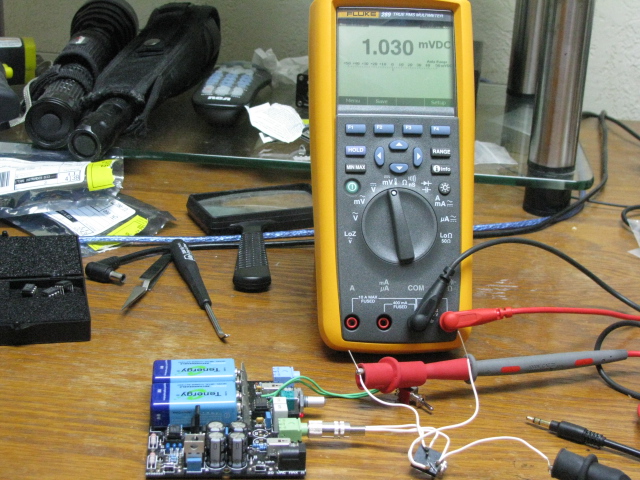

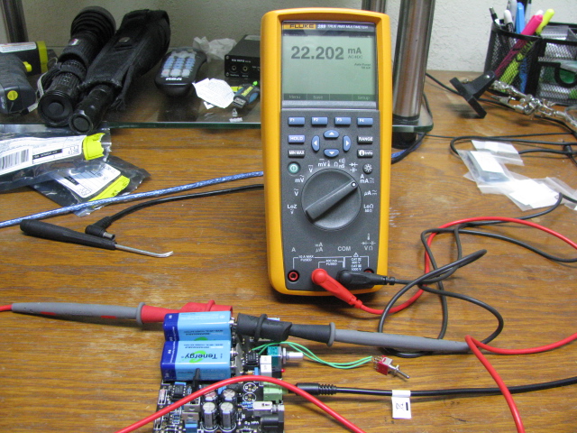

O2 amp longer runtime #2, low power op amps from BOM
RocketScientist's writeup on the O2 amp includes an option of using a set of low power op amps he specified for increased runtime. It seems the option has been largely forgotten or unused, since as RocketScientist wrote that the distortion and noise floor can be a bit higher, depending upon what one is doing.
However, RocketScientist did not include the effect of headphone sensitivity in his writeup about the low power chipset. This modification shows that for very sensitive headphones, like the AKG K550s at 114dB/V, the distortion levels are well into the "great" range from the dScope measurements he has posted with the low power chips. He shows "very low" distortion up to about 0.7Vrms output swing at 15R output impedance. The K550s only require a maximum of abour 80mV (rms) swing at 32R, well into the low distortion part of his dScope curves.
The writeup is here on his blog,
NwAvGuy: O2 Details
and search for the heading "low power option" and the heading "low power distortion & output" for his dScope distortion graphs with the chipset. The chips involved are listed on any of his BOM's for the O2 amp, under the gain resistor section. The output NJM4556 chips are replaced with TLE2062CPs and the NJM2068 gain op amp replaced with the OPA2277PA.
These two low power chips also have much better input bias current numbers (pA vs. nA) then the NJM chips, resulting in lower DC offset at the output of the O2.
The first photo below shows the new chips. The TLE2062CPs are at the top and the OPA2277PA at the bottom. The next two photos show the quiescent (idle) current of the O2 with the original NJM chips still installed. 22.2mA on one channel and 22.1mA on the other, which matches up perfectly with RocketScientist's mention of around 22mA idle for the NJMs in his writeup. The batteries are freshly charged for all this, both running at about 9.1Vdc.

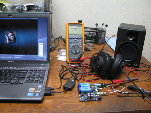

The next two photos show the new idle current with RocketScientist's low power chipset installed. 4.8mA on both channels, representing a 78% reduction in idle current. RocketScientist says "below 8mA" in his writeup. I'm at a loss as to where he came up with the extra 3.2mA of current usage. The idle current is significantly more than the current used by the headphones, as RS notes, so this idle current reduction represents a huge decrease in current draw. Assuming around a 30mV normal (rms) listening level on the AKG K550s, that is just (30mV / 32R)(2 channels) = 1.9mA, a drop in the bucket next to that 22mA - 4.8mA = 17mA idle current reduction!
Assuming Tenergy is lying about the 250mAhr rating on the 8.4Vdc cells (I've been working with high power LED flashlights too long, lol) and they are really 220mAhr or less, a 17mA drop in current per battery represents 220mAhr/4.8mA - 220mAhr/22mA = 35 hour increase in run time! That means charging your O2 once every 4 days rather than every day.
The next two photos show the reduction in output DC offset into the headphones. 380uV and 1.03mV vs. about 3mV per channel with the NJM4556 output chipset. That is better than a 3:1 reduction.
I have left the output resistors at 1R, rather than reduce them to 6R as RocketScientist mentions in his low power write, since the very low voltage swing needed for the AKG K550s would still result in low chip to chip balancing currents even at 1R each. For headphones requiring larger voltage swings, closer to that 0.7Vrms "knee" in his dScope distortion curves, using the 6R output resistors would probably reduce distortion slightly.
All measurements aside, the final photo is some actual listening time. 🙂 Sounds great! In this case the O2 amp is being fed with the HiFimeDIY ODAC clone here, into the K550 headphones, O2 running on batteries.
I should re-iterate that this mod is assuming very sensitive headphones or IEMs, like these 114dB/V AKGs. The mod would probably work very well down to a sensitivity of 110dB/V or so. Lower than that you will run into all the issues that RocketScientist originally wrote about for this low power chipset, namely significantly increased distortion due to the higher voltage swing requirements and higher noise. This low power chipset would not work well at all with my 100dB/mW Shure SRH940s, for example. Those need closer to 1.8V rms max. From RocketScientist's dScope curve for the low power chipset you can set the distortion starts rising exponentially (at 15R) around 0.7Vrms output.

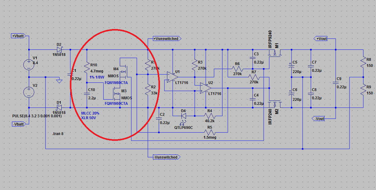

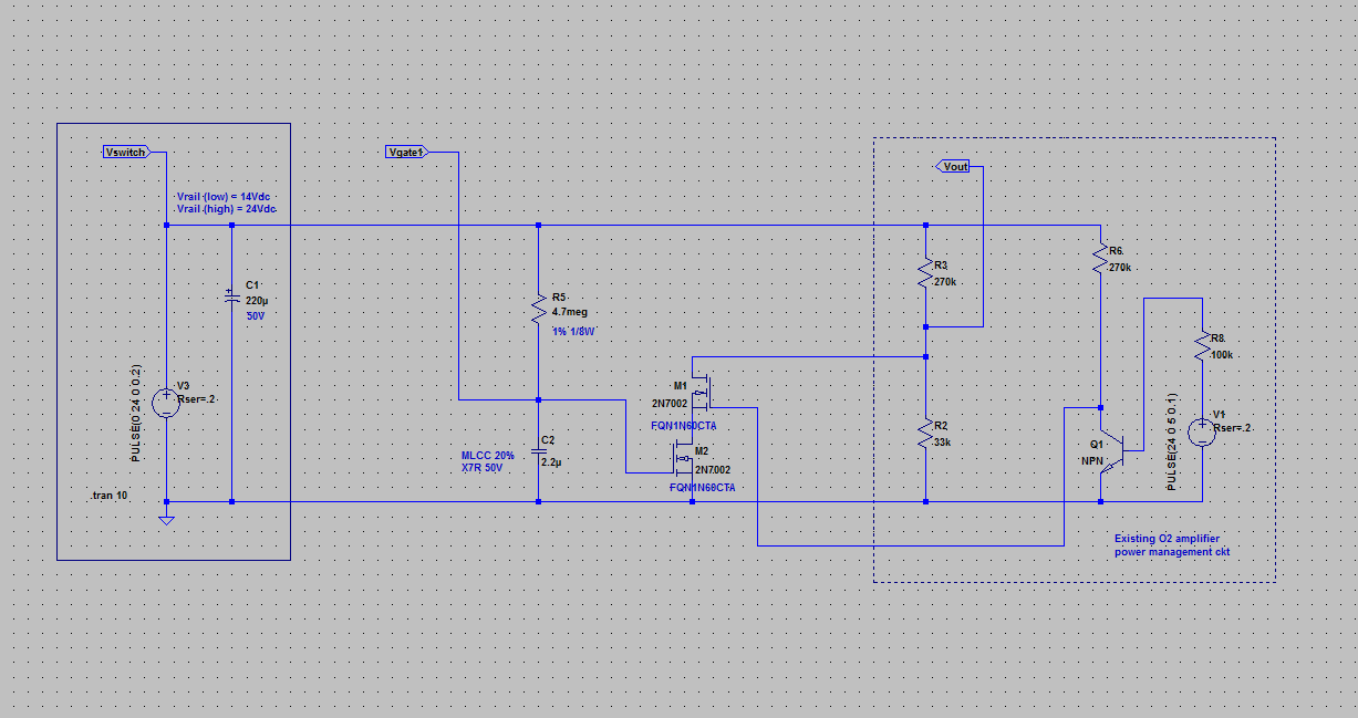

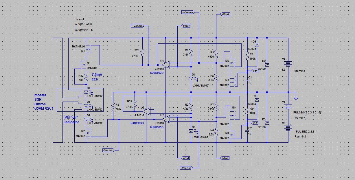

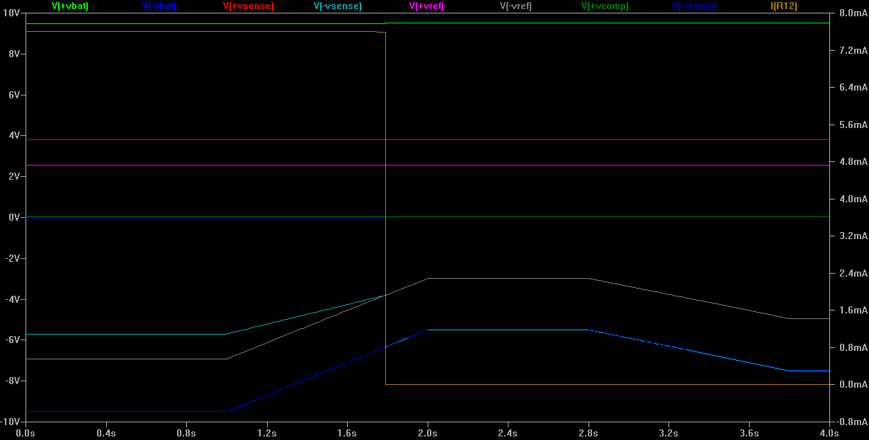

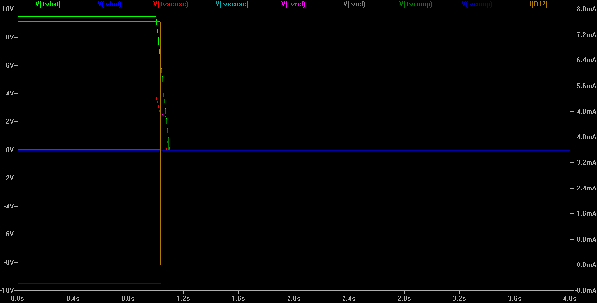

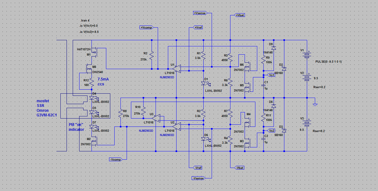

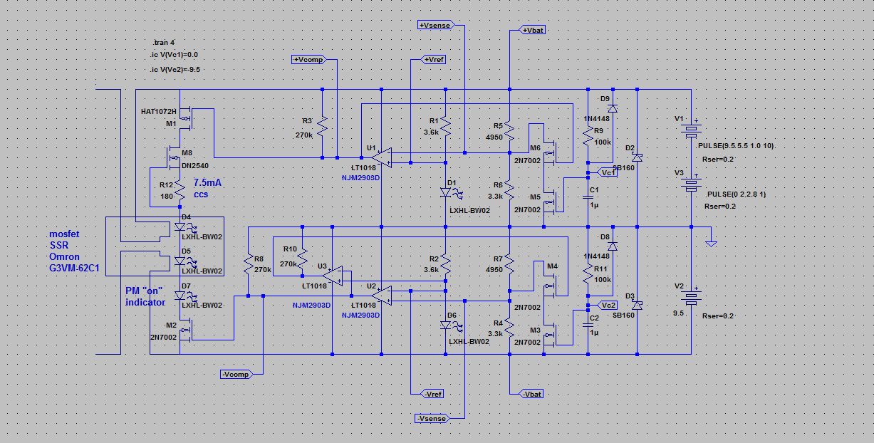

O2 amp power mgmt latch modification - no oscillate
This O2 headphone amplifier modification adds a latching circuit that keeps the power management circuit "off" permanently - until the amp power switch is turned off and back on to reset - regardless of any re-charge behavior by the batteries.
The battery re-charge issue is described in the posts above about hysteresis. Once the load is removed from the batteries when they get low, when the power management circuit turns off, the battery voltages tend to rise on their own which can turn the circuit, and hence the whole O2 amp, back on again. The O2 then just oscillates on and off like that making a noise in the headphones.
This modification adds a couple of mosfets across the 33K R9 resistor in RocketScientist's schematic. When the power management circuit turns off, the gate of mosfet Q1 goes high (to the positive rail, whatever voltage that is at the moment). That signal now goes to the gate of a new mosfet in this modification that in turn "shorts out" R9, bringing pin 2 of the comparator U2 to the negative power rail. Lowering that pin voltage forces the gate of Q1 high, which is already is, thereby creating a latching feedback loop. If the battery voltage subsequently rises it will have no effect, since that would ordinarily increase the voltage at U2 pin 2 by the action of the R9 / R5 voltage divider. With U2 pin 2 now latched at the negative rail voltage the power management circuit will stay off permanently, regardless of battery voltage, until the O2 power switch is turned off and back on.
The one trick to the circuit is that RocketScientist has the power management circuit turn off briefly when the O2 is first turned on to prevent a turn-on pop in the headphones. C1 C16, and C21 are part of that function. This action would trip the lock circuit and lock out the O2 from ever turning on in the first place without the addition of an initial time delay, which is formed from the second mosfet in series with the first across R9. The time delay RC circuit feeding the gate of that mosfet produces an initial power-on delay in the latch circuit of 1 -2 seconds (1 sec = 24Vdc rails on AC, 2 sec = 14Vdc with nearly dead batteries). The two mosfets in series logically "AND" the power-on time delay and latching signals as a condition to short U2 pin 2 to the negative power rail.
The first circuit below shows how the new parts are wired into the O2 power management circuit. The second circuit is just an LTSpice test circuit for function.
Suitable parts from Mouser are:
Two n-channel mosfets: these MUST be +/-30Vdc gate mosfets. A 2N7000 with a +/-20Vdc gate will not work.
FQN1N60CTA Fairchild Semiconductor | Mouser
Resistor: 4.7M 1/8W 1%
RN55D4704FRE6 Vishay/Dale | Mouser
Capacitor: don't use an electrolytic for this. The leakage is too great and will prevent the circuit from working correctly with the tiny currents involved. Use a multilayer ceramic capacitor (MLCC), 2.2uF, X7R, 10%, 50V
FK20X7R1H225K TDK | Mouser
The bad news is that I don't see any way to fit this modification into the standard B2-080 O2 chassis, at least using these through-hole parts. The slightly taller B3-080 case would have to be used. All 4 parts in the circuit have surface mount versions though. It may be possible to fit a SMD layout for the the circuit underneath the O2 PCB in the B2-080 case, and wire the board into the bottom of the O2 PCB, although I haven't tried it. 🙂
For a power managment circuit "on" indicator, wire a small 3mm led in series with a resistor to run at 1mA or so, across C8. Then just drill a small hole in the O2 front panel and glue the LED into the hole. When the PM circuit is on the LED will be on, and when off and latched the LED will be off. The same thing could be done with a second LED across C9 (careful to observe polarities!) to show the same for the negative rail and Q2.

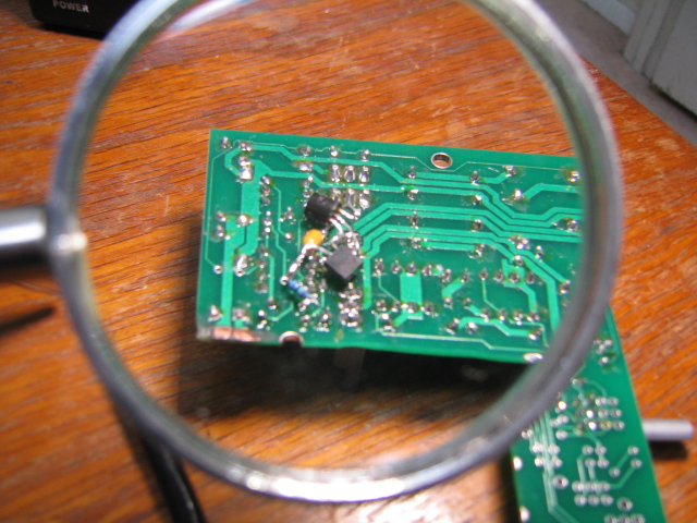

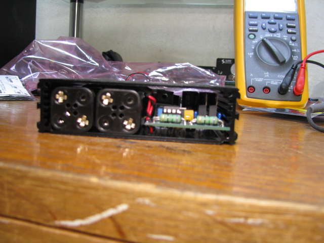

O2 power mgmt latch mod does fit under the PCB
It turns out that the RocketScientist O2 amp power management circuit latching modification that I posted above does fit under the O2 PCB in the standard B2-080 case just fine - if you are really good with a soldering iron adn some DIY work. 🙂
The purpose of the latch circuit, again, is to prevent the natural voltage rise that happens with the batteries when the power management circuit cuts the load off from reaching a level where the pwr mgmt circuit turns back on, hence oscillating
I added the circuit to the bottom of the 8-cell AAA NiMH O2 modification that I posted in another thread to test it. Works great, with one thing that I'll call a feature rather than a bug. Once the latch circuit trips, the O2 amp must be powered off for a full 2 minutes to reset it. It takes that long for the RC time delay lockout circuit in the latch circuit to bleed down. If the O2 is turned back on in less than two minutes the mosfets will just remain off.
All of this should be done on a antistatic mat with grounded wrist strap, grounded tools, grounded soldering iron tip, etc. to keep from blowing the mosfet gates.

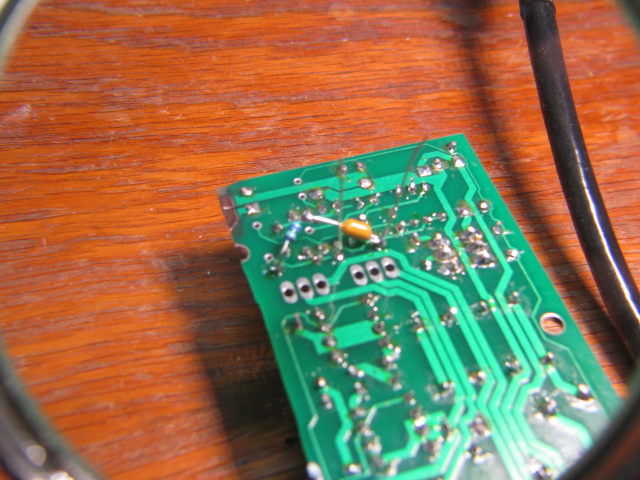

The first two photos below shows the resistor and axial capacitor that form the RC time delay circuit soldered across the outer pins of R5 and R9 under the O2 PCB. When R9 was soldered in I left the leads long so I could solder the mosfets to them.
The mosfets source and drain leads are bent at right angles, then the drain of one soldered to the source of the other. Then the mosfet pair are soldered onto the free R9 leads and the leads trimmed.
Finally one mosfet gate lead is soldered to the connection point of the RC delay circuit, while the other is bent around and soldered to the nearby gate connection of Q1, as shown in the 3rd photo.
The whole thing clears the bottom of the B2-080 case just fine, as the last photo shows.

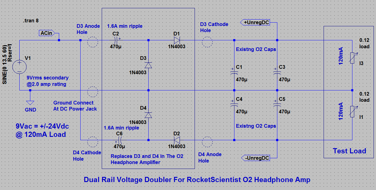

This modification of RocketScientist's O2 amp adds a few diodes and capacitors to the power supply to create a dual-rail voltage doubler and dual-rail voltage quadrupler using the same AC input transformers. The net result is that a 9Vac transformer with 2A secondary will produce +/-18Vdc rails going into the regulator chips (120mA load per channel), allowing for the use of 15V regulators and supply rails (MC7815 and MC7915).
A note on terminology first. RocketScientist's power supply in the O2 is already a voltage doubler if you look at it just right. It all depends on where the ground reference is placed (negative DMM lead for the discussion here). If the ground reference is in the middle, at one end of the transformer secondary as in the O2, you get dual rail 1x, which is 9Vac rms X 1.414 for sine = 12.7Vdc. Subtract a couple of volts ripple for the half wave rectification and another volt for AC line fluctuation you get +/-9.7Vdc into regulators. If however you move the ground reference to the negative rail being produced, the result is a single ended votlage doubler of 9.7V x 2 = 19.4Vdc.
So the "dual rail voltage doubler" circuit presented here is really a "single ended voltage quadrupler" if the ground reference is moved from the middle to the negative rail. Similarly the "dual rail voltage quadrupler" here is a "single ended 8x" with the ground reference moved.
Another note is in order on currents and voltages. Anyone building these circuits should pay close attention to the ripple currents needed in the capacitors at each stage and make sure cap voltage ratings around around 20% higher than the peak voltage, including line voltage fluctuations, at each stage. And finally, a voltage doubler or quadrupler can produce some high DC voltages if higher AC voltages are used on the input. Use caution! 24Vac into a dual rail voltage doubler will produce around +/- 60Vdc.

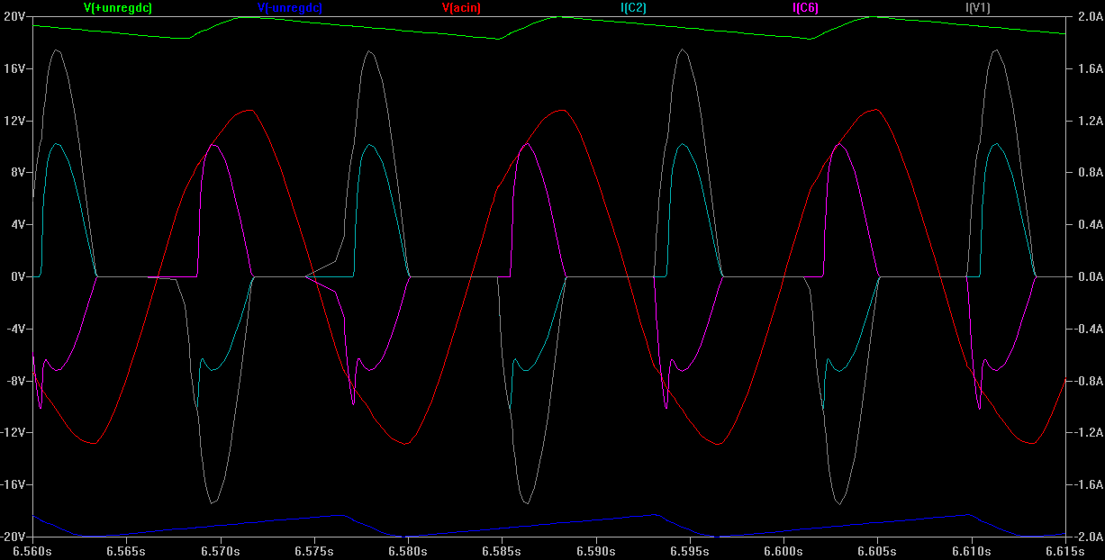

The first circuit and plot below show the dual rail voltage doubler. As shown a 9Vac rms transformer with a 2A secondary, like this one
9 Volt 9V AC 2000mA Adapter for Line 6 PX 2 US Pod Power Supply Cord Charger PSU | eBay
will produce around +/-18Vdc rails going into the regulators with a 120mA load on each channel. 15V regulator chips can then be used, along with appropriate resistor value changes in the PM circuit and clip on heat sinks on the output chips (as shown in the first couple of posts in this thread).
Green and blue in the plot are the voltage outputs of the voltage doubler, going into the regulators. Red is the AC input voltage. Volt scale is on the left. The aqua and magenta current plots using the righthand scale are the currents through the input capacitors, C2 and C6. Half the current waveform looks distorted since these caps charge on one half cycle and discharge on the other. The grey plot is the current spike through the input transformer, showing the need for the 2A secondary.

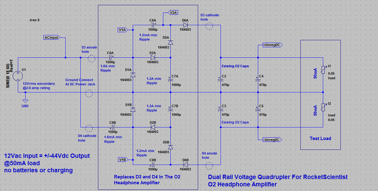

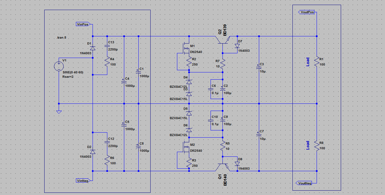

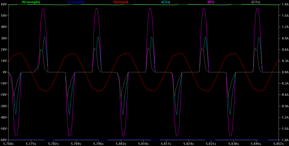

The second circuit is less of an O2 modification and more of a separate DIY project for someone with high impedance (600R) low efficency cans. The plot shows the result of 12Vac into a dual rail voltage quadrupler circuit, producing +/-60-Vdc going into the regulator. Regulator chips are not available at these voltages, so a simple discrete regulator pair as in the next attachment would have to be used. This one is a simple capacitance multiplier fed with a current sourced zener. The high voltage +/-60Vdc rails here can be used with amps such as opc's "wire class A/AB" amp based on the LME49830 chip and mosfets that goes up to +/-90V rails
http://www.diyaudio.com/forums/soli...amplifier-based-lme49830-lateral-mosfets.html
In both the dual rail doubler and dual rail quadrupler the circuit just replaces D3 and D4 on the O2 PCB, as shown. In the case of the voltage doubler the parts cold be built up on an upside down PCB slid into the top slot on the taller B3-080 case, with wires going to the 4 holes where D3 and D4 would have gone, plus the one ground connection on the AC input jack.

O2 amp dual rail power management modification
Here is a dual-rail version of RocketScientist's power management circuit in the O2 headphone amp for anyone into some DIY modding work. 🙂 This circuit essentially takes RocketScientist's design and just applies a copy to each power supply rail individually rather than measuring the two rails summed together.
One benefit is the ability to detect a single supply failure that doesn't add up (both rail voltages added together in the original O2 PM circuit) to less than 14Vdc where the original PM O2 circuit would trip. An example from a recent post in the O2 thread is using a DC power supply instead of AC. One rail is on AC while the other is one battery, allowing the battery to discharge too low to about 3Vdc. The dual rail circuit here would catch that condition - or any unbalanced rail condition like a battery with partially shorted cells inside - and shut down the O2.
The circuit adds reversed biased diodes across each rail to ground to take care of a situation where one rail is left floating and held up to the opposing rail by rail-to-rail parts, like using a DC supply with no batteries installed.
The circuit incorporates the latch modification earlier in the thread to latch the PM circuit off once it trips. This eliminates any chance of the circuit oscillation when the battery runs down, original PM circuit trips, then the battery recharges a small amount and turns the PM circuit back on. I've left off RocketScientist's hysteresis resistor R25 since it isn't needed with the latch circuit. With the latch the O2 will remain off until the power is switched off and left off for about 15 seconds to reset the latch circuit.
I've also left off the capacitors on the mosfet gates to slow turn on, the "turn on thump" preventer. I'm assuming that a headphone relay cutout circuit like posted earlier in this thread would be used instead to lockout turn on thump. But the caps can be added back if needed.
This dual-rail circuit has two power leds, one for each rail, which also act as voltage references for each rail just as with RocketScientist's original design. The LEDs would also help diagnose missing power supply inputs on one rail or the other.
The output uses a mosfet optical solid state relay, an Omron G3VM-62C1 to improve the syncronization and hence quality of the PM switch-on and switch off. RocketScientist's original design tries to keep the gate switching of the two individual mosfets synchonized so both rails switch at exactly the same time. But in actual practice a lot of posts have noted that turn on thumps are solved by replacing one mosfet or the other, meaning manufacturing differences (and possibily installation static damage) are causing switching time differences with the mosfets.
The Omron SSR is an integrated DIP-8 unit so the two mosfets will be highly matched. Easily replaced, too, since the whole thing fits in a standard DIP8 socket. The mosfets are optically triggered by two LEDs in the package that are placed in series between the outputs of the voltage comparators on each rail, fed with two mosfets in a similar fashion to RS's original design. So now the mosfets don't supply the power rails directly, but rather together turn on the SSR control LEDS and simultaneously switch both SSR mosfets. If one comparator chain or the other is slightly off in time it doesn't matter since the SSR LEDs are in series. First one wins. The constant current source maintains the datasheet recommended 7.5mA current through the SSR LEDs through the whole power supply range of 12Vdc to the trigger point of 7Vdc on each rail. The downside is 7.5mA of additional current draw, about the same as one of the op amps, which will run the batteries down slightly sooner. Another external LED is included in series with the SSR LEDs as a PM trigger indicator that comes for "free" in terms of current draw. The PM "on" LED indicator should help with diagnosing problems.
The LEDs in the schematics for the voltage reference are just something that was living in LTSpice. For the actual circuit use the LED in the O2 and adjust the series resistor accordingly for the same current from one rail rather than rail to rail. The voltage divider resistors get adjusted for the 1.7Vdc of the O2 LED.

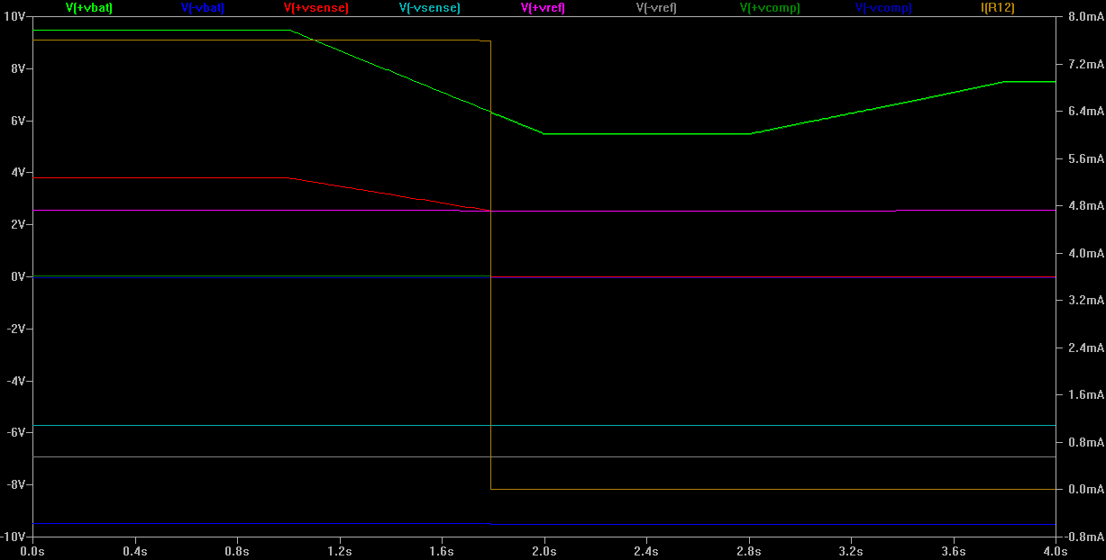

The first plot below shows the positive battery (green trace) discharging from from +9.5Vdc intial down through the +6.5Vdc trip point of the comparator and down to +6.3Vdc. The orange trace is the current through the SSR LEDs, showing the switch at the trigger point. The battery then recharges back up through the trigger point to +7.5Vdc, but the SSR remains off due to the latching circuit.
The second plot shows the same thing for the negative rail (blue trace). The negative rail circuit has an extra comparator to make an inverted copy of the output signal for the negative rail latch circuit. The third plot shows the effect of a sudden complete disconnection or failure of one supply (loose battery terminal, one battery removed, AC voltage regulator failure). The SSR switches off as it should.

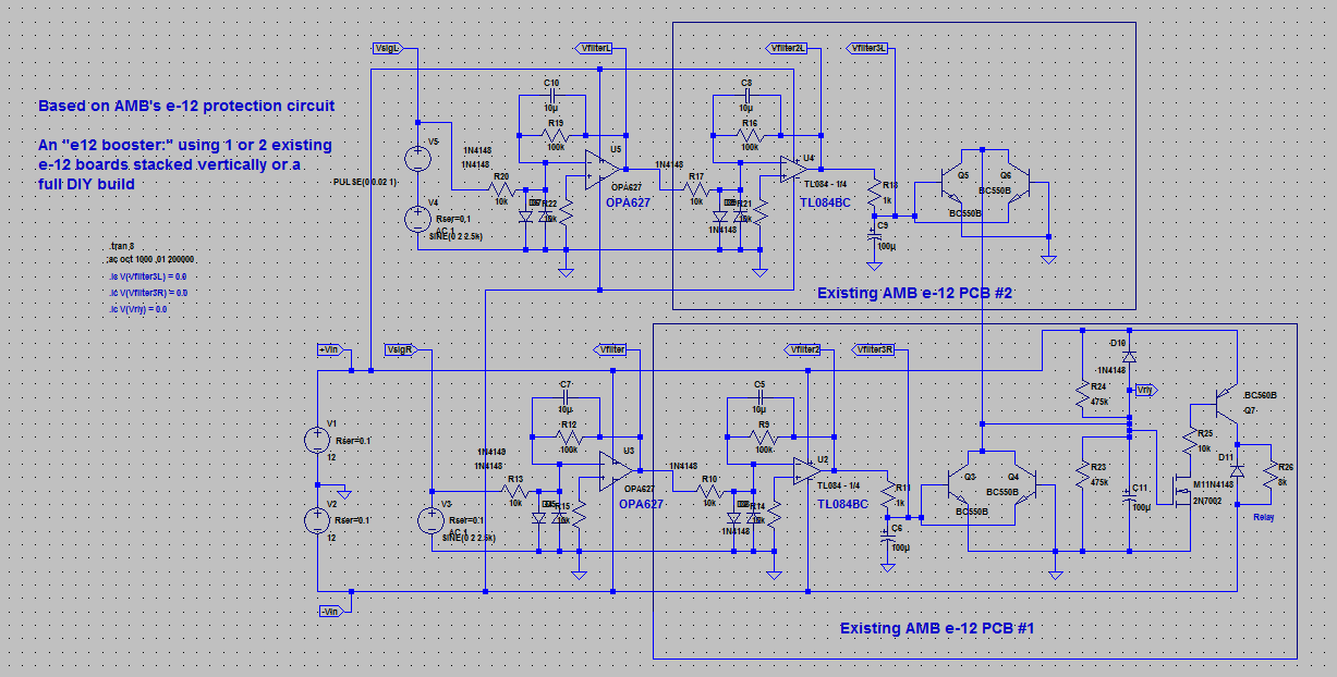

And a link to AMB's e-12: The ε12 Muting / Protect Circuit
e-12 booster relay protect - part 2, applied to O2 amp
Here is some more info on the "e-12 booster" above. If used with the O2 amp the O2's power supplies can be used, as shown in the circuit below. Just don't populate the power supply and virtual ground parts on e-12 PCB #1. Wire the +12Vdc, -12Vdc, and ground over from the power switch on the O2.
Also a typo warning on the circuit I attached above - it has the negative rail attached to ground in the top half when I did a cut and paste. The negative rail should attach as shown here.

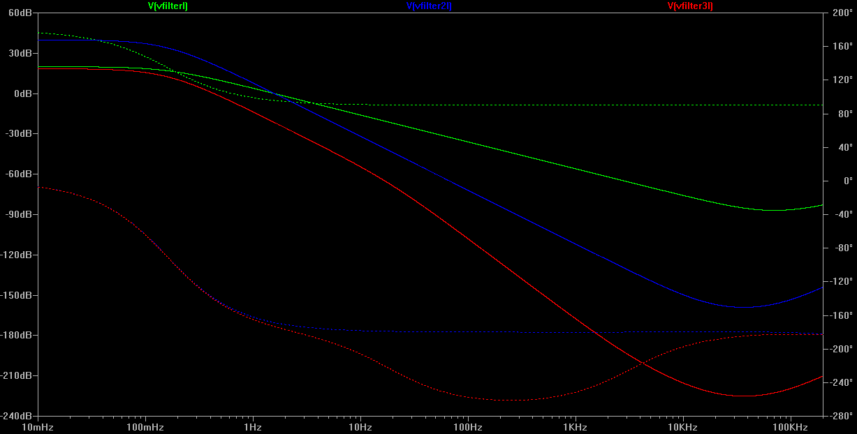

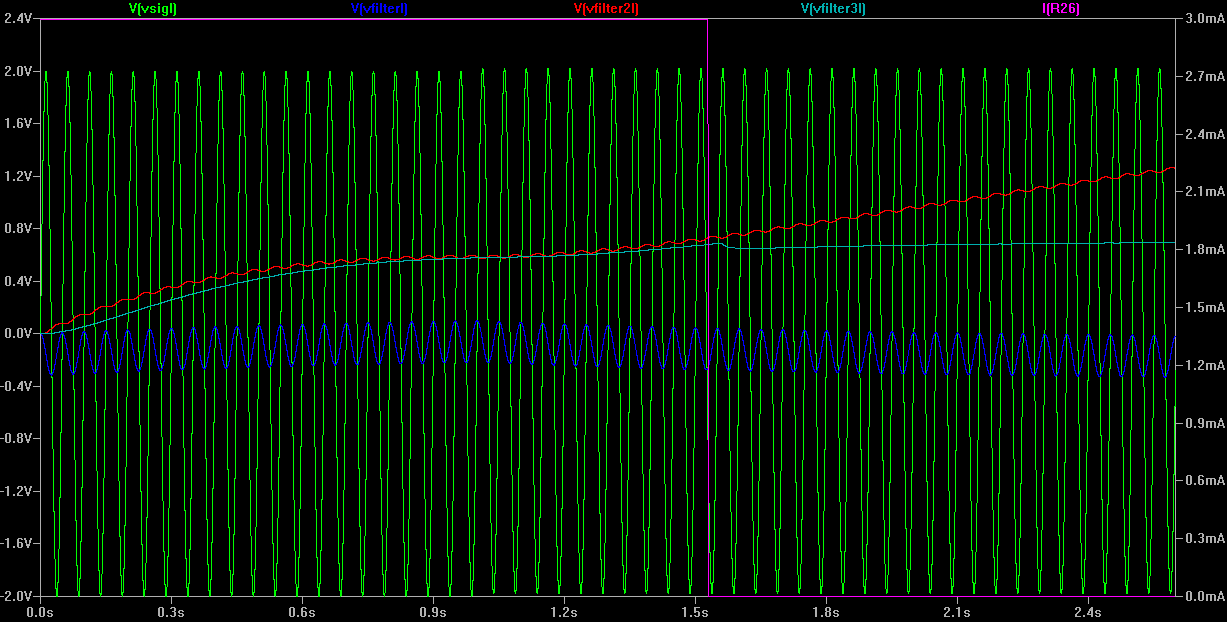

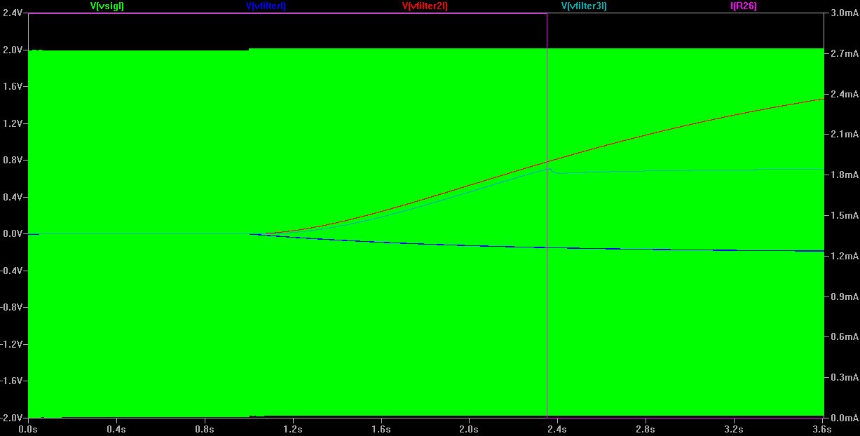

I've added the device models for the OPA627 and TL084 in the LT Spice sim below. The first plot is the AC response from 0.01Hz to 200kHz, showing the 0.1Hz corner frequency and 20dB/decade, 40dB/decade, and 60dB/decade rolloffs for the output of the 3 cascaded filter sections. Green, blue, and red respectively. Labels are at the top of the plots.

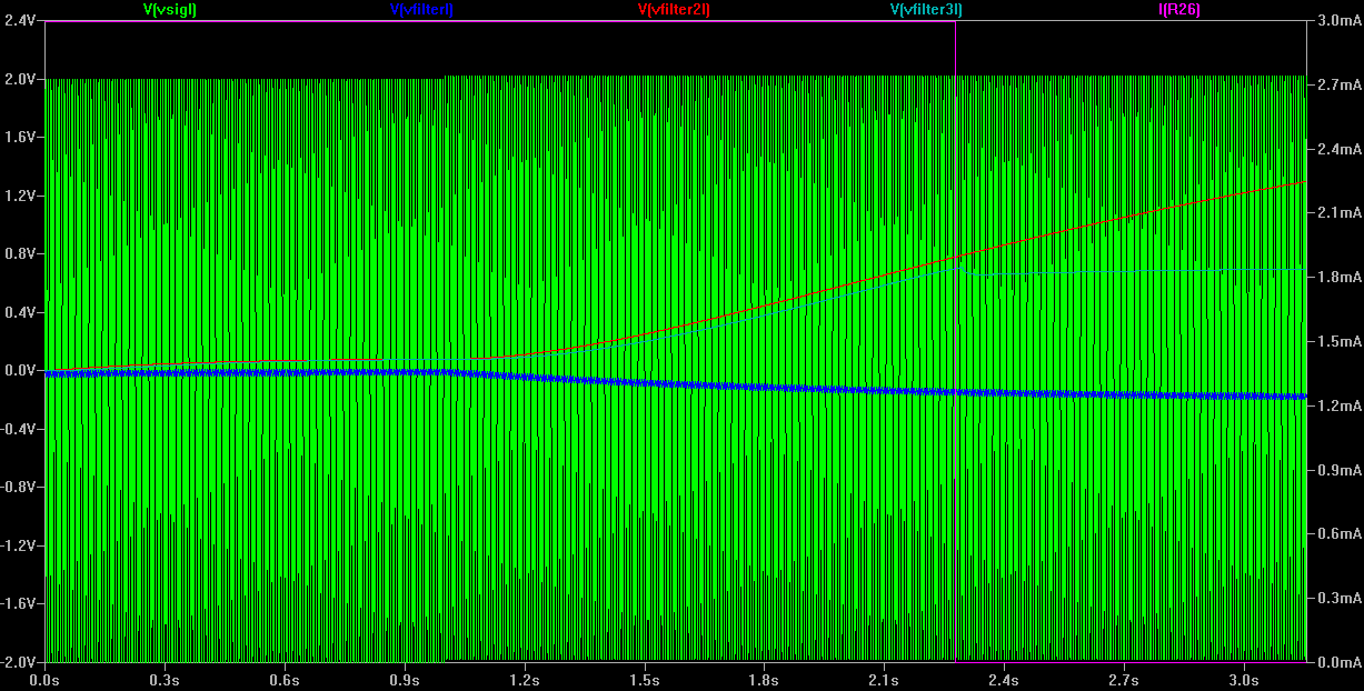

The second plot shows the transient response when a fault of 20mV occurs at the 1 second point (20mV of DC shows up on one headphone output). The circuit takes about 2.3 seconds to switch the relay, which is the transient delay through all the filters. The the input signal is in green (2.5khz so it looks nearly solid here) and relay current is in purple. The output of filter section 3 (1K in series with the 100uF), the aqua plot, clamps at 0.7Vdc since it is feeding a transistor B-E junction, of course. Voltage scale on the left and relay current scale on the right.
The final two transient plots show the more "difficult" cases for the filters of lower signal frequencies at 150Hz and 20Hz. The filter delay at 150Hz is still about 2.3 seconds until the relay switches off, while at 20Hz it shrinks down to about 1.5 seconds.
e-12 booster with O2 pwr transient plot 20mV at 1sec.png19.8 KB · Views: 94
e-12 booster with O2 pwr transient plot 20mV at 1sec 150Hz.png29.7 KB · Views: 104
e-12 booster with O2 pwr transient plot 20mV at 1sec 20Hz.png38.3 KB · Views: 111
