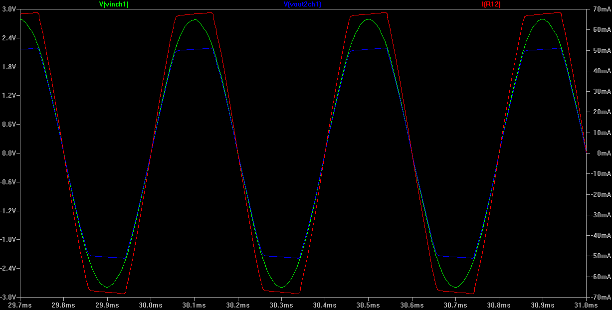

I ran some LT Spice simulations, below. The first concern with the modification is whether the single section of the NJM4556 can handle the current load of the 32R K550s at normal listening levels, or if the parallel buffers would be needed. A second concern is stability against oscillation in removing the 1R output resistors entirely with a typical headphone cable capacitive load. A third concern is whether the new +/-6Vdc power supply rails provide enough voltage headroom across the output devices in the NJM4556 when pushing 36mA(peak) or so.
My back of the envelope math seemed to indicate that a single section would do, since 1.1Vpeak going to the phones (which should be super loud as ethanolson mentioned given the K550s sensitivity) should be around 36mA(peak) [= 25mA(rms)]. Sure enough, that is what the first plot below shows. Green is the 1.1Vpeak input signal to the amp (and on to the phones since the "pot" is all the way up), blue the output from the 1:1 current buffer, and red the load current on the right axis. I still have 390pf across the 32R load to simulate some headphone cable capacitance.

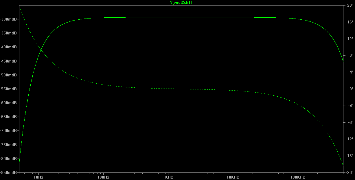

The second plot is the frequency response. Still the same as the unmodified O2, as it should be, with the exception of a slightly higher RF 3dB point since RocketScientist had some compensation in the gain stage.

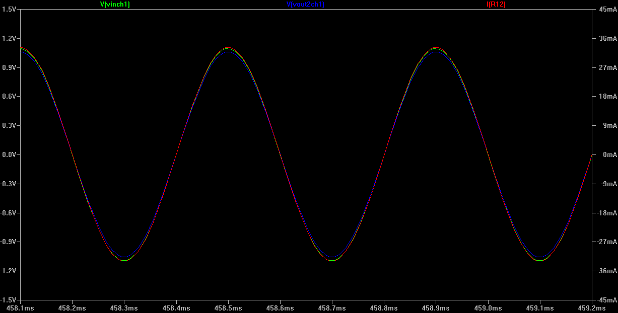

The third plot is an intentionally huge input signal to force clipping, to roughly test the accuracy of the device math model being used for the NJM4556. The output current for the single section limits at 70mA, exactly like it is supposed to, and the voltage overhead (output device minimum resistance in the chip) of the NJM4556 is about 4Vdc at 70mA (2Vdc across the phones = 6Vdc rails total). That is better than I was expecting. My back of the envelope came up with about 4V at the 36mA, which is why I picked +/-6Vdc rails. This would indicate +/-5Vdc rails may work for normal listening levels, but that is starting to split hairs and would have to be confirmed with some scope measurements. I'm leaving the rails at +/-6Vdc to allow some extra voltage headroom.
With the gain stage gone one slightly negative effect will the input impedance and upper (RF) corner frequency varying slightly with the pot position, since the 40.2k bias resistors on the output stage are in parallel (ac circuit model) with the pot wiper. Shouldn't make a bit a difference with any sort of normal source device, from what I can tell. On the plus side no forced clipping with large input signals, like my two sources that output 2Vdc, since the pot attentuates the input signal from 0.0->1.0 the standard way.
Input power to the NJM4556 chip would be around 25mA(rms) * 6V = 150mW. Subtract what the phones use per channel, (25mA)^2 * 32 = 20mW leaves about 130mW dissipated in the chip. Well within specs of 350mW per half (700mW total for the DIP8 chip). I've shown in previous posts you really have to plot a few points vs. output voltage level to find max chip dissipation, but this is far enough within specs it should be just fine.

O2 current buffer plot 2.5kHz 1.1Vpeak input 32R 390pF load.png26.5 KB · Views: 415
O2 current buffer AC plot 5Hz to 500kHz 32R 390pF load.png20.9 KB · Views: 411
O2 current buffer plot 2.5kHz 2.8Vpeak input 32R 390pF load.png29.6 KB · Views: 403

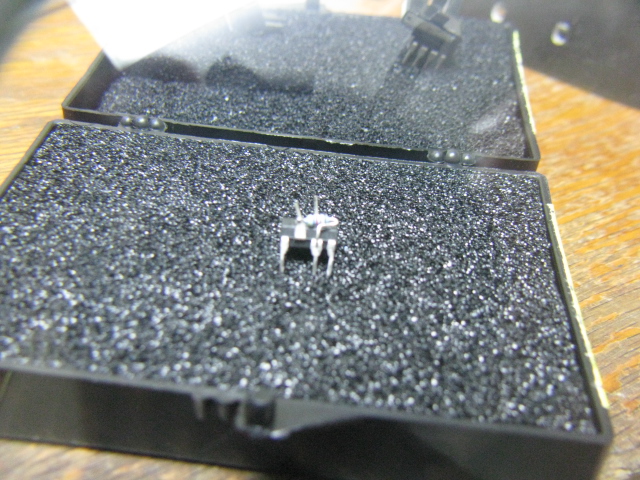

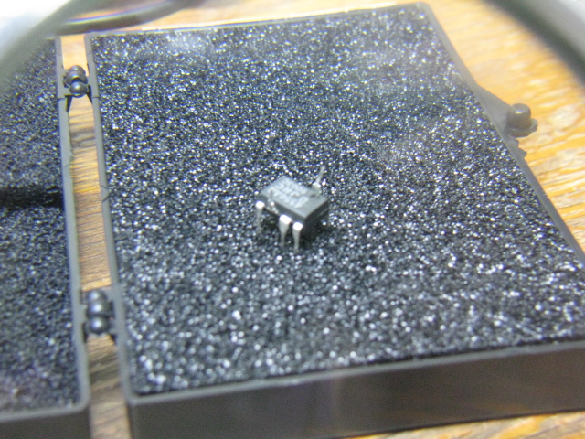

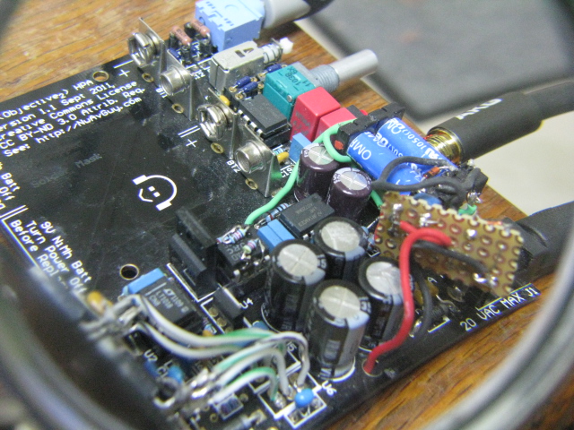

O2 current buffer offset reduction mod tests
Well, I did it. 😀 Mod built and tested below, complete with pictures, using both regal's feedback resistor and a LME49720 in the same circuit. Either way worked well, below.
regal: Interesting thoughts about the offset! I agree the O2 would probably make a good instrumentation amp, given the low noise floor and distortion. With the coupling caps removed it could even be used with DC things like strain gauges. 🙂 I'll bet it would be very linear from that -9Vdc t0 +9Vdc.
ethanolson: thank you for getting RocketScientist's input!
This is using an O2 that is built up the standard way with the two output op amp sections still in parallel on each channel. For just testing offset reduction here I didn't want to also mix in unparalleling them yet.
I replaced one NJM4556 with a LME49720. For the other one I built up regal's feedback mod, putting a 40.2k resistor between pins 1 and 2, and another between pins 6 and 7 after disabling the existing PCB short between those pins for unity gain. In actual practice that turned out to be a bit harder than it seemed, since the PCB traces that connect 3 of those 4 feedback loops (both 4556 op amps) are on the top of the PC board, covered up by the IC sockets if you all ready have the board built, which would require removing sockets to cut the traces.
Instead I bent pins 2 and 6 on a NJM4556 up and soldered the two 40.2k feedback resistors on top of the chip. Bending the pins up disconnects them from the PCB traces (they don't go into the socket holes), of course. The first picture below is the NJM4556 with the two pins bent up. The second picture is the resistor from pins 6-7 crimped on before soldering, and the third picture is both resistors soldered on. In the final picture that is an LME49720 in the rightmost NJM4556 position, and of course the modified NJM4556 in the left position.
The LME49720's DC offset actually measured 0mV, below the LSB of the meter. The the NJM4556 measured 1.5mV, down from the 3mV I measured before modding it, so the feedback resistor modification worked well.
The interesting thing was the listening test. I could hear (completely subjective, your mileage may vary!) that one channel seemed to have a bit better sounding bass than the other. I assumed the good bass was probably the NJM4556, since it had the best current capability. So to save from tracing wires to find out which channel was which chip, I just pulled out the LME49720 chip and powered it up expecting the better bass channel to be remaining. To my surprise that was the wrong channel. 🙂 The LME49720 was the one with the better sounding bass. So I pulled the modified NJM4556 out and stuck in another LME49720 and listened for an hour. 😀 That is completely subjective though, so take it with a gain of salt. The offset measurements are quantitative and what count here. The LME49720 would not work at all with many phones since it isn't capable of a lot of current. It is just sort of luck that is will work here due to the low current needs of the sensitive K550s.
So in summary either method worked well for reducing the DC offset, using a LME49720 or using regal's unity-gain feedback resistor mod. If someone was building an O2 up from scratch it would be easy enough to cut those three top traces (and the one on the bottom of the PCB) before the NJM4556 sockets were soldered on, then the 4 feedback resistors could be soldered on the bottom of the PCB.

bada bing and ethanolson: good question! The DC offset remaining is 1.5mV. The feedback resistor took care of the offset voltage created by the NJM4556 input bias currents through both inputs (inverting and non inverting) passing through those 40.2k resistors, then reflecting back to the output of the buffer stage. Looks like that was about 1.5mV worth of the total 3mV DC offset.
But... that still leaves the inherent input offset voltage of the op amp itself, which for the NJM4556 is given as 0.5mV - 6.0mV in the data sheet. Looks like it may be around an additional 1.5mV in this case. Some op amps have "null" pins to hook a pot between to null out the differential amp. In this case it could be done externally by putting a pot between the power supply rails, with fairly large resistors between the pot and each rail to reduce the full wiper range to around 0.1Vdc (5mV per turn on a 20 turn trimmer pot), then a resistor from the wiper to the inverting input to supply a small DC offset voltage. Then the pot can be turned to null the output to zero, and it should stay relatively stable with just a bit of temperature drift. See figure 1-42 here, along with the associated writeup: Op Amp Applications Handbook - Walter G. Jung - Google Books (no R1 in our case). The LME48720 was 0.0mV since the input offset voltage is also much lower than the NJM4556, along with the input bias current being much lower. Took care of both issues.
I'm probably not going to mess with the additional circuitry to fully null, since I'm really finding an amp just isn't needed at all with these AKG K550s and the sources that I have. If I do I'll pop in the LME49720s in place of the NJM4556s. I've spent some time now A/B-ing between a DAC + O2 current buffer and just the headphone output jack on a Sony laptop. I'm finding the sound difference so small I can just eq it out. Not worth the hassle of even firing up the amplifier. 🙂 But if someone does add the circuitry to null the NJM4556 out the rest of the way, please do post! If the additional circuitry was added for a full null, I would still leave those output resistors on the NJM4556 if they are to remain in parallel, but they could probably be reduced to 0.5R or even 0.1R. But with the low current needs of the K550s I still think a single half of the NJM4556 would do the job - no need to parallel - in which case the output resistor on the remaining section could be eliminated.
