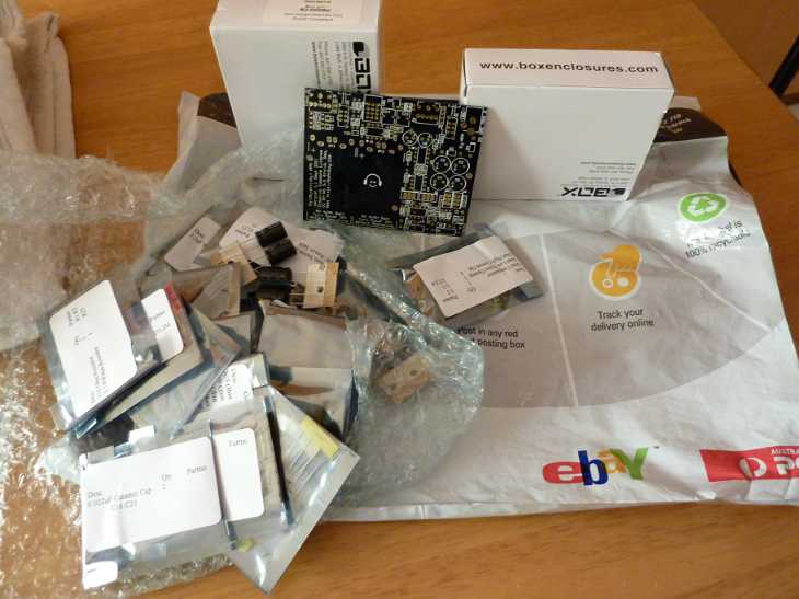

Well, I'm thrilled to say that the package from BF arrived about 20 minutes ago. (mail deliveries on Saturday - go figure
My initial impressions of the kit is that BF has done a top notch job in labeling and packaging the components.
I'll check off the parts this arvo, build it this evening and report back as ASAP.

I have checked the parts in the kit and found 2 relatively minor issues. I have provided feedback directly to BF.

I was hoping to build the amp tonight and post any other observations, but I didn't have a dead 9v battery on hand. So, I'll leave the build while I create a dead battery overnight.
The two issues are the size of the resistor for R16 & R22 - as already identified by hochopeper - and that my kit was missing the dip sockets. As I said relatively minor, but worth pointing out before BF sends the kits.

I've started populating the board. Those 1.5K resistors for R16 & R22 are not going to fit very well at all. Using the larger resistor will mean that they will have to be tombstoned or otherwise just jammed in there - not nice.
Farnell have some small 1.5K resistors in stock. I'll buy some and send them on to BF for inclusion in the kits ASAP.
The second matter is only of concern to new builders. BF has grouped and packaged several resistors into anti-static bags, and then labelled the bag with the contents. This means that each of the 4 or 5 anti-static bags containing resistors contain several values of resistors, which means that you MUST measure the resistors before installing them - so for any newbie builders; get yourself a DMM (even a $10 one from Bunnings) before you start.
