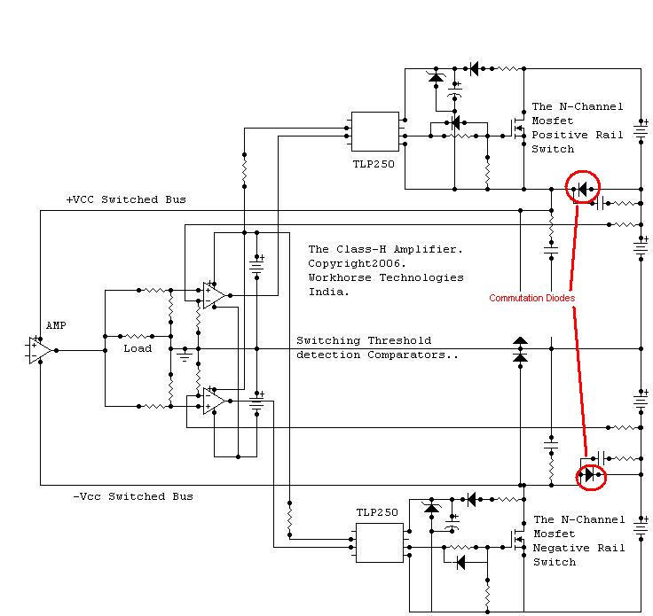

The Switched elevation from lower to upper rail voltage is 45V....First Tier at +- 45V and Second Tier at +-90V....
Ok, but that's the rail voltages, but respect to the output signal when do you switch in the upper rails voltae, that was my question, eg. if lower rail is 45 volt then you switch in 90 volt when the output reach perhaps 42 volt, right?
You know that the miller capacitor grows extremely much the last volts so why switching in exactely at 45 volts, besides if you switch in at a lower voltage you don't need that gate diode and can keep much softer switching without the risk the output FET's would run into clipping.

Ok I get it you were asking about the margin left between when the FET switches....then its about 5 volts....The FET switches to upper rail when the peak output voltage reaches 40V.....
Acc to me slow switching leads to higher dissipation in linear region curve of FET...Correct me If i am wrong....

Hi Kanwar,
sorry for my delay, bussy weekend.
Yes you are absolutely right, the slower you switch on/off the switching FET the more switching losses you will see.
But you shouldn't focus too much on that, it's still small comparing to OPT losses due to slow transients in the bass region, you still will have considerable gains with the Class-H topology.
Don't forget if you have an army OPT FET's you have a very large Miller capacitance, IF the switch FET have a very fast dv/dt you can encounter AMPERES of gate drive current during the switch time, do your drivers manage that? (eg. which mean the output signal will jerk every time you switch between lower and higher rail despite of the FB.)

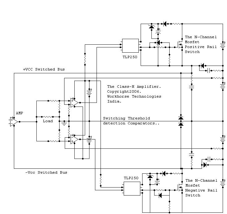

High dV/dT rate will result in higher gate current demand...my TLP250 drivers could source/Sink 2 amperes of gate current...
I have slowed the Switching speed and updated the schematic....increased the marginal headroom voltage to 8 volts from 5 volts also....spikes are very much lowered....
No Andrew , its insnot cross conduction, but it appears more like a Seamless transfer between 2 Tiers through a Switch which is a mosfet and the supplies cannot cross-conduct because there is always a Series Commutation diode present in between them....

Hi Andrew,
This is the diode which helps the current from lower Tier to transfer or commute to the Switched bus of amplifier when the upper Tier is Switch is OPEN not in conduction mode.....

is the
is the
the diode beside the RC next to the lower voltage supply?Series Commutation diode

Kanwar,
good to hear it developes well!
Just a clarification to my previous post, what I meant was not the switching FET, but your output FET's in your audio amplifier when I wrote OPT.
The input capacitance in your switching FET is small in comparisson with your OPT's in the amp section, it's here you will encounter big gate current durig the switching time all dependent on the dv/dt. But the softer you drive your switching FET the smaller the gate current in your OPT amp section.

Hi Michael,
Thanks for clarifying the information.....The gate drivers of output transistors are PushPull types BD140/139 therefore peak current of 1A is obtained easily...I have already soften the switching of Tiers....
