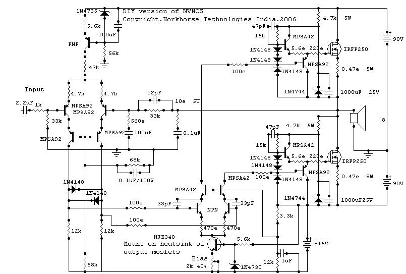

HI Kanwar,
Did pay a visit to the local Mkt. Unfortunately it is not as well stocked as the LJR Mkt at Delhi. Summer being at its peak the heatsink arena is dominated by the plain regular vertical finned invertor/UPS types. I was unable to find a suitable one wherein I can orient the mosfets on the sides along the length for proper forced cooling.
On second thought I went thru some QSC designs and found even they follow the edge placement approach with one fan in middle catering to cooling of both channels placed back to back.
Given the limitations I feel placing the devices on edge is better option as we have a wide choice there where heatsinks are concerned.

QSC Designs are Class-H ones much efficient than class-B designs therefore they prefer edge placement of devices and also produces less heat in comparision to Class-AB designs...

Hi Rahul,
Have a look at this latest schematic for your easy to see reference....
