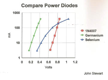

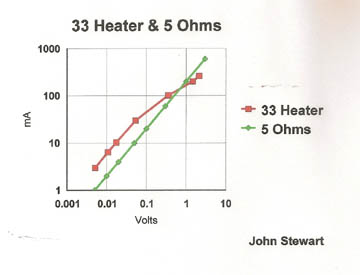

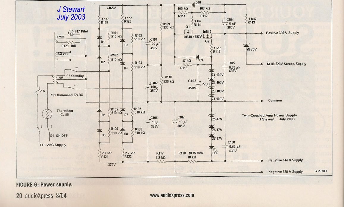

I've built audio amps & a wide variety of electronics for many years, with & without surge suppressors. No problems at all either way. One monster had a measured surge of 400A from a 240V line.
Beginning long ago while still working in a research lab I starting looking at the properties of various devices, not usually found on the data sheet. Some of that was the cold vs hot operating temperature. That included tube heaters such as the 6L6 & 33. I found the ratio to be in the order or 9-10, that is the heater had ~10X the resistance hot is it did cold. In many common consumer products the supply transformer limits that simply thru the benefit of a cheap build.
Later I looked at various semiconductors, incandescent lamps, LEDS & so on. All this information is worth knowing during the design phase. In later tube builds I included standby switches & measured both on & off line power real & reactive. And the harmonics back into the line. These in a residential area are nowhere near the problem all the other non-linear loads impose on the power system. For those unfamiliar, the 3rd, 9th & 15th harmonics are additive in the 3-phase source at some point in the power system. Both single & 3-phase transformers have to be sized to carry that excess current. Skin effect & proximity effect limit what the transformers can do, they must be oversized.
I've noticed many here on DIY talk on & on but often do nothing more than some simulations. Some threads seem to go on for a year with no hardware in sight. Not a good sign in my opinion.
Some might wonder who I am, check the BIO. And then the many articles on amplifiers & other devices in Glass Audio & AudioXpress magazines. While they were still published on paper.🙂
Attached a few examples of many. Most are on MS Spreadsheets. Ask!

Figure 6 Power Supply Clone of Twin Coupled Amplifier w Caption.jpg271.2 KB · Views: 384

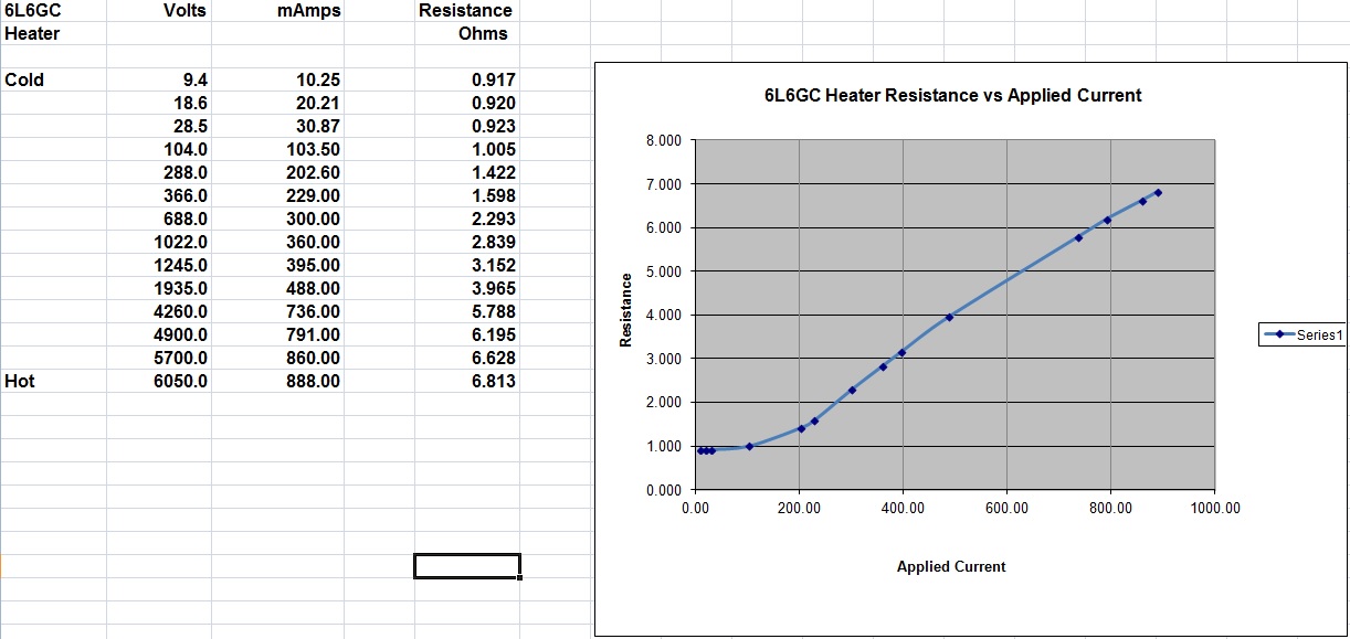

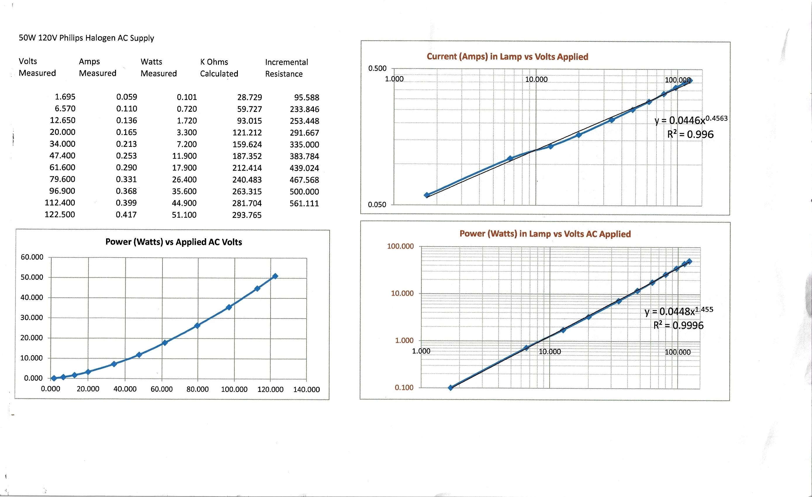

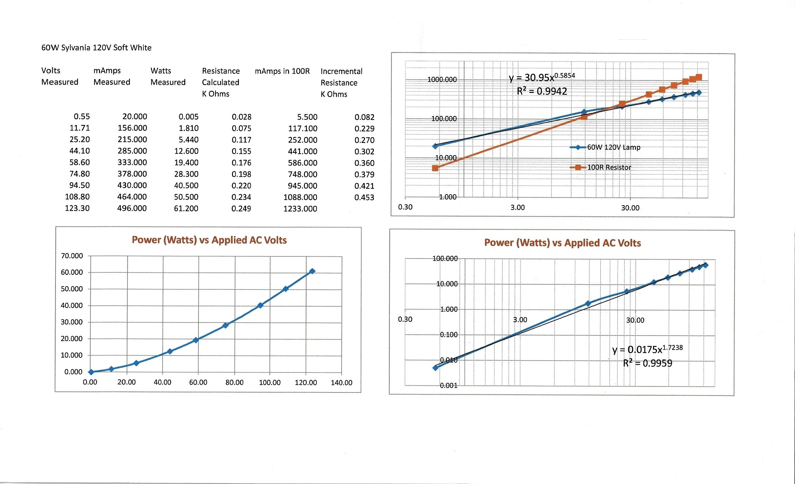

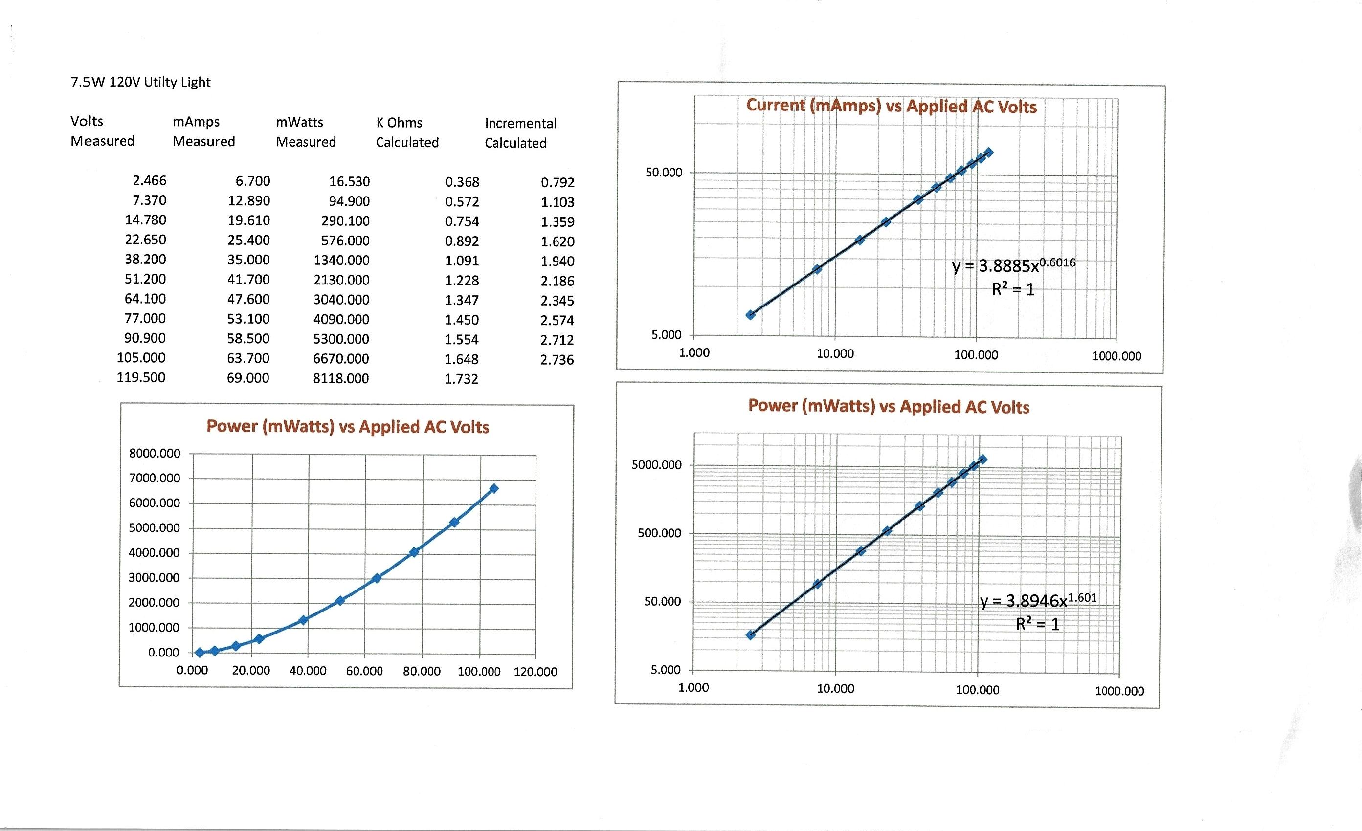

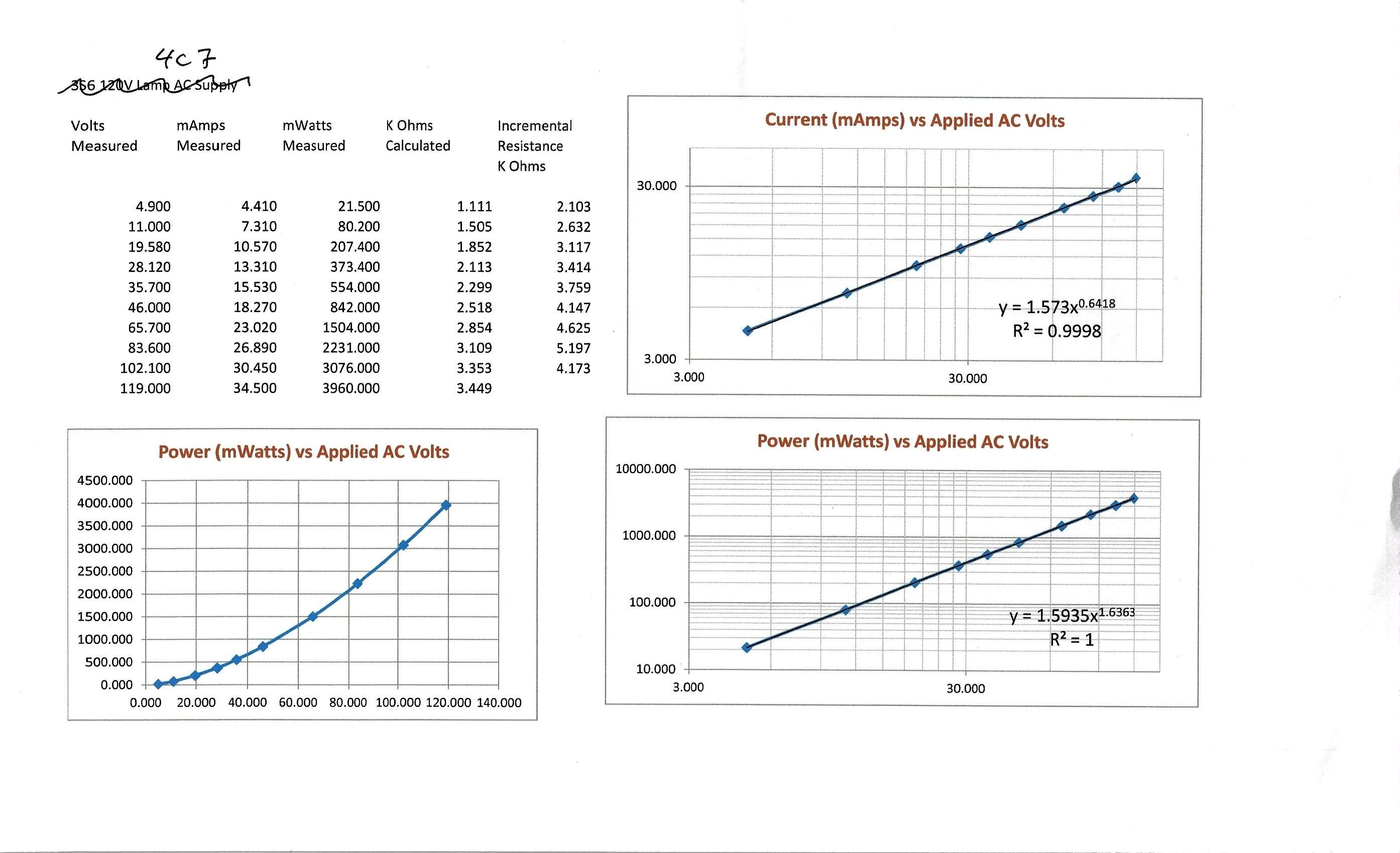

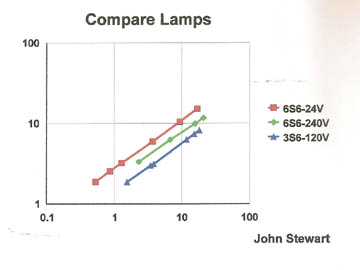

Incandescent Lamp Tests
By popular (?) request here are some spreadsheets of the EI characteristics of common incandescent lamps. On a log-log scale, resistor plots have a slope of one. A square law device has a slope of two, a vacuum diode has a slope of 3/2. Tungsten incandescent lamp slopes are less than one, typically 0.45 -0.60. Their resistance increases as applied voltage is increased. The R2 value is an indication of how well the curve fits. An exponent close to one is good. Carbon filament lamps have a slope of one, thus same as a resister. But no spreadsheet in this group.
The lamps were run up by a Variac, voltage, current & in some cases power is measured using a pair of MetraHit 29S Precision DMMs & Wattmeter. The DMMs is built by elves in the Black Forest. Just Google for a description.
The 3S6 bulb was used in the Heathkit AG9 Bridged T Audio Oscillator. I built a clone circa 1956, it is still here on the shelf in working condition. I sub’d the 4C7, a 4W night light, the measurements of D% were the same.

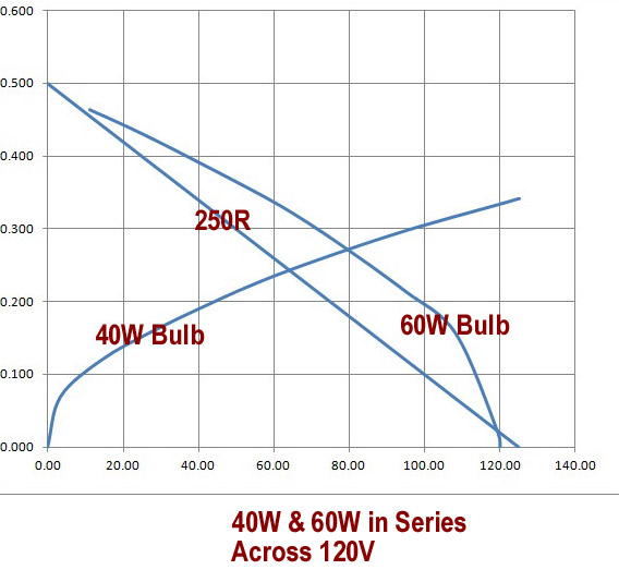

And what happens when a pair of incandescent bulbs are series connected, each is the others load resistor.😀
More later.🙂

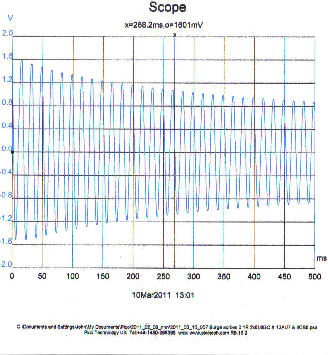

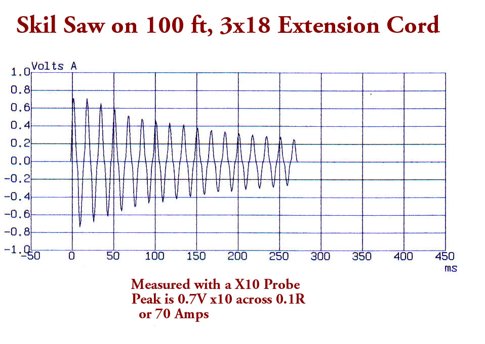

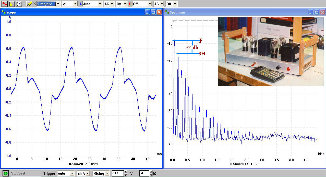

One of these is the first 1/2 second of a 2X6L6GC PP UL Amp. Built circa 1960. Still here on the shelf in working order. There are two for stereo. The front end is a pentode connected 6AU6 driving a paralleled 12AU7 phase splitter. The rectifier is a 5AR4. The PT is a Hammond 273Z. There is another trace somewhere shewing a longer time as the tubes begin conducting. Just gotta find it.
The other is a trace I did something like 20 yrs ago. I wondered what a Skil Saw did to the source while starting on the end of a 100 foot extension cord.🙂

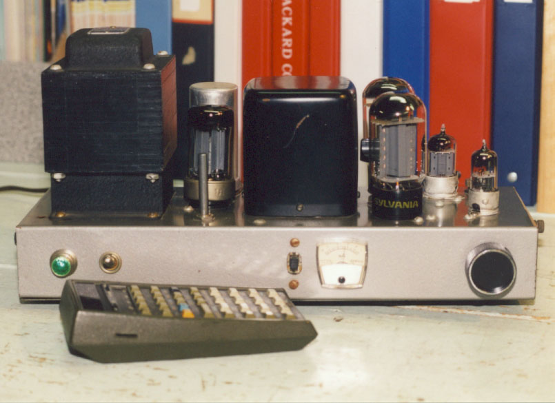

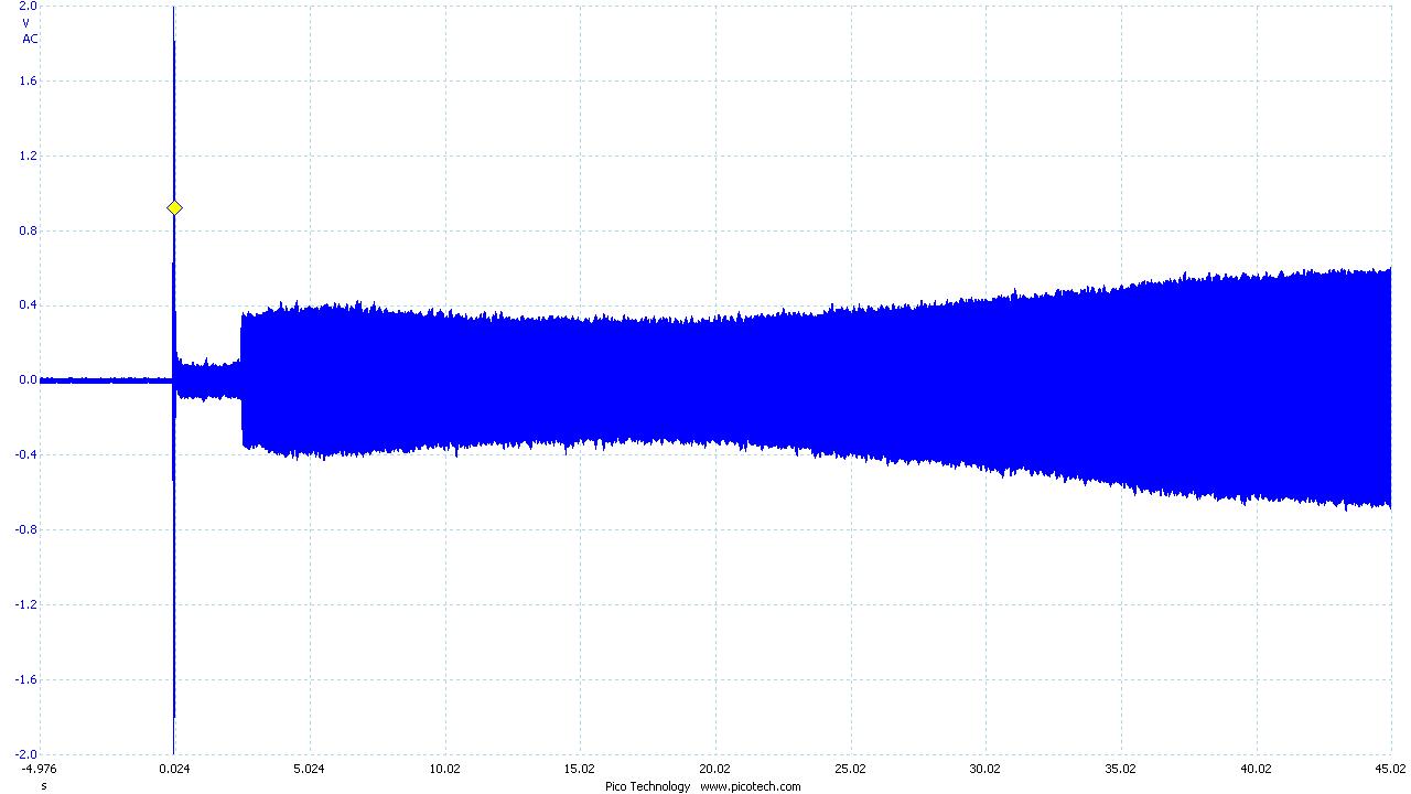

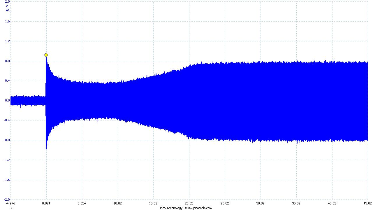

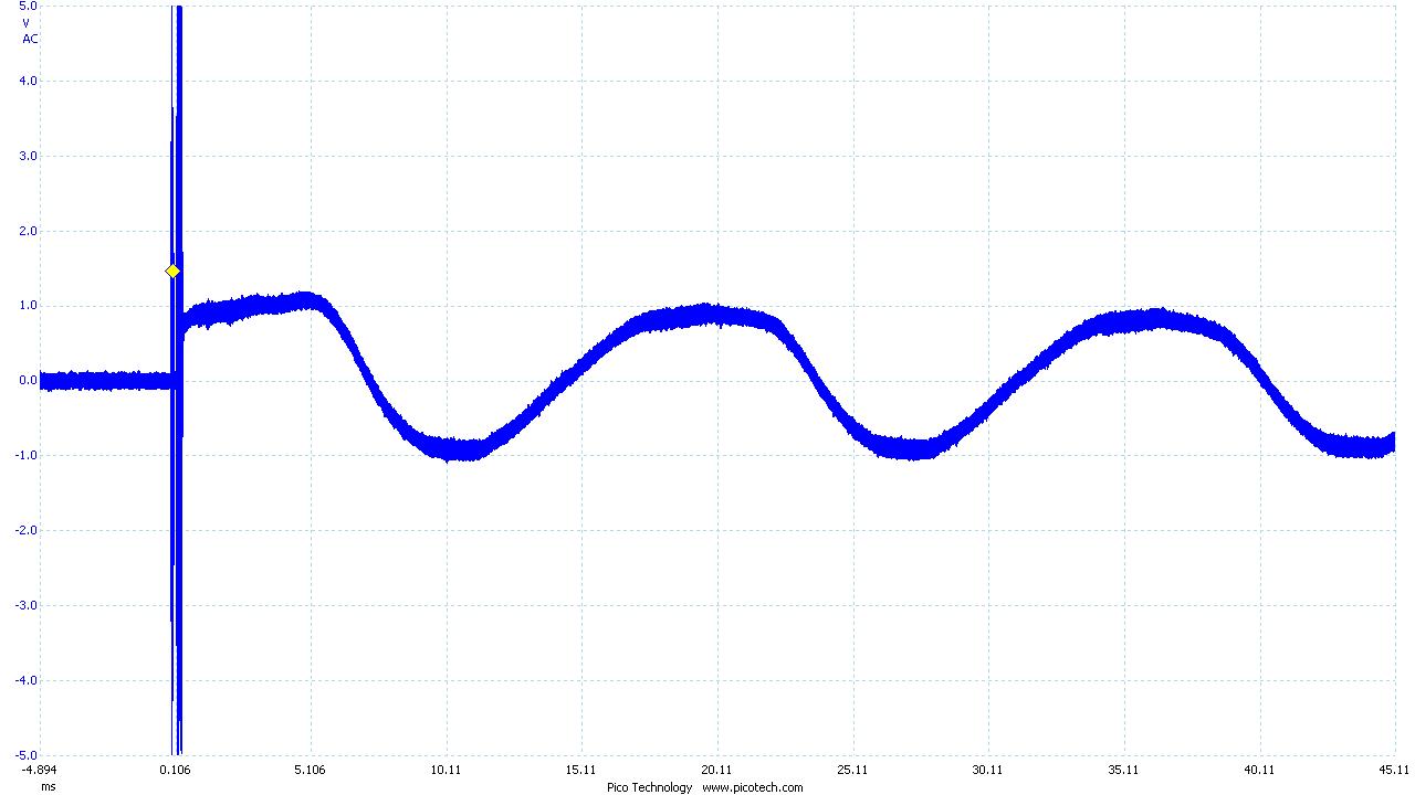

OK 20 to 20, Current vs time plots. But these are on the PT primary where we would normally install a current limiter.🙂
The amplifier in these tests is PP 6AQ5s driving a Hammond 1618 (10K P-P) I had built in 1957. It is nominally 8W. The driver is a 12AX7, one section connected as a normal triode driving the other as a split load phase inverter. The tone controls are a 6J6 connected in a Baxandall circuit. Positive FB in the 6J6 common cathode is avoided, the cathode is taken to common thru a silicon diode. A 12AX7 front end is corrected for a GE VR phono pickup, but for these tests that tube was left out. The PT is a Hammond 270BZ60 driving a 6X4 rectifier.
These single shot tests were done using a PicoScope 3224, 2-channel, 10 MHz scope. The time scales are different. The front end uses a 4 MHz Differential Probe to avoid ground loops. The sample is taken across a One Ohm resister on the low side of the line.
So we see the initial high current drift down as the tubes warm up. When the tubes begin conducting at about 20 seconds the current to the PT increases. Just as we would expect.
As Tim R has pointed out, the proper way to measure the initial current would require a way of switching on the supply at the point where the current would be the maximum. I’ve no way to do that, never built something to make it happen. I’ll leave that to one of the Eager Beavers here on DIY.
In Trace 0009 the startup is thru a Workman Tube Guard, a commercial current limiting device, common in the 1960s used as a surge suppressor for TV receivers. Looks like it still works.
