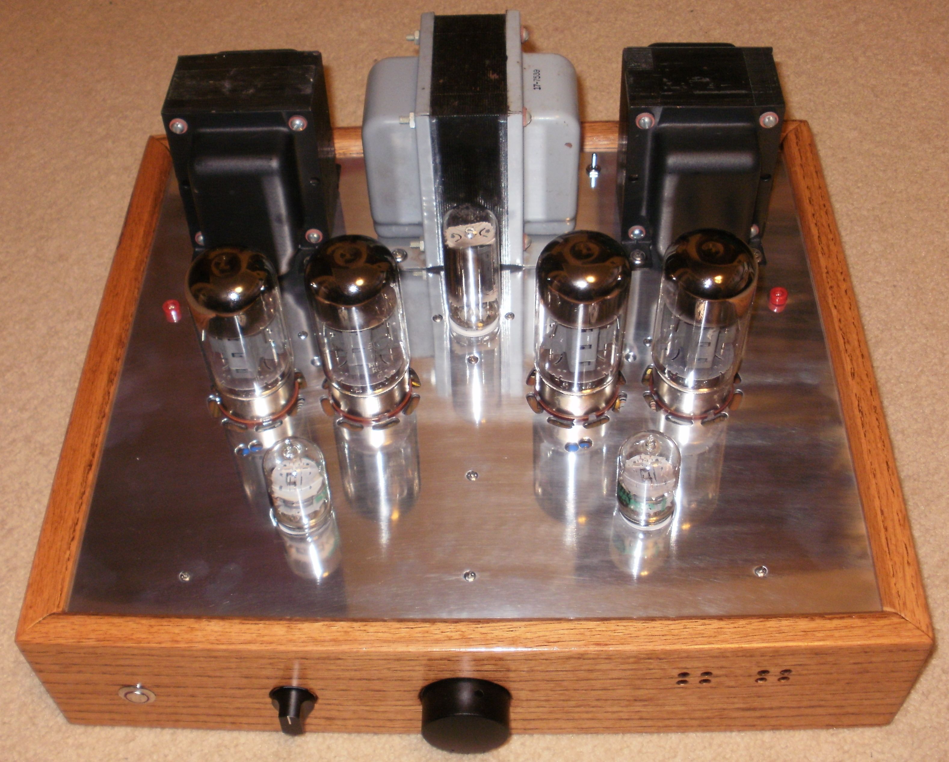

I use a CL80 on the 110 side of the transformer for inrush current control for the first cap. It allows for a smaller fuse to be used. Then C-DIODE-C-L-C. The diode bridge feeds the first cap, Now I place a damper diode as a pass device to another cap that feeds the subsequent filter and B+ bias string. I've done variants of this on many amps and also used it on a slow start for my RIAA and Preamp ( 12AL5 in this application).
The damper diode is the tube in the middle behind the 6550's.
