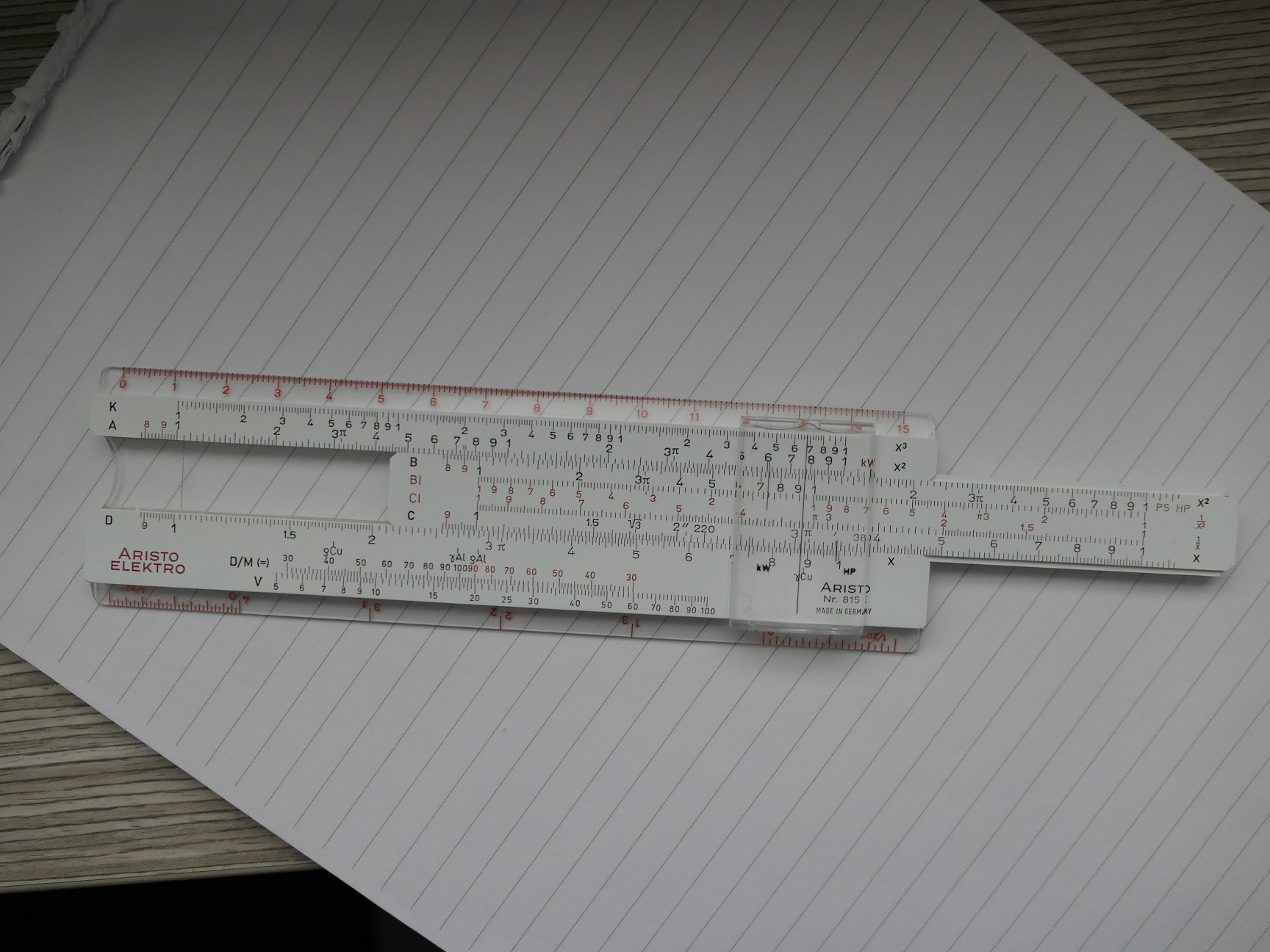

Am finding it relaxing to work with my old slide rule.

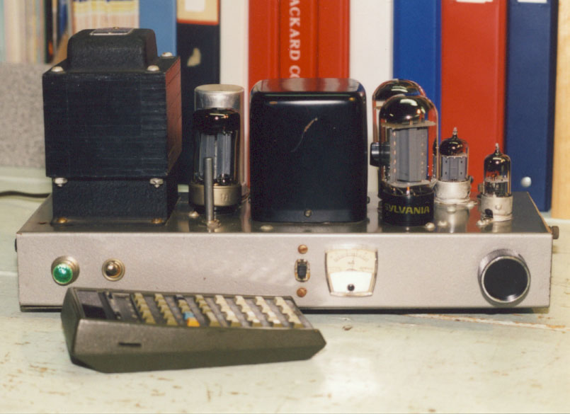

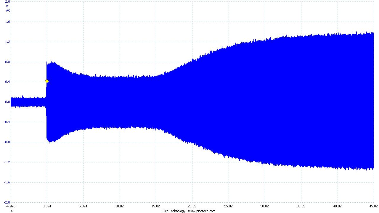

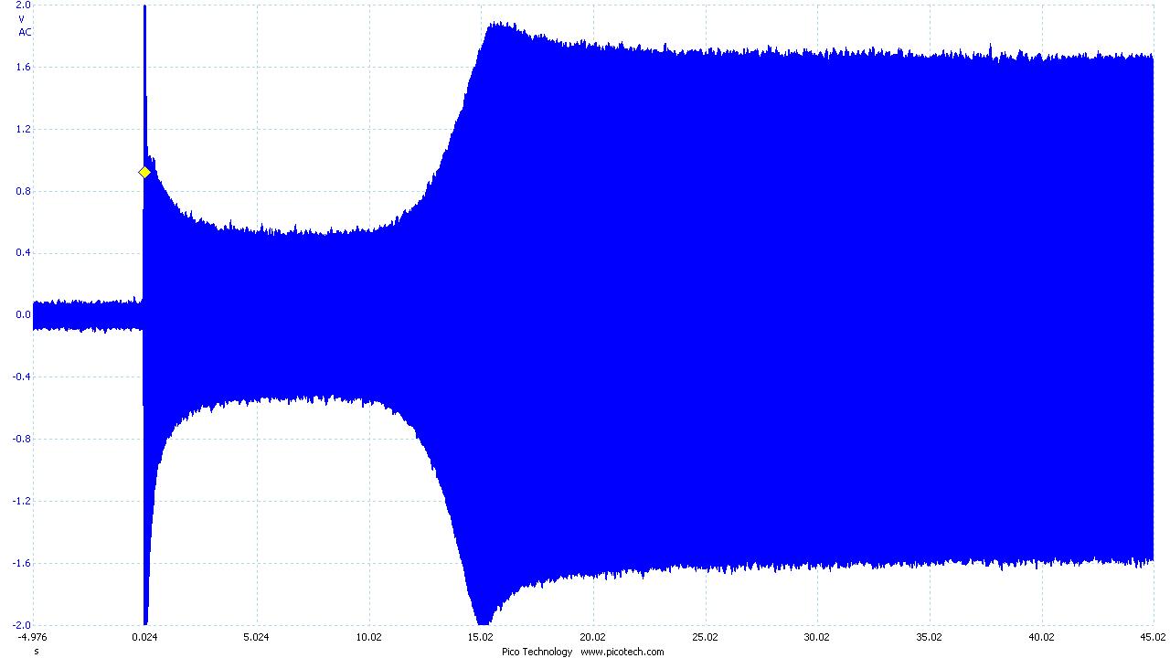

Another Test With & Without Current Limiting
This test was with the same setup as the 8W amp using the Workman TV plug
inline limiter. This time the amp is something I built two of circa 1960. 2X6L6GC UL PP, nominally 25W. The front end is a 6AU6 driving into a 12AU7, both sections paralleled in a split load phase inverter. There is DC stabilization of the front end thru a 12AU7 cathode back to 6AU6 screen connexion. I did a comparison to the regular hookup a few years ago. Just ask. The rectifier is a 5AR4. The OPTs is an obscure Japanese build, they even came with a frequency response test plot. The PTs are Hammond (naturally) 273BXs.🙂
There are both AC & DC Balance adjustments & bias setting. And the audio front end is somewhat protected from large LF transients by a 2-section Hi-Pass network.😀

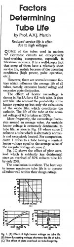

And a note to us from the good Prof AVJ Martin on tube life expectancy.
