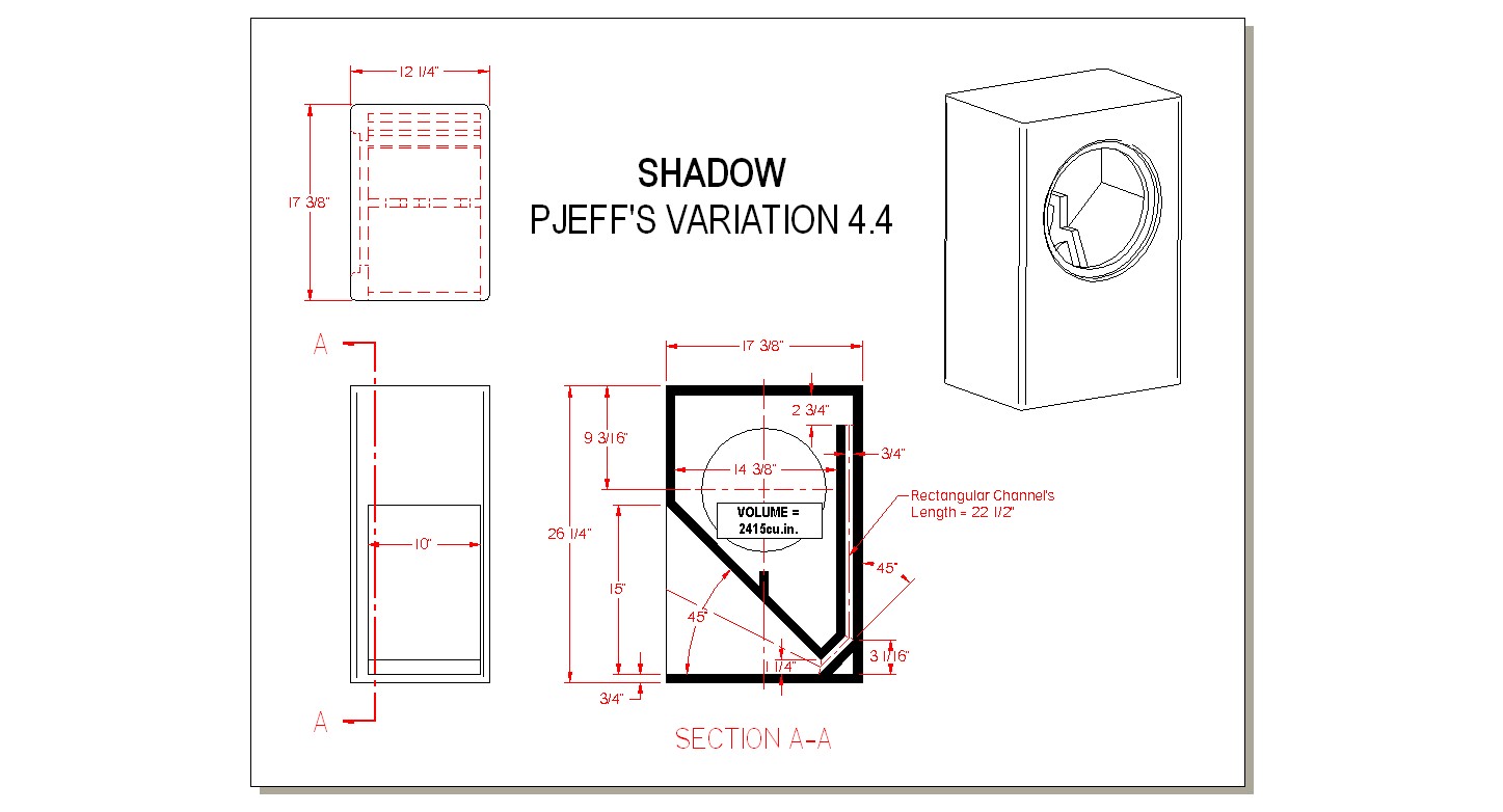

Ok... I slept on it and I've decided to give one of my Shadow variation (Var4.4) a try(Please tell me if you see any problem with my variation... now is the time). Front firing, side mouth, mirror imaged. I'm very intriged by the shadow design so I'm going for it and in order to have something to compare it to, I will build one basic sealed enclosure as well. WinISD gives me a default sealed enclosure of 56.9L for a Qtc of 0.71. Is it optimal for best integration, dynamics and clean sound? My intent is to use them from 60-80Hz and down. If I increase the volume, even to ridiculous values, the Gain curve doesn't change much but the Phase Plot and Group Delay seam to vary in more significant ways... but unfortunately... I do not know how to interpret all that.
So what do you think would be the optimal sealed volume for the Trio12 and could you explain to me why? I would like to further my understanding.
PJeff
PS: The Trio12's are on their way and should be here any day now:D!!!

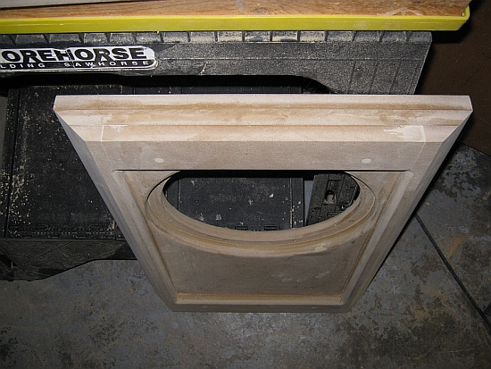

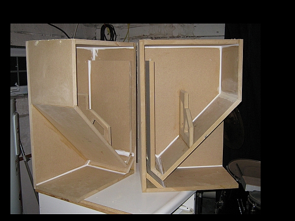

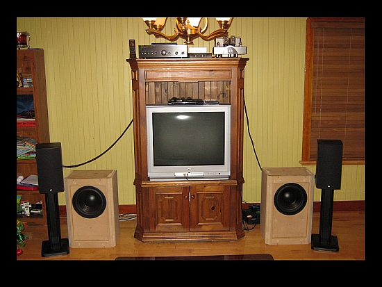

Yes... I did build two ''Shadow PJeff var4.4'' but not the closed box(not knowing exactly what size would be ideal:boggled:). Here's some pics of where they're at...broken-in, without any stuffing or sound treatment inside and still unfinished yet.
How do they sound?!! I've been experimenting a bit on placement and I think they sound pretty good. They're a lot of fun for sure, especially in movies...I did crank them up quite a bit and they never showed any sing of wanting to bottom out.
Besides some frequencies that seams to overwhelm the room(room modes maybe?) the only thing that I would like to improve is the transient/cleanness for music playback.
Do you think stuffing will improve that aspect?:scratch2:
I havent had time to work on them for a little while now experimenting and enjoying since mid september :) but now I want to get to it and revive this really fun project. (I really enjoyed the building phase... BTW they weigh about 75pounds each:D)
Thank you for your interest and help :nod:
PJeff
