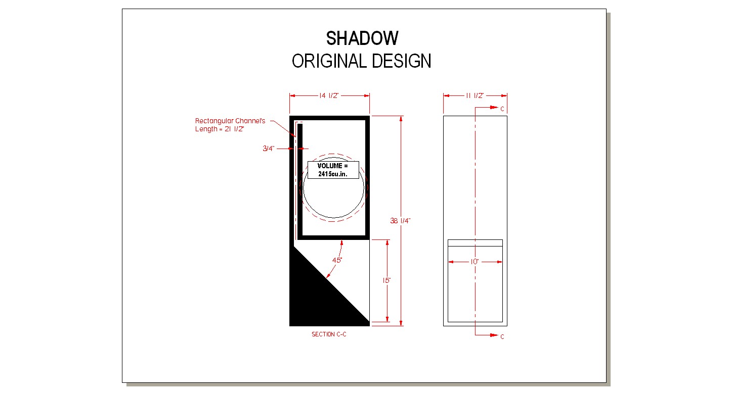

Shadow x 2!!... What is ''shadow''?
Forget about that... I just found the shadow box on your site. Would there be any way to make it about 24inches high? My idea is to use the subs as stands for my monitors. If not possible, no big deal. It just would be nice to be able to do that...
It is possible, but they'd be kinda strange looking.... same concept, 2 orientations. Top is probably better. The cats might like the bottom one.

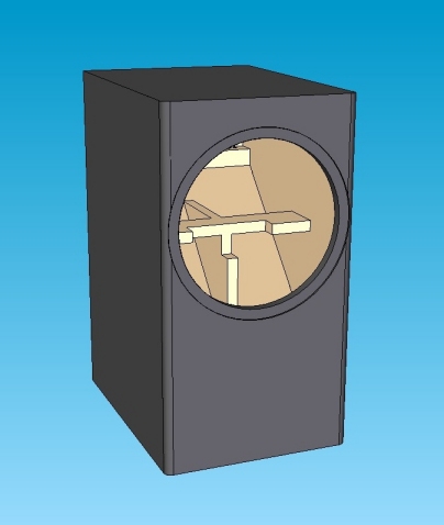

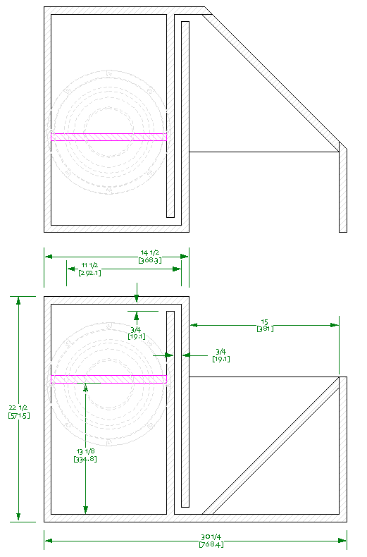

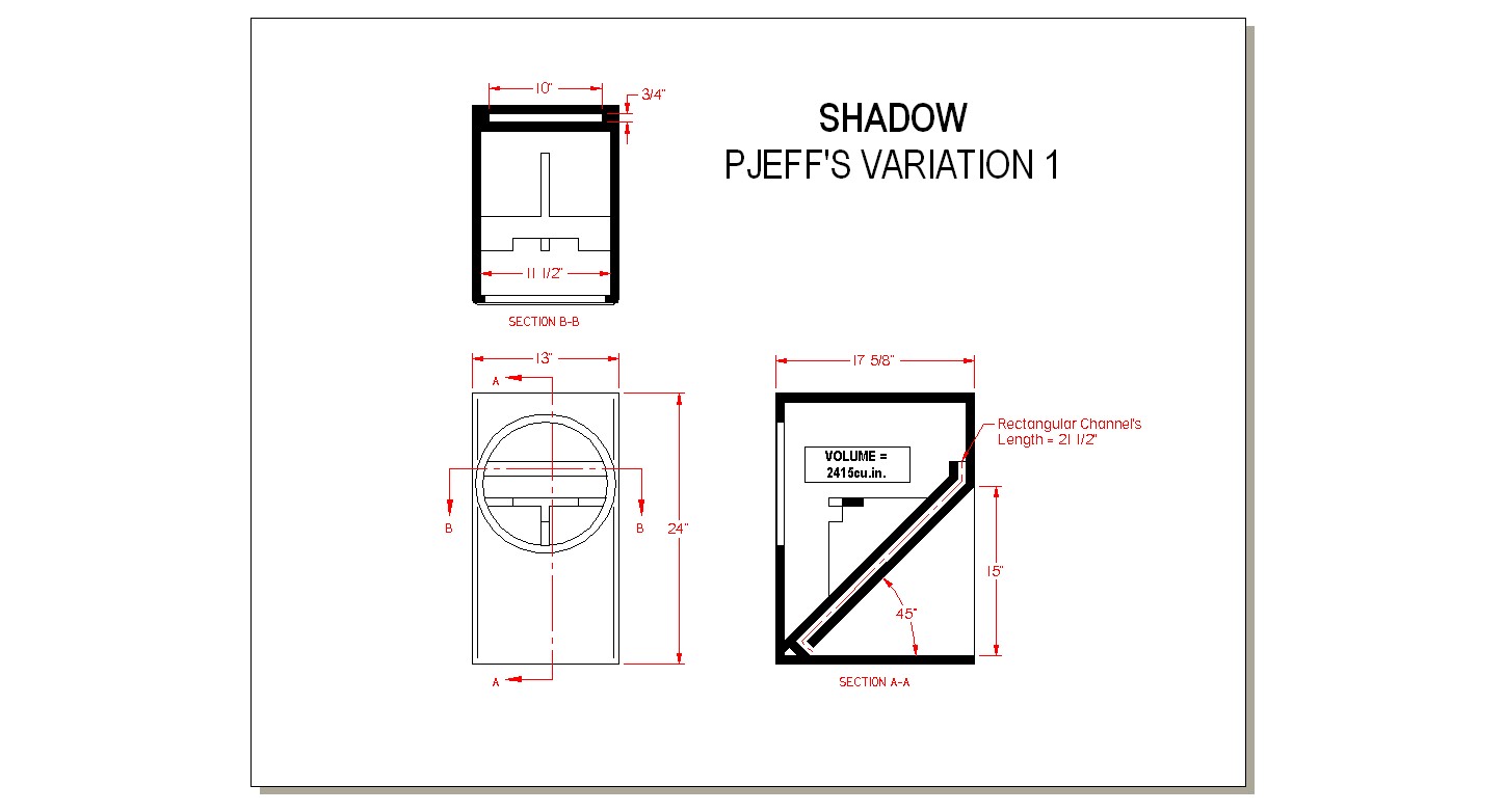

I'm worrying about my lack of phase adjustment so I'd like to have a front firing driver and a cabs serving as stands. With that in mind, I sketched the attached files as an alternative. Would it work? (One is the Original Shadow and the other is my variation1 for comparison)

Now that is clever. I'm going to steal that 🙂
The only issue is that it doesn't seem to have the right throat for the start of the horn vent.
I'll have to redraw it to verify the details.
dave
Thank's for the good comments David and AdamThorne.
That can be very easily adjusted for the throat... and the original drawing says that the ''suggested driver position uses golden ratio''. Not really knowing what that is, the driver position might have to be adjusted as well.
I'm really busy preparing and hosting my oldest daughter's birthday this weekend so I probably won't have much time to work on the fine-tuning of my variation this weekend. But as soon as I can I will adjust the throat and i'll be waiting on anyone's comment for further mods.

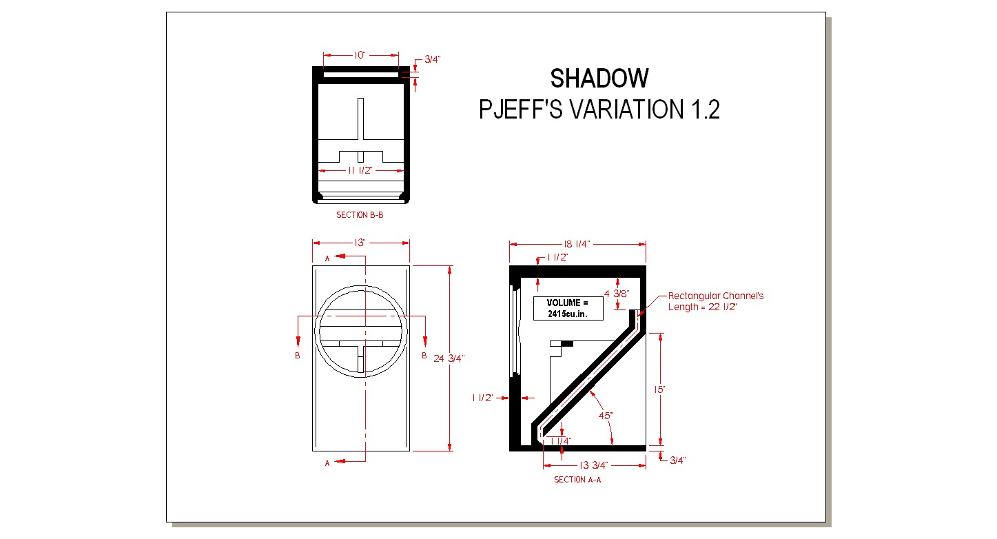

I'm back with a possible solution to my variation about the throat dimension and it includes also the correction of an error I had made in the rectangular channel's length.
Do you think this is an equivalent variation to the original?
