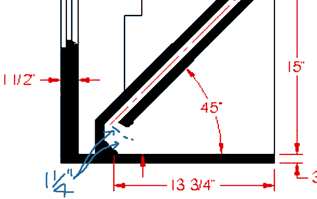

Here's a pic to illustrate the first point of my previous post.
You get even more versatility by doing mirror pairs of the 1st one with side firing mouths.

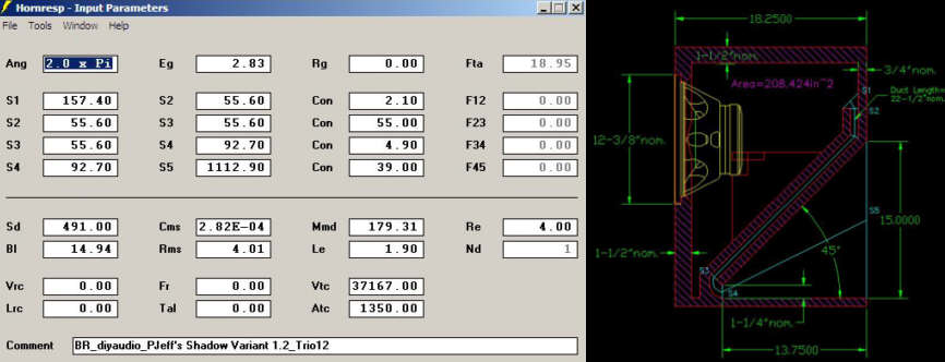

Simulating PJeff's Shadow variant 1.2
Hi PJeff,
This may be as good a project as any for getting into Hornresp 🙂. Here is one way this can be simulated in Hornresp. Basically as a back-loaded horn with a large throat chamber, a short coupling section to the straight duct, and a second coupler to the port horn. After hitting calculate you must use the combined response button to see the in-room total, the path length is probably in the neighbourhood of about minus 45cm. You can also use the sliders in the Horn Loudspeaker Wizard to modify the individual dimensions.

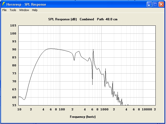

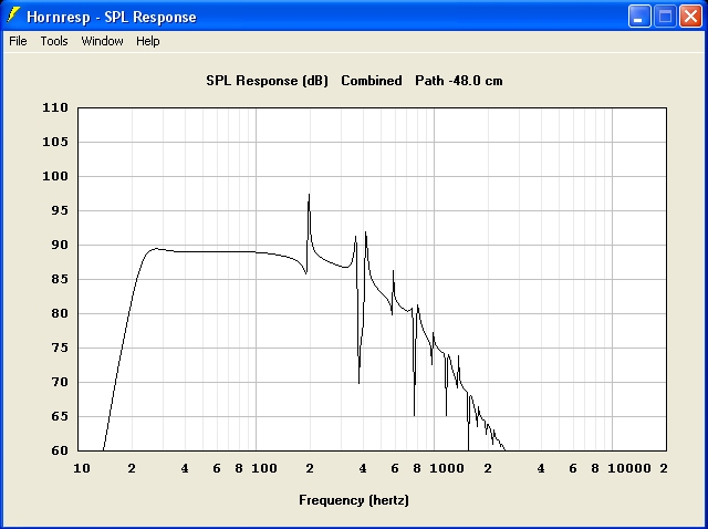

Thank you for this tb46,
I've played around with that and what i've noticed, with my limited knowledge, is that the extension is somewhat limited in the Shadow enclosure compared to something like a ported 119L box tuned to 20.6Hz(see attachments). Do you see any advantage the Shadow has in other areas? Dave any thoughts?

Sorry, forgot the attachments... Here they are...
