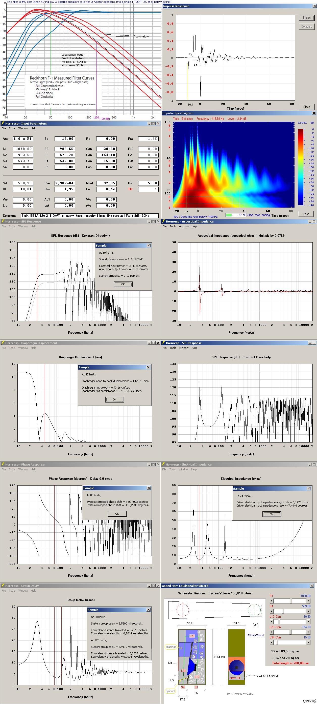

Yeah, it could work, but I think we still need more info...
How low do you want to go? (using headphones and a signal generator is good for choosing...)
What size is your room?
How loud do you want to go?
How big can the subwoofers be?
What's the budget?
For a start, though, I'd begin playing around on winISD.

Given 30Hz as a target (pretty sensible...), a pair of 12" drivers should suffice. A single 12" driver, in a sealed cabinet, would move 8mmp/p (peak to peak) to hit 30Hz at around 93dB.
Dual drivers would half the excursion, so most pro audio drivers will do the job.
I have an Eminence Beta 12, and that does the job well. It has reasonable linear excursion, but (perhaps more importantly) around 99dB@1w efficiency. With a Linkwitz Transform in place, you'll be going at around 40w total output (2x20w seems reasonable), hitting 95dB at 30Hz. The cabinets would be 50 litres each. They're £40 each here, which is a bargain, in my opinion. It's not a driver designed for subwoofer use, but it has enough excusion and power handling to be a good option for a lower budget.
Edit - just noticed your budget. Perhaps either something better by Eminence (or another Pro Audio manufacturer), or something aimed more at the hifi market would be in reach.
The Eminence LAB12 could be something to consider. More excursion, but lower efficiency (still not bad, though)

I might point out that Hoffman's Iron Law does not say that deep bas has to preclude efficiency. It just says that you need a freakishly enormous box.
I've seen some nice things done with small drivers and tapped horns - you could conceivably build some 30hz horns using Tang-Band 6" subs that you could use as speakers stands. While the efficiency isn't awe-inspiring, it's hard to argue with the form factor.

It would be far far cheaper to build something yourself. There are lots of active crossovers out there.
Active Filters Those will cost next to nothing to build on some stripboard or something like that. It would be better to play with $5 of components, than $135 on something that does the same thing. I made the circuit shown above (just the low-pass), and used a 100k stereo pot instead of those resistors. The result was a variable cross-over. This won't work for the high pass. You'll need a variable capacitor for that...
WRT the tapped horn, there's a couple of compromises that I know of... The size is still bigger than a sealed box for the same driver, the construction becomes more difficult (lots of pieces, and the all have to be in exactly the right place). In some cases of horn loading, you can't hear the driver hit the stops, so you have to be careful. Dunno if that applies to tapped horns.
On the positive side, it gives good low frequency extension, and brings efficiency up.
For the TB driver, you can get similar extension from a ported box, but the overall efficiency stays low... (still, by having a smaller cabinet when vented, you could add more later...)
Anyway, I'd cross your monitors over. Saves them going to any excursion when you've got a sub to do the pushing.
Ohhh - just noticed that the frequency response of that TH has boundry gain added (ie, on the floor, up against a wall...). Add that to a sealed design, you can also get pretty low (before even adding a Linkwitz Transform).

It wouldn't be easy to replicate all of it, but it would be easy enough to replicate the variable low pass filter.
You'd need 2x the filter I posted (it is powered, btw, but that's not shown. I power mine with around 12v, tapped off the pre-amp PSU), and replace all 23.7k resistors with a 4 channel potentiometer (that way, you get stereo).
I'd go with Dave's offer, but getting it as a kit would give you some experience of building audio stuff...
Anyway, for driver choice, it's going to be a trade-off, but staying around 12" would probably be wise for a subwoofer (it's a pretty common size, so you've a better chance of finding something you're after. That said, if you see a tapped horn, and it's easy enough to construct etc, don't rule it out based on driver size...
Looking on parts express (where will you be ordering from? - I guessed there, but I could easily be wrong), the 12" PA woofers are pretty cheap, but the "hifi woofers" start out equally cheap, but get a lot more expensive very quickly...
