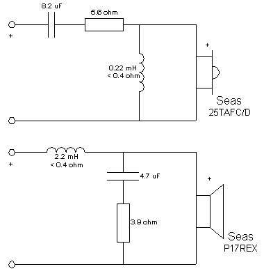

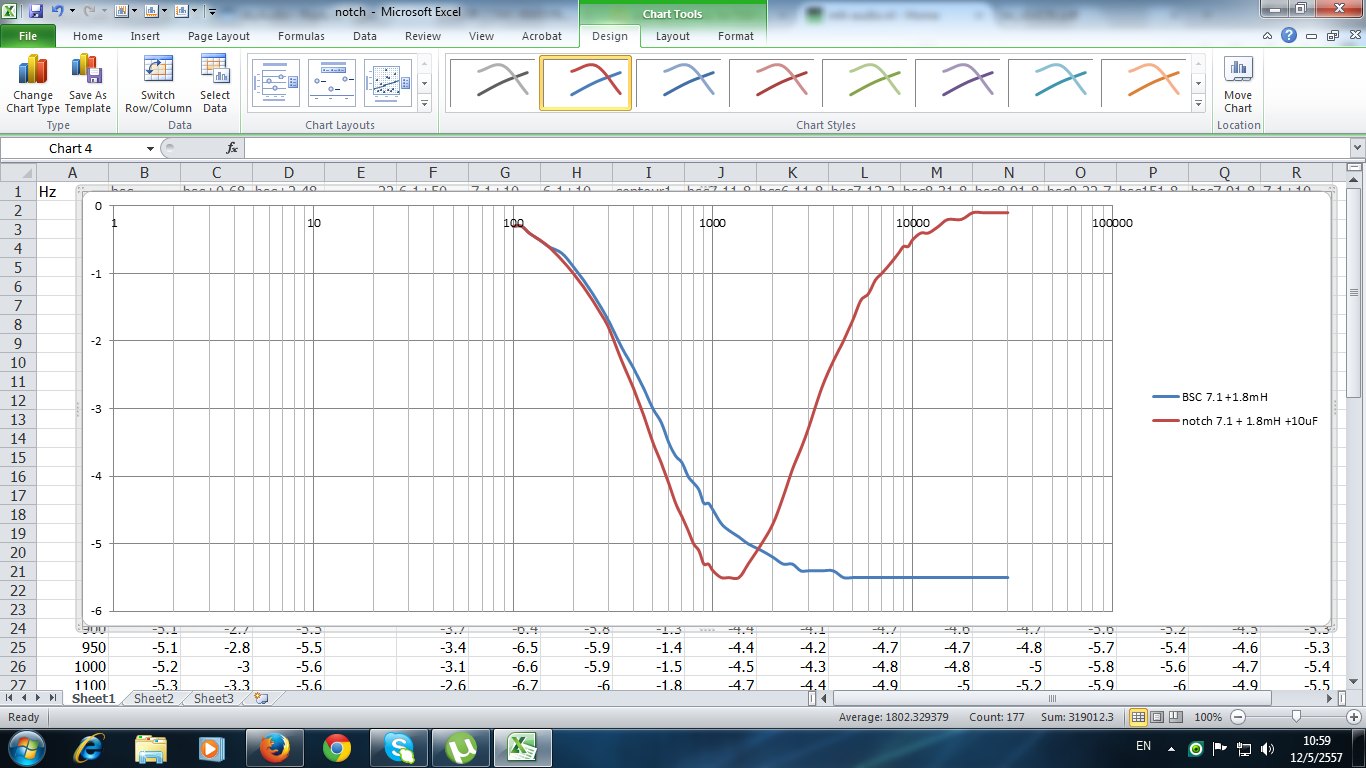

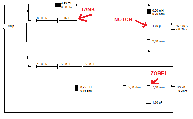

Steve's post 9 has a series notch on the woofer in attachment 2.
A pararallel notch. The filter is in parallel with the driver and shunts a range of frequencies past the driver.
dave
Aw, boys! This is SO boring!
Learn to call the elements their proper names and you won't worry about series and shunt, or series and parallel! :D
BTW, while you have been taking pedantry to astronomical heights, I must tell you that me and sreten, working together as a team, have solved the problem of Barbara Streisand shrieking on presscot's SEAS bass whilst BeeGeeing it up on Guilty.
Marvellous. Problem fixed. :D

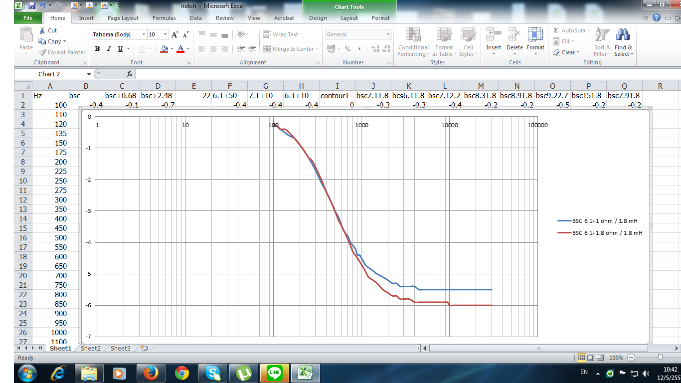

Back to my circuit issue, now I'm happy with my current circuit - BSC for my SEAS. :up: It works very well. And the problem also seem to be fixed ;). Or if a little adjustment would be required, it probably replacing a 1 ohm resistor to much higher value; I've 1.8 ohm one in my store :birthday: but haven't done it)
Attached image : I just post to you my auxiliary. Lol :D

Now as to the parallel/series notch filter controversy: You can have either a series notch filter in parallel with the driver or a parallel notch filter in series with the driver. Simple. Easy. Use this description and everyone will know what you mean.

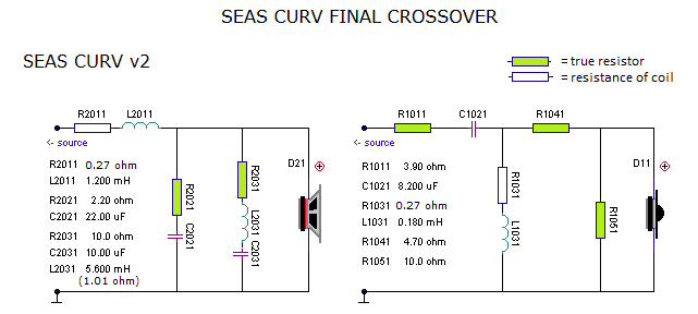

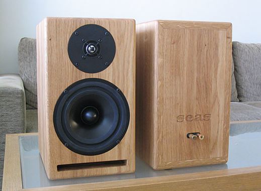

Presscot, you may be reinventing the wheel here really. Those engineers at SEAS in Moss, on the edge of Oslofjord in Norway know what they are doing with their drivers. I would trust their design. It looks good to me.
They probably don't fancy a notch because of the closeness of the cone resonance to crossover.
But the trick here is to have sufficient rolloff from the BSC coil to lower the midrange energy. I would get a BSC coil around 2.2-2.5 mH. Everything else should then work without the detailed but shouty quality that too small coil gives.
I really quite like the Embla filter. You'll probably adjust the series resistor on the treble for top end level matching. :)

Thank you for advising, System7 ;)
I have a 0.47mH and a 0.68 mH air-core coil in my hand. If I have some free time, I'll try it -- series with my current 1.8 mH coil. :)
