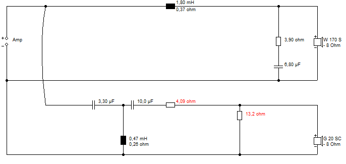

If you're very nice to Dissi, he might be able to knock something up for a 3.3uF/0.47mH tweeter filter and incorporate a 1.8mH coil. Probably be more accurate than my guesses. 😱
The ancient Audiomaster MLS4 used a 6" bextrene unit with a complex midrange notch, which incidentally increases the bafflestep correction. You could lose the 0.33uF KEF Acoustic Butterworth element since I just don't think it sounded good.

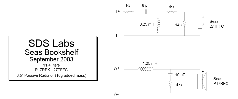

I had a very rough stab at deconstructing it, though I think I overdid the bass coil values. It is rather in the KEF/BBC tradition and is a Robin Marshall design IIRC:
OK, here's my guess where you want to be. 😱
This uses your existing components. I have adapted the SDS Labs bass filter, and tweaked your treble filter and added an attenuator which you'll have to adjust yourself for tonal balance, but keep the overall attenuator plus (6 ohm DCR?) tweeter load around 8-10 ohms for a good impedance. It's about 2.8kHz crossover.
You can, of course, just try your existing second order tweeter with a regular attenuator. Adding bafflestep to the bass takes its level down a tidge, so you'll need to adjust levels. No idea how it'll sound, and I can't attempt a midrange notch on my sort of rough and ready modelling, but it sure can't be worse! 😀
Oh! It's really appreciated! I can't thank you enough. 😉🙂

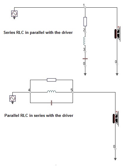

I would rather call it:
- parallel RLC in series with the driver
- series RLC in parallel with the driver
Yes, it couldn't be clearer than that! 🙂
I use the series RLC in parallel with the driver a lot where I need to tailor the frequency response to achieve the desired topology roll off.
/Göran

A picture says more than thousand words! 🙂
In my experience the "Parallel RLC in series with the driver" should be avoided if possible because it has a negative sonic impact.

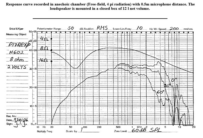

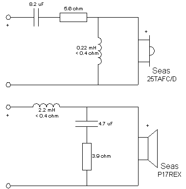

I've just hit paydirt! 😀
There was a 12L SEAS kit called the Embla a few years back. It's a reflex design using the SEAS P17REX (which is incredibly similar to the P17REX/P) and the 25TAFC/D.
Crossover below. My guess wasn't bad! 😎
A 2.2mH looks better though. Dealing with the midrange shout on Barbie's voice, an all that. Still not sure if presscot's tweeter is up to it though. Looks a low crossover to me.
