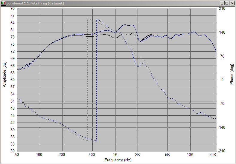

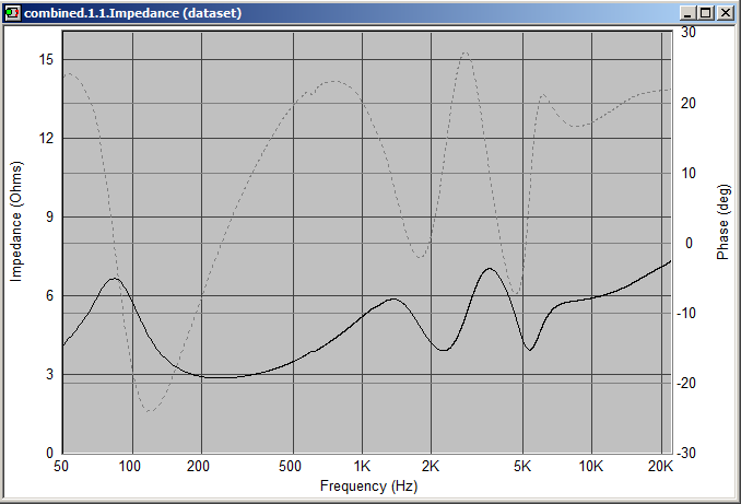

I found that a parallel LCR in series with the bass driver was very effective at removing my baffle step related hump (though mine is a bit higher in frequency than the OP's). I actually have two parallel LCR's in series with the midbass unit. One tuned to about 1.4Khz to deal with the baffle step hump and the other tuned to around 4Khz to deal with driver breakup. The lower one is fairly low Q and the higher one a bit higher Q.
No problems so far with the amp, and to my ears (and anyone who has heard them so far) they are very natural sounding.
Attached shows the difference in the response with and without the 1.4Khz // LCR ( Blue is without in case it wasn't obvious 😉 ).
2nd pic is the impedance plot. Note that these are the simulated results but the actual results are very close to this.
Tony.

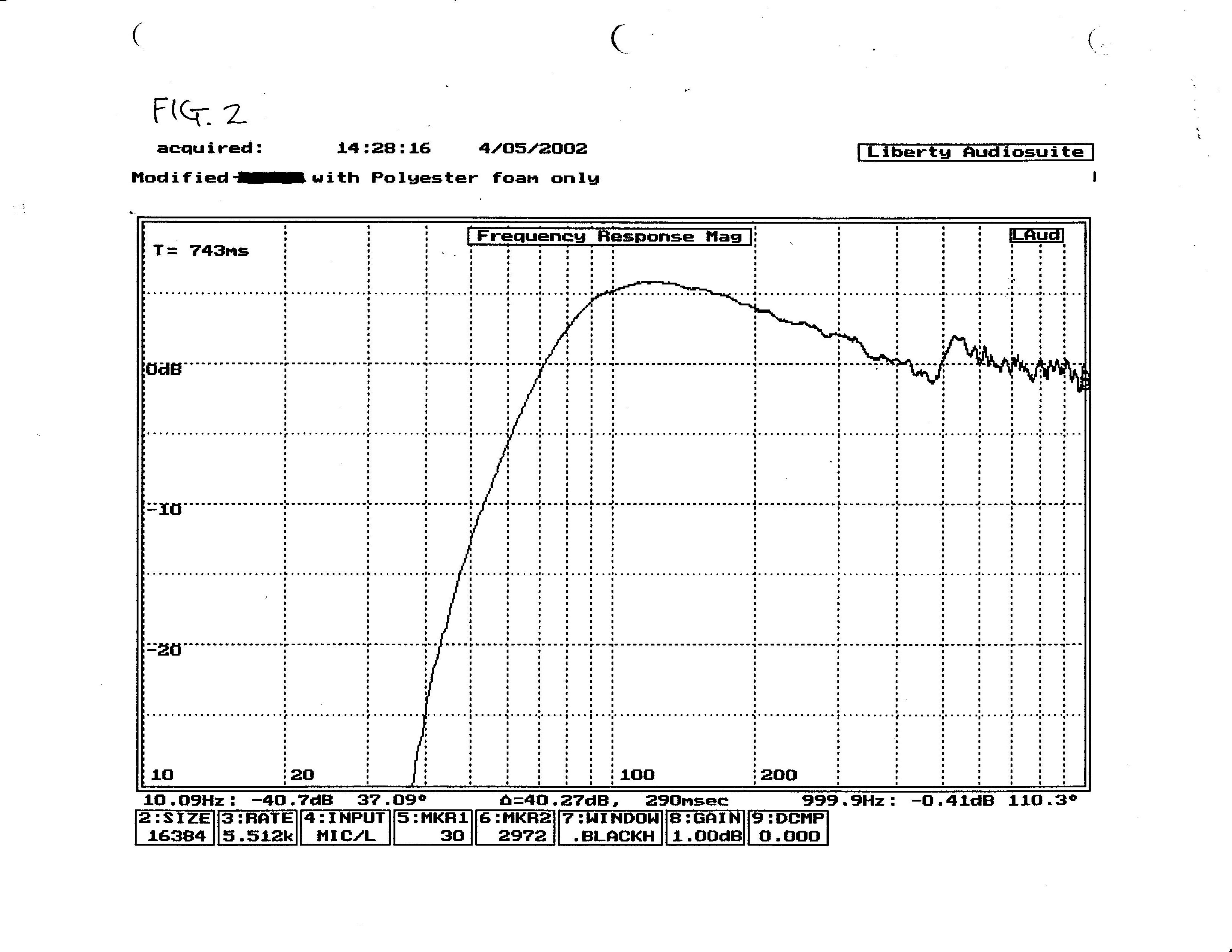

Hi Presscot,

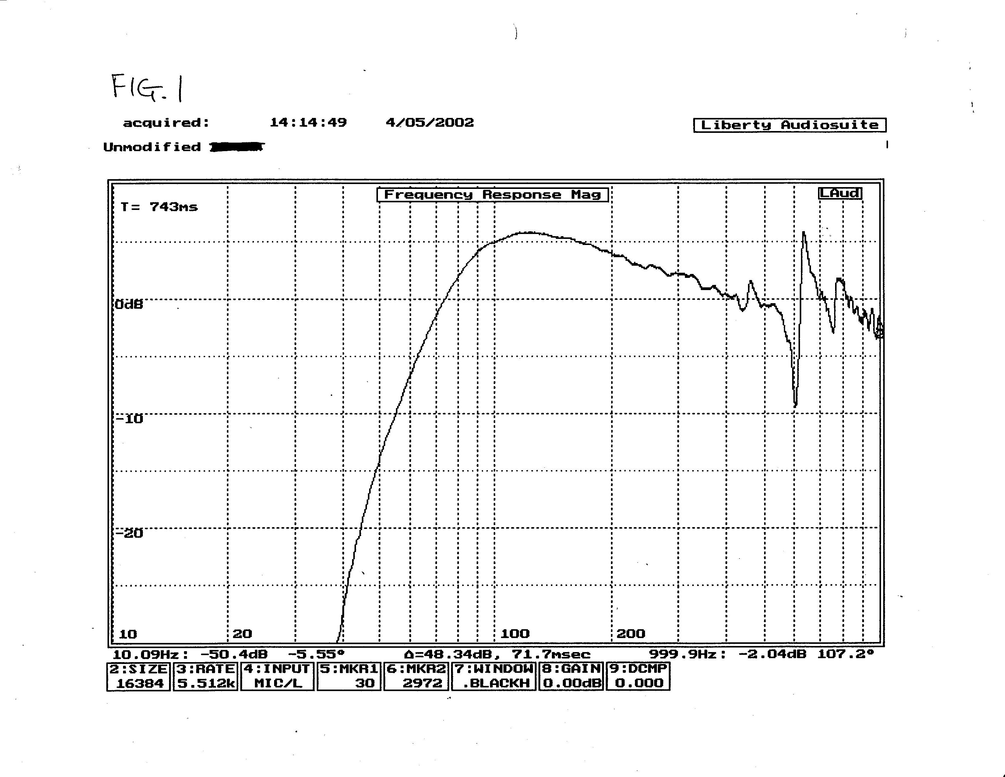

Is your speaker adequately filled with acoustic damping material? The reason I ask is because several years ago I was asked to look into the problems of a 2 way active loudspeaker employing an 8” bass/mid-range driver together with a 1” dome tweeter in a ported enclosure.
Upon inspection, I found that the enclosure had no internal acoustic damping material. Before I did anything else, I made a high-resolution near-field measurement as shown in Fig.1.
The peaks and dips in this response were dramatically reduced in magnitude (as shown in Fig2) when I applied 1.5” thick acoustic grade open cell foam to the internal walls of the enclosure. Needless to say, these peaks and dips were caused by standing waves inside the enclosure and as you can see, are right in the frequency range you refer to in your OP.
This kind of problem is not easily solved with analog filters though, especially since there are simple ways to fix it.
There are many things that can cause the problem you describe like for instance, an inadequately braced enclosure, an inadequate baffle step correction (BSC), or if you have a ported design, it could even be a port resonance. The best way to find out is to start making electrical and acoustic measurements.
Peter

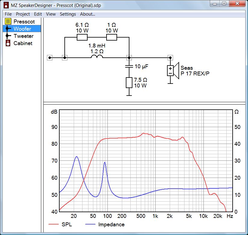

Update!
Thank you for all the answers 🙂. Your all answers are very useful to me and have brought me to the solution!
I've found a solution to my problem. I have achieved with a Baffle Step correction (BSC). 😉
First, I thought to myself I should have built a notch filter to solve on my problem. So, I tried on this link - mh-audio.nl - Home. After calculating and testing, it worked not so bad 🙄. The spike (female vocal) has been removed ..but slightly . So, I reconsidered about my situation and thought again.
As my woofer has been used as a full-range -- the x-over point has been set up by its roll-off (4kHz for my seas h602). I went for a try on this calculator - mh-audio.nl - Home and I went back to this one again - mh-audio.nl - Home. To the second part, An amplitude parallel notch calculation, it shows how the circuit works. I put the values from my bsc calculation and notch filter calculation into it and then when the result arrived, I took the values out to be plotted the graphs on a microsoft excel to see how it shapes. 😀
After comparing a graph, I chose "BSC". It use 1.8mh parallel with a 6.1 ohms resistor and placed them series with a driver. The result is... it works well! 🙂 Those spike has been almost removed ...but there still remain some harshness on female's reaching high notes. So, I tried to add a 1 ohm resistor into it to make a resistor much higher value, and so now! the sounds right to my ear.

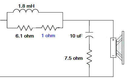

Pay attention if you are using a resistor in series with the driver (woofer) for the power admissible and that of the amp. Maybe I'm missing here something, but that's not a good idea. 😀 😀...So, I tried to add a 1 ohm resistor into it to make a resistor much higher value, and so now! the sounds right to my ear.
Thank you very much for all your kind of help and suggestions. 😉
Do a FRD/ZMA simulation of the drivers, crossovers and baffle/speakers with any free software available and post it here in diyAudio for analysis, if you want to go in the right direction. 🙂

I don't know whether the resistor will effect on my woofer but I'd wiring the circuit like this (image 1). So, it would be kind if anyone just comment on this.
Note : I've added a zobel network altogether.

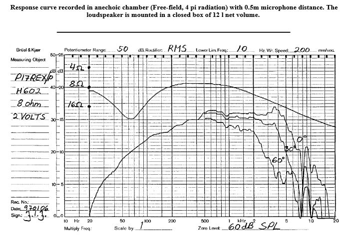

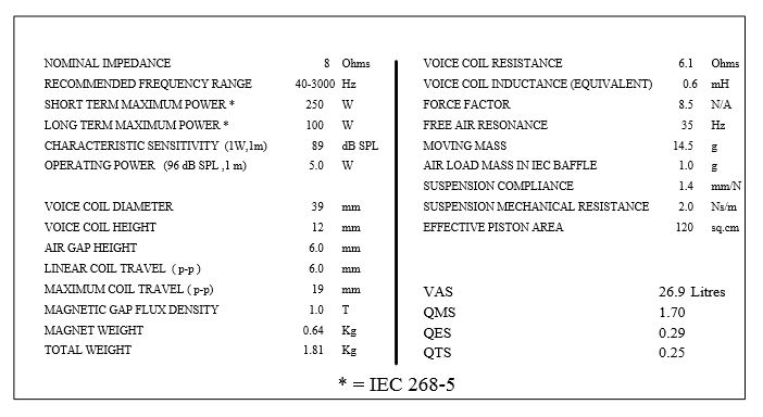

What drivers do you have after all, if you don't mind me asking after 33 posts?!
Oh sorry! Forgot to tell a basic information. 😀
Seas h602 p17rex/p. 🙂
THIS is what is needed for any meaningful discussion, my friend! 😉Oh sorry! Forgot to tell a basic information. 😀

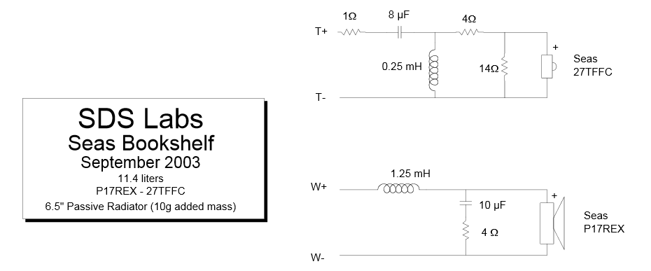

It's a Frankenstein box consisting of a Denon SC-C3 speaker with the woofer replaced by a rather impressive SEAS P17REX/P 17cm. polypropylene cone with phase plug.
So far, crossover work is rudimentary to say the least. SDS labs publish something that might be adaptable.
So, it would be kind if anyone just comment on this.![]()
Your current circuit doesn't look bad (see attached simulation). Personally I would go for a 2nd order low-pass filter in order to attenuate the peak at 3.7 kHz somewhat. Perhaps Barbra Streisand then wouldn't shout anymore.
Thank you for your hospitality and friendship. 😉🙂
