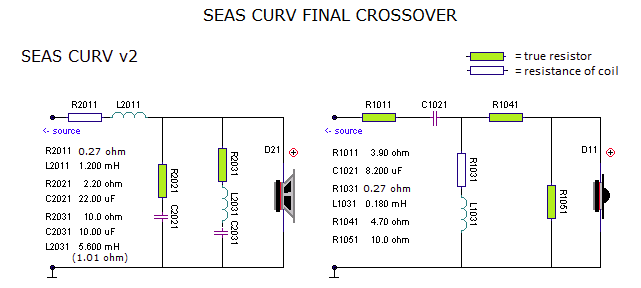

I do think that 5-6" bass on narrow baffle is really hard to get tonally right. They tend to brightness or harshness in the midrange, especially female vocal. Everything I hate about a speaker...
Troels does a ca. 600-800Hz series LCR notch very frequently. He obviously likes it. Impact on impedance is not too bad, but it takes it lower to around 4-5 ohms. The BBC used a parallel LCR notch or "Trap" a lot for slightly different reasons with polycones. It's much harder to model, but when it works, it works well.
SEAS CURV
What is seen much too often is the crossover depicted above. Any driver mounted on a baffle will have an f3 = 11,600/width of baffle in cm, here 11,600/19 = 610 Hz, in short, we have a rising frequency response towards higher frequencies and this is usually dealt with by adding a large series inductor for the midbass in order to tame too much energy around 1 kHz. Problem is that by doing so we tilt the response so much we have a dip right in the middle of the midrange around 500 Hz, see figure below (green graph). Depending on the intrinsic response of the actual driver this may be more or less severe and a few times we can get away with the simple "v1" crossover.
SEAS CURV
