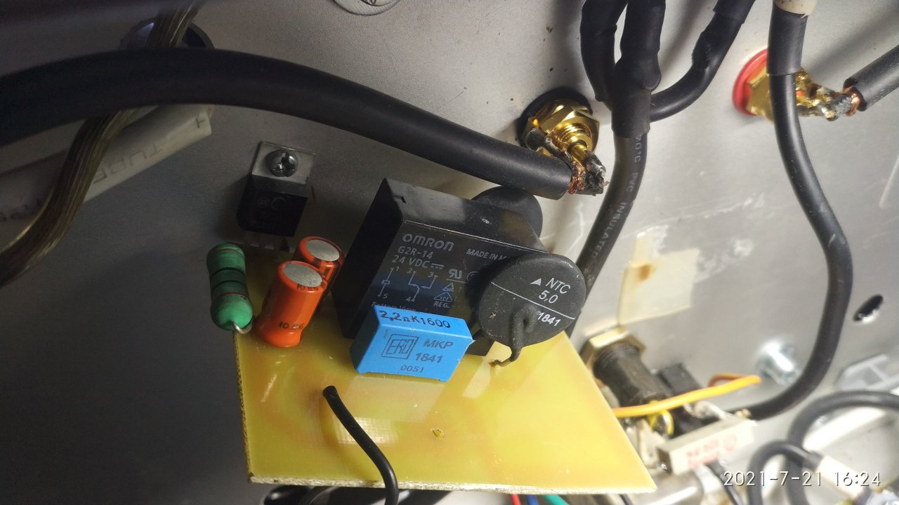

I only know that the SE Class A with 2-750 VA Transformers blows each and every time the Main House Fuse, without inrush limiter..(PTC) The Amp usually draws 750Watts / Channel @idle.
In the meantime I have made a LOW CLASS A MODE SELECTOR where the CLASS A runs on 167Watts instead of 750/Channel. But it could be Switched to high mode any time.
Config of the Circuit is parallel to the PTC, a 10 WATT 10 Ohm Resistor, both which will be coupled out when the amp has received it's full voltage, by a Relay. I use two PTC Resistors each of them when Cold =5 ohms & 10 Ampere. The Relay is fed by 12Volts which is regulated after the MAIN RAILS +- which are feeding the Amp itself.
These PTC are in the AC 240 Volts Line. I think to cut off the PTC with a Relay, when the Amp is switched on makes sense because otherwise the PTC getting really hot. In the same time that the PTC is set to off the LINE Of LINE VOLTAGE have =0R or not more than the RELAY contacts itself, so full Voltage (240 Volts) is applied to the Transformers.
And there is no need to have the PTC's hot when not in use.

Sorry Guys, today it's not my day..
this should read NTC - was in a hurry.. This would be proper
Also I have two versions, on with 24Volts on the regulator for the Relay and one for 12 Volts.
The 24 volt works better.. With the 12 Version I had to change the relay several times already. But I think it's a problem for the Quality of the relay..
In the pic you can see the actual one.. the Parallel resistor is mounted near the Fuse Socket, not on this board.

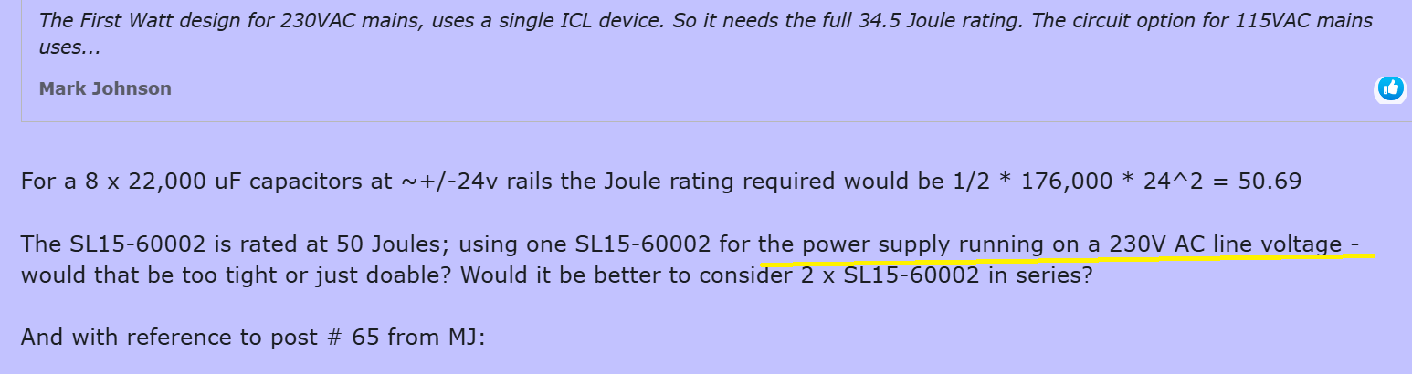

Thank you Mark Johnson for the informative post #22 on this thread:
For a 8 x 22,000 uF capacitors at ~+/-24v rails the Joule rating required would be 1/2 * 176,000 * 24^2 = 50.69
The SL15-60002 is rated at 50 Joules; using one SL15-60002 for the power supply running on a 230V AC line voltage - would that be too tight or just doable? Would it be better to consider 2 x SL15-60002 in series?

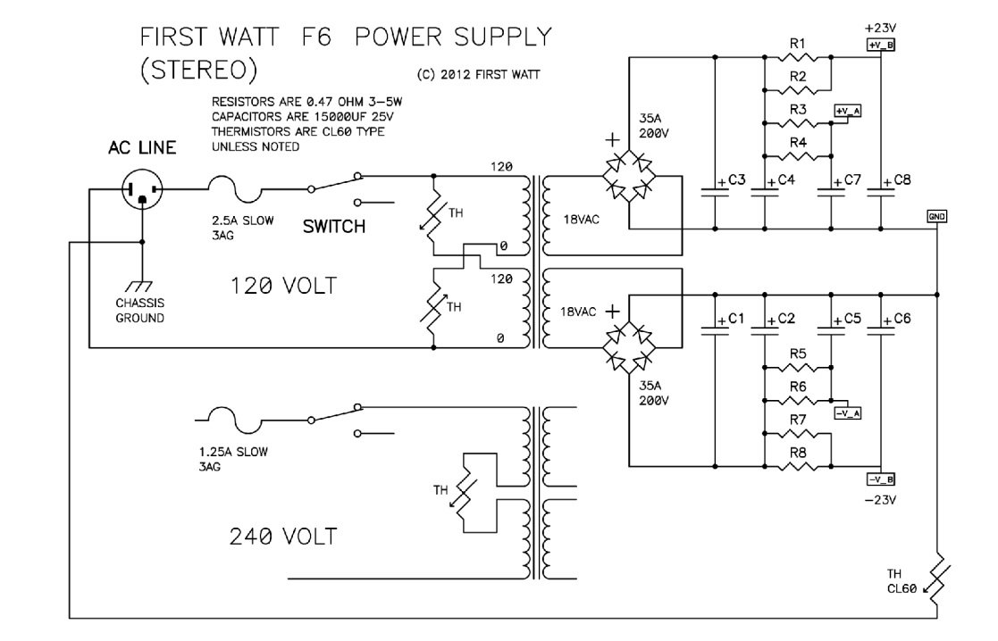

And with reference to post # 65 from MJ:
If the transformer is rated at 400VA, then is it correct to calculate that the AC voltage drop will be ~2.76V with a single SL15-60002, and ~3.7V with 2 of them in series?
The power supply schematic is attached for reference(First Watt F6 Power Supply).

If you increase the total capacitance by a factor of (22000 / 15000) then you need to increase the Joule rating by the same factor: 1.47X .
As your arithmetic indicates, 34.5 Joules (before) x 1.47 = 50.7 Joules (after)
It's appropriate that when you move up to Big Boy capacitors, you also move up to Big Boy inrush current limiter discs. You will pay a little more money in exchange for a lot more Joule rating. A 50 Joule inrush current limiter disc is insufficient for Big Boys.
Your steady state current requirement is less than or equal to (400 VA / 230 Volts) = 1.74 amperes. Probably less since it's unlikely you'd run the transformer at 100% of its max VA rating continuously ("steady state"). But conservative design practices demand that your equipment must survive the worst case scenario, so you will design assuming 1.74 amperes.
Luckily, Ametherm sells a Big Boy line of inrush current limiters called "Mega Surge" (link) and they have one which fits your requirements nicely. It is part number MS22-12102 and {here is its datasheet} . As you can see, this one is rated for 220 Joules (!!) and its steady state max current is 2 amperes -- which exceeds your requirement of 1.74 amperes. This ICL disc's resistance when cold is a whopping 120 ohms, so the initial inrush current cannot possibly exceed (230V / 120R) = 1.9 amps, far FAR smaller than the no-limiter-installed inrush current of your transformer and ENORMOUS capacitor bank.
If you want to estimate the voltage drop then you will have to make two guesses. First you will have to guess what your equipment's steady state current actually is. We know an upper bound (1.74A) but that is unrealistically high. You need to guess what is I_steady_state in reality, not on the chalk board.
Second you will have to use the paltry information in the Ametherm datasheet to estimate (guess) your very own resistance-versus-current curve for this ICL disc. You know that it must pass through these three points:
  • at Current = 0 amps, Resistance = 120 ohms
  • at Current = 1.0 amps, Resistance = 3.65 ohms . . . see datasheet "50% Max Current" info
  • at Current = 2.0 amps, Resistance = 1.78 ohms . . . see datasheet "100% Max Current" info
Now it is your job to interpolate between these given datapoints. Draw your own curve.
When you have a curve, look up I_steady_state_in_reality (your first guess) and read the graph to find Resistance_of_ICL_from_graph.
Then the voltage drop is just Ohm's Law: V = I * R . Voltage_dropped_across_ICL = I_steady_state_in_reality * Resistance_of_ICL_from_graph.
Check the ICL datasheet to find the diameter of its leadwires. They may be so enormous that you will be forced to sandpaper them in order to fit through the PCB drill holes. But sandpaper is cheap and labor costs $0.00 per hour when it's your hobby.

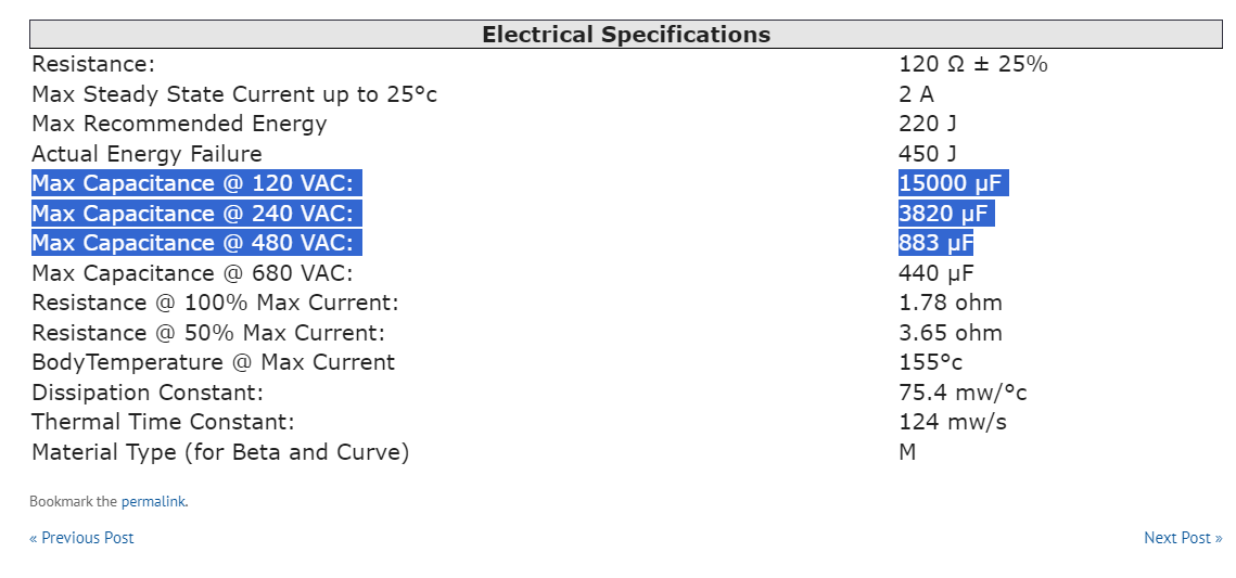

Hmmm.... what does this Max Capacitances mean..? How are they connected/influencing the max Joule rating?
I think they (the capacitors above) are connected (fully discharged) right across the NTC, making a dead short.
We are discussing the capacitor bank connected to the transformer's secondary winding, together with the associated wiring and bridge rectification, which will remove the need for such a huge Joule absorbing need.
Plus, the 120ohm resistance in series with the primary might be too much to allow the amp to quickly settle to its operating regime, where it would conduct a lot of current, to let the NTC warm up sufficiently to reduce its resistance. I do not believe the 120-ohm cold resistance NTC would ever get to 2-ohm.
If the Joule recommendation you calculated were applicable to FW clones, the standard CL60s would be popping left, front, and right, but I haven't heard of a single failure
