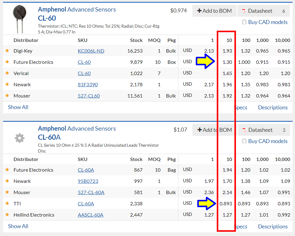

... vs $7ea for a CL-60. ...
Here is what Octopart.com gives me when I ask for today's prices on CL-60 parts:
_
_
Those seem much more reasonable. This was maybe a year ago, but I recall the price was about $6.90ea from Mouser. Maybe I was looking at the wrong part.

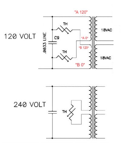

Did you consider using two CL-60 in series? That would give you ~20 Ohms cold R...
Why would I even consider using four of the wrong part when I could use two of the right part instead? Particularly when the right part is cheaper. Schematic is post#17 Figure 1, the wrong parts are X1 and X2 at left.
Yes, your idea does represent one valid method to handle the dual mains voltage requirement:
Nelson Pass's First Watt power supply schematic is an unusual and clever implementation of this very idea, in that he has chosen N=1/2 (!) thus 2N=1. He manages to arrange the dual primaries in such a way that each of the two IRC limiters carry half the current, thus they are effectively in parallel, thus effectively (1/2) of an IRC limiter's cold resistance. Schematic attached.
You propose to use N=2 IRC limiters in series for the 115VAC case, allowing you to continue purchasing Amphenol CL-60 parts. This means that 230VAC builders would need 2N=4 components in series. Besides increasing the parts cost, this also increases the voltage dropped across the ICL limiters in steady state, after the inrush. It's now (4 * Iprimary * Rhot) which looks a bit intimidating. Speaking of emotions like intimidation, and individual personal preferences, I mentioned another of mine back in post #6.

- For 115VAC mains: connect "N" number of IRC limiters in series
- The inrush peak current is approx [115V / (N * Rcold)]
- For 230VAC mains: connect 2N number of IRC limiters in series
- The inrush peak current is approx [230V / (2N * Rcold)]
- Presto, same inrush peak current in both arrangements
