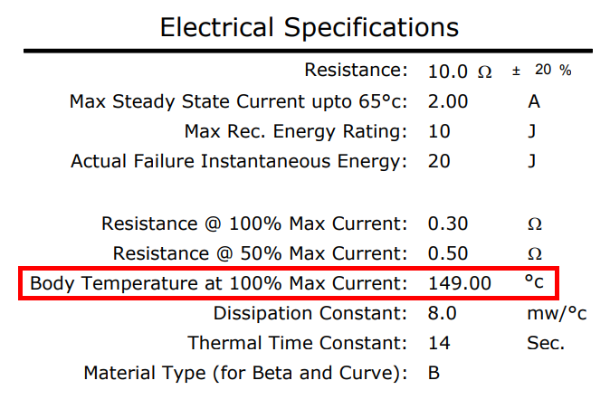

General Electric / Thermometrics / Amphenol don't specify the ICL body temperature on their datasheets, but other companies do. I've attached a representative one below. It runs at 149 degrees Celsius! wow.
I just measured the CL-60 ICLs in my M2x. After three hours of thermal soaking (power applied, inputs shorted), the body of the CL-60's measure 33.8 degrees Celsius using a Type-K thermocouple, and 32.9 degrees Celsius using an infrared no-contact thermometer. That's a far cry from 149 C. So I'm thinking the CL-60 may not be the best ICL for this particular amplifier.

Hi, do you mean that you rather would like to see the CL-60 at 149 degrees Celsius instead of 33 degrees Celsius?

I would prefer to see two CL-90s or CL-120s at 149 degrees Celsius instead of two CL-60s at 33 degrees Celsius.
However I like the other ICLs mentioned above, not made by Amphenol and with a part number that does not begin CL-. They appear to me to be even better suited than CL-90, to the M2x with USA voltages.

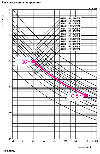

The resistance drops with heat. Cold, he's not getting "all" power expected; if they ran hot he'd have more power to run with.
I didn't find that exact part but here's the trend. (Attached)

I would never use parts that are supposed to be 149 degrees Celsius continuously in a consumer device.

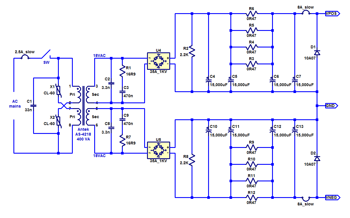

I bought some more Inrush Current Limiter devices and ran some more tests. While taking the M2x amplifier apart to make these new test runs, I discovered a minor hook up error on my Inrush Limiter daughter board. This error (plugging the wrong wires onto 1/4" FastOn connectors) resulted in Primary#1 getting no ICL at all, and primary #2 getting both ICLs in series (!). Thus the measured ICL disc body temperatures in post#1 above are wrong, wrong, wrong. I am sure glad I decided to try some more ICLs: preparing those experiments, allowed me to discover and fix the mistake.
Although I tried numerous ICL devices in my M2x amplifier, I will only mention three of them in this summary:

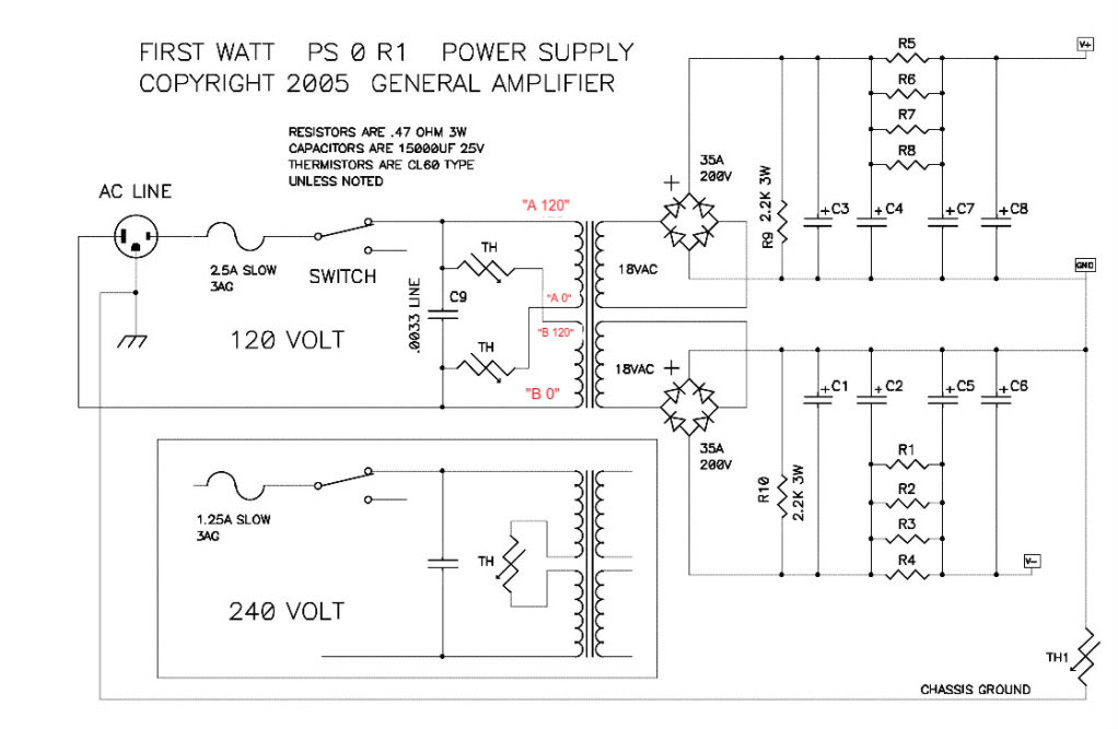

The power supply schematic of my M2x is shown in Figure 1 below. It's mostly a copy of the First Watt PSU, plus the addition of secondary snubbers, rail fuses, and antireversal diodes. The Inrush Current Limiters appear on the schematic as component names X1, X2. For those who might not know, M2x is a Class A amplifier that runs at a bias current of approx 1.3 amps in each of two channels.
After the inrush event is complete, the ICL resistance falls to a small number of ohms, but not zero. There is a small voltage drop across the ICL, which means the voltage applied to the transformer primary is slightly less than the full AC mains. Which means that the DC output voltage is also slightly less than it would have been without an ICL. To see this effect, I connected a DVM between the two power supply output nodes POS and NEG. Different models of ICL gave different values of total supply DC voltage (VPOS - VNEG), as shown in the table below.

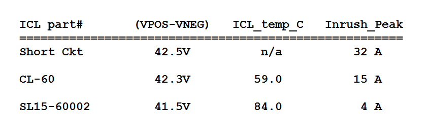

ICL body temperature and supply DC voltage were measured 5 minutes after power-on, to allow the M2x Class A bias loop to stabilize and settle to a constant bias current. Temperature was measured with a type K thermocouple.

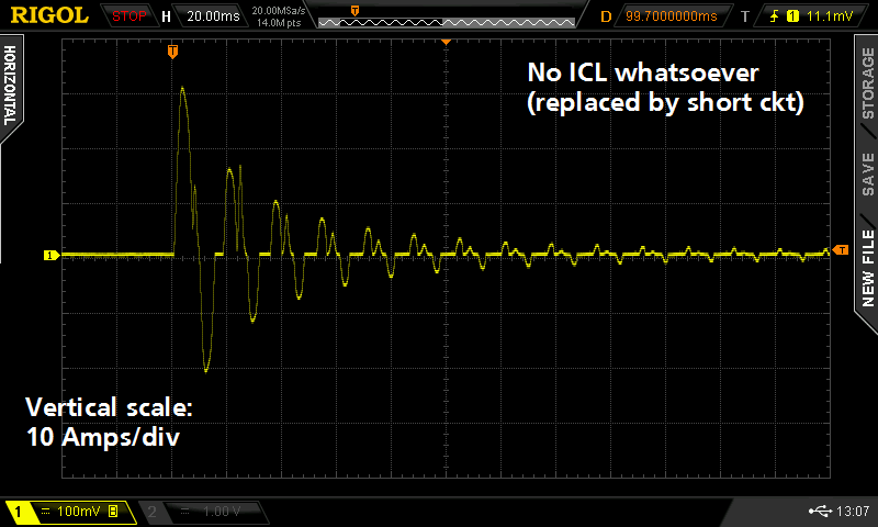

Replacing the ICLs with short circuits, gives the largest possible inrush current. The scope photo in Figure 3 shows this inrush current 32 amperes. That's high enough to make me nervous about blowing the 2.5 amp mains fuse, even though it's a "slow blow" type.

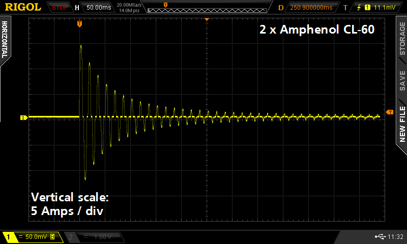

Installing the CL-60s reduced inrush current to 15 amperes as seen in the scope photo of Figure 4. The CL-60 discs stabilized at 59 Celsius, and the DC supplies sagged very slightly (0.2V) compared to the no-ICL case.

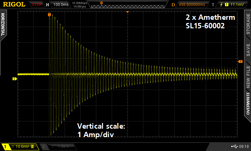

Changing to the SL15-60002 ICLs reduced inrush current even further; it falls to 4 amperes as seen in Figure 5. The ICL discs stabilized at 84 Celsius, and the DC supplies sagged about 1.0V compared to the no-ICL case.

After gathering the data, I decided that I liked the SL15-60002 better than all the other ICLs. Compared to the CL-60,
I decided the benefits (point 1) outweighed the costs (points 2 and 3), and I decided I could live with the costs. So I have permanently installed SL15-60002 ICLs in my M2x.
- Its inrush current is almost 4x less
- Supply DC voltage sags an additional 0.8V
- Body temperature of the ICL disc is higher: 85C not 60C

Fantastic research and findings! The results are particularly telling when looking at the scope shots, the time differences are quite notable.
I'm quite surprised in that the inrush is still 15A with the CL-60s!! That the fuses generally hold is amazing, and that they blow randomly (something that's reported fairly often) is now most likely explained.

...The scope photo in Figure 3 shows this inrush current 32 amperes. That's high enough to make me nervous about blowing the 2.5 amp mains fuse, even though it's a "slow blow" type.
It's "only" 10A peak after 3 cycles, 50mS. This part of the fuse thermal curve (rarely plotted) is practically vertical; a few 32A-10A blips won't usually blow a 2.5A fuse.
Also, it is a narrow peak. Squinting on thumb, maybe 1/10th of a half-cycle. So the heating effect of a 32A rectifier peak is more like a 10 A current; falling to 3A after the 3rd cycle.
Additional datapoint: if a 2.5A fuse blew on a dozens-mS transient, fuses would protect transistors. As we know🙁, they don't.
