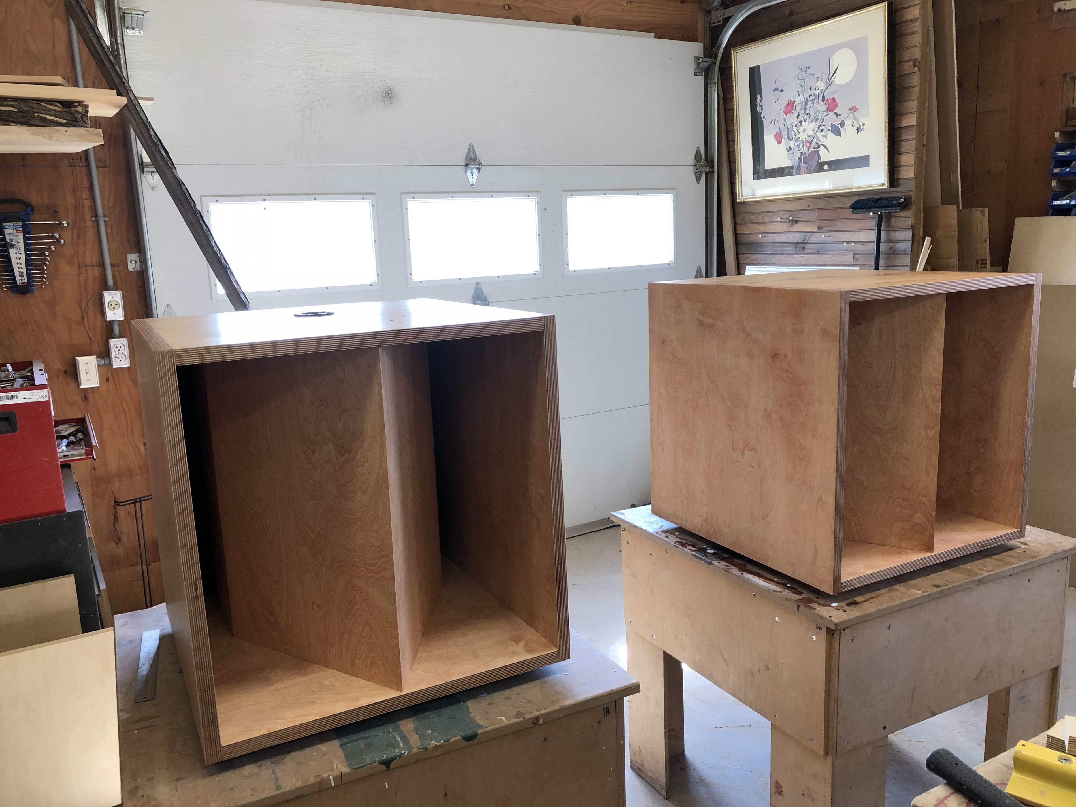

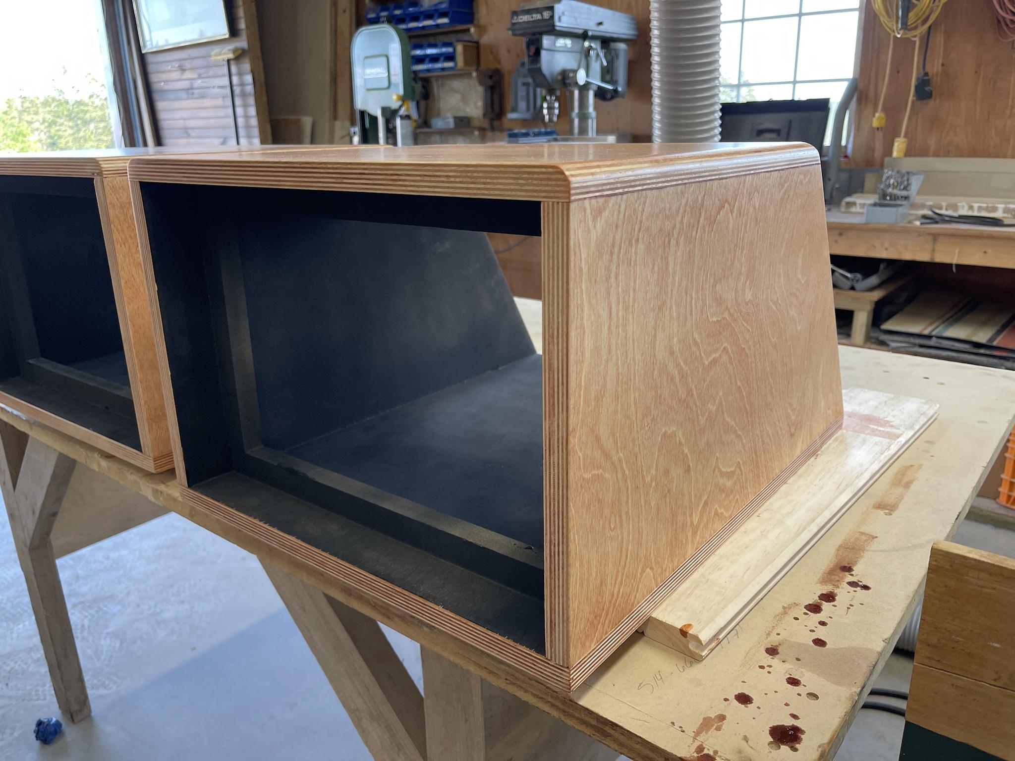

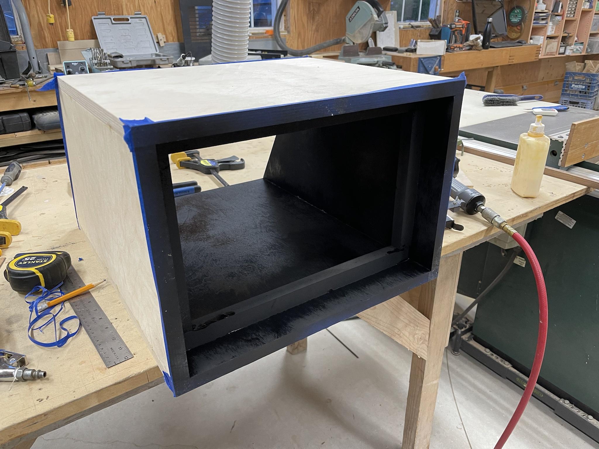

Second enclosure is assembled, sanded, stained and the first coat of clear has been applied. 2 more coats to get it caught up to the other cabinet and then tomorrow morning I will be doing one final coat on both. A quick paint of the bottom covers and they should be good to go. Going to be using foam tape to seal it instead of acoustic caulk like the originals mostly to minimize the mess.
Very happy with how they’re turning out.

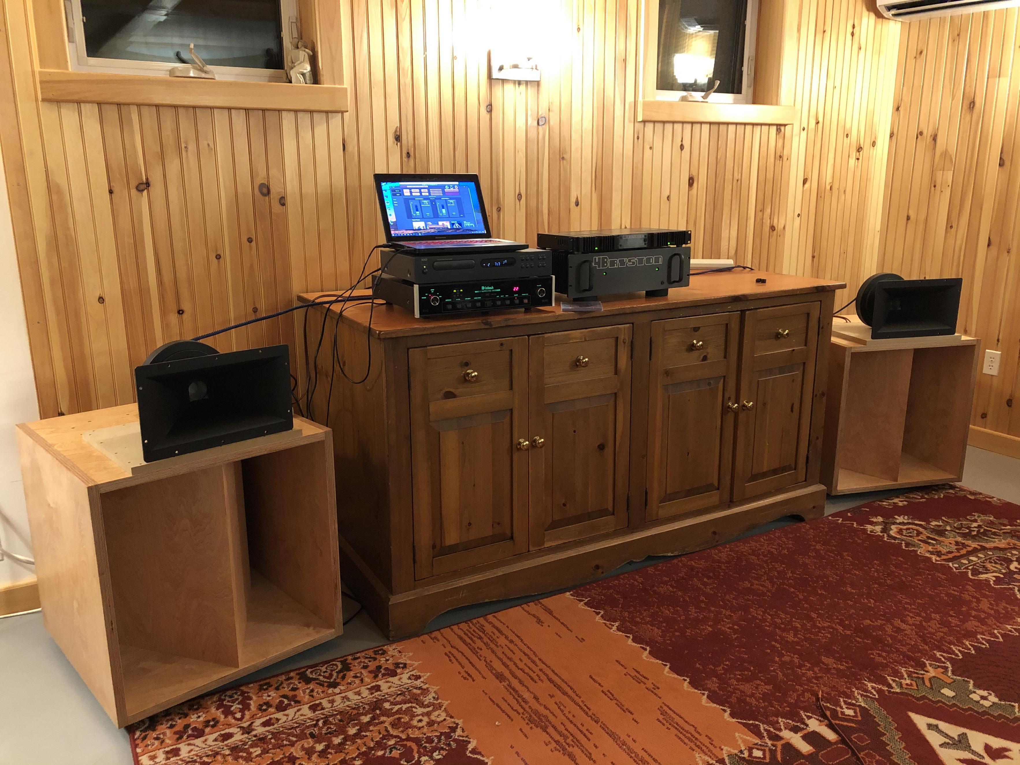

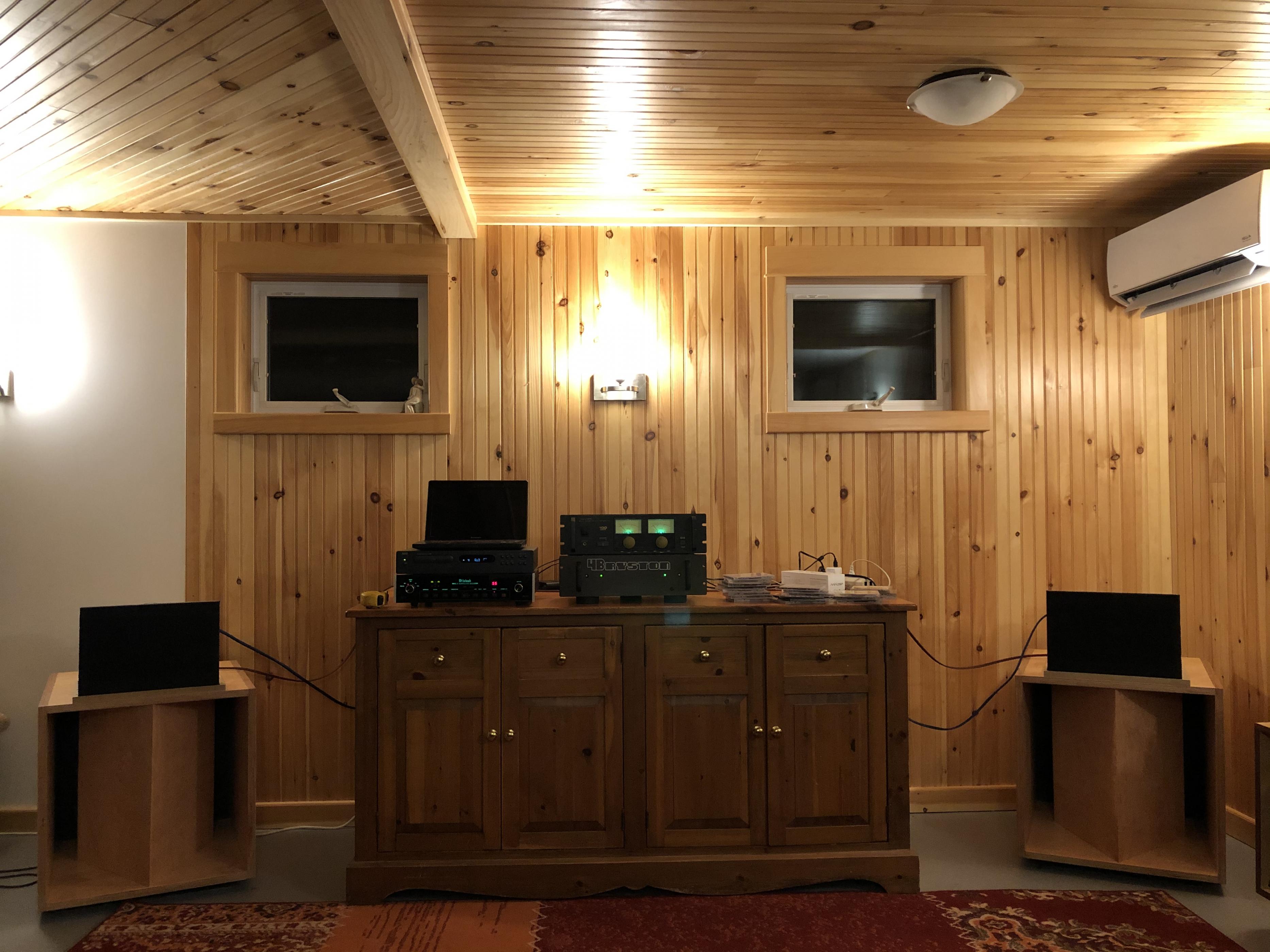

Awesome thanks! I just hooked them both up for the first time and besides needing tweaking amplifiers to minimize the hiss they’re already sounding impressive. Now that I see them with just the bare horns on the top I’m thinking I might do a smaller enclosure instead of the LS2 clone tops. Right now just going to dial in the sound.

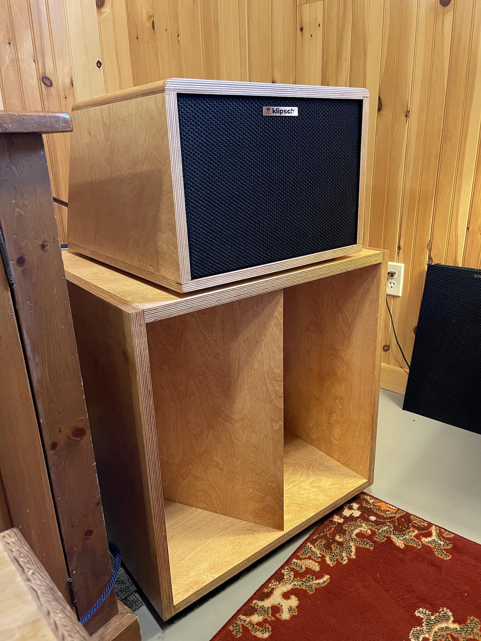

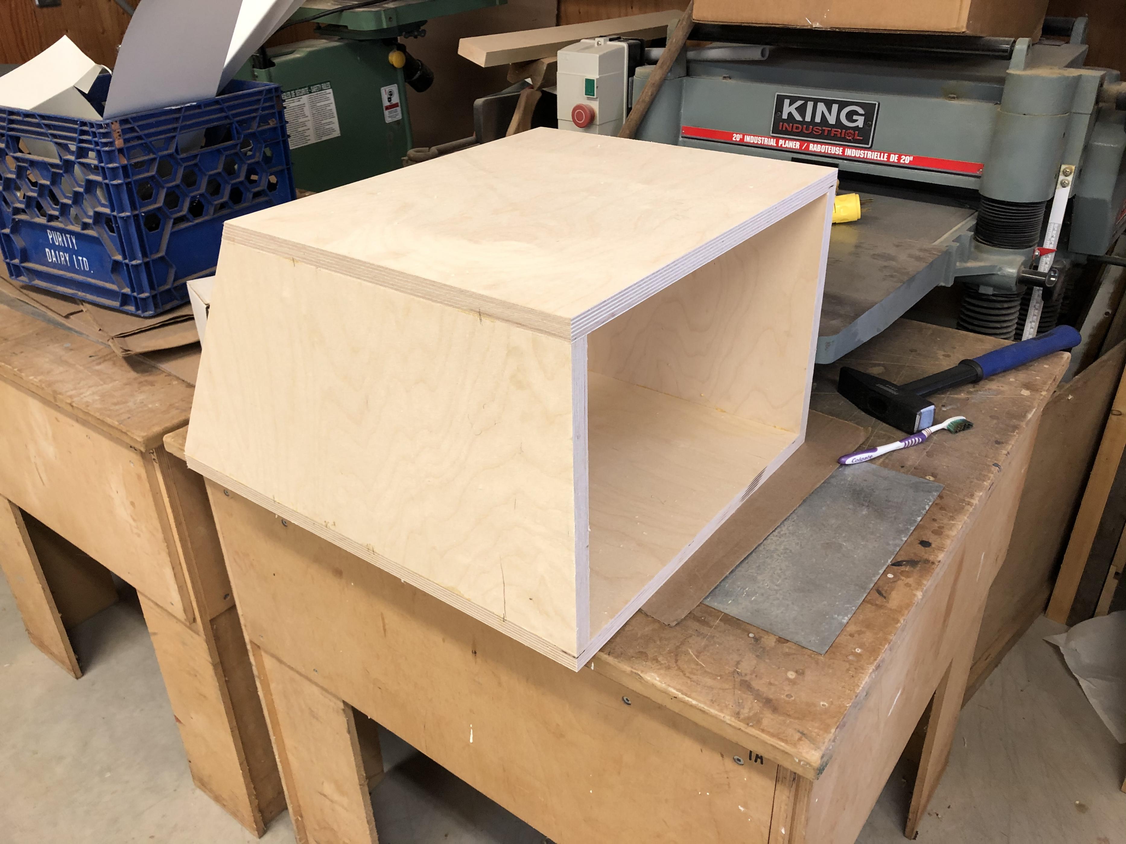

So after a little while of tweaking and listening I’m very happy with where the dsp and crossover is. So it’s time to tackle the enclosures for the horns. I was originally going to make clones of the LS2 HF boxes but have since decided to go with something smaller. It’s exactly the same width as the doghouse In the bass bin which should be a nice continuation up the center of the speaker. Also a slant on the rear to keep things from being too boxy.

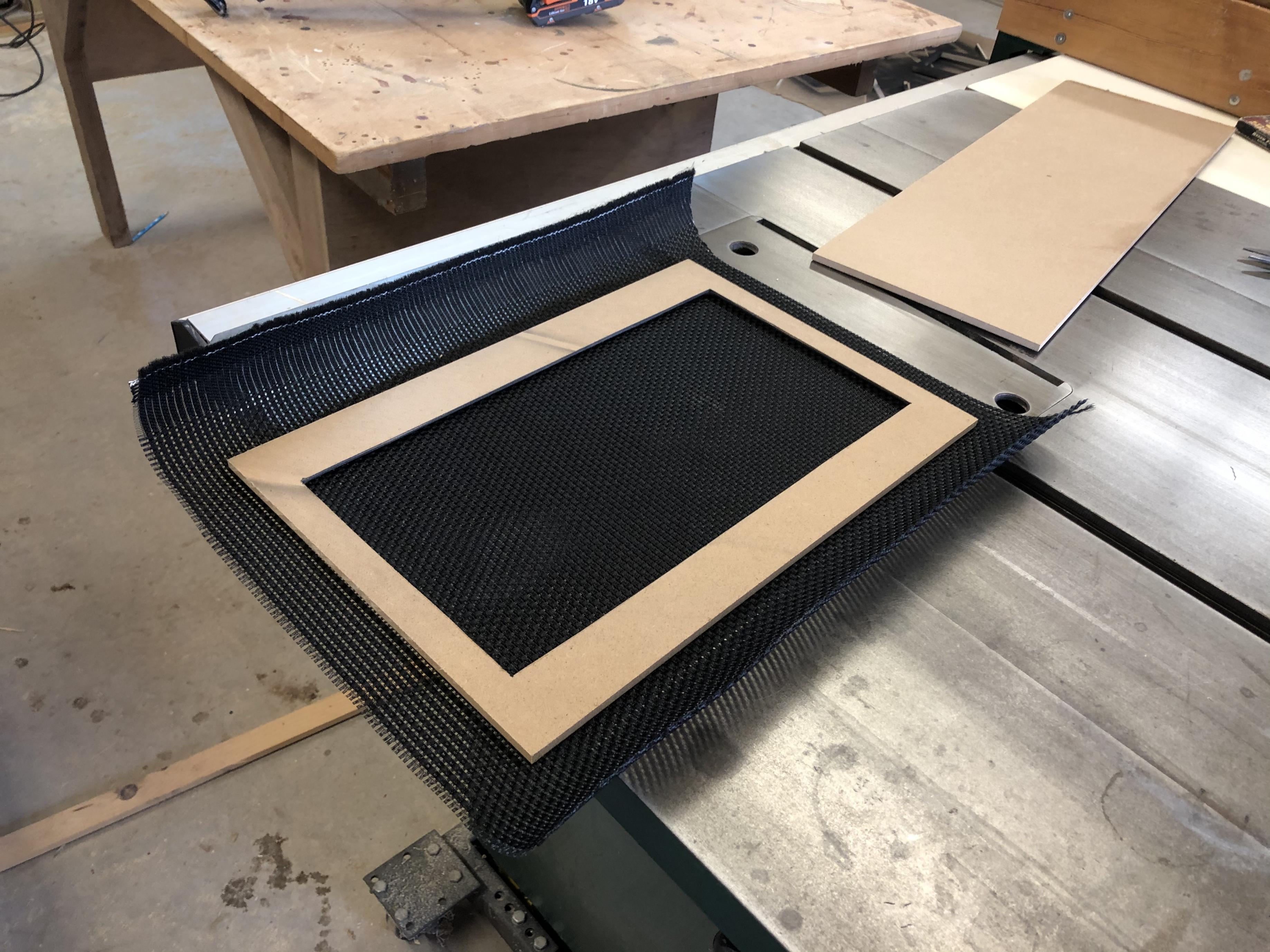

Also using the heritage Klipsch grill fabric to make some grilles.

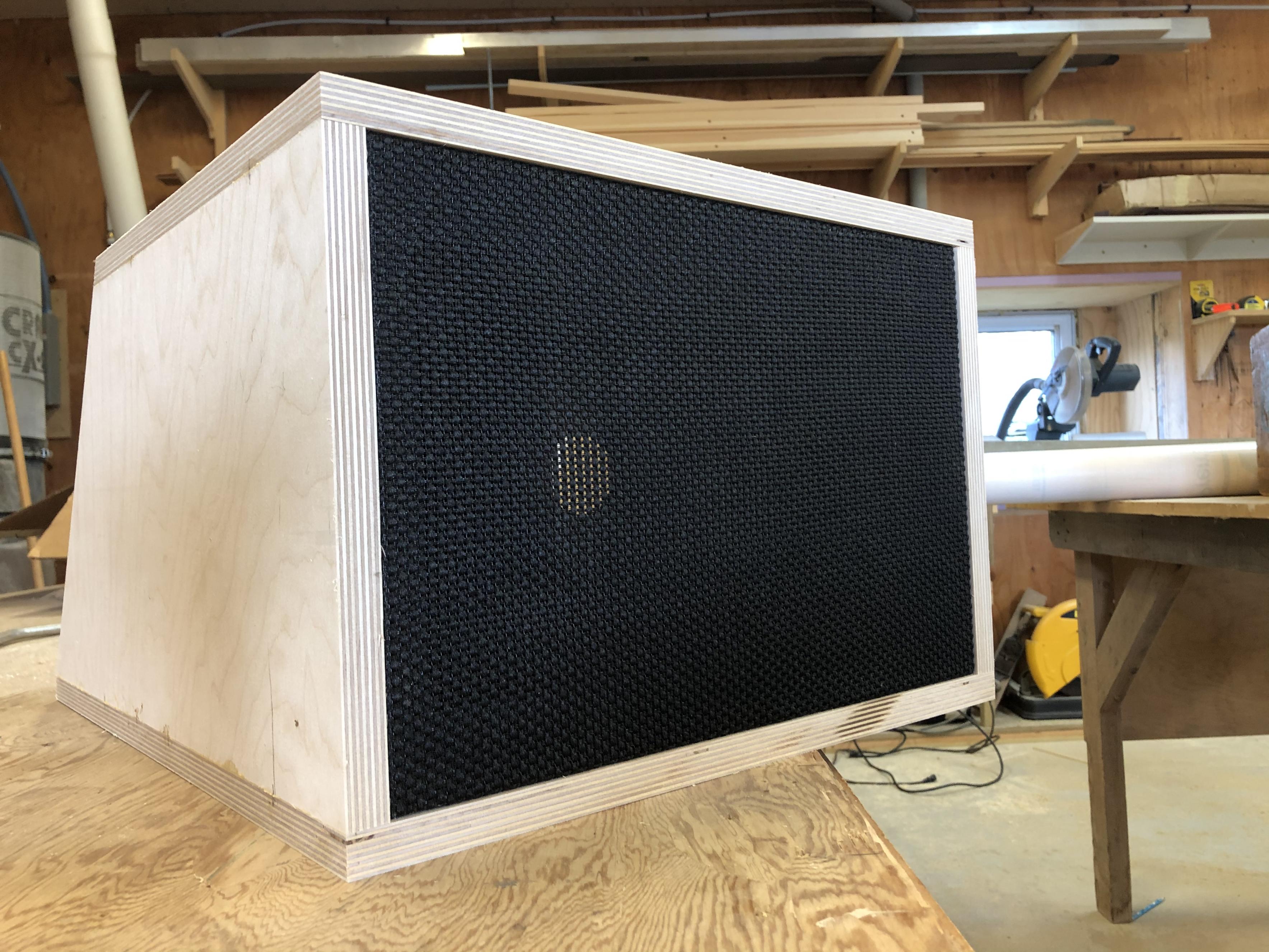

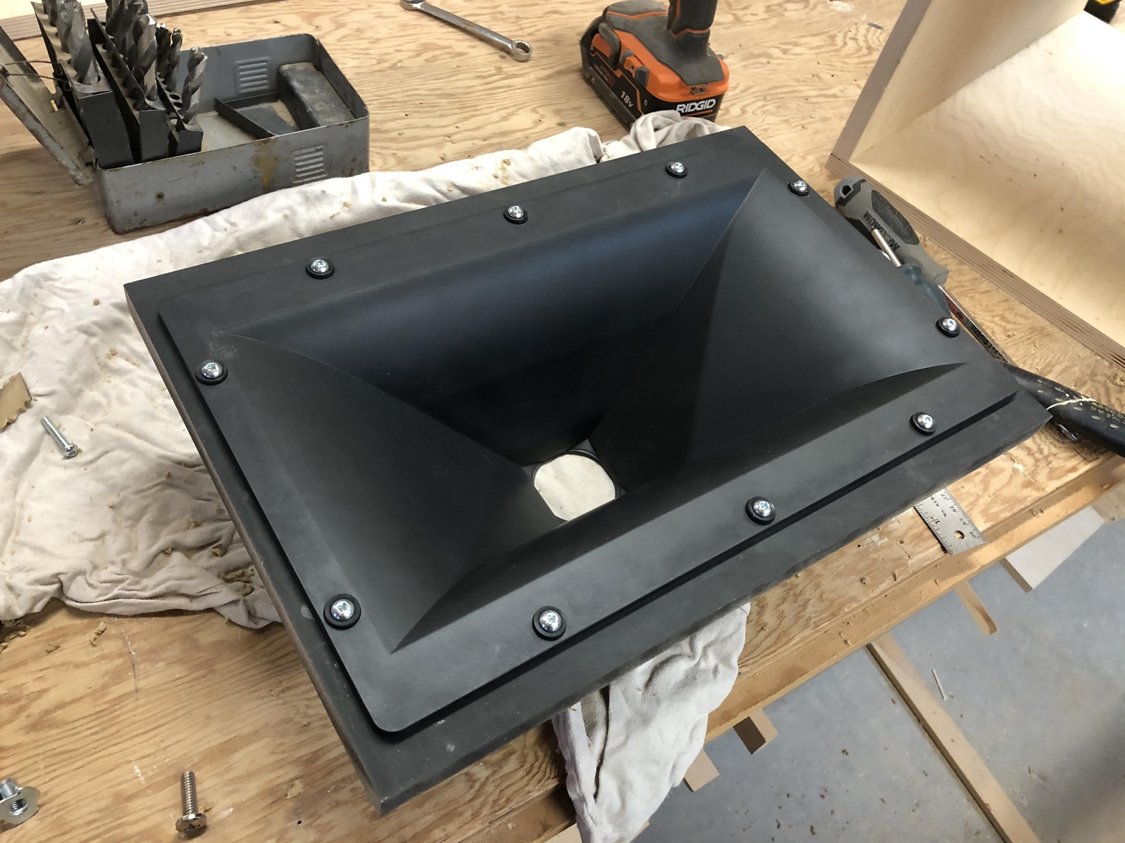

Got the frames for the horns figured out today, god bless tee nuts and did I ever under estimate the costs for hardware on this build. Nice and solid, finishing the cabinets this weekend and took the horns back inside for evening listening to see how they are woh the grills. Turns out just a little smoother so they’ll probably live grill-on once they’re finished.

The amp on top is actually an old Realistic radio shack unit I’ve had around as an emergency backup power amp. It’s not amazing but it has adjustable gain which my Bryston 2B doesn’t so it helps with calming down the hiss from the compression drivers. I’m actually waiting on a class D 4 channel board I’m hoping will be silent enough to work for all four drivers that can go in an enclosure along with the dsp board. You don’t realize just how noisy your fancy amps are until you plug a 111db horn straight into them.

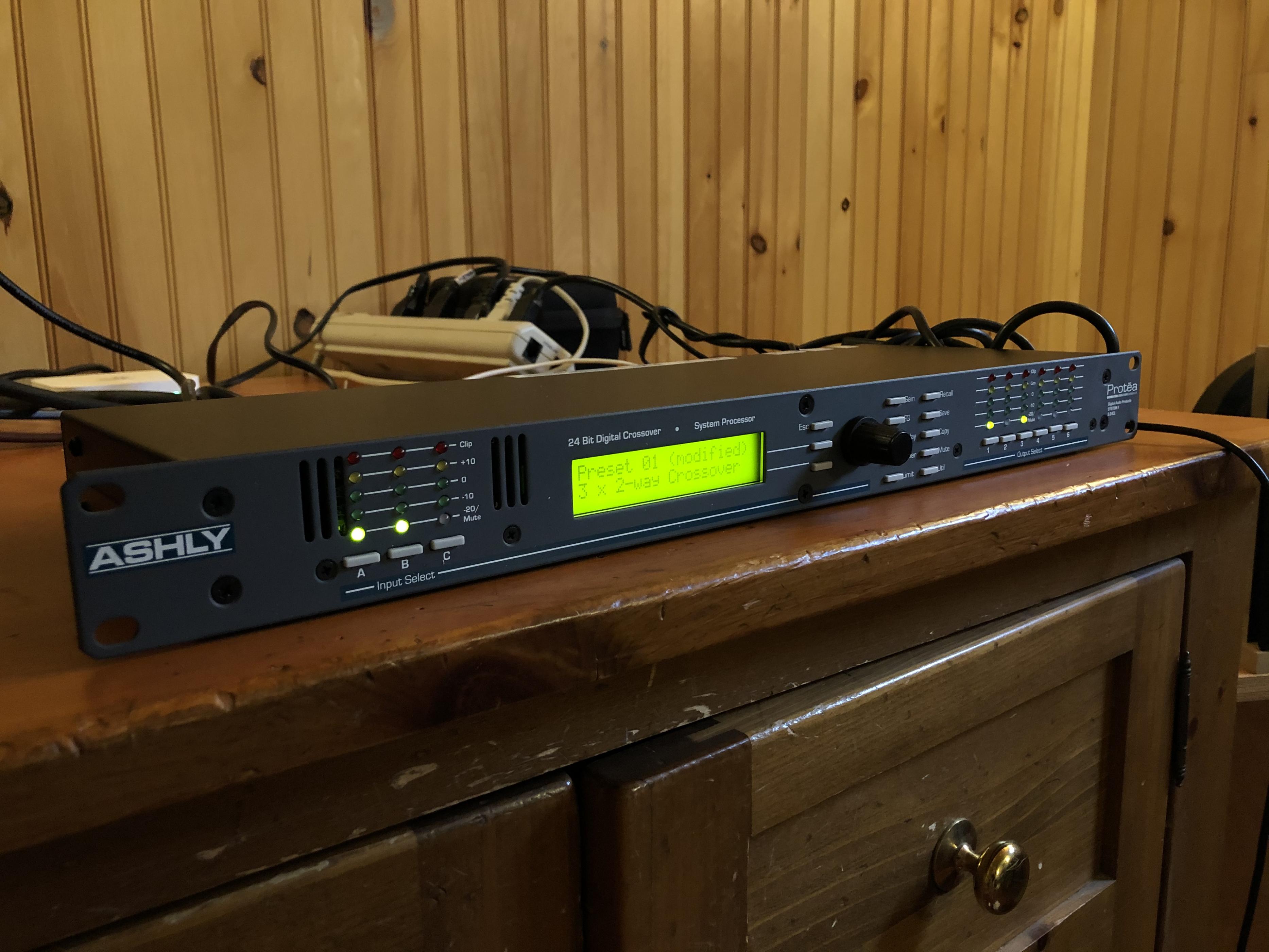

Hit a bit of a wall with the upper cabinets as I was focused on tracking down the source of my noise on the HF horns, a mix of high gain amps and a noisy minidsp were the culprit. Did a little upgrade today and good god it’s nice working with a good interface. Ashly Protea 3.24CL handling EQ, crossover and delay. Couldn’t be happier.

Zeagan, I have followed your project with interest and read the thread. The big challenge is the 111dB of the JBL 2446h. The significant improvement was achieved by switching from the noisy miniDSP to the Ashly Protea 3.24CL-d as speaker processor for equalisation, crossover and time delay.

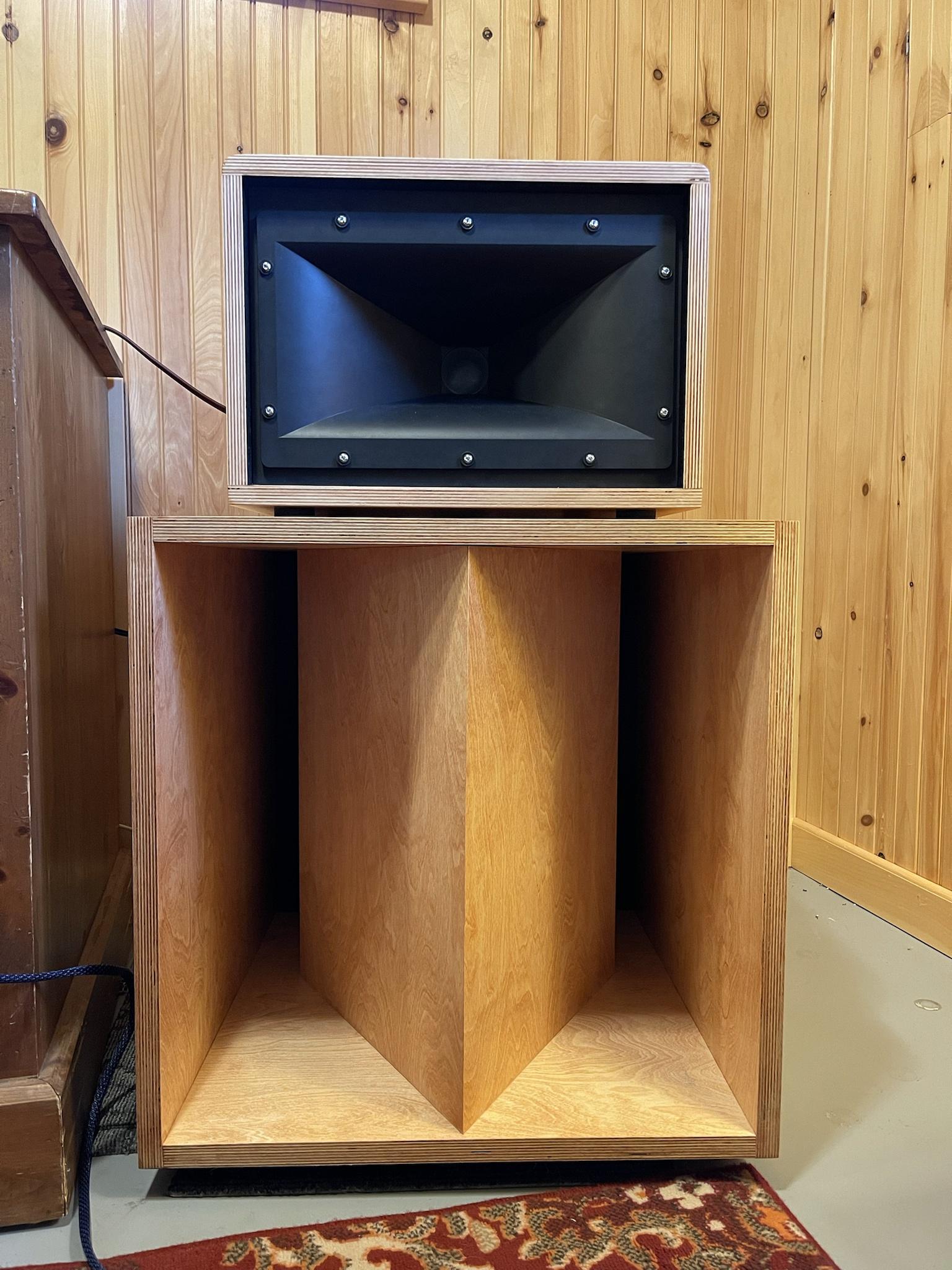

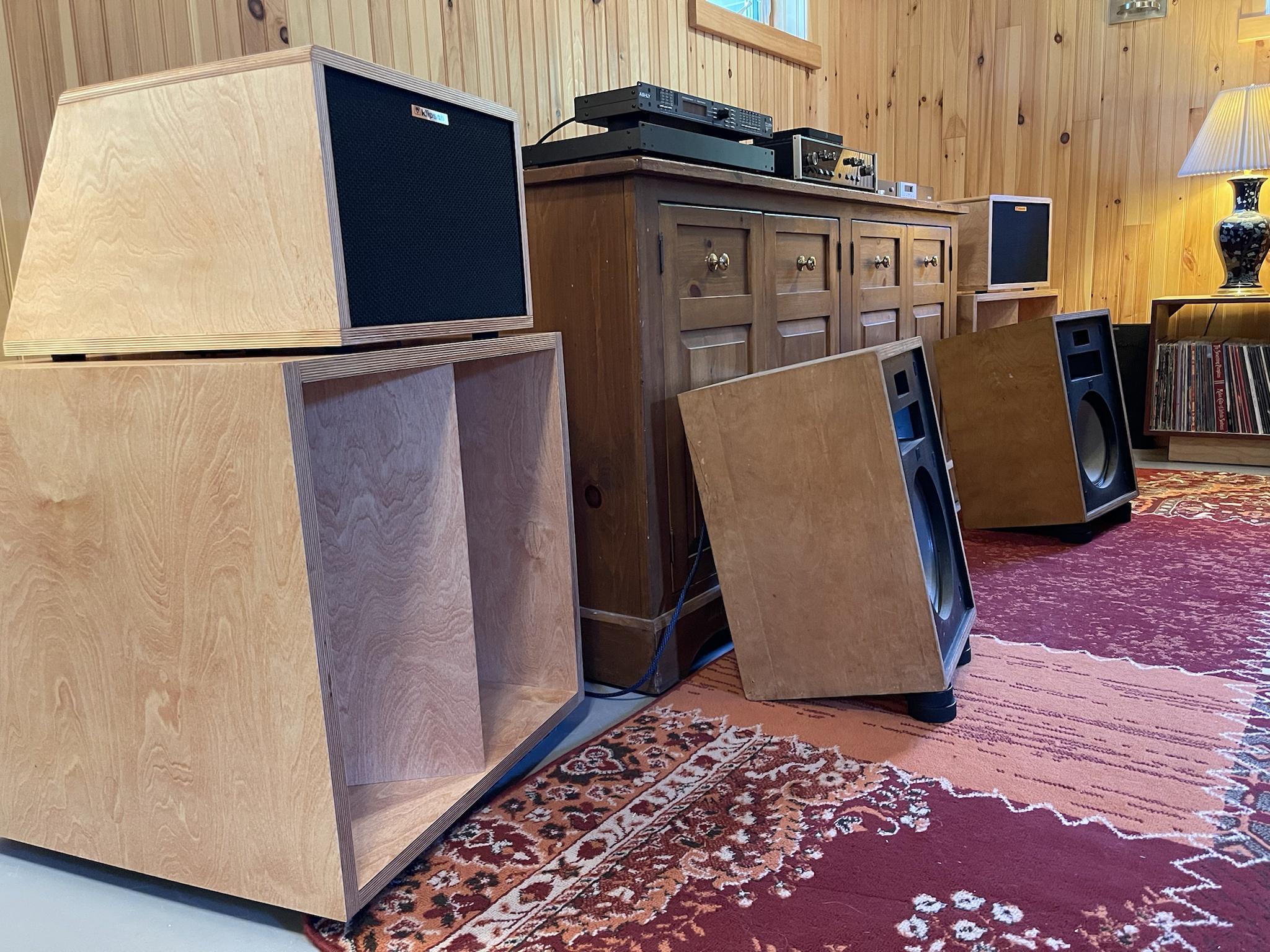

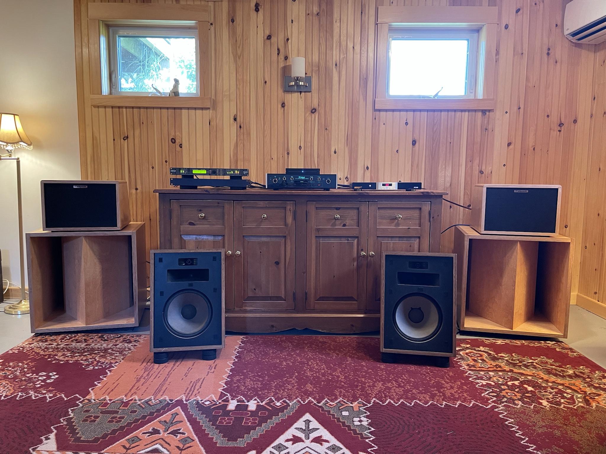

Anyway here's the final product. Still using the 2445h with k510, they now have homes and grilles. Used 3/4" baltic birch to match the bass bins, same stain and water based matte polyurethane. Grill cloth is from Crites to match the old heritage Klipsch speakers, and the badges, honestly I never intended to put badges on these as they're kind of bastard step children of a bunch of Klipsch ideas with a pair of JBL compression drivers but I was sent the wrong design replacement badges for another project and the seller told me to keep them so they were just laying around.

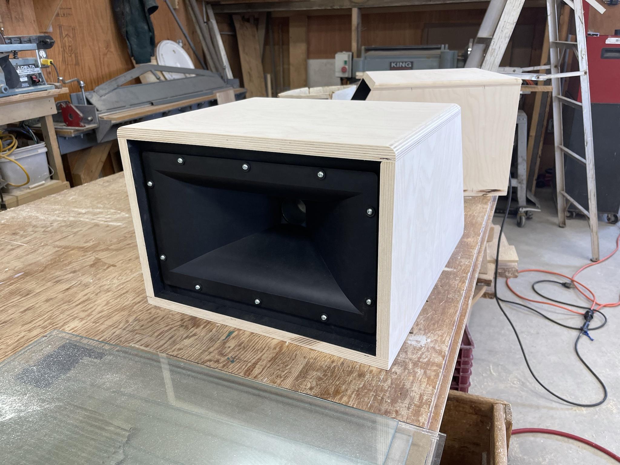

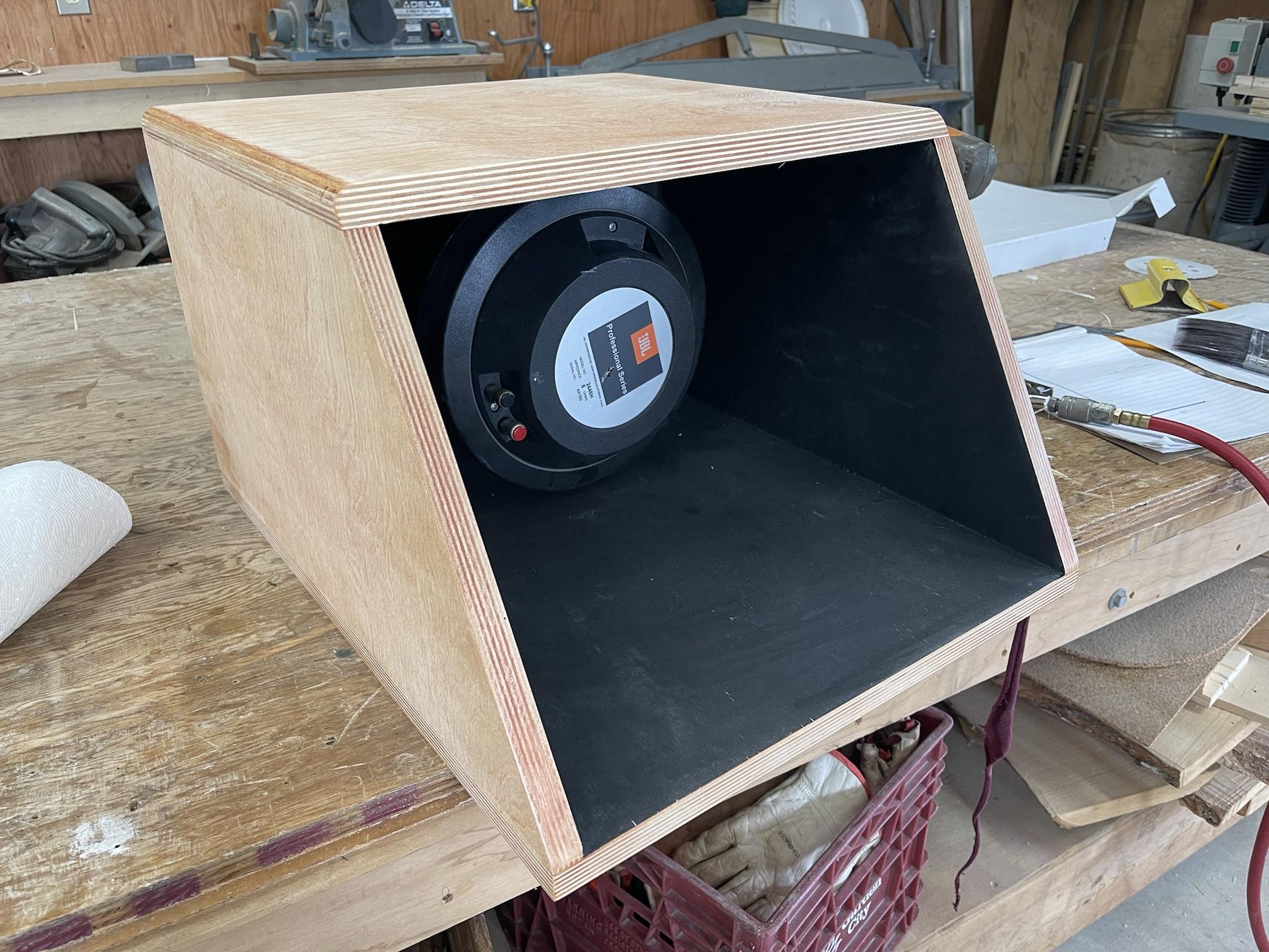

And here are some photos of the assembly of the HF enclosures. Nothing too fancy just some butt joints, a 5/8" roundover on the top edges and some black paint for the inside bits. There's also now a small hole with a grommet for the speaker cable to go through to the bass bin which isn't shown.
