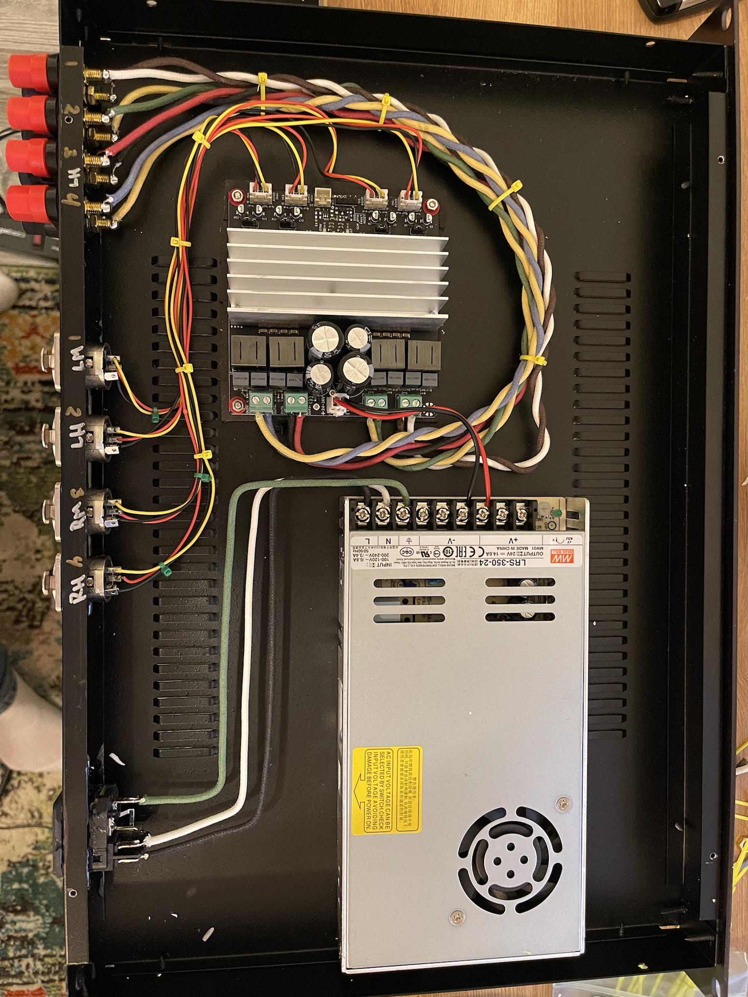

Which amplifier and power supply do you use for the JBL 2446h compression drivers?
You had informed yourself about the e-audio TPA3255 modules in the forum and then ordered the LRS-350-24 as a power supply. Is this now the solution or have you changed to another solution? Is the solution noise-free or so low-noise that it doesn't interfere with listening to music?

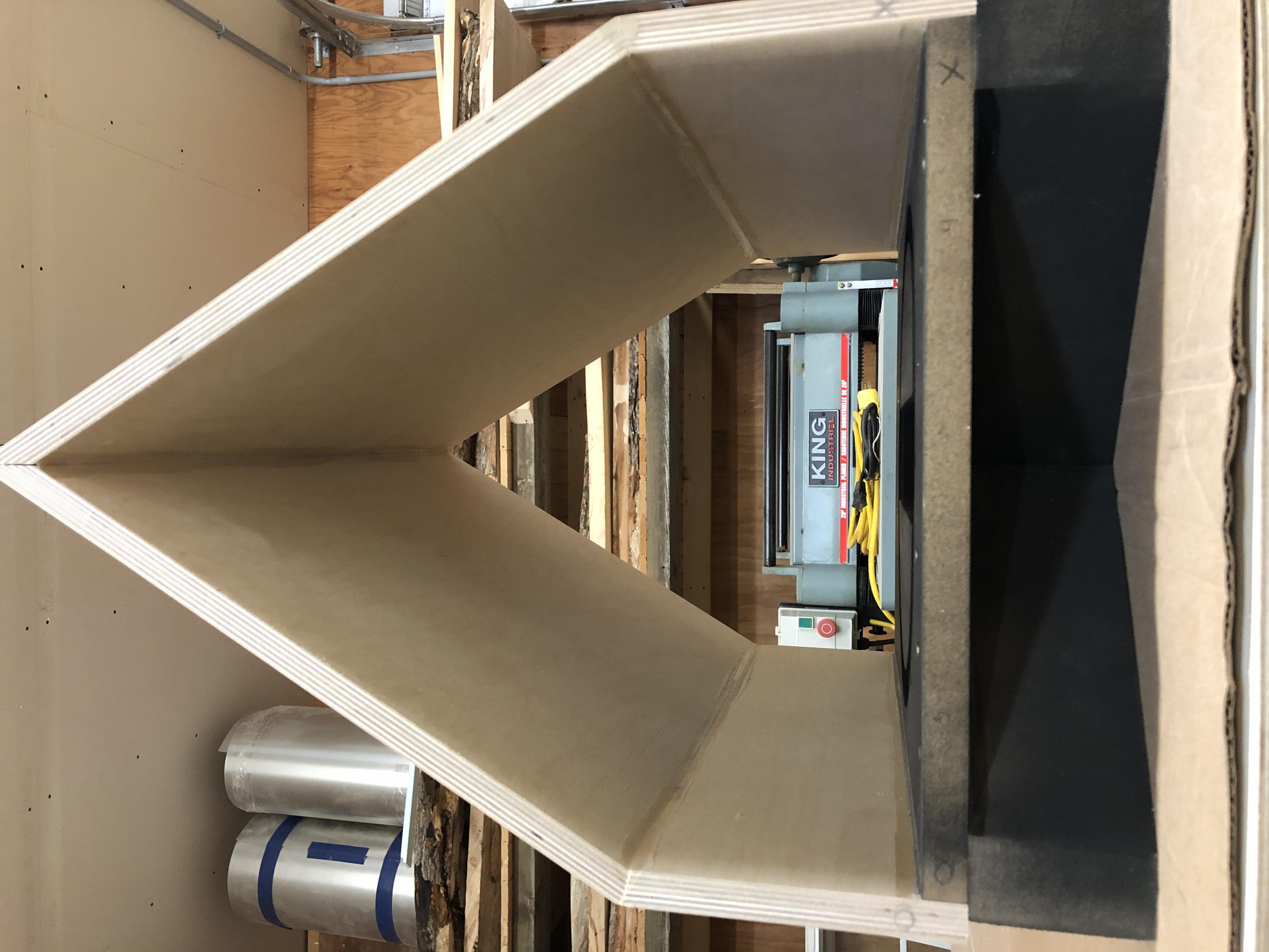

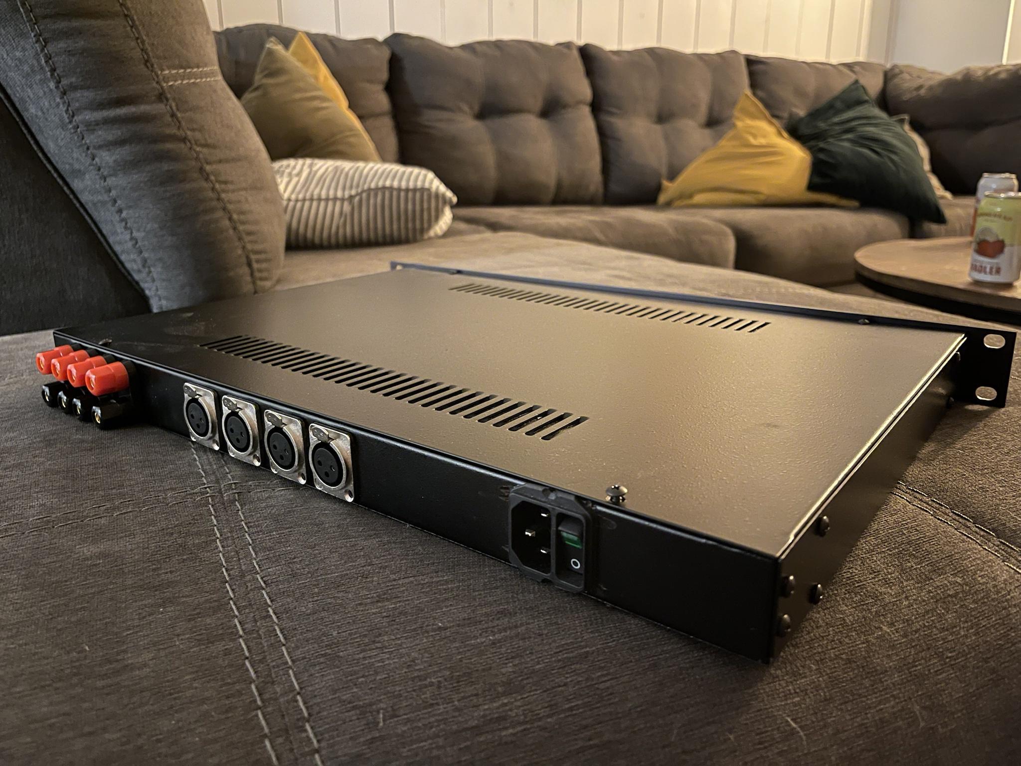

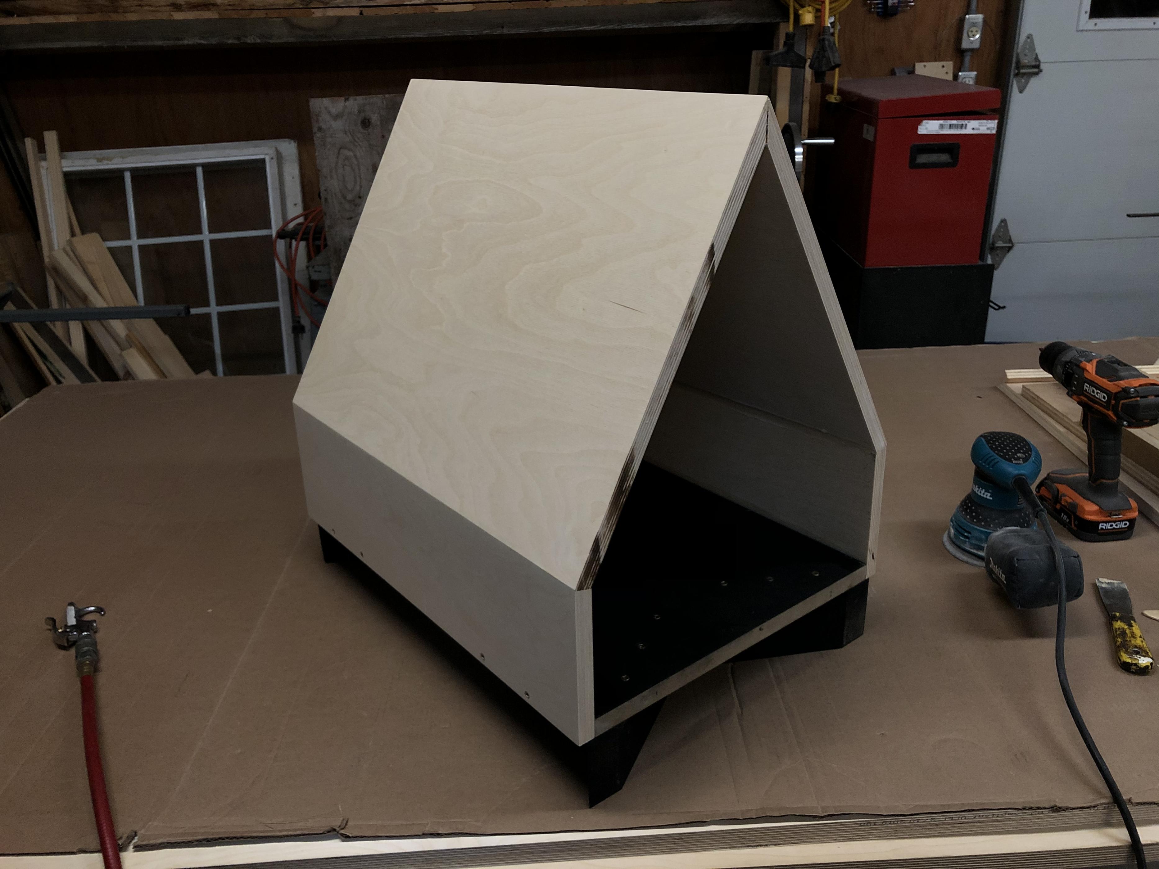

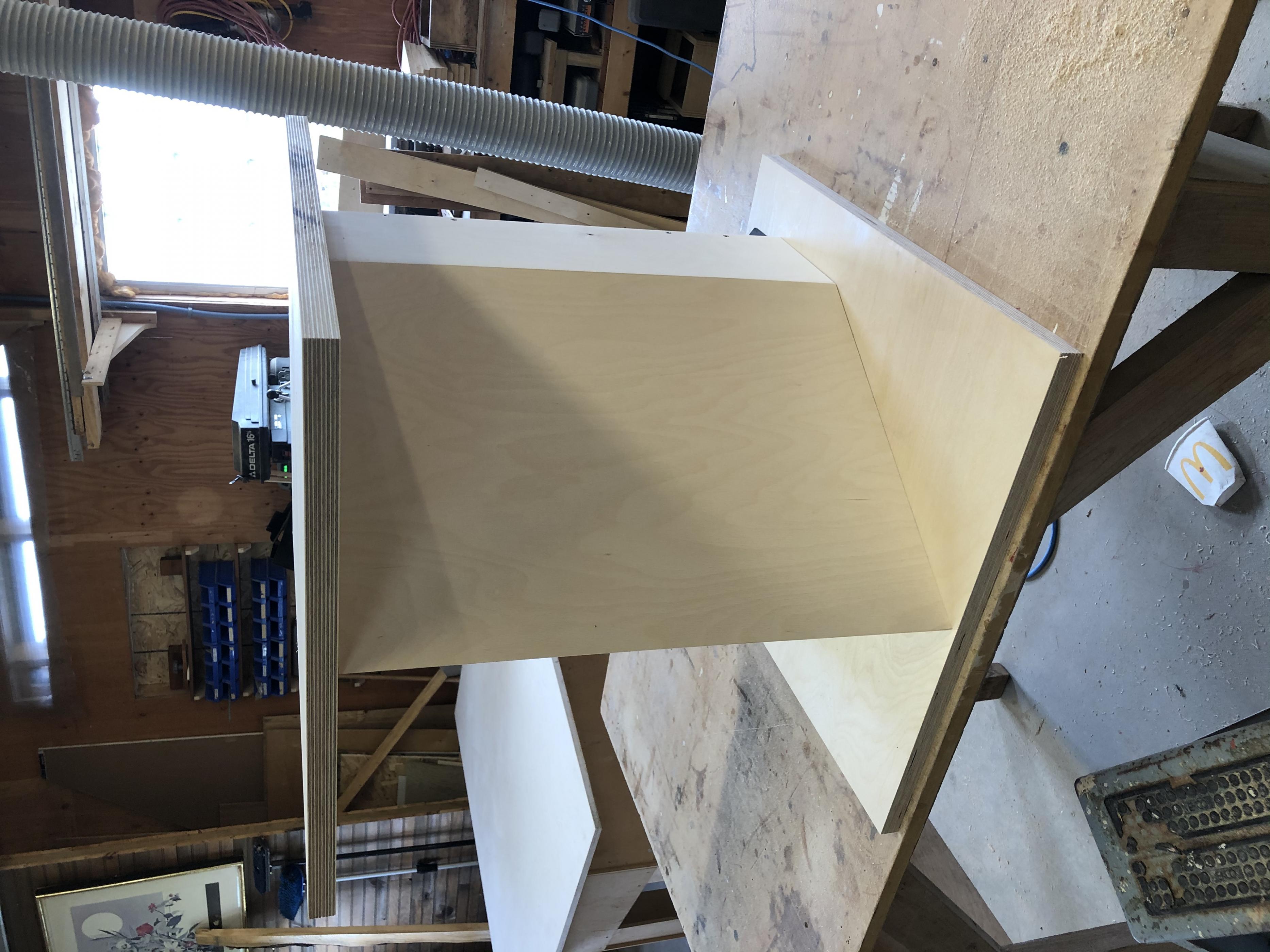

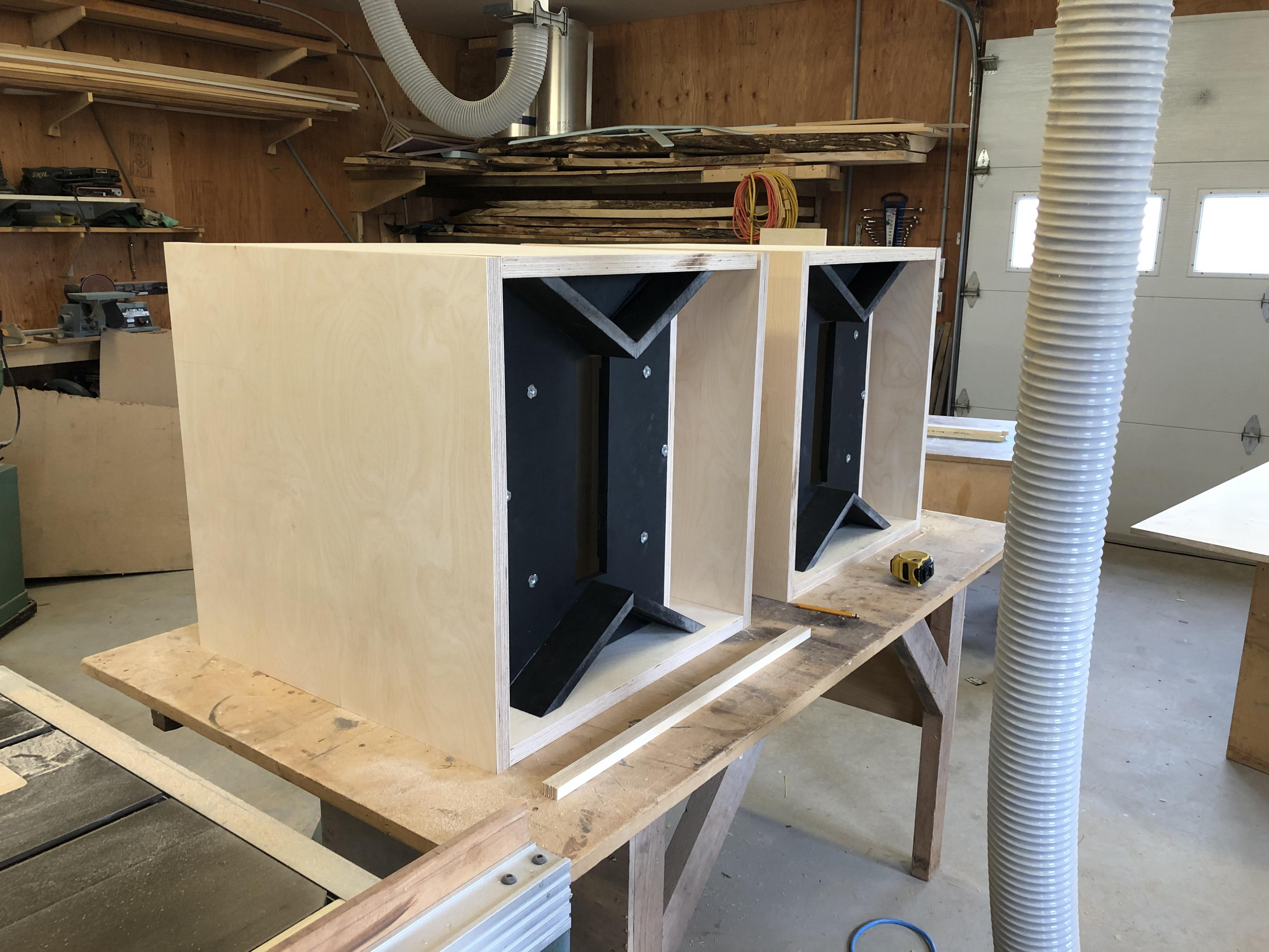

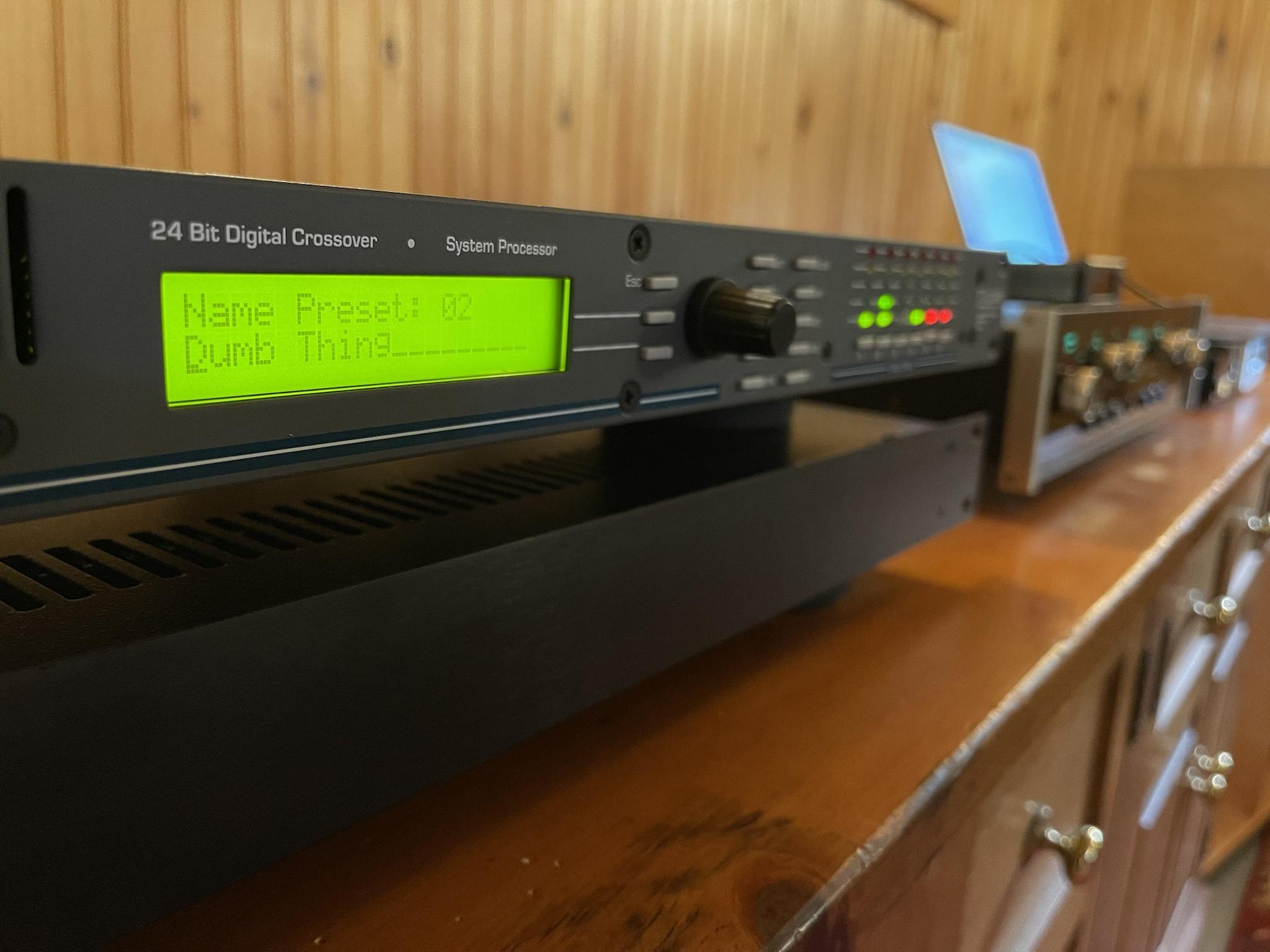

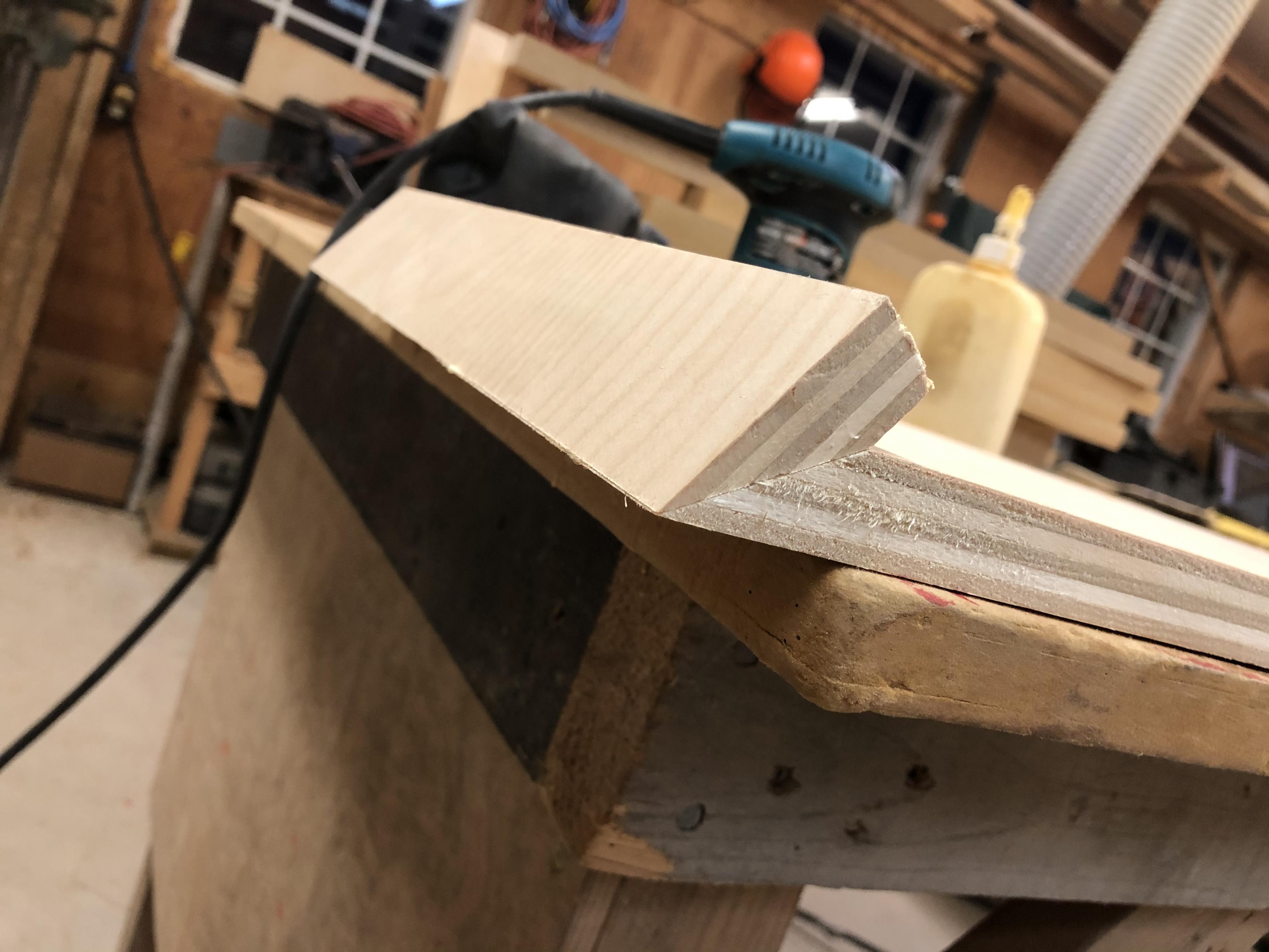

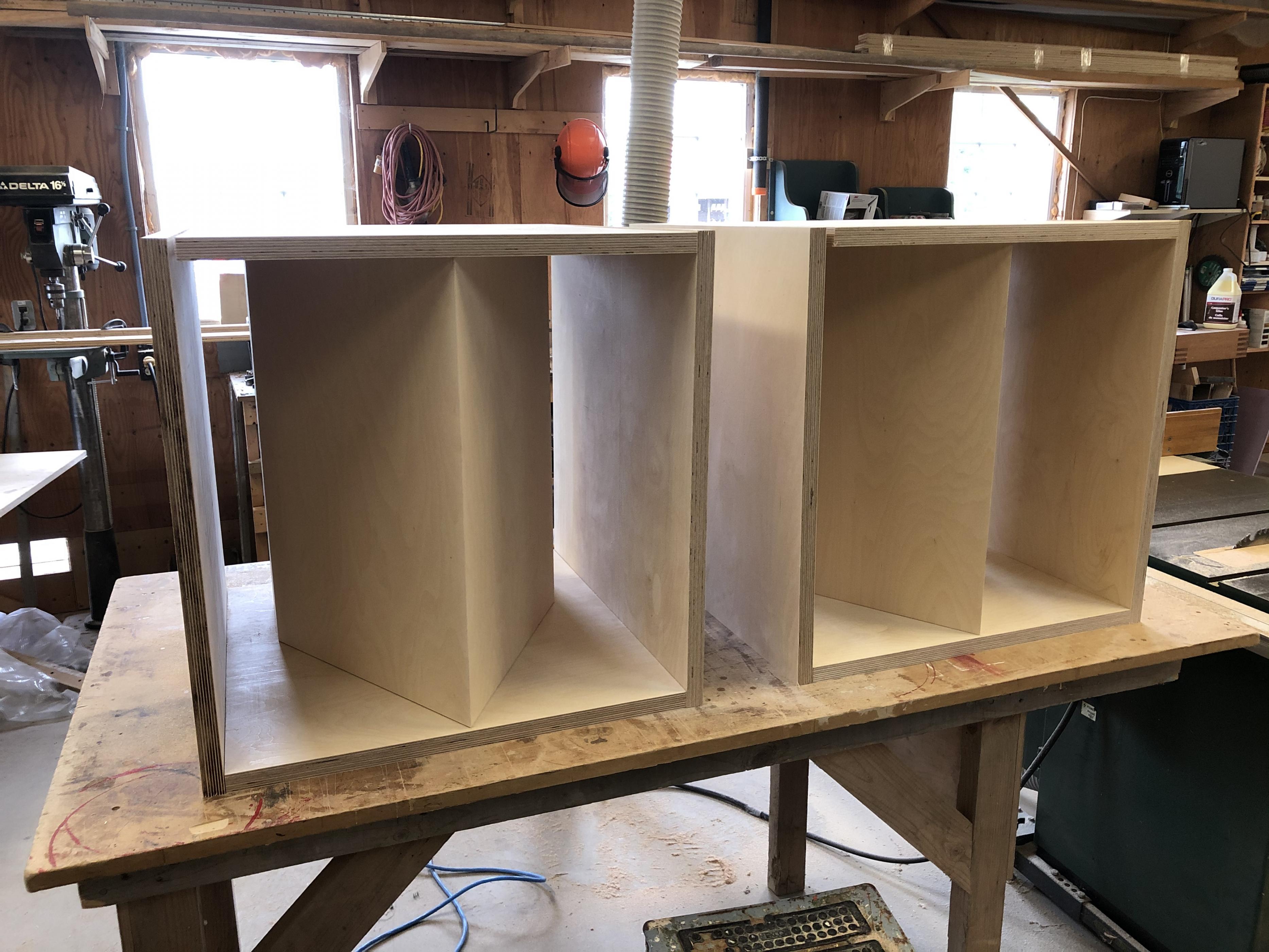

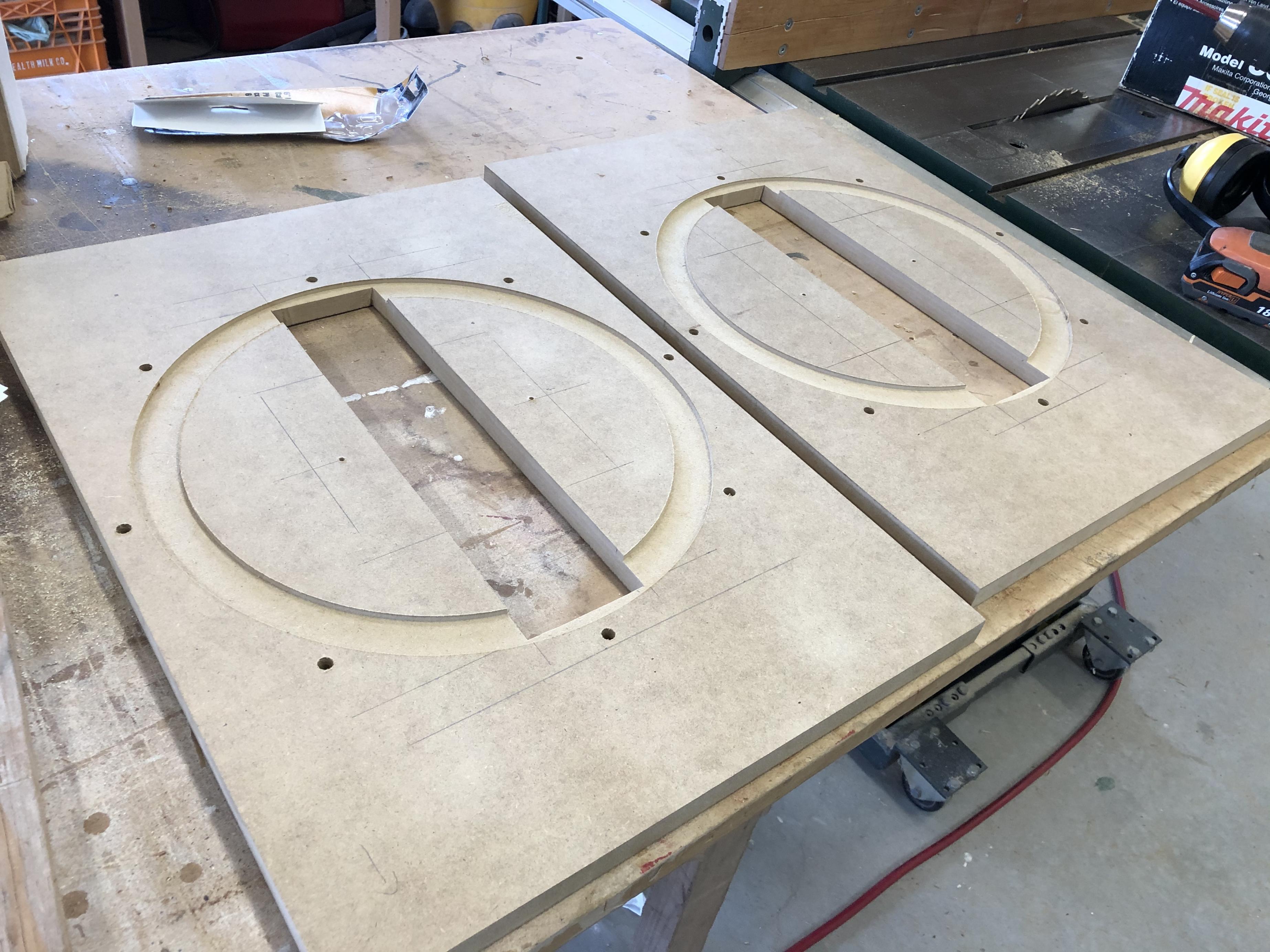

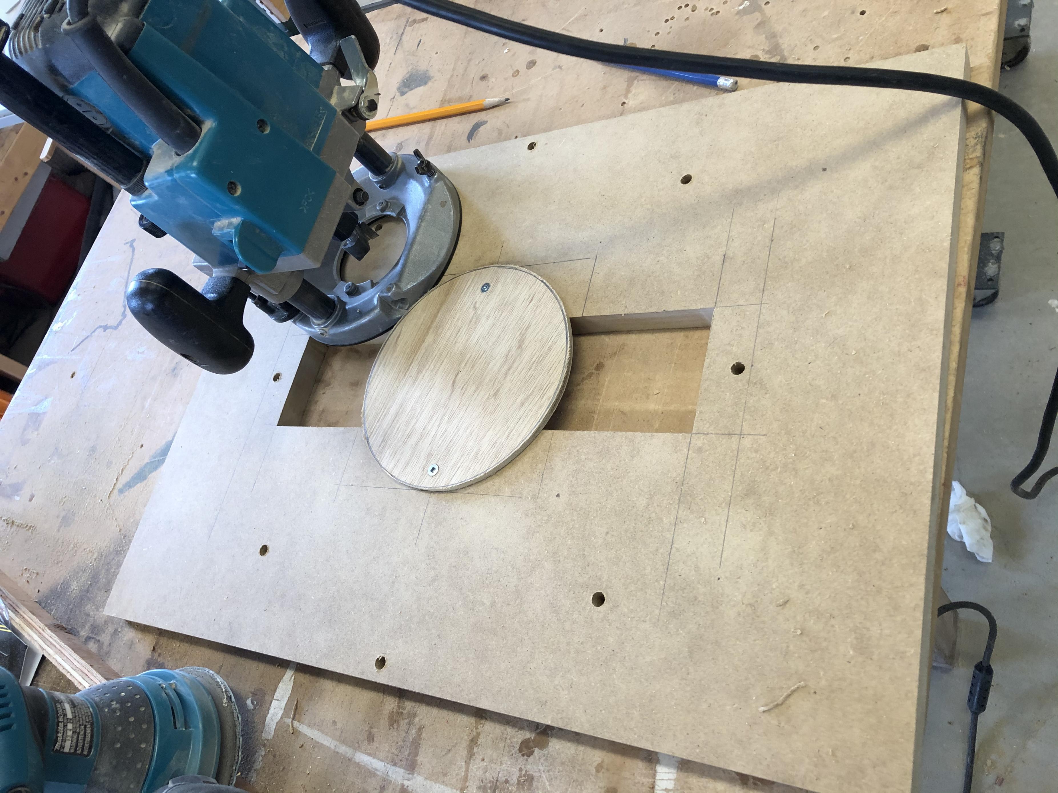

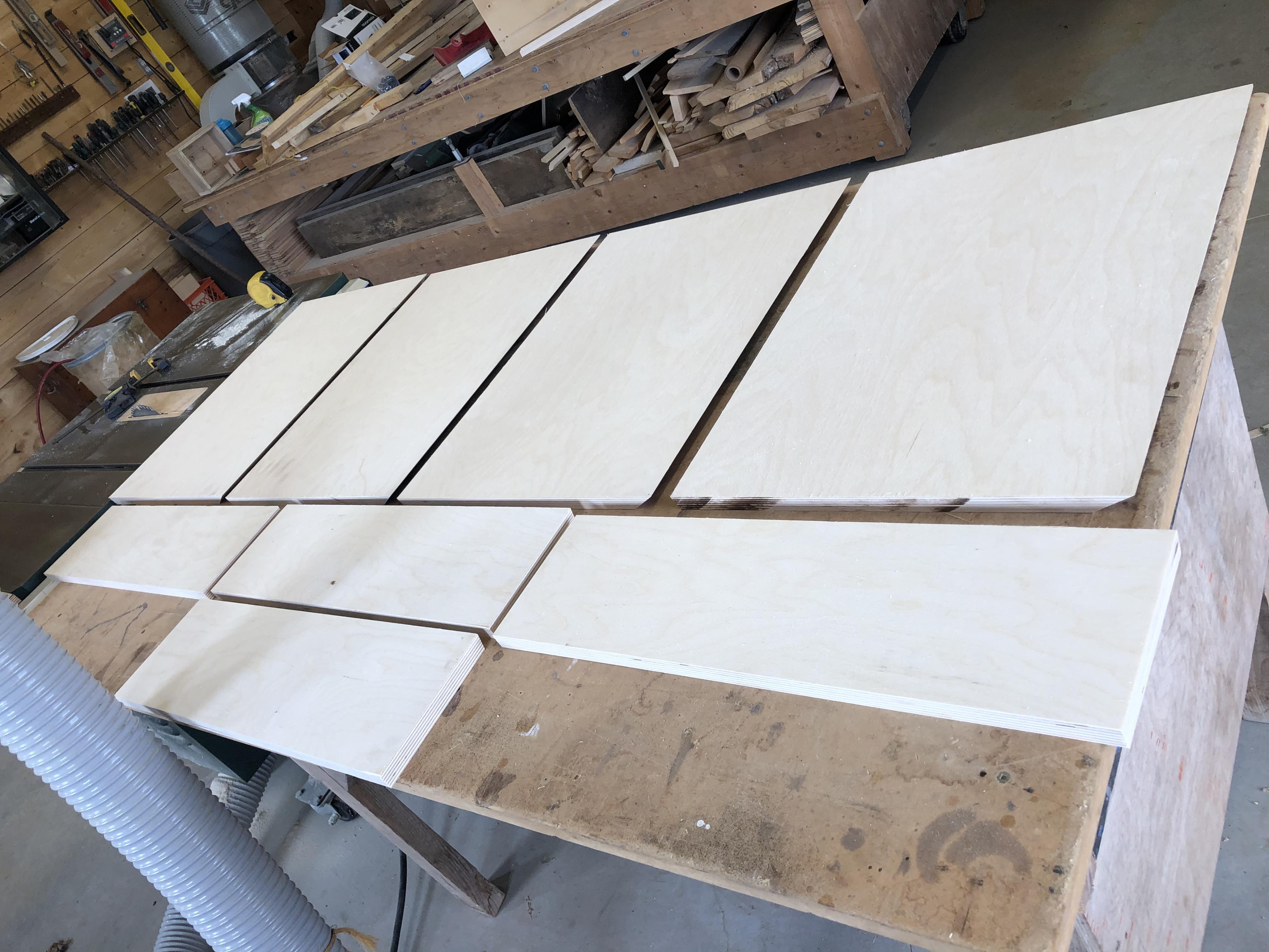

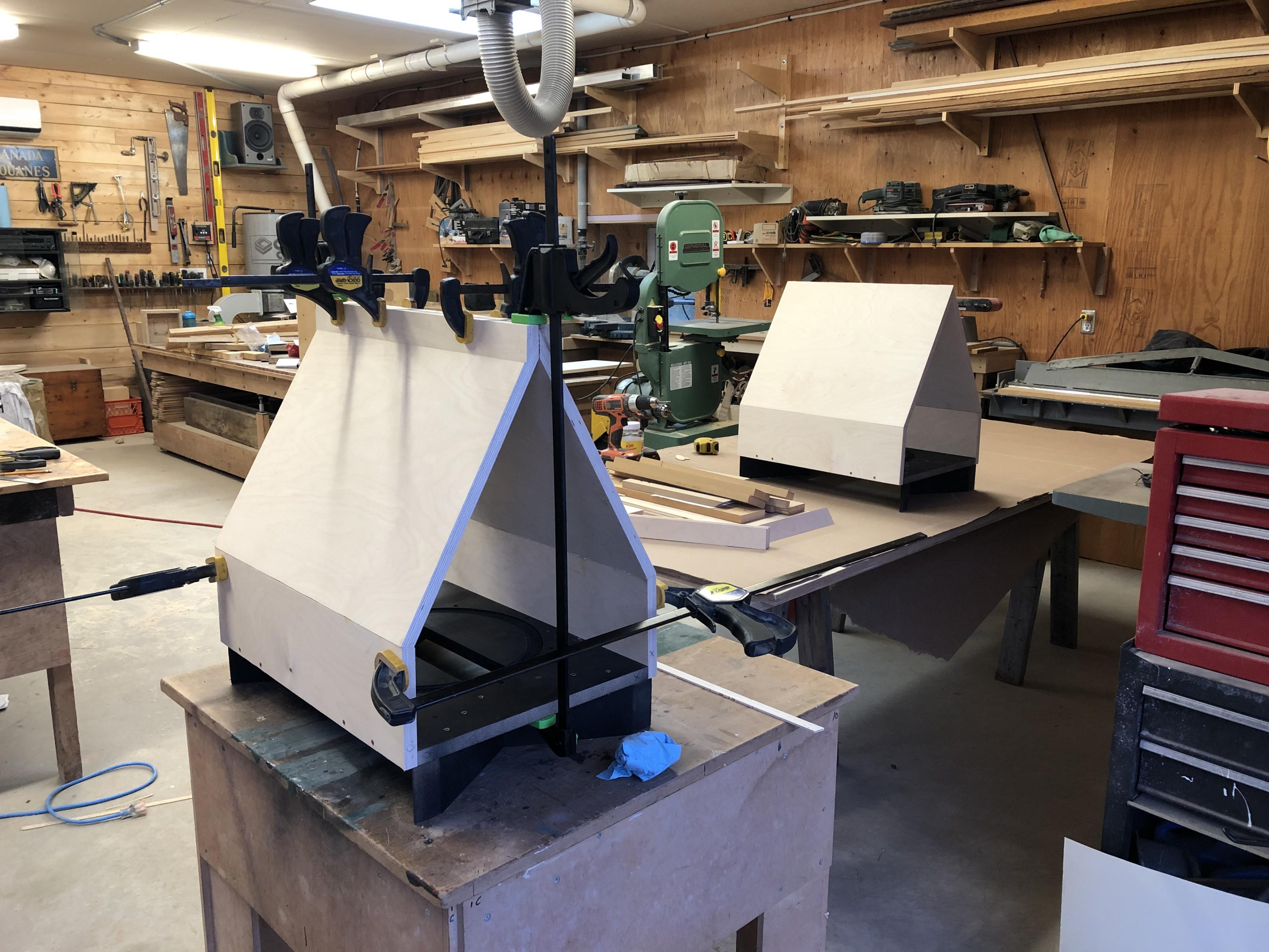

Roger I'm sorry I never saw this or replied, your project sounds super interesting. I did end up sticking with the TPA3255 based system as well as the LRS-350-24 power supply. There is no audible hiss present with this solution and plenty of power to basically go deaf before distortion sets in. I build a pretty simple little enclosure for it that sits under the Ashly. Since it's a one-purpose solution I made it as simple as possible with balanced inputs aligned with those on the back of the Ashly. Also using a McIntosh C712 preamp with balanced output so everything in the signal chain is balanced which is nice.

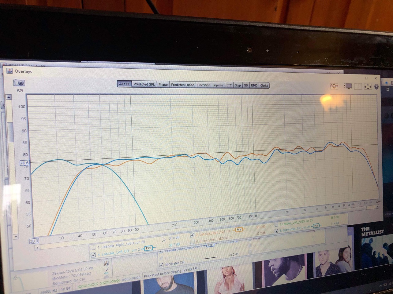

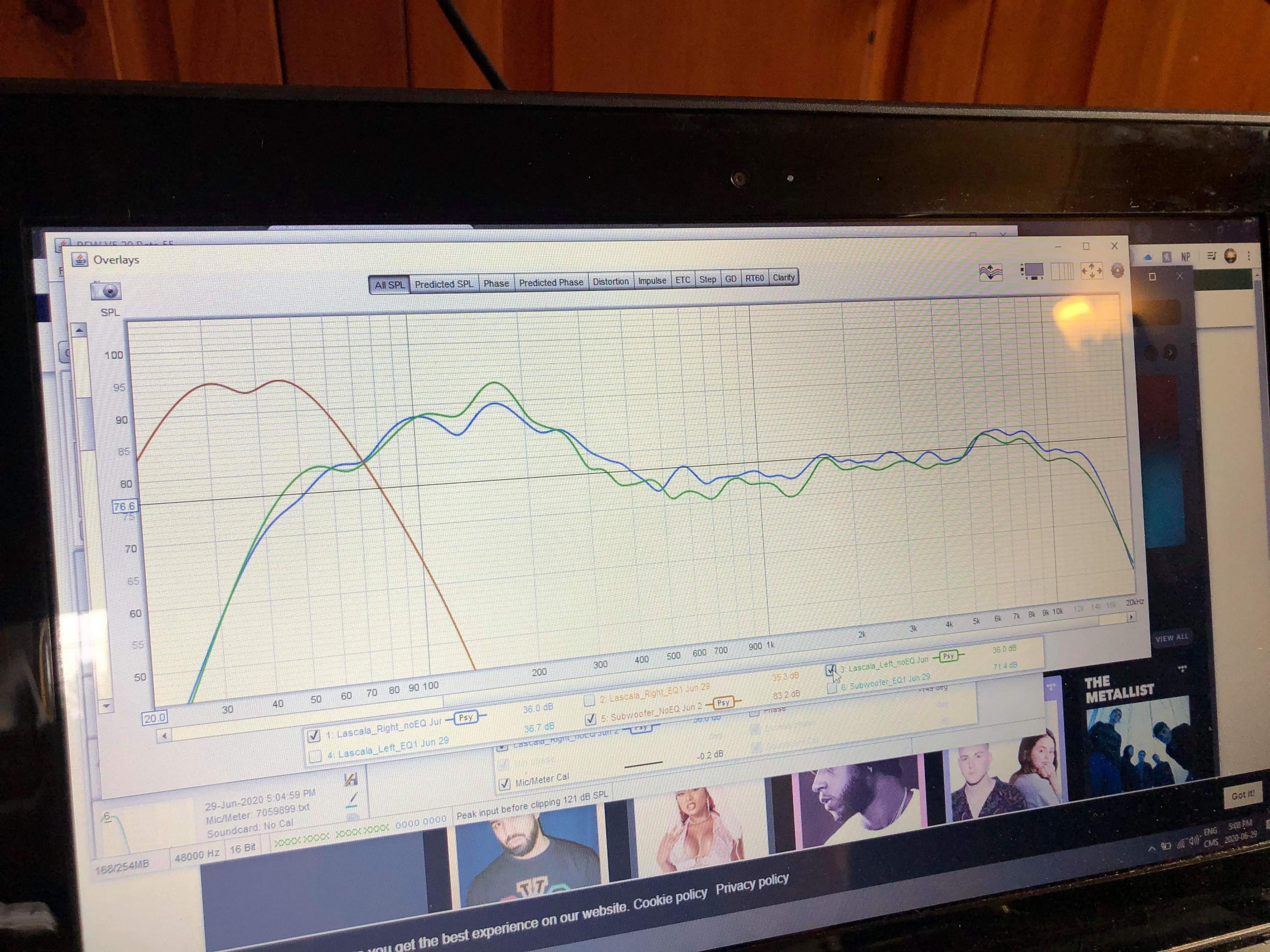

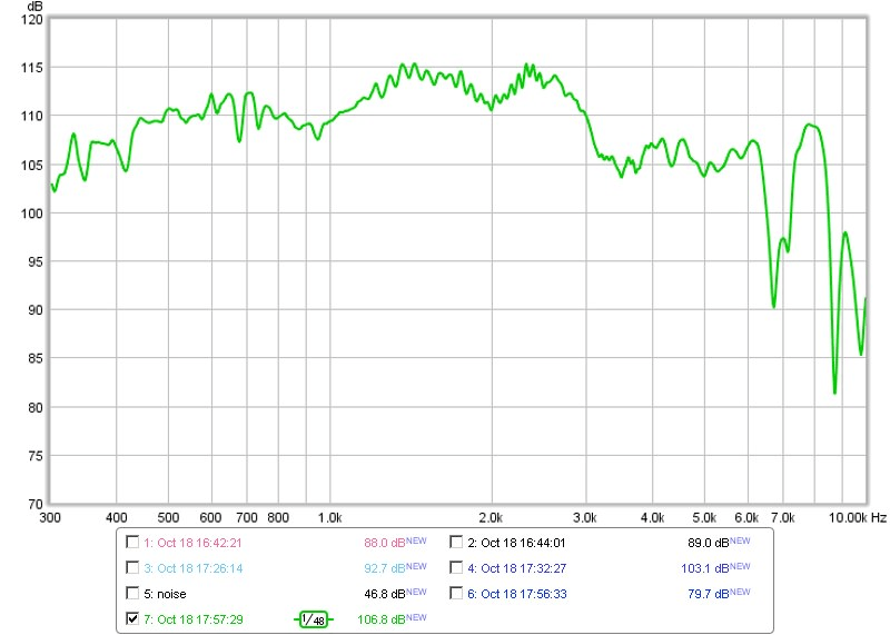

zeagan, what are you using above 8kHz? The Ti phrams break up badly above there and will oil can if you push them hard.

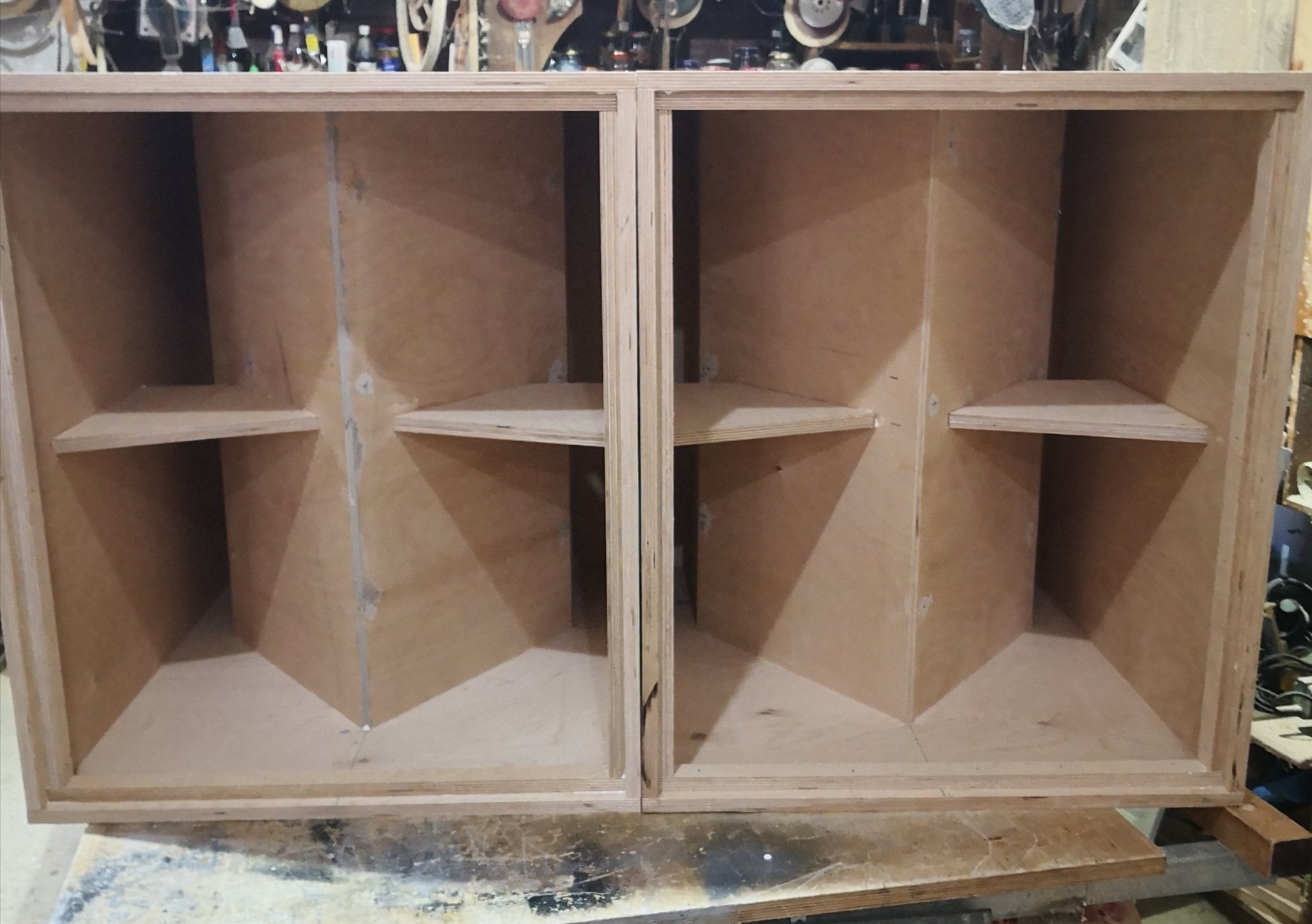

Also having had several LS sets before, both factory and clone, I've dubious of a 50Hz response from them. The flare is too short to support it. This is why djk (vale) developed the ported version and whilst that was better, it wasn't great. My KHorns in really solid corners just did 40Hz and they're far larger.

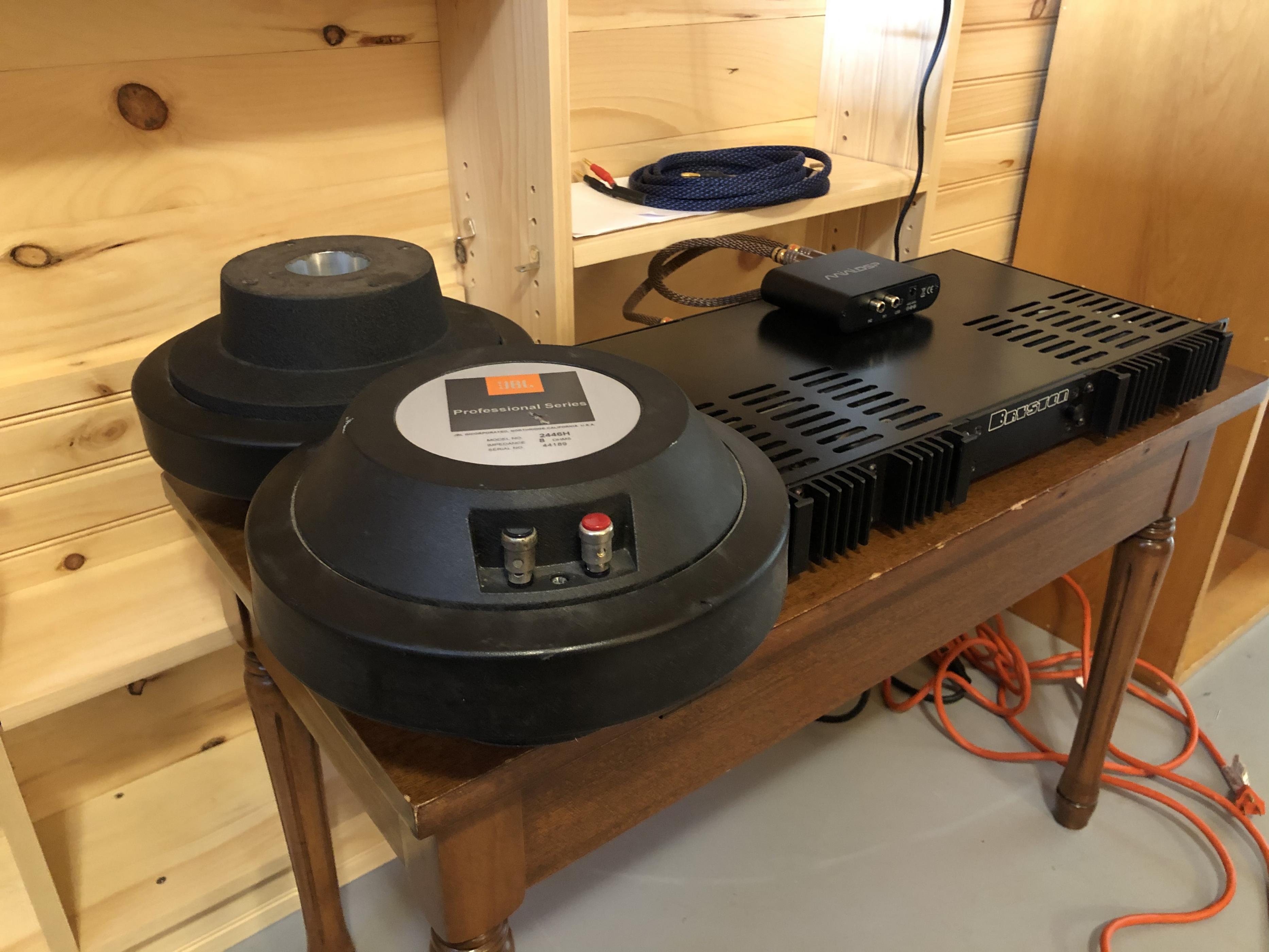

Brett, I’ll do some in-room sweeps when I get home from both a meter out and listening position as I’m going to be re-doing the EQ, crossover and delay. Did find this photo from a year ago when I was dialing them in though. The 2445’s did fine up to around 13/14k in that horn and the bins played down to 50Hz without issue. If I recall correctly this was when I was trying to maintain that “LaScala” sound which is basically exaggerated mid bass, when I EQ’d them flat they felt boring.
If you're happy with the 2445s up that high, great. I couldn't live with them even with Radian Al phrams.
EQ'd flat and get rid of that 10dB or so hump, and yes, they're going to sound more boring because they're going to be rolling off closer to 100Hz. I measured mine outdoors, ground plane.
I’ve just never experienced any oil canning on them, the long term is to pick up some de750’s but for now these perform better than the data sheets would have led me to believe.
Also EQ’d flat they don’t roll off at 100Hz.

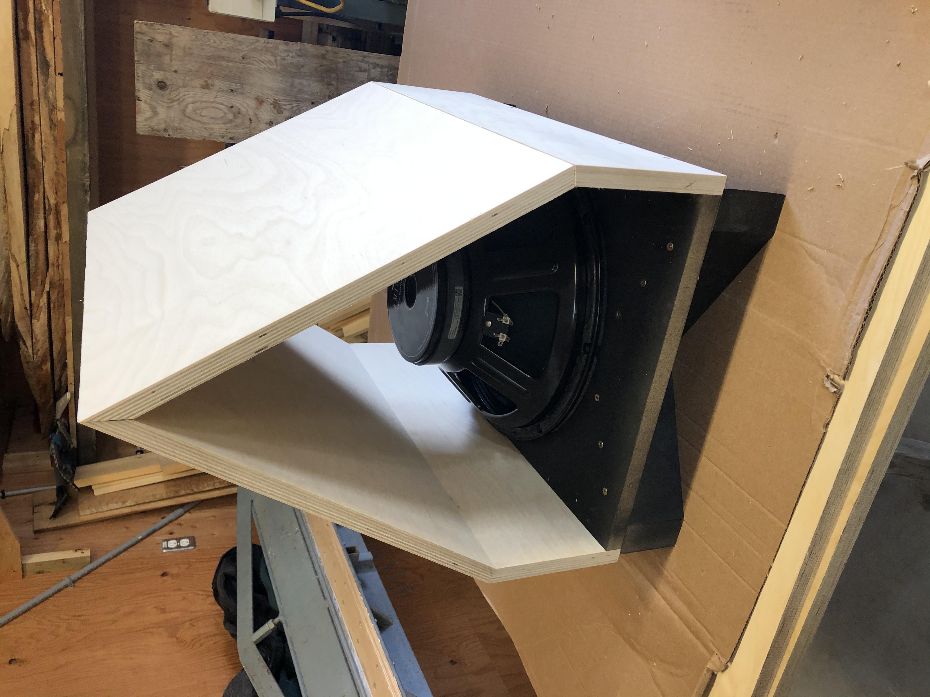

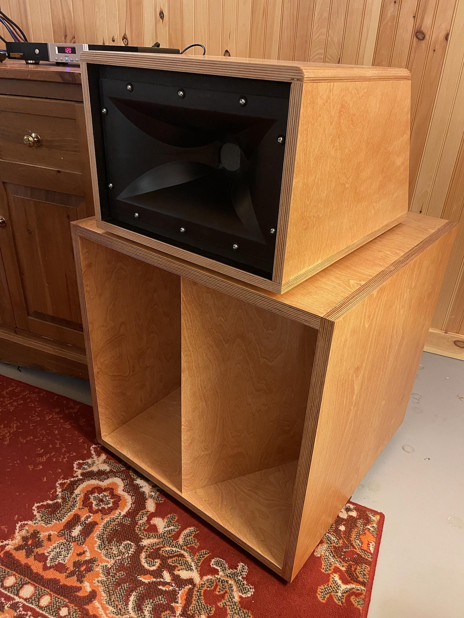

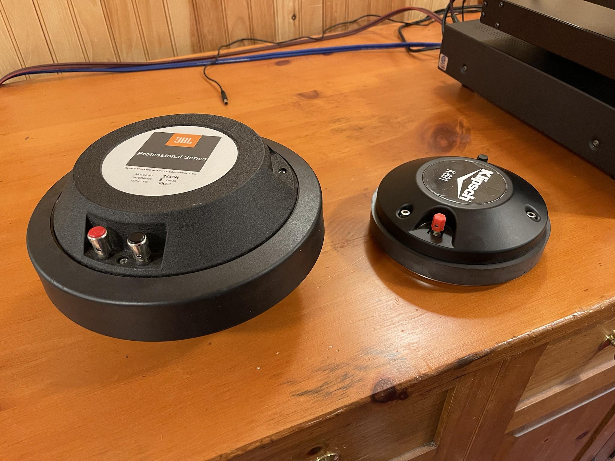

Just a little update to anyone that was following along to this thread from a while back, I came into possession of the newer K510 horn lenses (actual Klipsch ones, not the clones from ebay) and added those. Also I swapped out the 2446h JBL drivers for K691's, which are from what I understand B&C de75p drivers with a slightly modified diaphragm.
As for the DSP/crossover/delay settings, Roy Delgado at Klipsch actually put this style bass bin in their anechoic chamber with this horn lens and came up with settings for both. The setup he had was using the K69 compression driver (which is a P.Audio BMD750), so the HF PEQ settings and shelf filters were modified (since I'm using the K691) after some measurements, but it made for a good starting point. After several iterations and adjustments this project essentially turned into a LaScala bass bin with a Klipsch KPT-904-HF on top and 90% of their DSP settings, sort of DIY but not.
Now here's some photos, absolutely wild how much smaller the compression driver is than the JBL dinosaurs, the new horn lenses with "mumps" are nicer to look at too.

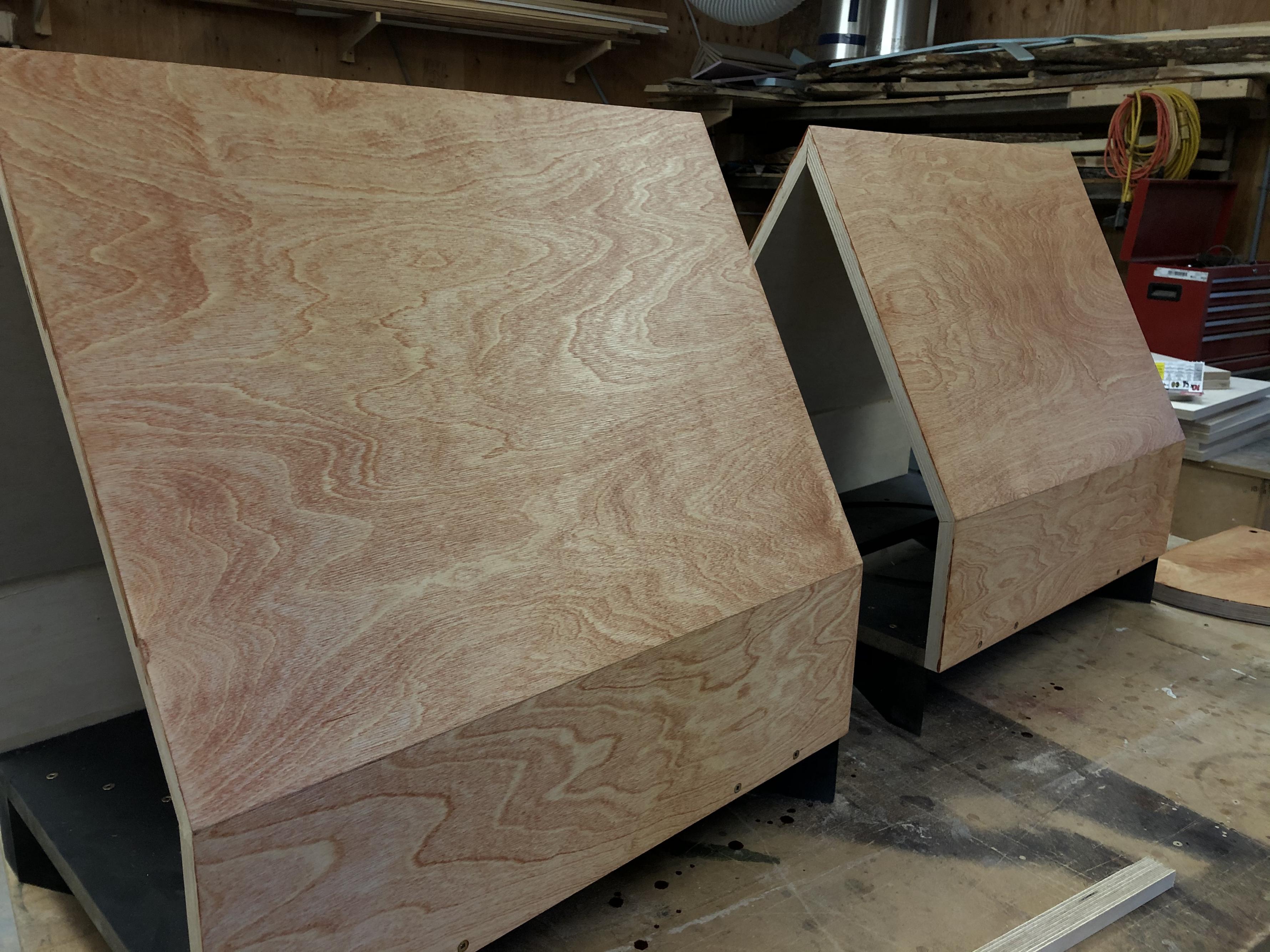

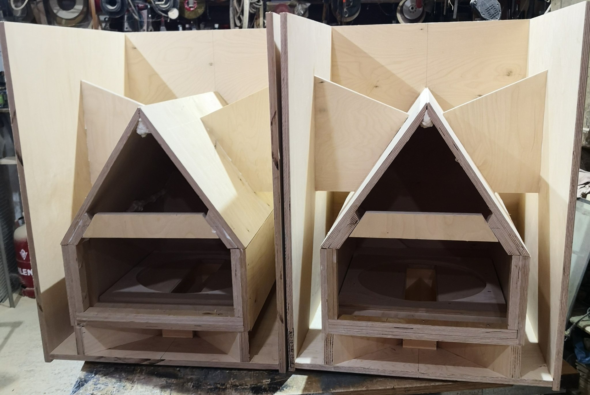

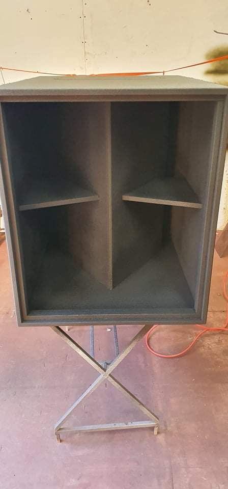

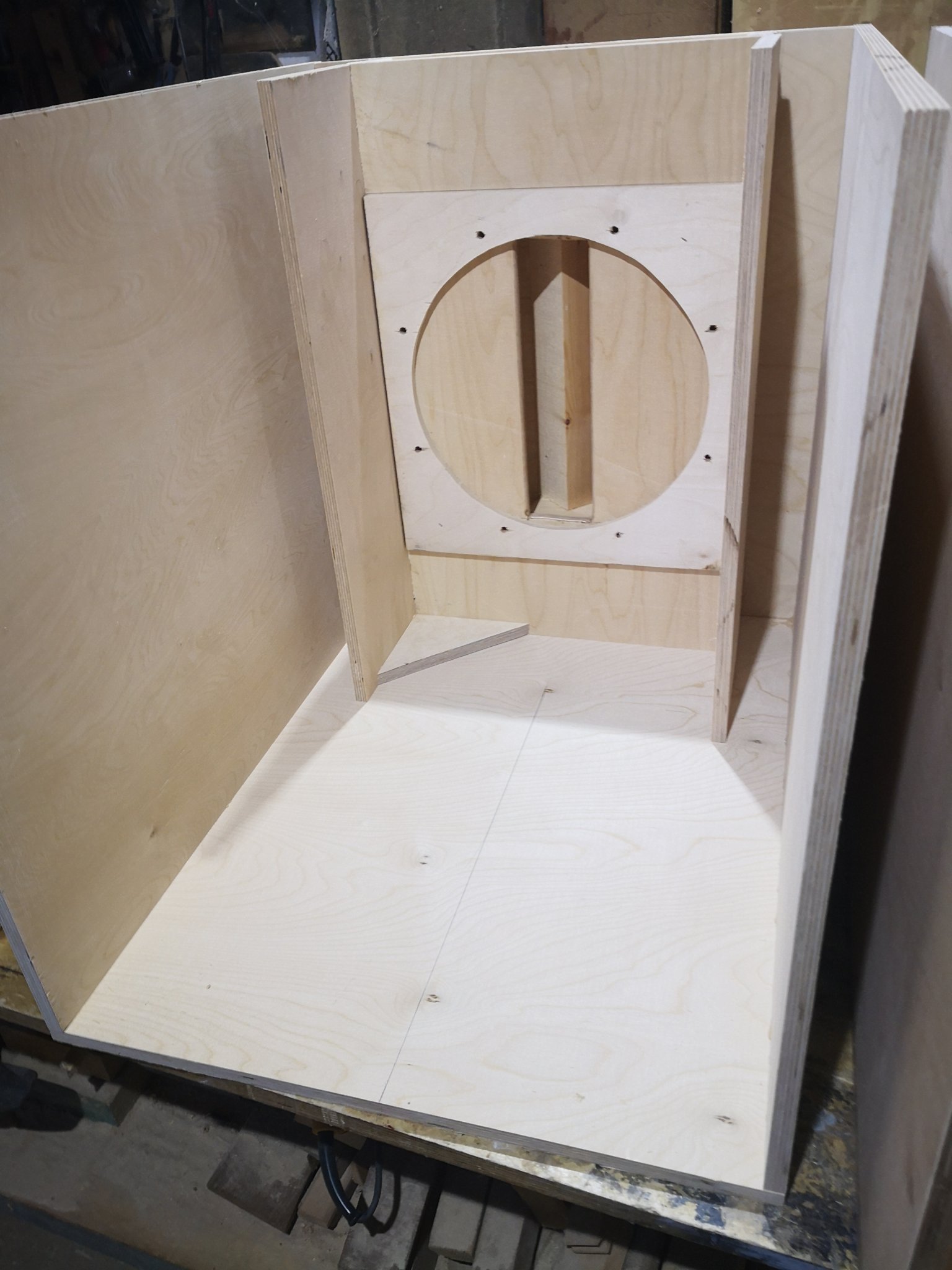

hi again i built the last month two midbass horns for a friend.i made bigger from original plan 80cm deep 60cm bright and 70cm high.loaded with b&c 15pl40. here some pics.View attachment 1011979View attachment 1011980View attachment 1011982
Interesting, they definitely look sturdy, I'd guess close to 200lbs each? I'd be curious to see what the the effect of the extra depth and if there's any weirdness where the expansion stops for that last few inches and the mouth of each horn section merges at the point of the doghouse. Did you model these in hornresp to see what the differences in rates of expansion of the throat would do to the response? Cool work!
no i don t have the time.only acoustic tests done and they are chest thumbing and very aqurate and clear there matters the heavy constraction material and bracing.is dificult to find here the right speaker for that box and we had offer some rcf s models new but their specs is for bass reflex and we desided to B&C model. it sounds amazing out of the box and after the burn time is gonna play more better . is start from 45hrz to 500hrz don t make use of any eq (i hate eqs) boxes have to play good without any of process only 24LR hi pass and low pass crossovers from one dynacord dsp260 processor .and yes is very very heavy made from 15mm board but is for instalation on my friends living room and not for turing.
Makes sense! Definitely looks solid. I'm sure your friend is happy to have them.
