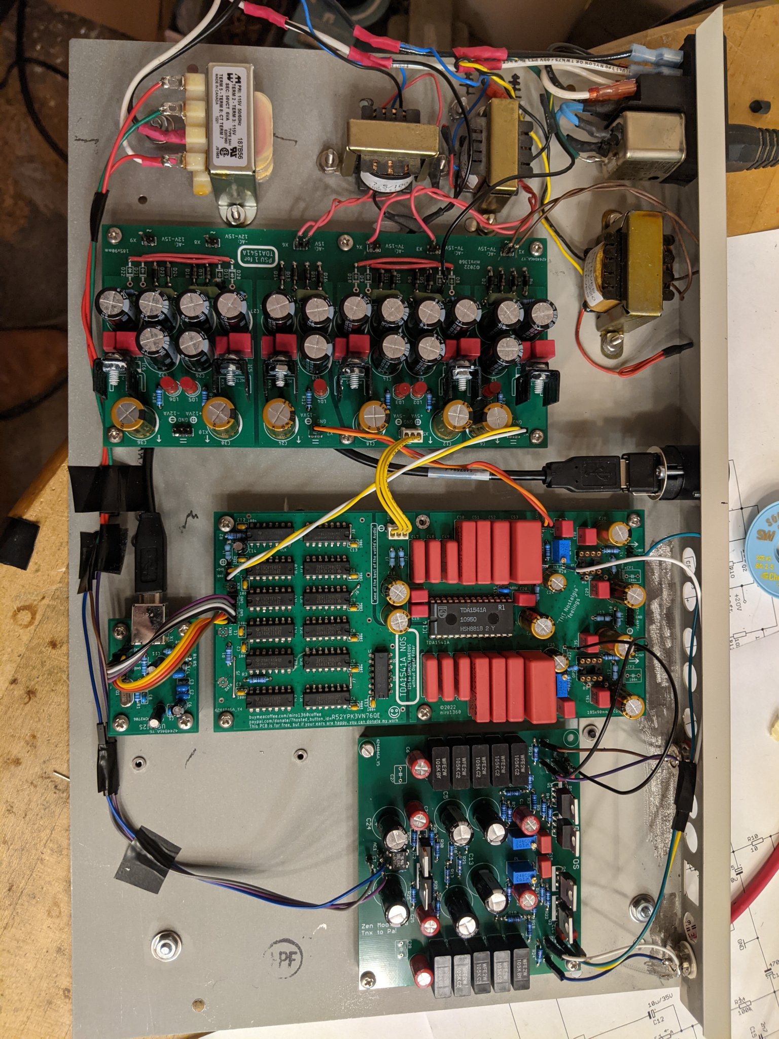

Hi All,
I recently built a TDA1541A DAC, using gerbers and info from the miro1360 thread; relevant info is at
https://www.diyaudio.com/community/...s-input-nos-r-2r.354078/page-268#post-7159210

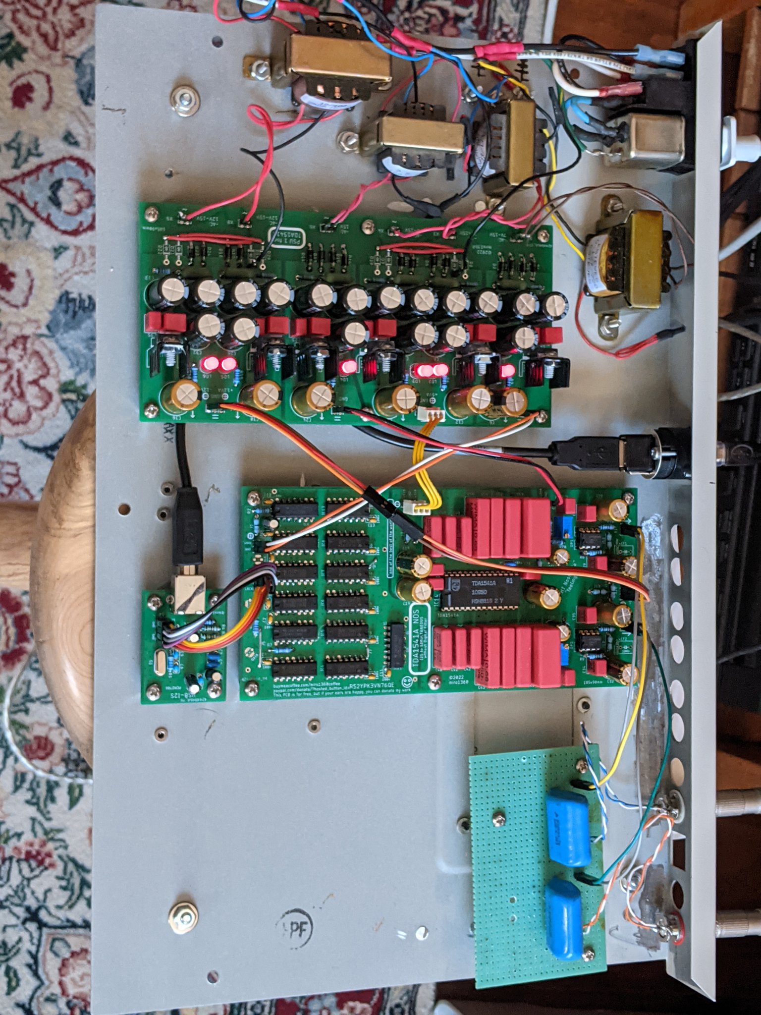

The DAC sounds great; I've attached a photo - the output caps were a temporary safety measure while messing around with DC offset. Anyway, it sounds (or sounded) great. But of course I couldn't leave well enough alone, and my plan is to try other I/V ideas. Starting with the Pass D1, using the schematic two posts above this one, and ZM's gerbers posted elsewhere on the site - I forget where.
However the DC offset with the D1 is very bad (about 12V on both channels) so I've obviously done something wrong. Before I start searching for construction errors I'd like to ask whether I've disconnected and connected things incorrectly when changing I/V stages, since the TDA1541A supposedly has a big offset when you do that...

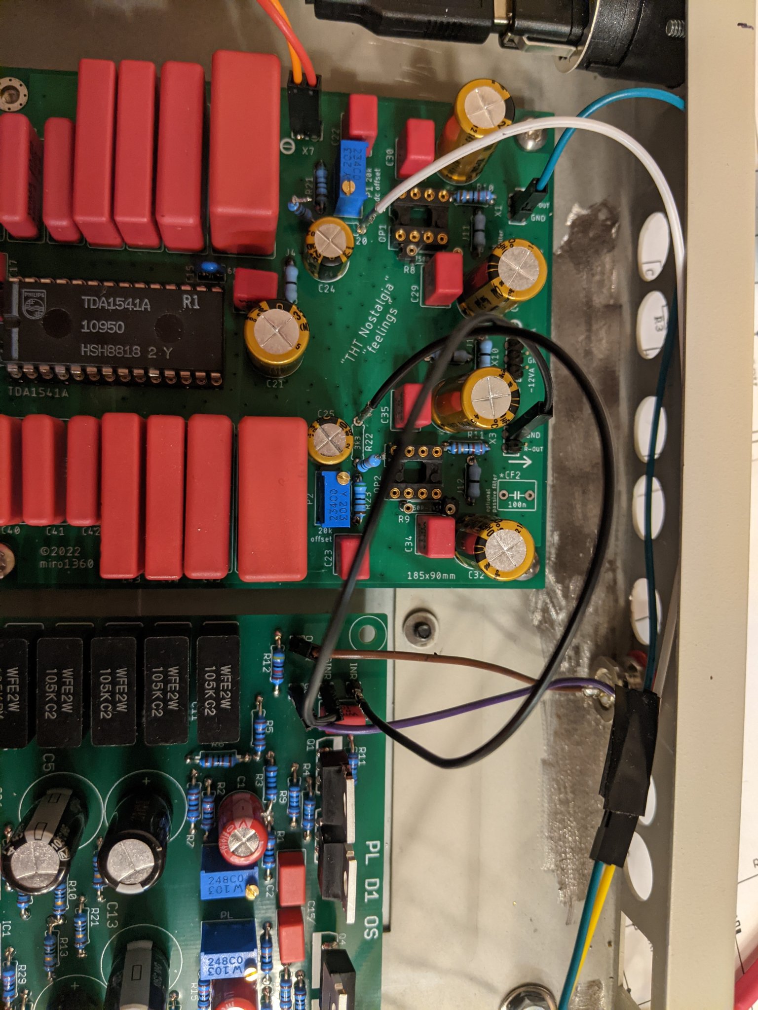

What I did on miro1360's board was to remove the opamps, lift R20 and R8 (and R22 and R9 from the other channel), and then connect pin 25 of the TDA1541A directly to INL on the circuit above. I thought that I would not need the DC offset circuitry on miro1360's board, since the D1 board has it. Is this right? Did I miss something else that has to disconnected? Or connected?
Thanks in advance for any help.

From your description it looks like you disconnected the existing output stage.
So there is something wrong with your D1 setup. A picture of the DAC with the D1 connected, showing all wiring and details of the D1 board would be very helpful. A picture of the previous setup without the D1 setup does not give any information on your current issue.
Did you connect the power supply ground to the D1 board?
With capacitors in the output of the D1 there should not be any DC offset.
Hi Ben,
I'll post photos shortly. To clarify, I'm not measuring the offset at the RCAs, but across R11 and R23. If I understand correctly, the TDA1541 has a 2mA offset that the trimpot on miro1360's board handles; I thought the arrangement on the D1 did the same thing? Either way, that's what I was measuring. I can check the RCAs but you're right - I'm sure there's no offset there.
The power supply board has separate grounds for each regulator (each of which has its own transformer). These are all connected together on the DAC board; the ground from the D1 board is also connected there - at least, it should be; I will check.
Have I misunderstood something about the 2mA offset business?
first test d1 pcb alone, to check are you able to set voltage level on input node
if that is OK (0V), check TDA output node voltage temporary shunted with 22R or something to gnd - it must be so-so 0V
then connect D1 to TDA (both gnd and input ) ; if both above are OK, you'll be able to set TDA out/D1 input to 0V, meaning that TDA is getting "missing" 2mA from D1 (input) current string

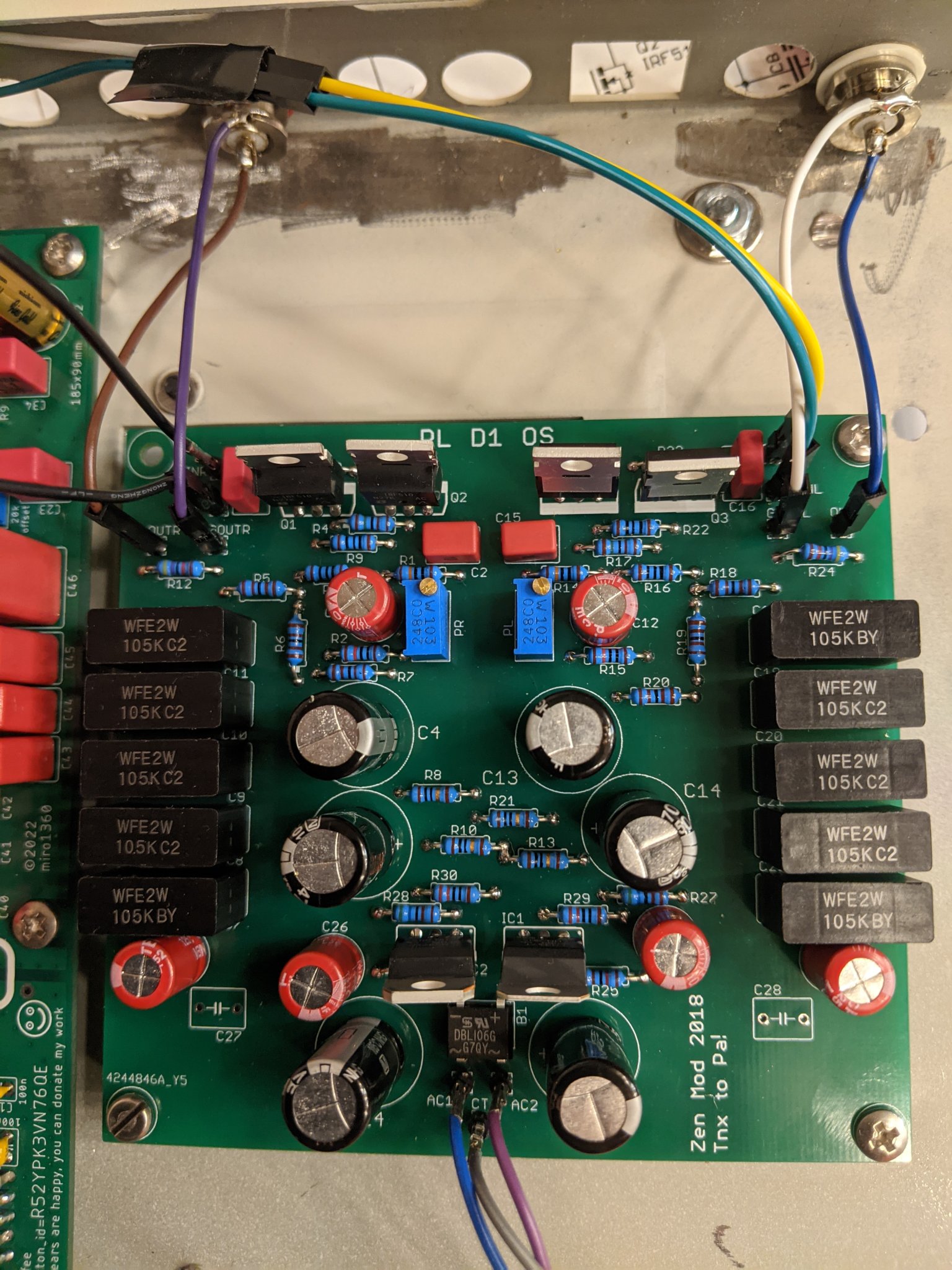

OK, Here are some photos. I had disconnected the D1 to measure some stuff, but it's all back as it was when I was measuring.
I checked ground connectivity; the center tap on the transformer for the D1 is connected to ground on the DAC board, and hence to the center tap on the other transformer.

The 12V across R11 and R23 is a voltage of the D1 circuit. Disconnect the TDA from the D1 and it should still be there.
Yes, it is. So I'm worried about nothing here? Was I measuring the wrong thing to see whether the 2mA was dealt with? Is this unimportant with the D1?
By the way, did you adjust the pot on each D1 channel to zero the voltage at the source of Q1 and Q3?
Aha! No, I didn't. Let me get on that...
Checked; yes, I can get it to 0. Or at least very near. (I didn't wait for it to warm up)
Also 0V.
Yes! This works fine; at least, I can get it to within 1mV, and I've left the unit to warm up and will adjust again.
Many thanks for the help. So the real problem was my lack of understanding of what the circuit is doing. As usual... I'll try the unit out once I've rechecked the offset, and will report back.
