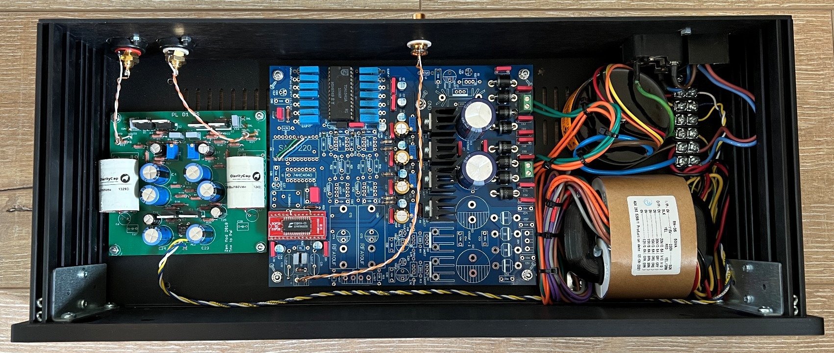

The Pedja Rogic IV looks interesting; thanks for the suggestion. I have to say that the D1 sounds really good so far, so I think I may stick with it for a while. It'll give me time to see whether I have enough BC547/557, and which other IVs I want to try.

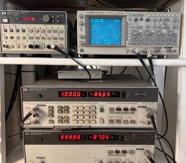

Hello All - quick question regarding distortion on a TDA1541A with a tube output stage - what would be a reasonable distortion number - Best I could do after numerous tweaks is 0.03% / -70db - 1kHz 0DB with a 30kHz low pass filter.
Warm regards, Emil

Thank you so much ggetzoff - To remove the guessing I build another board with a basic NE5532 output and with this I can get up to -87dB which is close to the datasheet - will work on this now till I can get to desired numbers and then just swop with the tube stage I have ready 🙂

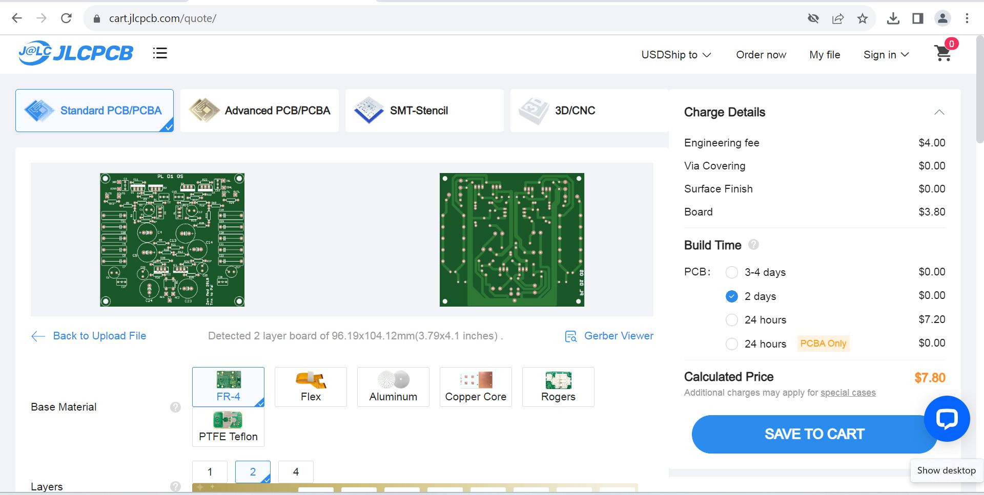

Hi, sorry for waking up this "old" thread but I'm in the mood for a new project and since having a few old 1541´s at hand, I think it would be fun trying out something like this. Now my problem is I'm really out of touch with computer stuff these days and don't manage to put the D1 Gerber files together to something the pcb makers accept. I have downloaded gerbview but so far only been able to open the file named "D1.gbs"
Probably relevant and definitely part of my problem is I only have access to Mac and growing up with windows, I'm not very familiar with the MacOs. So if there's a patient soul reading this and wants to help me figure it out, I would be very happy 🙂

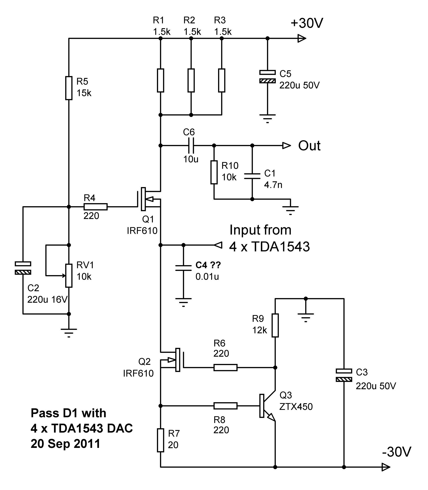

I just come across this thread. I would like to share my work on a similar setup. I built a I/V conversion circuit based on D1 with 4 TDA1543 in parallel. I had used this for a very long time until 2021 when I bought a small Chinese DAC (SMSL Sanskrit 10th Mk2 using a AK4493 chip). The sound of this AK4493 DAC is very transparent compared to the TDA1543 + D1 but it is a bit too sharp. Recently I start to think about making some small changes to the old TDA1543+D1 DAC and reuse it as my primary DAC. In doing more research I saw this thread.
I attach here the circuit I previously built. I added a CCS to bias the IRF610 and did not use an output follower. 4 TDA1543 will give almost 10mA full swing current. I reduce the load resistance to 500 Ohms (3x1.5k to try to smooth out the tolerances among the resistors) and run the IRF610 real hot at 30mA idle. The voltage compliance of TDA1543 is 1.8V to Vcc-1.2V. I happened to run it at 5.6V approx and I picked 3.1V (about the mid point) as the voltage level at the input (source of IRF610). This is achieved by adjusting the pot at the gate. I left pin 7 (Vref for bias current setting) open.
Currently I am thinking of the following:
reduce the idle current to 20mA to reduce the heat load.
attach a resistor to pin 7 to add a bias current to the TDA1543s to see if this will bring any impact to the sound.
My own experience with TDA1543 showed that pin7 is best left open i.e. the internal bias current generator should be switched off. Note in your schematic the +30V supply does need to be extremely low noise as terminating the I/V resistor to it gives zero PSRR. The original D1 was balanced (as far as I can recall) so relied on the CMRR of the next stage to eliminate PSU noise.
I can't find much info on this bias current of TDA1543, but believe that it exists for some reasons. Reading the spec the max bias current is 5mA, shared by both channels. Each channel gets 2.5mA, which is just enough to ensure that the full scale swing current is covered. This triggers me to think in the context of a Class A amplifier. It seems that the bias current will ensure that the DAC never "switch off", which might avoid some issues? Of course a DAC is essentially a current switch and switching is the norm. I still do not understand this.
