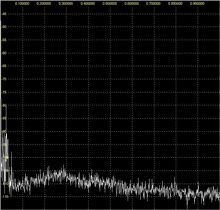

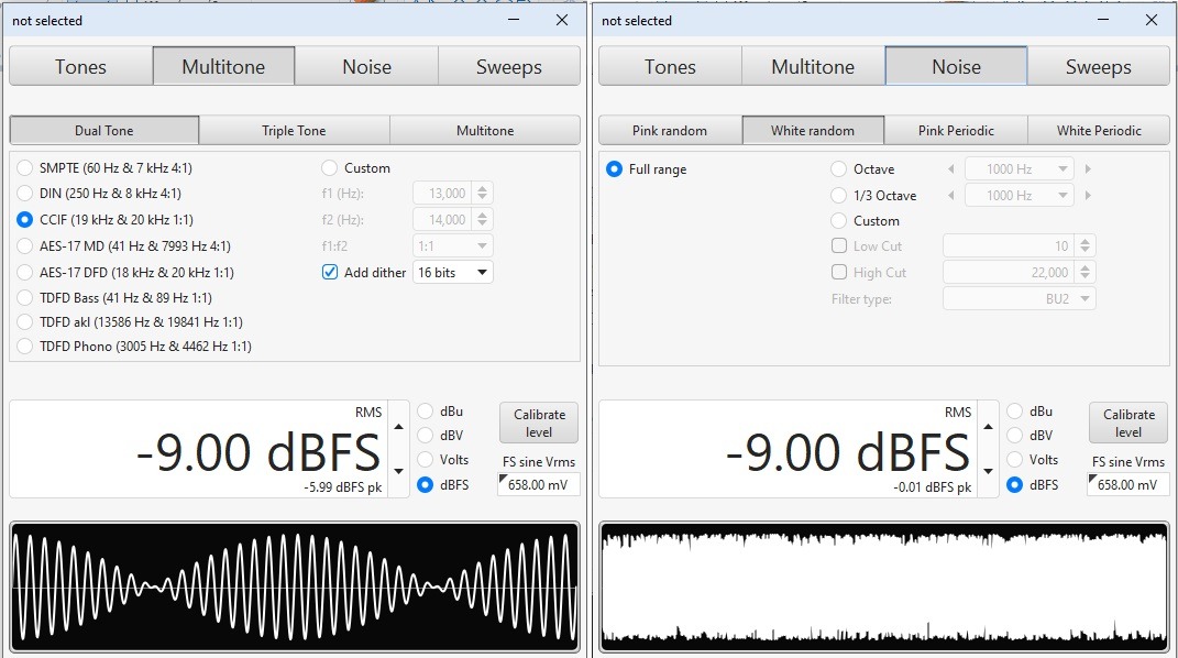

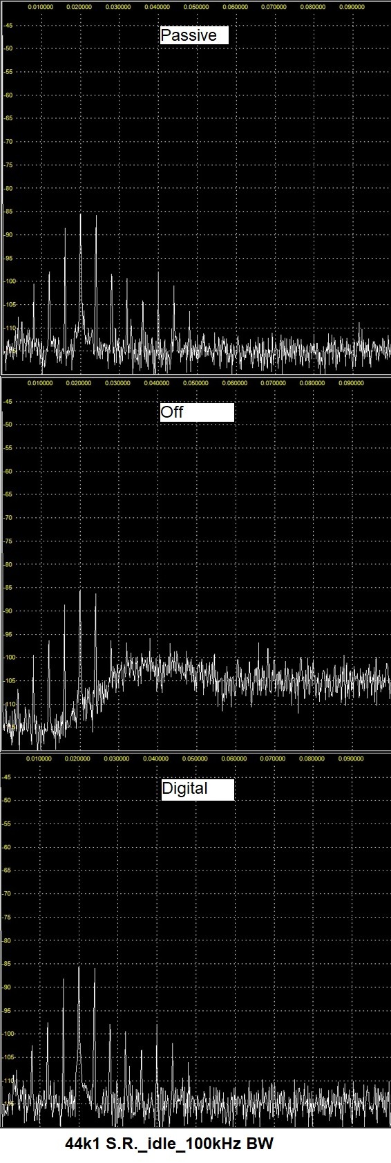

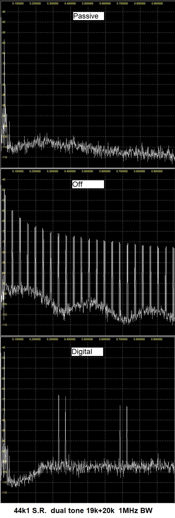

I run the tests inserting a resistive 21dB attenuator btn the DAC out and the SDR dongle input.
I gathered the data for the case of the 44k1 sampling rate . See you another day for the other S.R. data 🙂
44k1 S.R._100kHz BW

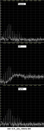

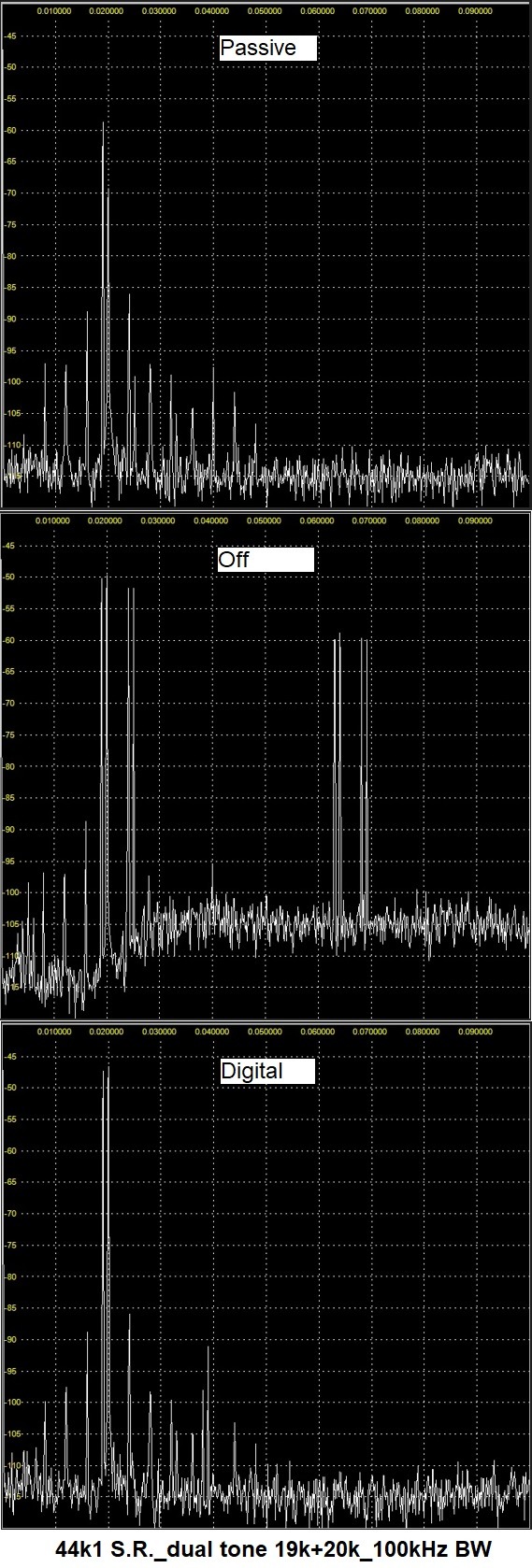

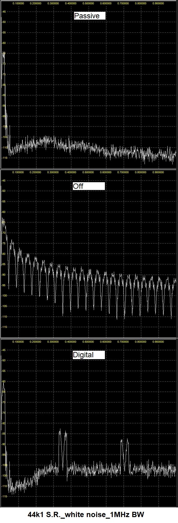

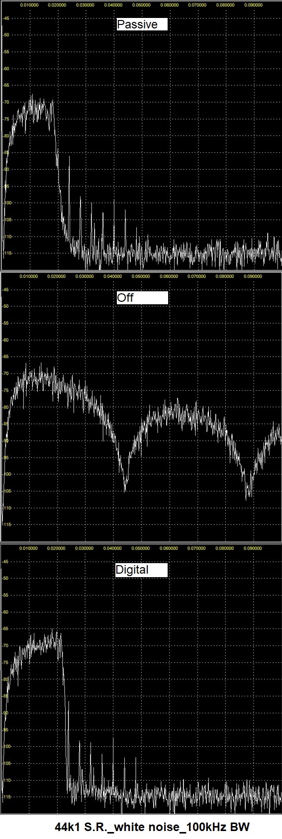

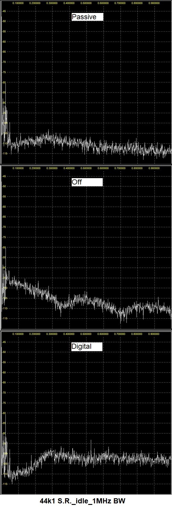

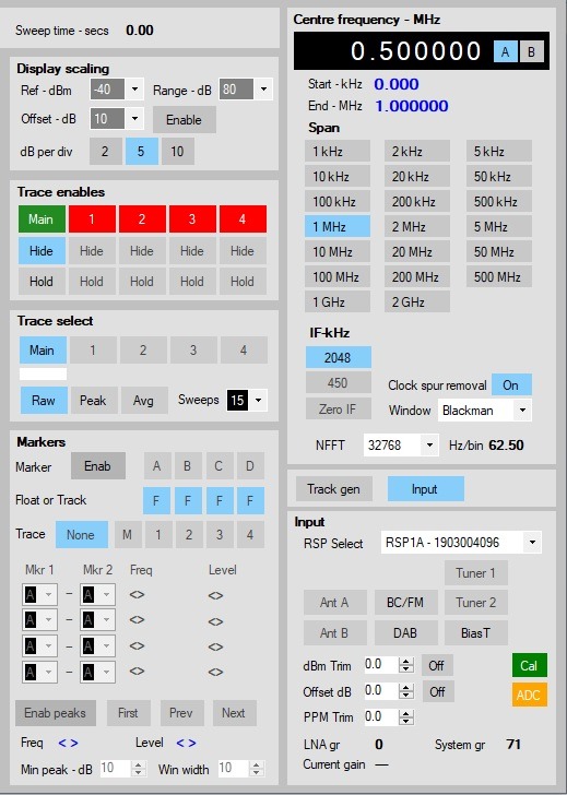

44k1 S.R._1MHz BW
Intermodulation
Intermodulation products in general show up close to the overload/1dB compression limits. However, if the strong
signal is on the roll off of the filter, they appear well before this limit.
Aliasing
Aliasing always occurs if an insufficiently band limited signal is sampled, i.e. if the signal to be sampled contains frequencies above half the sampling frequency. Thus, aliasing is an effect showing up in many SDRs, not only in these dongles. In both types of dongles there is not much space for brick wall filters.
Image Rejection
Because the E4000 is a Direct Conversion Receiver, it has an Image Rejection problem. By switching on Correct IQ in SDR# a more or less acceptable 50dBs are reached. For the same reason, a "hump" shows in the center of the spectrum display. By using a well filtered external power supply (not from the USB connector) the hump might be reduced.
https://www.rtl-sdr.com/tag/aliasing/
https://sandsoftwaresound.net/rtl-sdr-blog-v3-hf-reception/

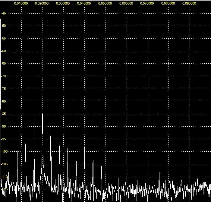

Just saying, one has to be careful with SDR devices. Need to make sure the problem is really in the DUT and not the test instrument.
True and thanks for the links.
The DUT of this thread has no active circuit past DAC IC's current output up to it's line out (where the SDR was connected to).
Therefore, when intermodulation products were seen with the one type of filter from the three available but not with another, this could only mean that the instrument acting as the load to the DAC analog output was the one producing the products of intermodulation.
That was clear from the beginning. I was only surprised and cought off guard because the DAC output signal seemed to be well below the overload limit of the SDR. But still...
The thing here is to test the filters effectiveness to reduce the out of band noise.
And it is clear that there is a lot of out of band noise.
George

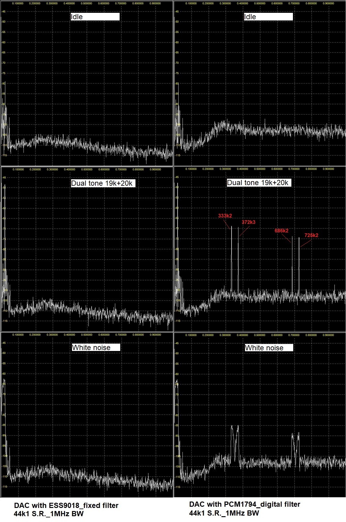

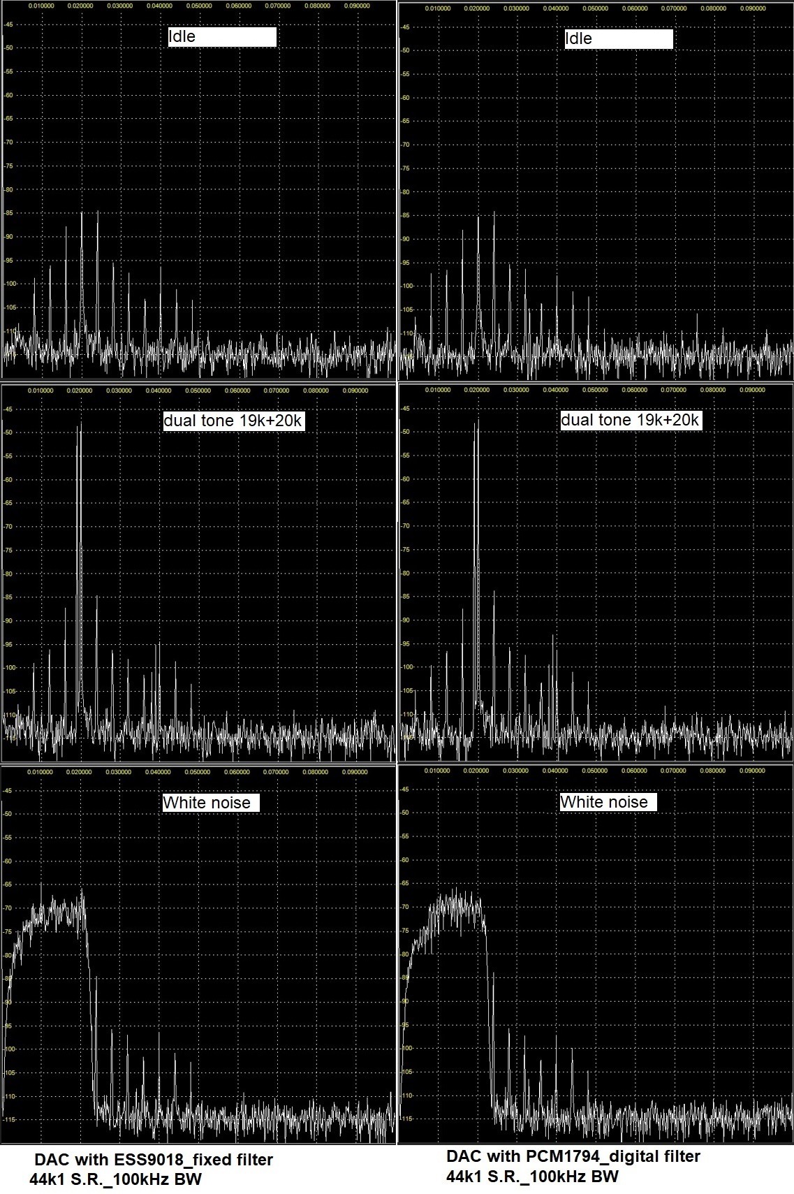

Thank you bohrok2610 for your comments.
I've tried increasing the attenuation btn the DAC out and SDR input. Also I've tried reducing the test siglal level feeding the DAC. Same picture with the digital filter.
I also did the same tests with another DAC based on ESS9018.
It seems that what you've noted are not SDR or setup issues, rather are related to the digital filter of Kosta's PCM1794.
I don't know what else can I do to look further into that. I think I' leave it here.
George

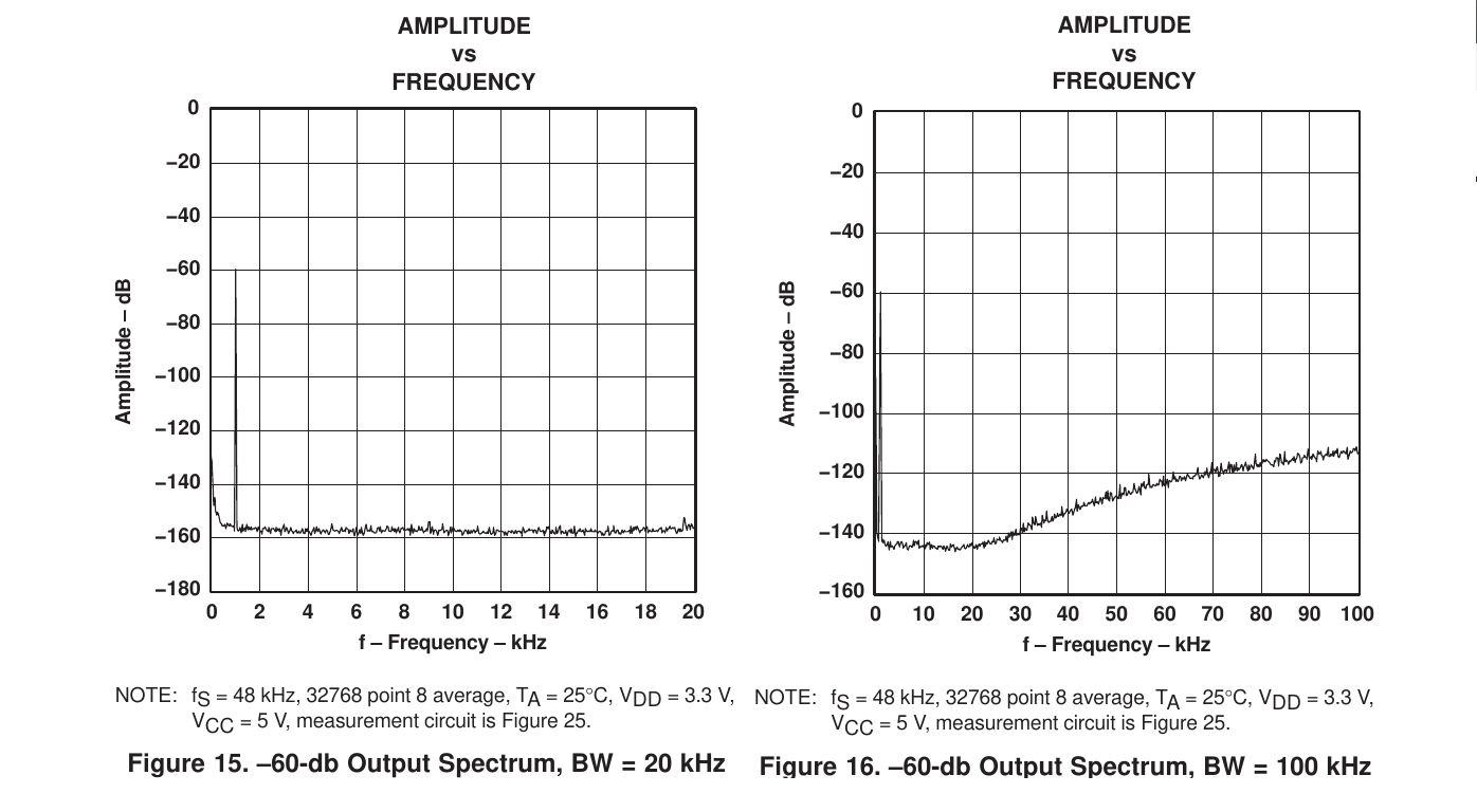

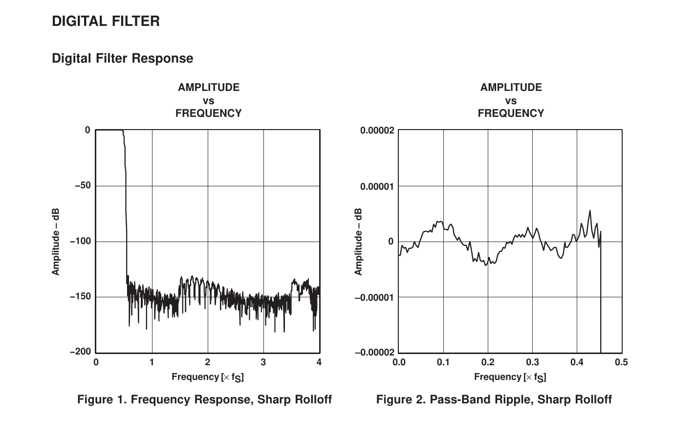

FWIW, this is all I can find on PCM1794 datasheet.
