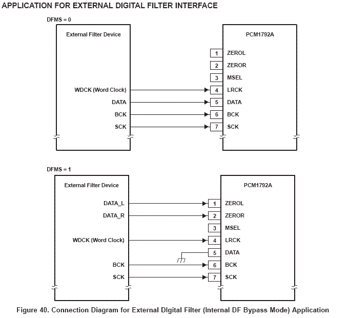

PCM1792 and PCM1796 integrates an 8x oversampling digital filter. Are you sure that you can bypass this filter and use as NOS DAC?Hyldal said:Does anybody know how to use a BB1792 or BB1796 as NOS. I would like to find a 24 bit converter that are cheaper then the BB1704.

Hi Hydal,
I ask to my question : Yes you can bypass internal digital filter.
See page 38 from PCM1792A datasheets. (see picture link)
With DFMS=1 you need shift register for bit alignment.
With DFMS=0 you don't need shift register.

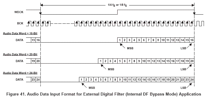

WDCK (word clock) coming from DIR = Fs (44.1KHz, 96KHz, 192 KHz). PCM1792A needs 1/4Fs or 1/8Fs.
PCM1792A accept right-justified 16bit, 20bit, 24bit audio data.
Eric
Understand that word clock (WDCK) signal must be operate at 8x or 4x the desired sampling frequency Fs.Eric Juaneda said:...PCM1792A needs 1/4Fs or 1/8Fs...
