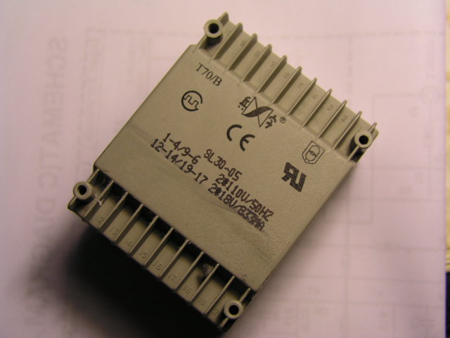

pls see the power transformer that will option for diyer.
This power transformer was a 110X2 0~16,0~16 35VA.
his is a isolate power transformers, U will see many use the sonfrontier DAC which was made by RS. Since this power trans was expensive in seperate into four chamber of the bobbin. two s pri, two is sec/
All in parallel winding to isolate to lower the noise.
weight of the power trans was approx 550g.

hi Idefixes,
at first i did not search this power transformers fatory so I prepare to call one factory OEM for me, same was isolate power transformers but it hadn't plastic mount for the power trans.
My friend told me this factory's tel no & address that this factory OEM for many overseas company & also had ISO standard. THis is the really isolate power transformers that we need.
as I said, many power transformers had seperate chamber for pri & sec winding. when they winding for power transformers, pri & sec only use one earth ( ground) to seperate the noise. But this is not the best method. If U like more, will seperaste into seversl chamber. every chamber is only
winder pri or sec. The best wa this type, so why RS is selling quite expensive.
there will two chamber in each side.
every side first chamber is pri,
sec chamber is sec.
this is parallel winding & isolate power transformers.
so parallel first chamber pri will 0~110 , 0~110=0~110.
series first chamber pri will 0~110 - 0~110=0`220V
sec winding will be same.
good for DAC, so U can see many hi-end DAC such as sonic frontiers was use this typoe power trans, less noise or said more silent.

Thomas,
The only potential problem with transformers would come if the transformer is pc mounted. In this case we would have to find an equivalent, from Hammond for example, since this company is represented all accross North America. The pin out has to be identical to fit in.
If we do not find an equivalent, it could be necessary to purchase the transformers from You.
Since we have no information on the implementation of transformers yet, we will rely on you to tell us.
Other important points to keep in mind is that, in North America, the ac voltage is 110-120 volts and frequency is 60hz. This difers from the europeen standards greatly.
It is necessary to have two windings on the primary to accomodate both the europeen and american standards. As far as frequency is concerned, if the transformer is designed for 50hz, it should work just fine here.
You probably thought of that a long time ago, but I just want to clarify and make sure we are all heading in the same dirrection.
