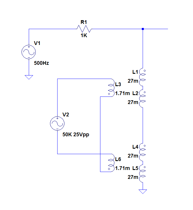

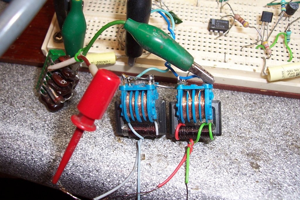

In the meantime, I have tested the effect of HF bias on the low-level linearity of ungapped inductors.
I have used CMC's, because they are pre-wound and have a solid, gapless core.
They are Siemens 2 x 27mH, and I have added 31 turns to inject the HF bias.
The 4 27mH are wired in series, resulting in ~216mH total inductance.
The 31t windings are wired in opposition, and are therefore not coupled, except parametrically, through the material properties (and also marginally through parasitic capacitances).
attachment.php
attachment.php

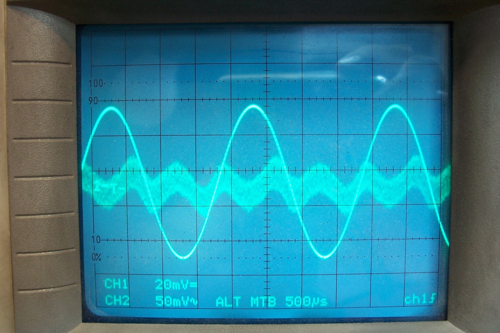

A 500Hz signal is injected, resulting in a ~0.6% THD, with no HF bias.
This pic shows the signal and the THD residual:
attachment.php

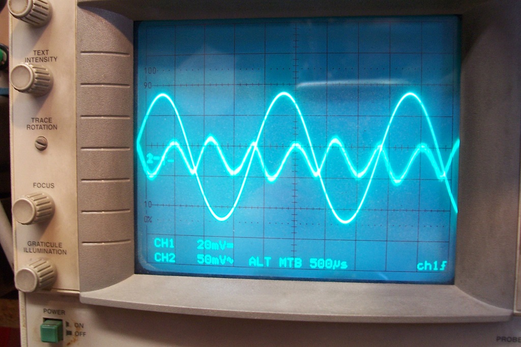

When the 50KHz is applied, the THD first decreases to ~0.4%, but then increases again on the THD-meter when the level is increased further, because the 50kHz leaks into the output (inductors are not matched or balanced), and corrupts the THD value.
However, it can be seen that the LF envelope of the HF hash has decreased to ~half of its initial value:
attachment.php
The amplitude of the 500Hz has also very slightly increased, meaning that more energy concentrates on the fundamental.
The improvement is not huge (~6dB), but it is significant, and it is just a quick and dirty test, improvised with what's available.

The HF bias is 25Vpp, against 1Vpp for the signal.
The Oscope screen shows the fundamental and the residue from the THD analyser.
The inductors are arranged in a "transducer" configuration, there is no direct coupling between them.
The THD reduction can be explained in the frequency domain by examining the multiple IM products between the bias and the signal's harmonics, and the way they cancel each other and the signal's harmonics, whilst reinforcing (very slightly) the fundamental

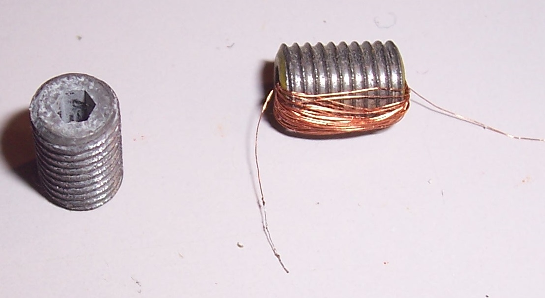

I have measured another iron/polymer core, a screw adjuster for VHF coils.
The shape lends itself to the measurements: it has an hexagonal hole for its whole length, meaning it is like an elongated toroid, without airgap.
attachment.php
I made the measurement at 10kHz, because with the 40 turns of the test winding I only managed 66.5µH.
The effective area is something like 16mm², not very accurate due to the shape of the internal hole.
With an Î of 7.45mA, the peak induction reaches 0.774mT.
Under those conditions, the distortion corrected for the winding's resistance is 0.14%, which is rather substantial considering the small excitation level.
It is possible to estimate the impact when used as intended, inside a cylindrical coil.
From the measured parameters, the relative permeability of the material, µr is ~9, which is normal for a VHF material.
When the screw is fully inserted in the coil, it ~doubles its value.
The reluctance of the circuit is thus halved, and due to the permeabilty, the core intercepts ~1/10th of the magnetomotive force.
Put together, these effects lead to distortion dilution of ~1/20, or 0.007% for the complete inductor, which is surprisingly large.
Morality: using low µ, VHF materials for AF applications is counterproductive.
At the same induction, the AF ferrite material 3H1 has 1/10th of the distortion, and the HF one, 4C4 one-fifth.
But these materials have a much higher permeability than 9, meaning they see a much smaller fraction of the total magnetomotive force, leading to a much higher dilution ratio, to the tune of several thousands.
As I have a real application in mind, I will try to find compatible adjusters made of ferrite. Even the worst possible ferrite will be much better than these iron cores
