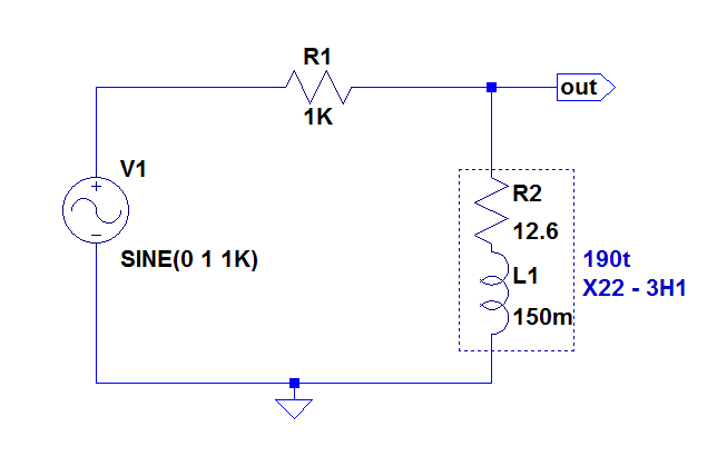

Here is the test-jig for the 3H1:
attachment.php
The 1K series resistor is calculated to be ~equal to the reactance of the inductor at the test frequency. It will be the load seen by the harmonics generated by the coil.
The test voltage was varied from 72mV to 2.2Vrms, resulting in a peak induction comprised between 1.293mT and 39.5mT.
Here are the results:
Code:
^B(mT)        k(%)
1.293         0.023
3.95          0.062
12.93         0.175
39.5          0.45
There seems to be a quasi-linear dependency of the non-linearity with the excitation level.

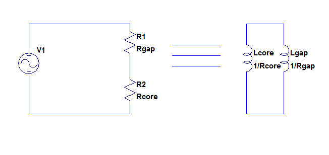

This is the equivalent circuit with an airgap: the reluctances on the left, and the electrical equivalent on the right.
attachment.php
It is obvious that by making Lgap much smaller than Lcore, the THD will be reduced in the same proportion.
Lgap can be computed : n²*µo*Ae/d (Ae= effective area, d= airgap).
The distortion will also be reduced if the excitation level is reduced.
It is counter-intuitive, but adding a gap will not directly reduce the induction: the induction formula does not include any magnetic parameter.
However if the gap is increased, the inductance will decrease and if the excitation voltage and frequency are kept identical, the current will increase, and the greater H will compensate exactly the increased reluctance.
Of course, in general the coil will be adapted to keep the same value with an increased airgap: this means increasing the number of turns by √r, and this will reduce the induction.

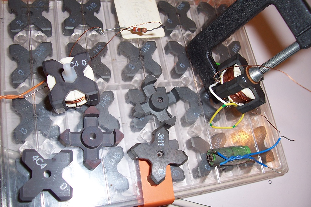

Here is a pic of the cores tested:
attachment.php
The 4C4 cores are clamped by a nylon bolt, but the 3H1's have a threaded insert and require an external clamp (or the proper mounting hardware).
The iron-powder core is an horrible kludge, more on that later

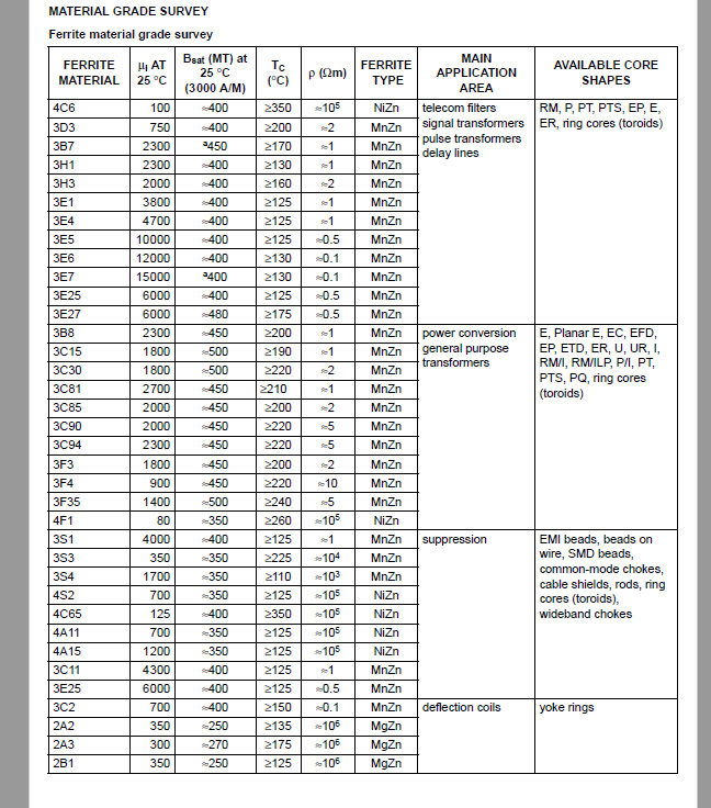

The 3H1 is a completely ordinary material, which is why I used it for the tests.
It has a µr of 2300, which is quite moderate compared to other grades: the 3E7 has 15000, and it is not the highest.
attachment.php
In my test, the maximum peak induction reaches 39.5mT, less than 1/10th of the saturation value

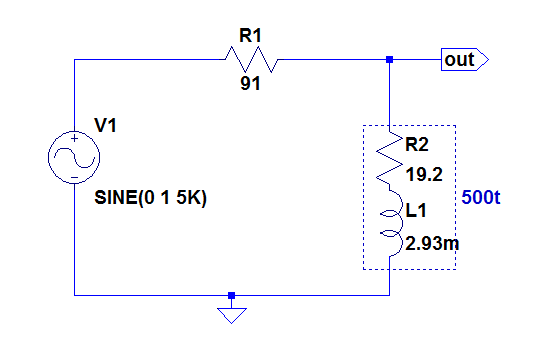

This is the test jig for the iron powder/polymer composite:
attachment.php
As I warned in the first post, this one is a messy kludge: I know I have potcore sets made of FePC somewhere, but I haven't seen them in 20 years, and I don't want to waste a day or two scouring my attic.
As a result, I had to use something vaguely resembling a closed magnetic assembly: I used an adjustment screw as a core, and I wound 500t of enamelled wire.
I then inserted the wound screw into a coil cover (~bell shaped). As this left one side open, I inserted another bell to close the magnetic circuit.
The result in not tidy: the core area is not homogeneous, and there are three parasitic airgaps.
In addition, I had to make the measurement at 5kHz, because of the low inductance value.
This means that contrary to the two previous ones, this set of measurements is purely indicative.
Code:
^B(mT)        k(%)
0.608         0.0037
1.92          0.0058
6.08          0.016
19.2          0.38
Up to 6mT, the THD remains quite low, but it increases very quickly afterwards.
Because of the parasitic gaps, the values are optimistic and should be corrected.
If the gaps are 0.3mm each, the total is 0.9mm. With an estimated core area of 14mm², the gap inductance is 5.58mH. This means that the core's inductance without gaps should be 6.19mH.
To take into account the dilution factor, the THD figures should be increased by 6.19/2.93=2.11.
These are very crude estimations, of course.
Even after correction, the figures still look attractive, but of course the relative permeability of these cores is very low, and they require a lot of turns to achieve a given inductance.

Correction: re-reading the results, I found the last line suspicious: the huge jump in THD for just a 10dB increase can only happen at some boundary, like saturation or coercivity, unlikely here which is why I did the measurement again and in fact the actual value is 10 times lower.
Maybe I missed a decimal place or the setup had a bad contact, I don't know, but here is the corrected table:
Code:
^B(mT)        k(%)
0.608         0.0037
1.92          0.0058
6.08          0.016
19.2          0.038
These results should also be corrected by the ~2 (?) factor, and taken with some caution and a pinch of salt.
However, they indicate that iron dust is no miracle material...

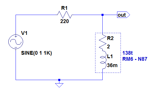

I have tested two other materials, from Siemens/Epcos this time.
A RM6 core, N87 material. Test jig:
attachment.php
Code:
^B(mT)      k(%)
3.8         0.26
12.1        0.54
38          1.4
121         2.8

I also made another test, to evaluate the internal impedance of the non-linearity source in the inductor: I replaced the 220 ohm series with a 470 ohm one (and I readjusted the injection level to arrive at the same induction).
The results are interesting, and confirmed my initial guess:
Code:
^B(mT)     k(%)
6         0.29
19        0.69
60        1.8
190       8.5
The increase with the load impedance means that the equivalent generator impedance is the inductance.
This probably doesn't hold at very high levels, but for low-dist applications, that's all you need to know

By contrast, the dilution effect of the gap is linear, and is not practically limited: with the induction, once you have reached the acceptable copper loss limit, that's it: you hit a wall.
The dilution effect is limited only by the µr of the material, and you will not need to adjust the gap to take the µr into account, because for ferrites, µr is so much larger than 1, having a µr of 2300 as for the 3H1 example, or 23000 for a hypothetical material, that only the gap will determine the µapparent, thus the inductance. This means that you can change the core material completely, as long as you keep the same shape, gapped in the same way.
The apparent permeability change will be negligible, but the linearity will be greatly impacted.

The T38 I tested is a possibility, but the 3E9 from Philips/ferroxcube looks even more promising, with a µr of 20000.
https://ferroxcube.home.pl/prod/assets/sfmatgra_frnt.pdf
If you reduce the µapparent of such an ungapped core from 20000 to 200 (which is still substantial), you will reduce the intrinsic THD by a factor 100.
There are variations among materials, and the ferroxcubes seems to be more linear than the Epcos varieties (which doesn't mean that they are worse: low-level linearity is specified nowhere, and the difference probably results from different optimization tradeoffs).
Modern ferrites are used almost exclusively for power and pulse applications, and the low-level characteristics have to be measured by the user.
Materials specifically designed for power (high Bsat) look significantly worse though.
There are many other manufacturers of ferrites, and some may be marginally better than others, but basically, all MnZN materials have the same overall behavior.
NiZn materials (high-frequency) are somewhat worse, and have a much lower µr, so they are not recommended.

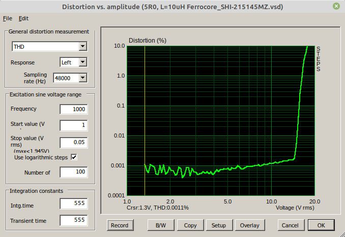

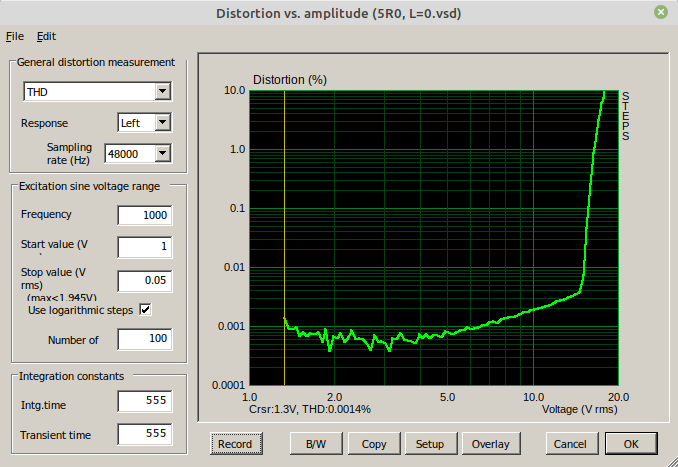

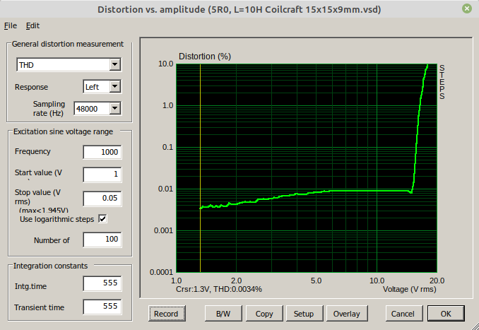

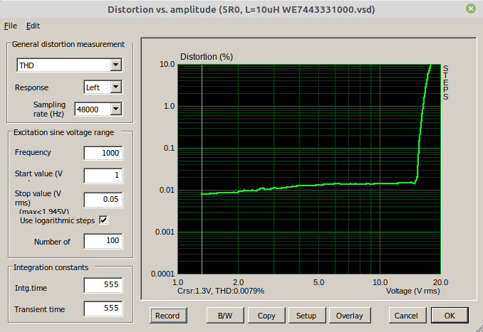

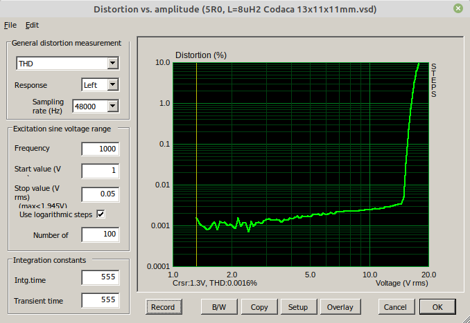

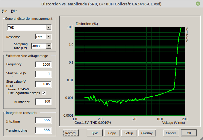

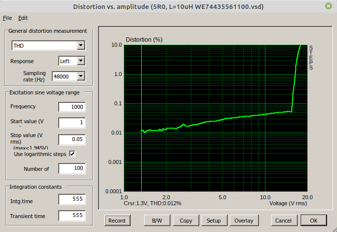

Exploring core distortion I measured THD along 5R0 dummy with various inductors connected in series. In my stash are several standard inductors and some special class -d-inductors. Inductance was 10uH or similar, current amplitude at clipping about 4 amps.It can be seen that specific class-d inductors generate about one order of magnitude less distortion than the standard coils. This is not a matter of the brand, my samples from Coilcraft, Ferrocore and Codaca showed similar results. Obviously there exists some extra linear ferrite composition. Worst linearity was observed with carbonyl (iron powder) inductors.
I append some plots
The reactance of a 10µH @1kHz is a minuscule 62 milliohm, about 1/100th of the load impedance.
This means that the actual inductor's distortion is 100x larger than what you measure.
The coil construction probably matters more than the material in itself: the worst WE one is shielded, meaning a closed (and gapped) magnetic circuit.
I expect more open designs to perform better, but other factors play a role
The reactance of a 10µH @1kHz is a minuscule 62 milliohm, about 1/100th of the load impedance.play a role
Yes, I am aware of that. But the minuscule non-linear reactance contribution can be measured in my setup as well. And the question was difference in linearity, i.e. a relative comparision of cores, not absolute values. Just showing big variations of core linearity.
As a side effect I discovered remanence effects while sweeping up the level with steps. Better reproduction was observed with starting at max level sweeping down - similar to de-gaussing the CRT
Yes, magnetic materials are curious beasts. In addition, in a class D amplifier, the high level of HF superimposed on the signal probably contributes heavily to the reduction of hysteresis distortion in the material, just like for magnetic recording.
If you want to measure more accurately and more easily the THD of the coil alone, adopt my test configuration: L and R swapped.
This will give you a much finer resolution.
