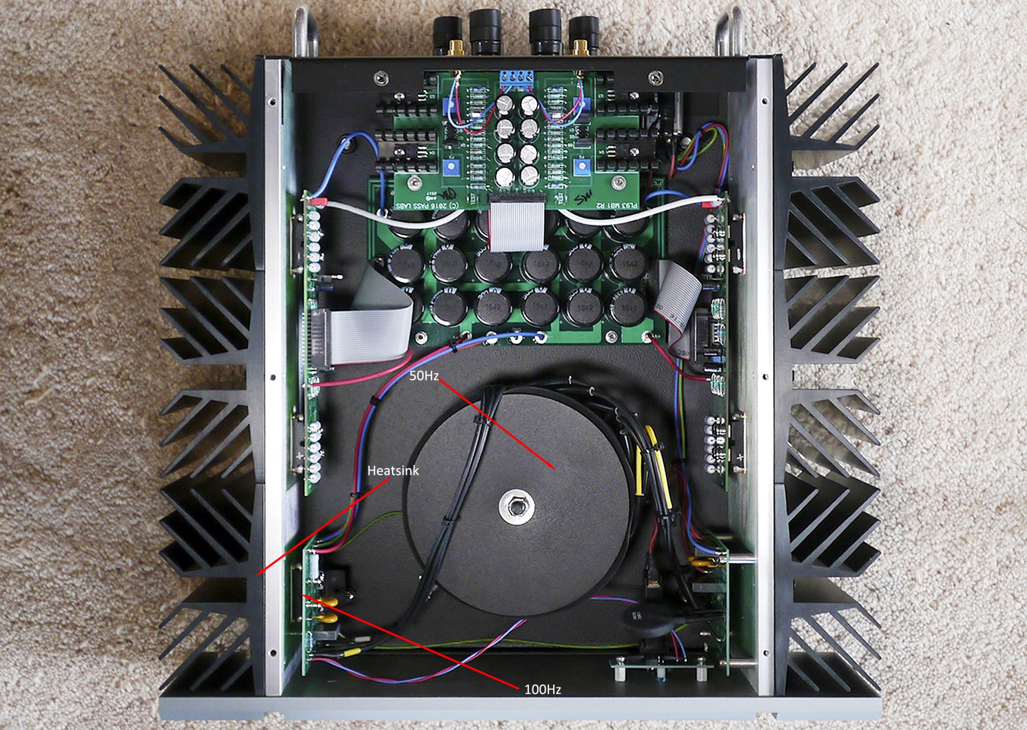

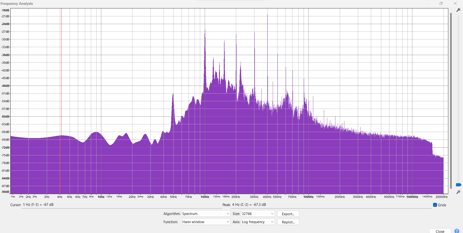

The recording sounds like a predominant 100Hz buzz to me (see photo), with additional extra (quieter) harmonics that I can not figure out... it does not sound like the 50Hz buzz I would expect to hear from the toroidal transformer (see photo).
When I did a bit of research around what that INT-25 is, and its innards, I saw a few posts where people complained about cooking bridge rectifier heatsink (the colour of the heatsink in question changed.... due to excessive heat...). The (section of the) heatsink in question is shown with the red arrow (see photo).
So, if you touch that section of the heatsink and it seems much hotter than the rest of the heatsink area (on the right-hand side)... you know that there might be something wrong with... maybe quiescent current... the toroidal transformer might be okay (I think it is).
The above is just FYI... and I do believe that you should send the amplifier back to your dealer... they'll handle it.

@Extreme_Boky: your picture shows the power amp, not the Int25. The Int25 does not have the rectifier at the spot you indicated.
