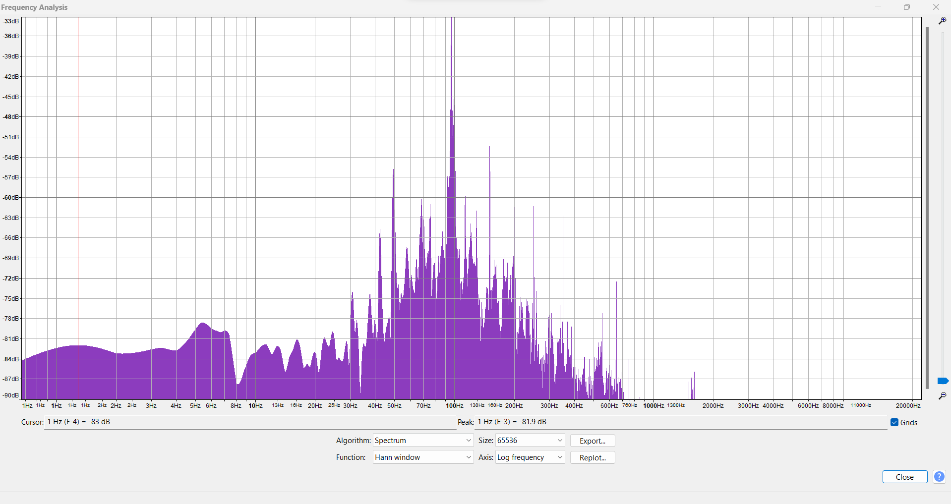

It is a matter of 50 Hz buzz or 400 Hz buzz demonstrated in the video from Andy Cine. I cannot imagine why an amp should produce 400 Hz buzz.

The 400Hz is a mystery but the other side of the coin is that the buzzing could be because of that component.
400Hz is an exact multiple of 50Hz. Had the frequency been some non related figure... but its not.
The bottom line is we just don't know what is happening here.
For comparison this is your clip swiped into Audacity.
