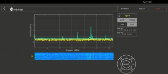

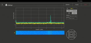

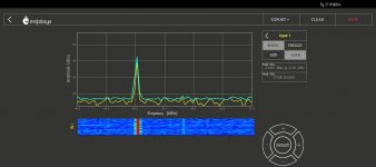

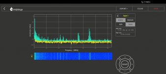

I also turned on the second, fixed, oscillator in that QRP labs VFO to evaluate it for a conversion oscillator. It's better than that other Si5351 based device, but that's not really saying much. The good news is that, unlike the other device, on this device when the fixed oscillator is turned off, it is actually off. The fixed output on mine is about -6 dBm and pretty nasty looking. Like the other, the crosstalk between fixed and tunable output is substantial.
Pic 1 is the baseline, RX strip the same as last seen. The IF is showing a BCB station on 790 KHz, 5 KW input, single antenna, about 12 km from my house up at the lake. I'm down in the hills, but it still has a pretty good signal. The LO is high side at 45.790 MHz, receiving antenna is about 4 meters of wire tossed across the floor and clipped to the low pass input.
Second pic is the fixed oscillator turned on, and set to 34.3 MHz for down conversion to 10.7 MHz, but is not connected to anything. The bleed through to the main channel is substantial, and looks like it is degrading the reception, as the image of the BCB station is showing up at a low level.

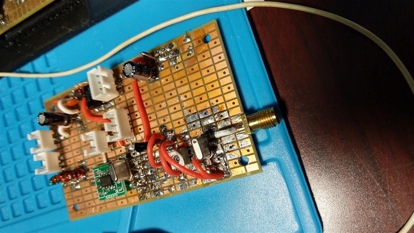

So I fired up the 30 year old board and found it dead, no surprise there it's been living in the "dead circuits" box where I shop for unusual parts from my past.
A little poking around with a spectrum analyzer revealed no local oscillator. A little comparing the old board to the new schematic revealed a dead short across a capacitor in the tank circuit, not a shorted cap, but a well placed blob of solder. Who knows what I was doing with this board 30 years ago, but I probably wanted to inject an LO from a sig gen. I removed the blob, and the board is live.

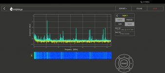

AM detection via the RSSI pin does work. It works best in the -50 to -60 dbm input at 45 MHz range but the output amplitude and distortion remains usable from -30 to -100 dbm. The signal becomes clipped (expected) with input stronger than -30 dbm. A weird random distortion occurs at weak signal.
The first picture shows the output, about 750 mV P-P at -55 dbm and 80% AM. The THD increases a bit at 90% AM and the signal gets rather pointy on the bottom at 100% AM, second picture.

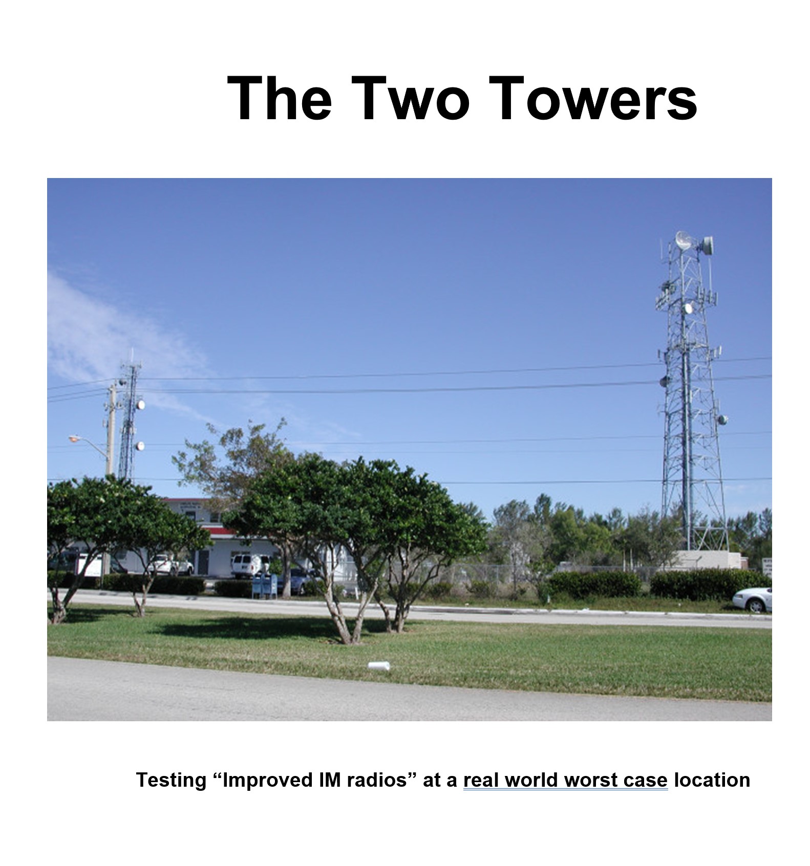

I spent countless hours driving around south Florida finding real world worse case test scenarios for two way radios. Around 199 to 2004 this was a "worse case" location for 800 MHz two way radios. This site was on the western edge of Broward county facing the Everglades swamp. There were 5 different sets of cell sites at this location all cranked up to (or above) the maximum ERP limit for cell site in order to offer some coverage in the swamp. This photo is the cover of a 40 page document outlining the issues and possible solutions to the fact that cops couldn't hear the dispatcher when they drove down this road.
The front of my white Mustang can be seen in right side of the picture. At first the cops thought I was up to no good, especially when I had a case full of radios set up on their frequencies (RX only). After a while they grew used to the Dumm Blonde dragging a spectrum analyzer, a car battery and an inverter around in a cow field.
This pales to the situation for UHF radios on the upper deck of the Miami Dolphins Football stadium. Here you are about a mile away from the Miami TV antenna farm where 14 stations operate 1 MEGAWATT transmitters in the UHF band. Fortunately most of the public safety in the area is at 700 or 800 MHz.

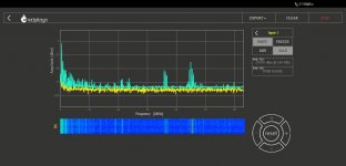

The second mixer is not being overloaded at the IF input. I reduced the 2nd LO drive some, and this made some marginal improvement at the 2nd IF output at the expense of some conversion gain. Since this isn't really a project, instead of making attenuators, I'm varying the drive the lazy way by adjusting the value of the LO coupling cap.
The first two pictures are with a 44.545 MHz 2nd LO. You can see the 2nd LO, the first IF, the LO, and I think the LO plus the 455 KHz 2nd IF all clustered around 45 MHz. I don't know what that stuff around 37 MHz is - some combinaton of Si5351 spurs and cross talk between the Si5351 outputs, I guess.
The third pic is with a 34.3 MHz 2nd LO for 10.7 MHz second IF. I haven't looked at 9 Mhz yet. Recall that the 36 MHz crystals I have oscillate at their marked frequency without any need for a tuned circuit, so 9 MHz may be the best chance I have to avoid using the second output of the Si5351, given the limited space remaining on the board. I have some 34.3 Mhz crystals and 44.545 MHz crystals, but I haven't tested them yet.
