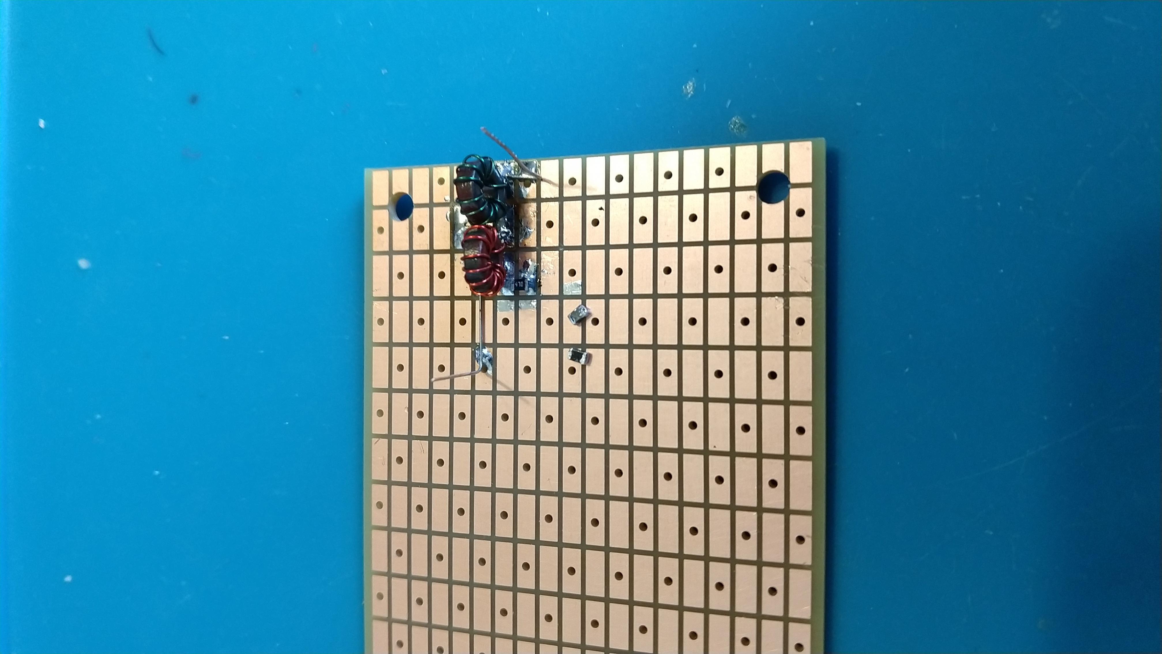

... The tiny Inductors are Murata LQW18A series High Q 0603. (those that look blue-ish.) The shortwave inductors are 1210 or 18?? from Coilcraft or EPCOS/TDK. They are not yet on the board.
I am not geting satisfactory results using SMD inductors in HF filters as constructed on these SMD prototype boards. I'm guessing that at some frequency the pads are going to have undesirable stray capacitance to ground, but it dosn't seem to be an issue at HF ( so far ). I'm doing something wrong, but I don't know what it is.
I built a chebyshev 3 pole low pass filter, - 3 dB cutoff predicted to be 30 MHz. In fact, the same low pass filter built point to point on the perforated board in the early up conversion experiments, so a known to work filter. I built it with 0805 ceramic caps, and the generic 0805 cheap china inductors that can be seen in the picture. I terminated each end with a 47 ohm 0805 resistor to force an impedance match. The calculator is at wa4dsy.net
As measured with the RP, the result was dismal. It had a low pass characteristic, but nowhere near what the filter program predicted, the roll off began about 10 MHz early and was very weak, even by three pole standards, really just a gentle slope. To eliminate the crap cheap china generic inductors as the problem, I built another with good quality EPCOS/TDK inductors ( surplus, but from a reputable vendor - I'm sure they are genuine parts ) but the results were still terrible. Better, but still terrible.
I removed the Epcos inductors, and subtituted inductors I wound on T-25 (red) cores, and remeasured. The 30 MHz predicted -3dB cutoff measured at 28.75 MHz. The program predicted -10 dB at 40 MHz, and I measured -15 dB. 50 MHz was predicted as -15 dB and I measured - 20 dB. I could probably tweak the toroids to get -3 dB at the predicted 30 MHz, but the point is that the toroids work, the SMD parts don't, and I don't understand why or what I am doing wrong.
So far I've fooled around with molded conformal inductors, SMD parts, and toroids, and the only thing that works as predicted in a filter circuit are toroid cores. As I've stated before, I'm aware of Q, but am not going to pretend I understand it. I would have expected the Epcos parts to be sufficiently high Q, maybe not like a toroid, but good enough to behave in circuit somewhat like predicted.

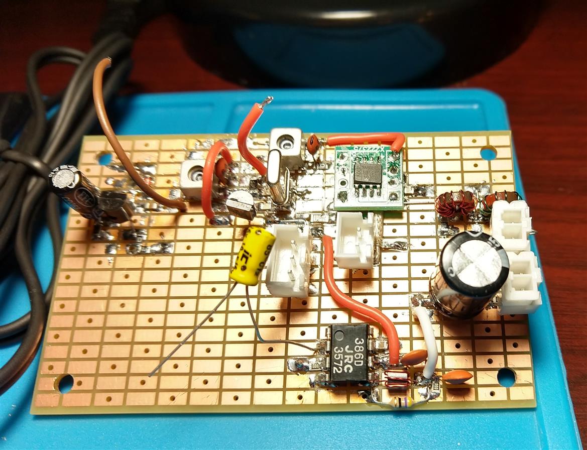

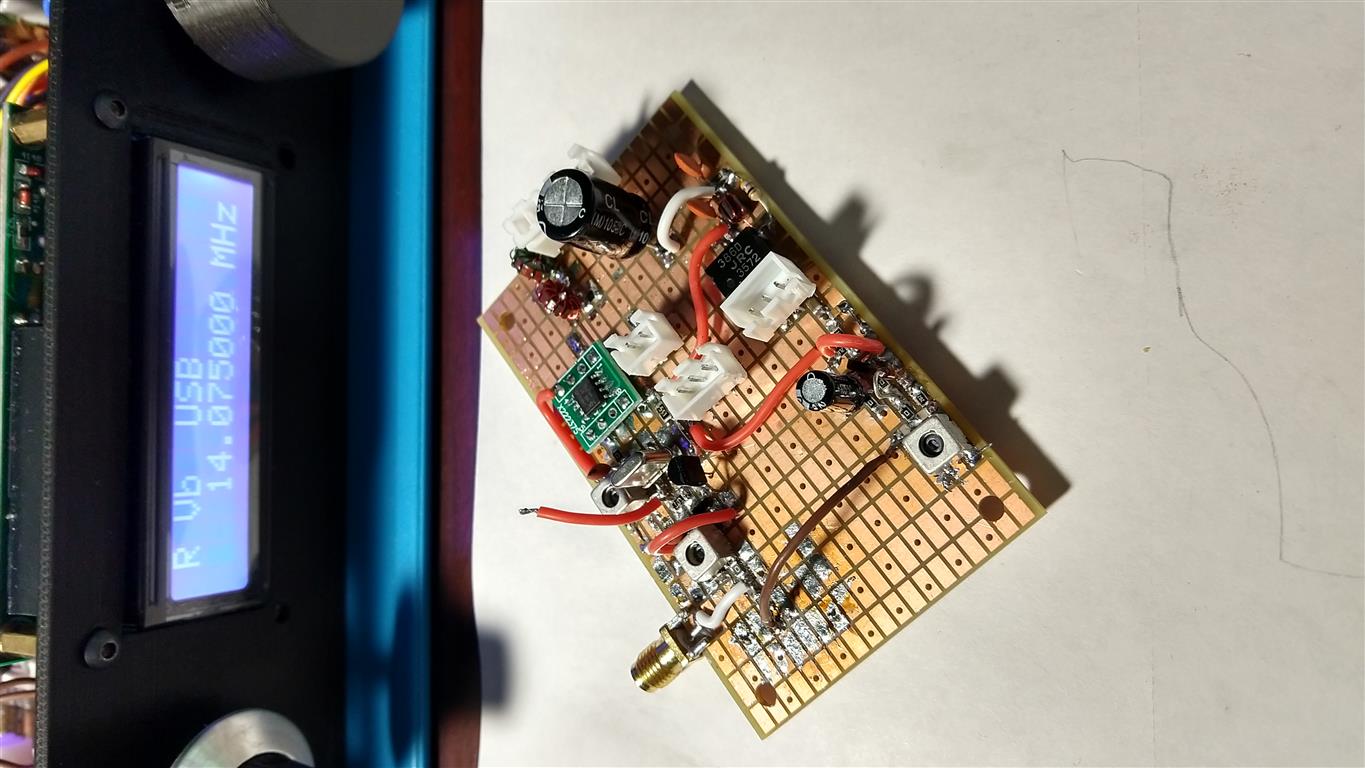

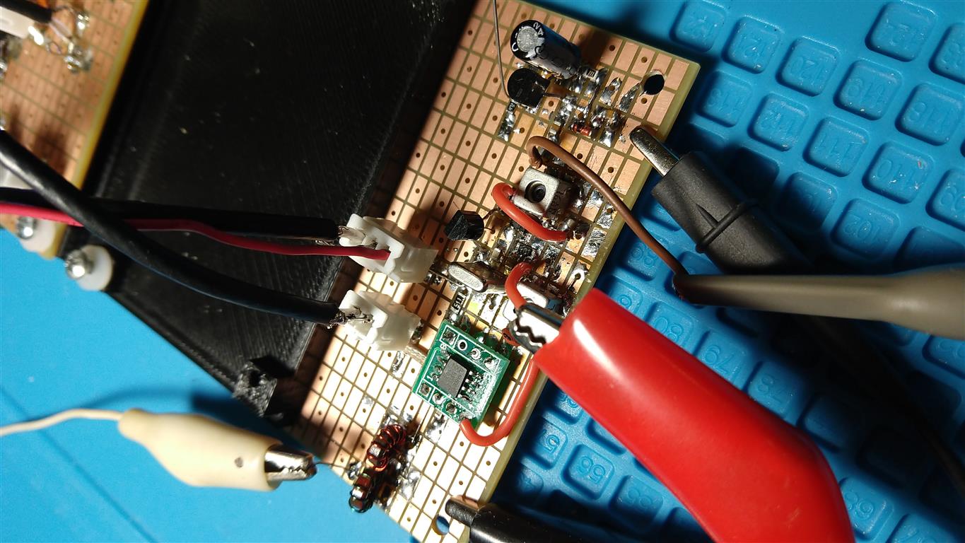

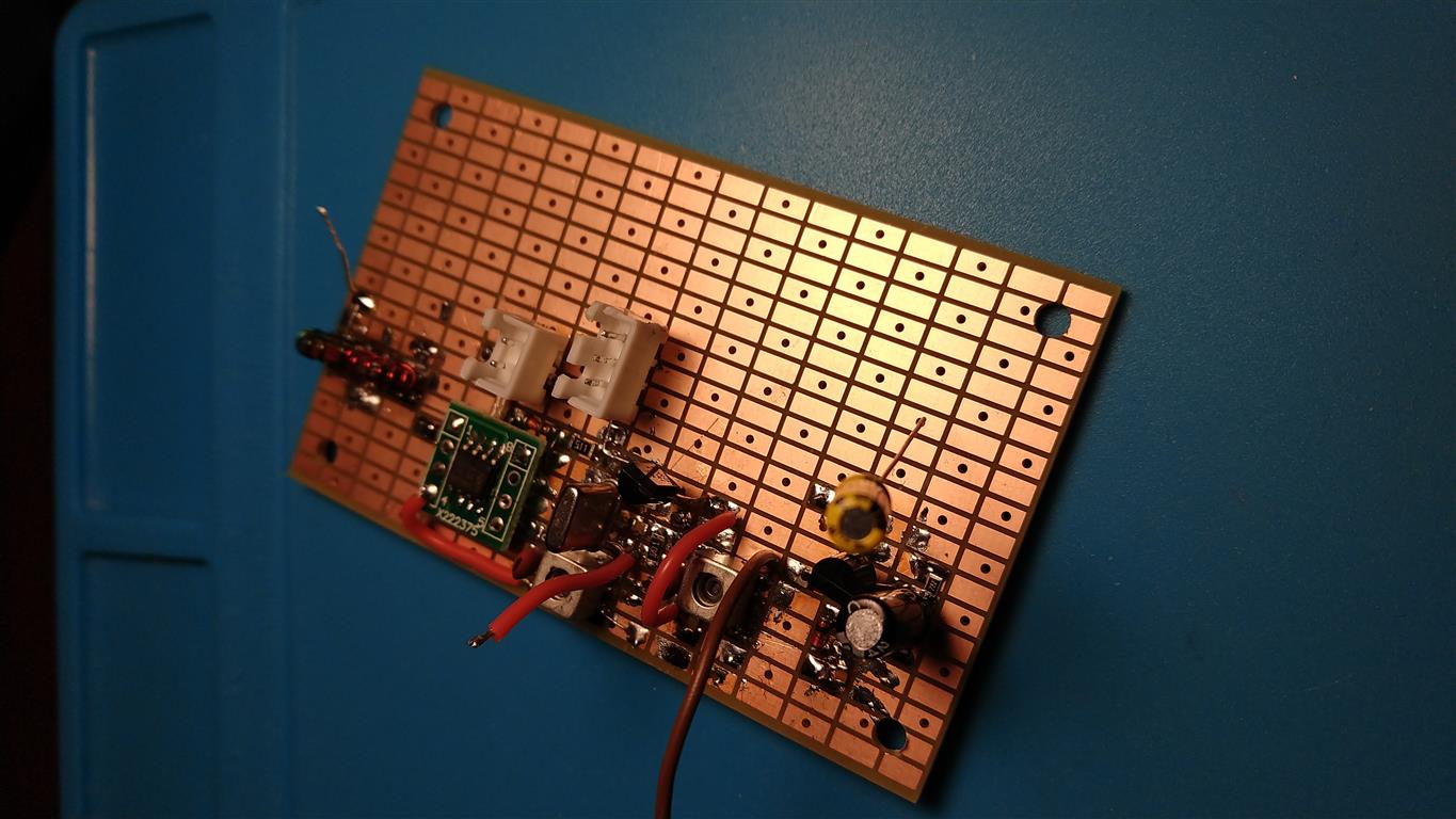

While I figure out the CW keying thing, I decided to build a fast and simple medium wave broadcast band receiver. Since the transmitter test jig has a very wide range, if mediocre, oscillator and power supplies available, it made sense to use it as the base.
This receiver strip is a rebuild of the early up conversion experiments, without all of the drama, from the beginning of this project.
The front end is a simple three low pass filter good to about 28 MHz. The mixer is an SA602, the input is single ended, the output is sort of balanced through a tuned circuit. The mixer noise is probably the upper frequency limit of the strip. The transformers are those nominal 0.2 microhenry transformers we discussed back whenever. The xtal filter is one of the 7.5 Khz two pole ECS monolithic devices. The first picture is the mixer output tuned to a local broadcast station with about twenty feet of wire for the antenna. About the only thing the RP can see at the IF is the modulation peaks. The LO bleed through predominates. Recall the LO is coming into the board at - 2dBm to simulate the xvtr board output for building TX strips.
The IF is an NXP BF1105R dual gate MOSFET. This is an unusual device in that it is an enhancement mode device, and has all of the biasing components on the chip. It is very easy to use, so far I have only smoked one of them. It is a low voltage device, with a max Vds of 7 volts. They're serious about this spec ... . As of a few days ago, Mouser was still selling them.
The red wire coming in separate from the test jig is from an adjustable power supply so I can see the gain response to get the AGC right. It looks like 2.7 volts on gate 2 is about max gain, and gain decreases as gate 2 voltage decreases. I can't tell how much gain the IF has. Before the BF1105, all the RP could see were the modulation peaks; after the BF1105 the station carrier is sitting at a solid -65 dBm. I am using 5 volts on the drain. The extra tuned circuit has eliminated the LO bleedthrough. Pictures 2 and 3 are the wide and narrow view of the IF output, respectively.
I will hang an SMA connector off the IF to use with the RP for newbie SDR.
The transformers are tunable, but I don't have and can't find a diddle stick to fit the slugs. They could be tuned to resonance with a trimmer cap, and I have suitable SMD trimmers, but I measured one of them as they come out of the strip, and picked a capacitor to resonate at 45 MHz. I used the Si5351 and the peak hold feature on the RP to sweep the IF from 44 to 46 MHz and I got it almost dead on resonant at 45 MHz. It looks like the usable low frequency response of the rcvr will be in the range of 150 Khz. I believe these transformers are ham diy usable for both 6 and 2 meter tuned circuits.
The stuff at the end of the board is a try at a transistor infinite impedance detector. It may or may not work. It didn't work when hooked to the mixer output, but that may have been because there just wasn't enough RF there to demodulate.
If it works with the IF output as is, I may leave it alone, add an AGC amp and an LM386 and call it done. Or I might add another IF stage, and / or a down conversion. There is as lot of room left on the board.

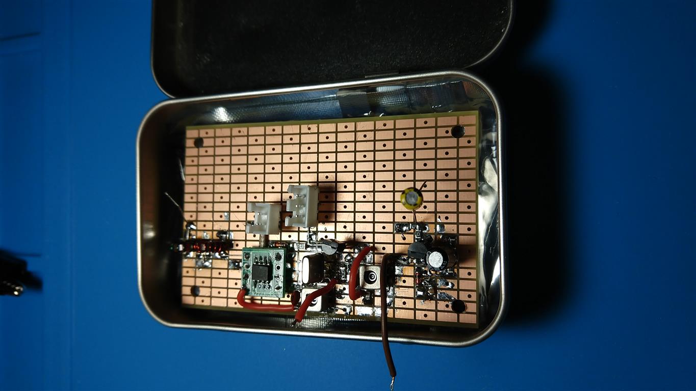

A lot of folks seem to package simple stuff in altoid cases. I find them very useful for safe storage and transport of these 50 x 80mm breadboards when they are not in use.

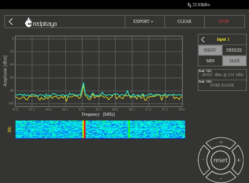

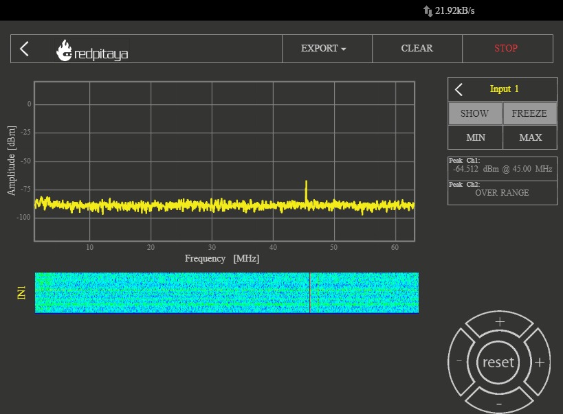

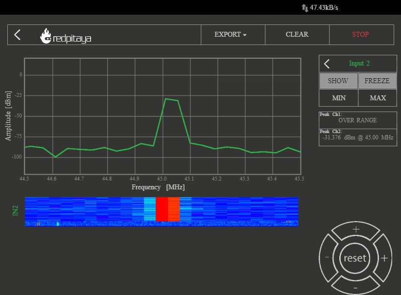

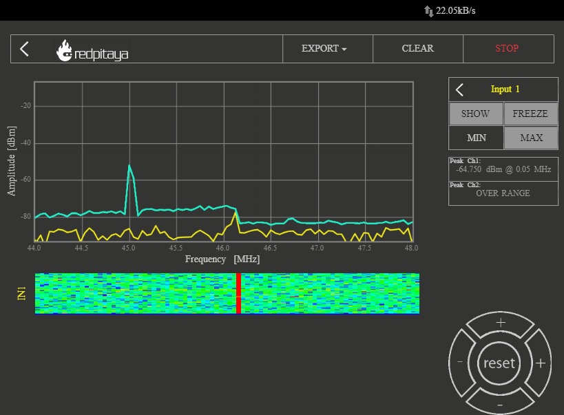

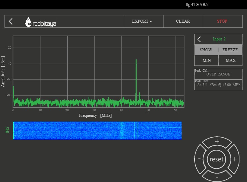

My IF is offset slightly high of 45 MHz. I found a small jewelers screwdriver that looked like it might be able to tweak the slugs in the transformers ( I know, I know, nobody needs to say anything ). Faced with the prospect of dialing in the coils with trial and error capacitor tweaking in a real crowded space, or the screwdriver, I VERY CAREFULLY used the tiny screwdriver and peaked the coils at 45 MHz. You can tell when the cores are moving because they make this agonizing creaking sound as they move. Mercifully, they didn't have to move much. If I had the stones to tune back and forth a bit ( I don't ) I might be able to get a bit better, but I didn't press my luck for fear of snapping a core.
I brought the signal strength up quite a bit, but it is still offset high of 45 MHz. I don't know what is up with this. ( edit: could the xtal filter be off frequency ? )
I removed the detector circuit, so I can relocate it to a better place on the board, freeing up space for a down conversion if I decide to do that. I put an SMA connector on the IF output to directly feed the RP. The pics are direct input to the RP. There is still a bit of LO bleed through. These SA602 are some eBay china chips, so I may replace it with a known genuine SA602 to see if that makes any difference.
Pics 1 and 2 are pre peak of the coils, pics 3 and 4 are post peak. I inadvertently used a different scale for the post peak pics, but if you look at them, you can see a significant ( 6 dB ) increase in the IF signal.

I moved the detector next to the audio amp where it belongs, and have successfully received medium wave stations, but the performance is unsatisfactory.
First, everything is offset downward 10 KHz. The RF transformers are for sure peaked at 45 MHz, the LO is on frequency ( measured with two different instruments ) , so I can't see a reason for this offset other than the xtal filter being not quite right. Suggestions welcome.
The detector works, but the output is really weak. I may have made a bad transistor choice ( PN2907 edit: mmbt2907 ) since I considered this an audio circuit, rather than a low VHF RF circuit. And / or it may be ( probably is ) still insufficient overall RF gain. I figure I have about 50 dB net RF gain, at most, between the low pass filter and detector. The transformer is hung off the end to make it easier to change IF frequencies if I decide to do that.
I'm not sure if I want to add the additional RF gain at 45 MHz, or some other frequency. I have crystals to down convert to 10.7 MHz, 9 MHz, or 455 KHz, so all of the common low frequency IF's are available. I don't know that it makes any difference to the Red Pitaya in terms of what IF frequency it uses.
So, anyway, works but needs more work. I'll load up the travel kit with some parts relevant to this project, but this is really low priority - still need to resolve the CW situation to finish the other thing. I need to build a microphone or an adapter for an existing one, and it could be on low power SSB today.
