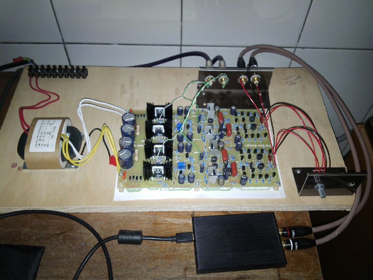

Hi all
I like to share my initial impression after a short, around 1hour, listening session on my desktop setup.
Detail is the same as or a bit less than dcb1, it has more weight specially on the bass, but dcb1 has wider soundstage (if im not mistakenly use this term). And I believe this would change in a better way if I give it more listening time and put it in my main system.
My desktop setup is: deadbeef, odac, gainwire2, F5 clone, dali lektor2.
I should mention as usual this impression is limited to my setup, room and my hearing for sure.
I hope this might help for one whos deciding to build this great preamp.

If you can dearly compare it with the dcb1, it surely must be something special... and it has gain.... can barely wait to build it myself 🙂

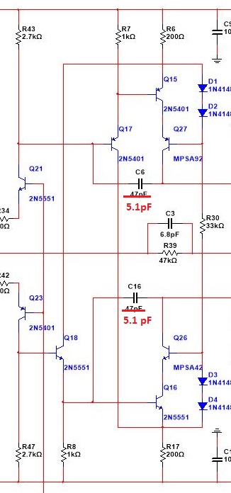

Well, must be a combination of THD (no additional harmonics), intermodulation distortion (not always as low as THD, requires special attention), phase shift (light and as constant within the bandwidth as possible) and slew rate (following fast rises/falls as precise as possible).
By the way, noticed an interesting effect in my CFA - never saw anything like this before. Square wave handling depends on input (and thereby output) amplitude. At small amplitudes it a little bit undershoots, then shape becomes perfectly square and at the higher amplitudes it a little bit overshoots.
Compensation
Got it!
The reason of the above effect was too "aggressive" lead compensation in VAS (transimpedance part of the system - C6, C16). 47 pF would be good for VFA design, but in my case 5.1 pF is more than enough for maintaining stability and totally removing overshoot on square wave an any level.
