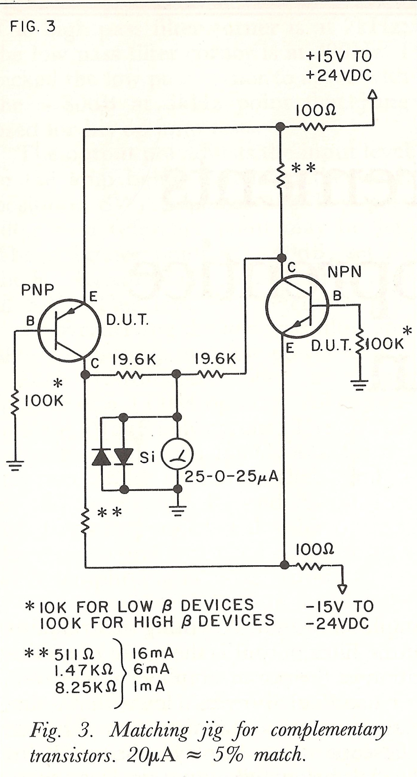

What is your setup to get Vbe of BC550C and BC560C?
You can use this test setup (Richard showed it in CFA thread).
Damir
ps. with BC550C/BC560C from the same batch all transistors were inside the 5%
