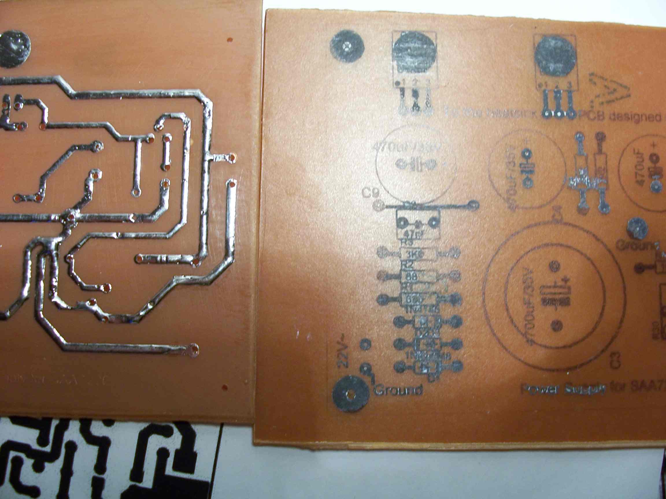

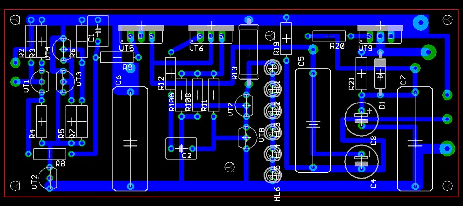

Hello Miklos,
Very nice board.
Im interested how your board looks from the side of components, what technique do u use to sign the placements of parts?
Best regards
Goran
Hi Goran,
The half finished stereo board component side is visible in post #72.
I'm using the Eagle PCB program to make the board and assign designation numbers to the components. If that what you meant with your question.
Miklos
Hi Goran,
Miklos
I know my question was not so clear. Im using Eagle also, but i was asking about that side of the board which is without coper. On the picture of your board -post #72, there is no signed placement for the components from the upper side of the PCB.
On the right side of the picture from my previous post i tried to implement the same aproach as for bottom side (coper side) to sign the placements for the components, but im not satisfied with the result as you can see. Maybe you know some other aproach (in the home conditions) for better signing for the component placements on the upper side of PCB.
Regards
Goran
Regards
Goran
I see your point now. Sorry I can't help in that, I mill my boards and never tried the placement schema printed on them. I believe you can arrange anything in the "Layers". Maybe manipulate the colors?

Layers are not the problem, its about how to print it well to the top of the board, but I wont violate this thread with my PCB problems anymore.

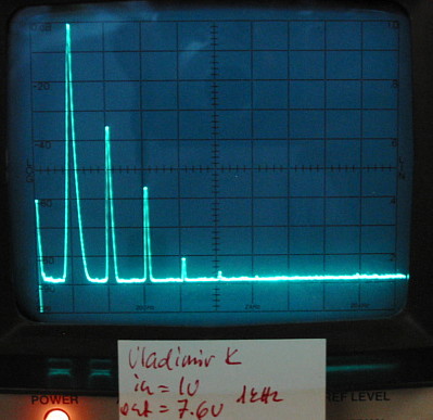

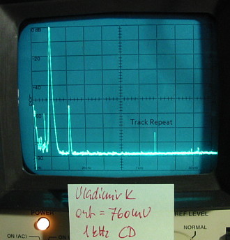

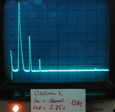

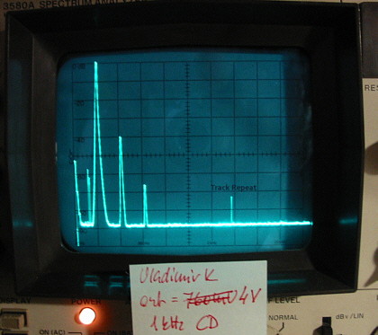

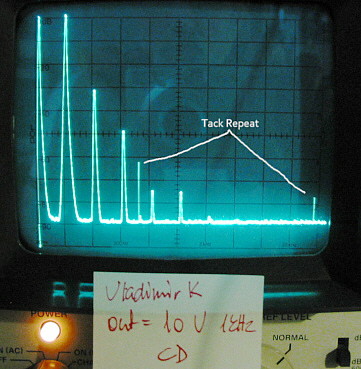

Finally I finished one channel of the amp and could measure it.
Here are the spectrums ,in the following order.
Output voltage: 760mV, 2.75V, 4V, 7.6V and 10V (clipping at 13V).
The source signal is a 1kHz Cd track, or a Sound Technology ST1500A (distortion test mode) oscillator, both clean to -90dB.
Hello, Miklos
I am glad to hear that you have advanced in this project. The results of measurements are quite expectable, they provide some ground for good sound, but do not insure it.
Pay attention to output caps quality and power supply filtering, and I could predict that almost no industrial head phone amp could beat this device in listening comparison, at any price tag.

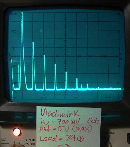

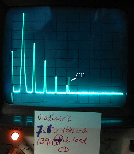

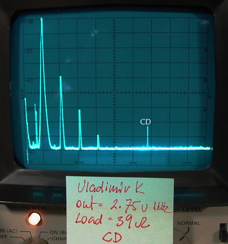

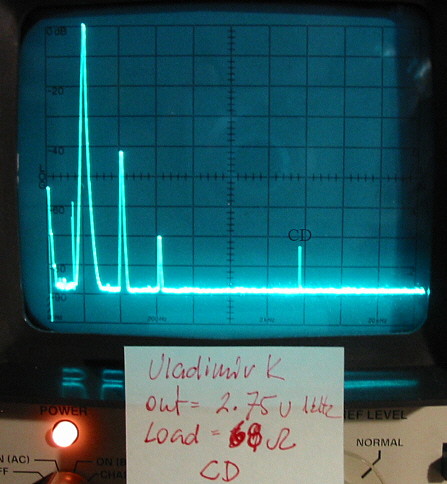

The above spectrum's are made without load.
The following ones are made with 39 and 68 Ohm's load.
The max output with 39 Ohm's load is 5V, it is better with 68 Ohm's.
I would like to note here, that the spectra measurements say only very small part of the story. They say about possible effect on the major components of the signal, that is about very small change of available at the output information. But they say nothing about complete losses of tiny components of input information, present at the input, but almost absent with bad amps at the output (in spite that bad amps can perfectly pass the major components). The reason of the losses of microdetails - the dynamical instability of the transfer function of the amp, due to thermal effects in semiconductors, due to effects in PS electrolytic caps, due to electromagnetic coupling, due to GNFB effects, etc. If the transfer function, being absolutely straight, is subject to a kind of "jitter", or thickening, the resulting sound is "dark" and "dull", "lifeless".
Believe, this schematics is for live-like sound, without losses of signal tiny components. These kind of non-linearity better not to improve, because of the risk of higher-order harmonics or losses of microdetails.
I believe in the spectrum's, as long as the amplifier has no negative feedback.
