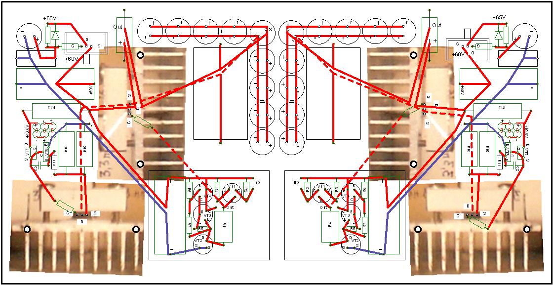

I do not use PCB, as already mentioned, but before drilling and soldering I try to create a picture of connections and parts locations, something similar to PCB drawing. Sometimes it is undestandable to me only, but I promise to post this drawing, maybe it could be of some use for others.

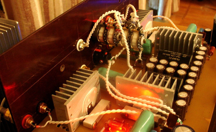

Here I eclose the picture of parts locations and connections. It is not very dense packed, because of the heatsinks, but No NFB assist to avoid any parasitic oscillations. Most of parts are soldered pin-to-pin, other connections are made by twisted 0,6mm copper wire in teflon.
Vladimir, you are avoiding PCB, from what reason? Do you think sound is better with point to point wirring aproach? I dont think there will be difference.
Without PCB, number of solder joints is almost half of that with PCB. Each solder joint contributes to that "effective total signal path" becomes a bit longer. This effect definitely is not measurable, but quite listenable, within ultimate sound quality domain.
The picture No.1 on your first post.. do you have a photo from the bottom side of PCB? Its not my intention to copy it, but im interested how you connect the parts.
I'll try to post, but its nothing noticable, just bend pins to each other, then decide how to locate and to bend the pins ends, then fix them and solder. Not too much aestetics, but quite an effective way.
